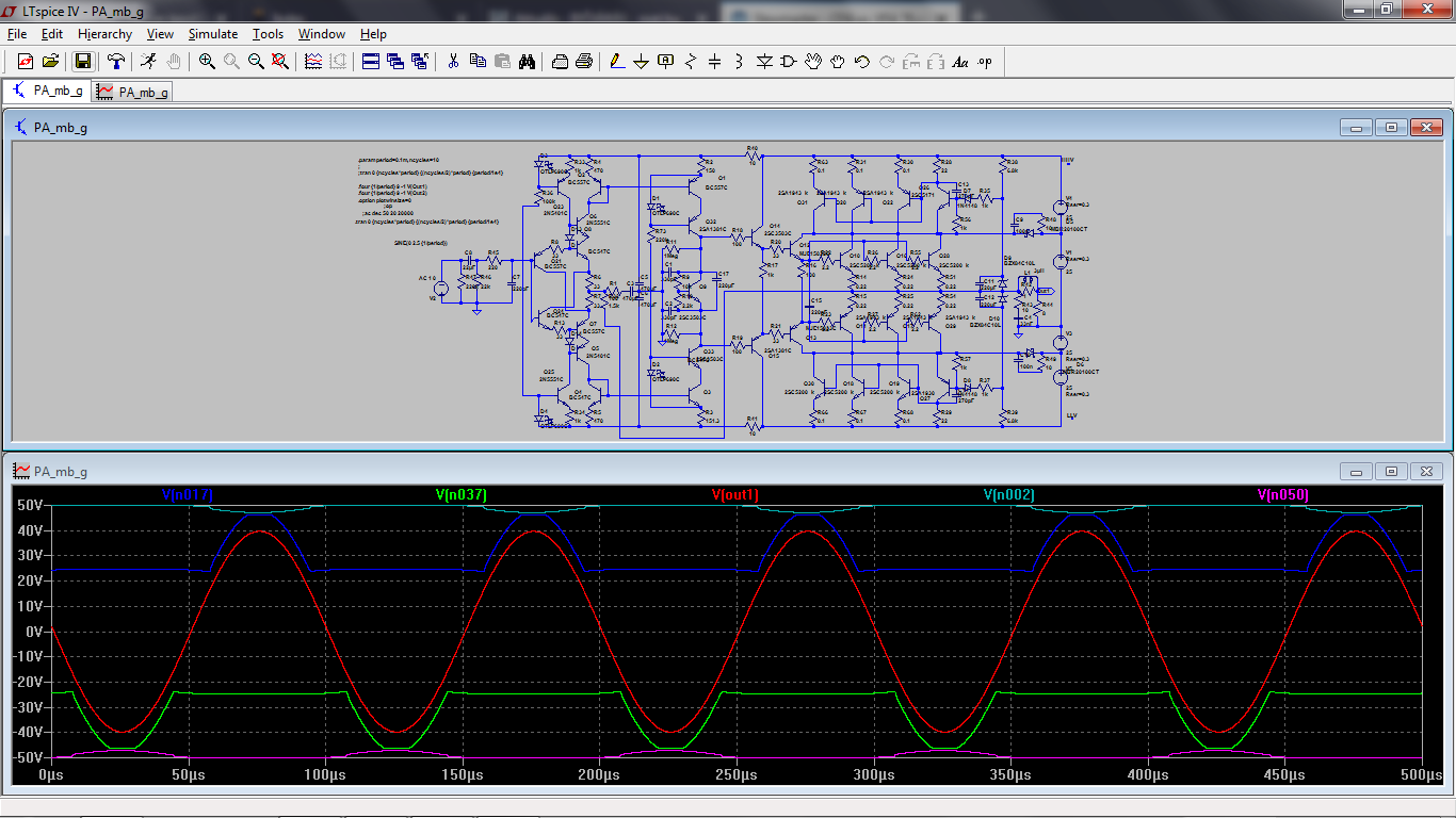

"pos/neg step" has to be faster than the fastest transient the input stage can
but the transition from the lower 20v supply to the modulated
higher one is not without glitches.
Lower the glitches with faster drivers, such as 2SC4793/2SA1837? They also have lower internal capacitance too...

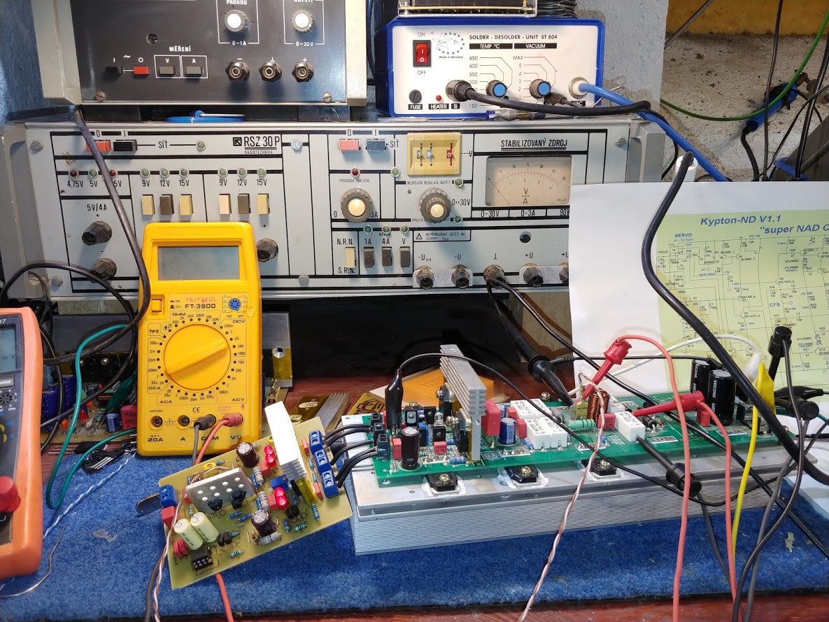

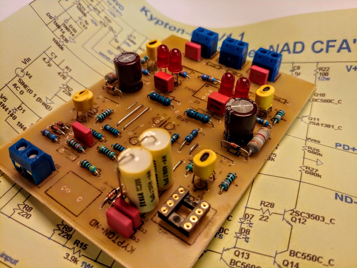

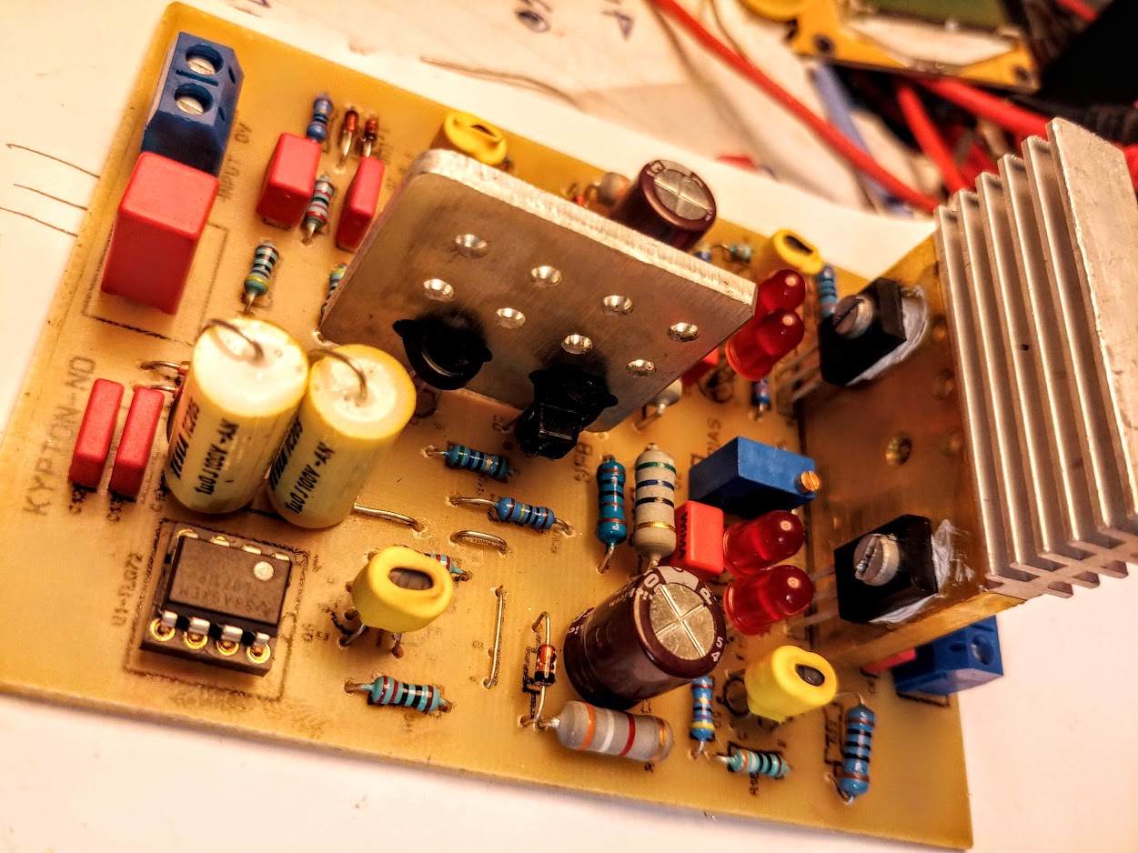

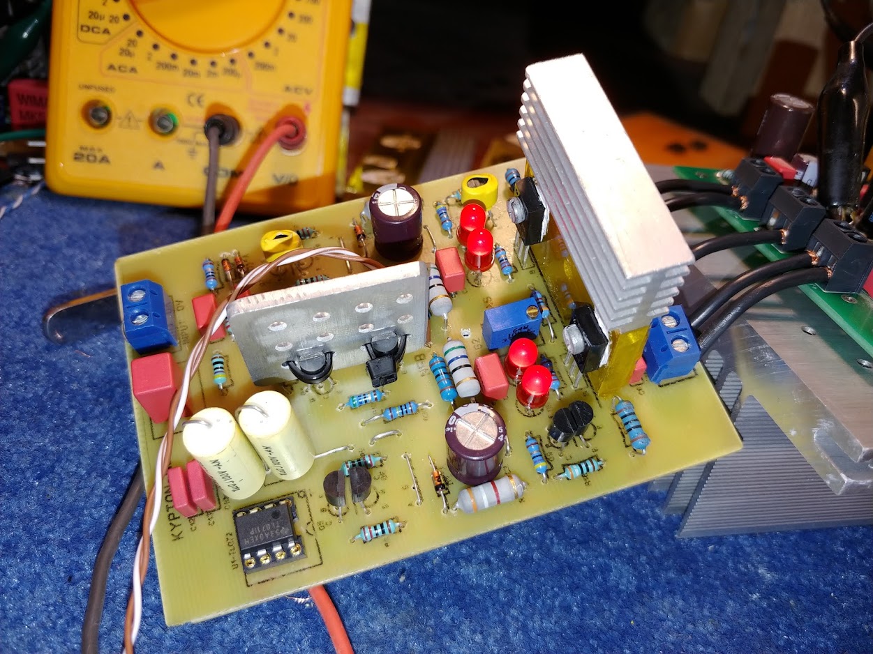

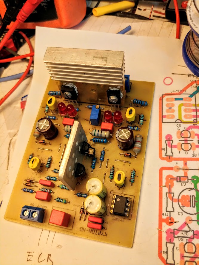

Guys any recommendations which IPS i should try for slewmaster? I would try Krypton ND, but some transistors are obsolete. Also LT1022 can't find for sale..
All the transistors are still available from Mouser for the Kypton-ND. Ostripper just used the LT1022 for simulation purposes. TL072 is the normal op amp of choice for Slewmaster servos.
512-KSA1381ESTU
512-KSC3503DSTU
512-BC560CTA
512-BC550CTA
512-KSA992FTA
512-KSC1845FTA
595-TL072CP
512-KSA1381ESTU
512-KSC3503DSTU
512-BC560CTA
512-BC550CTA
512-KSA992FTA
512-KSC1845FTA
595-TL072CP

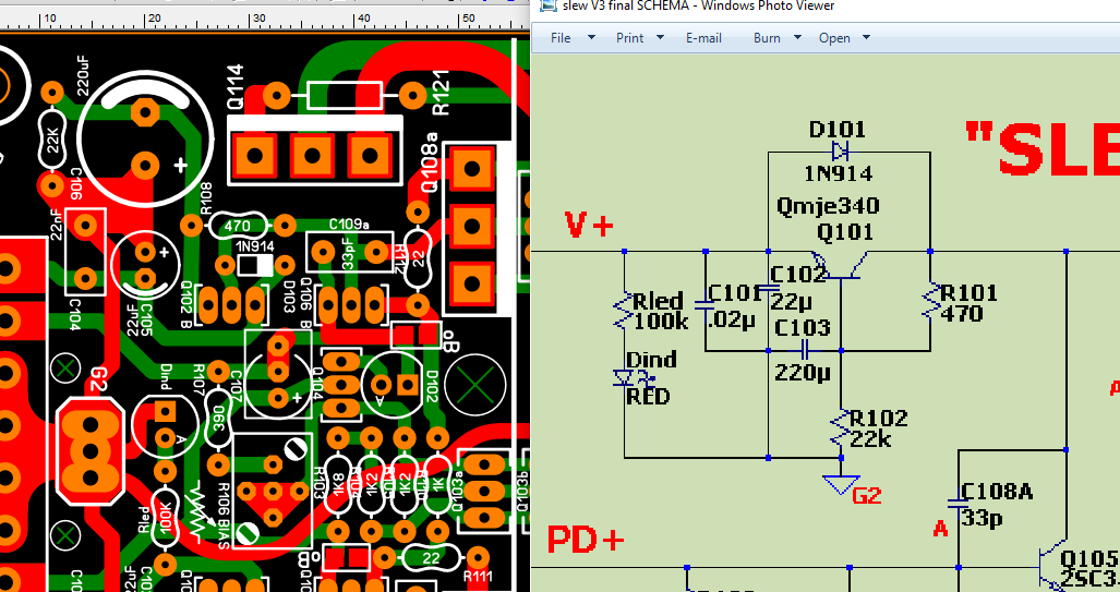

That is a capacitance multiplier. It is there to reduce power supply ripple going to the input board.
