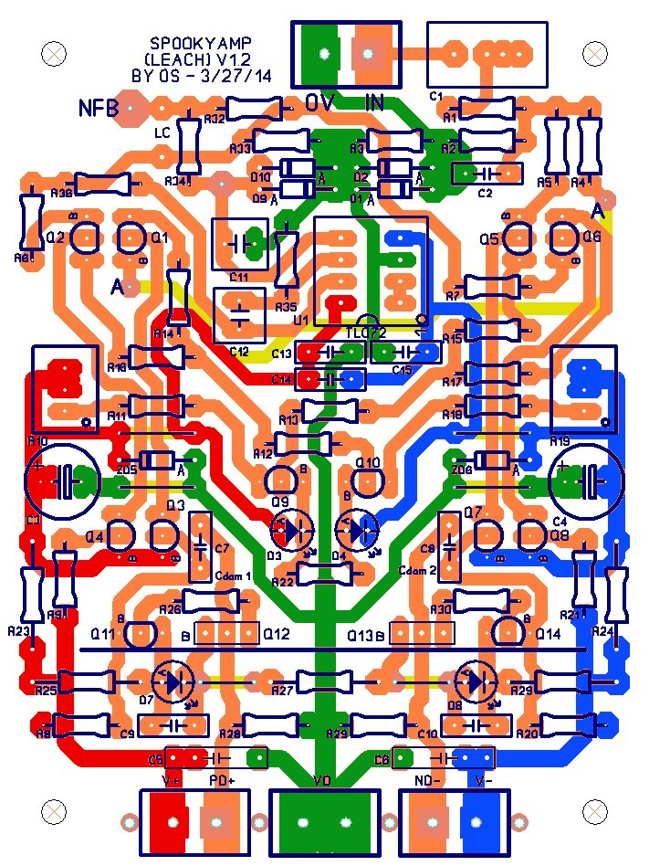

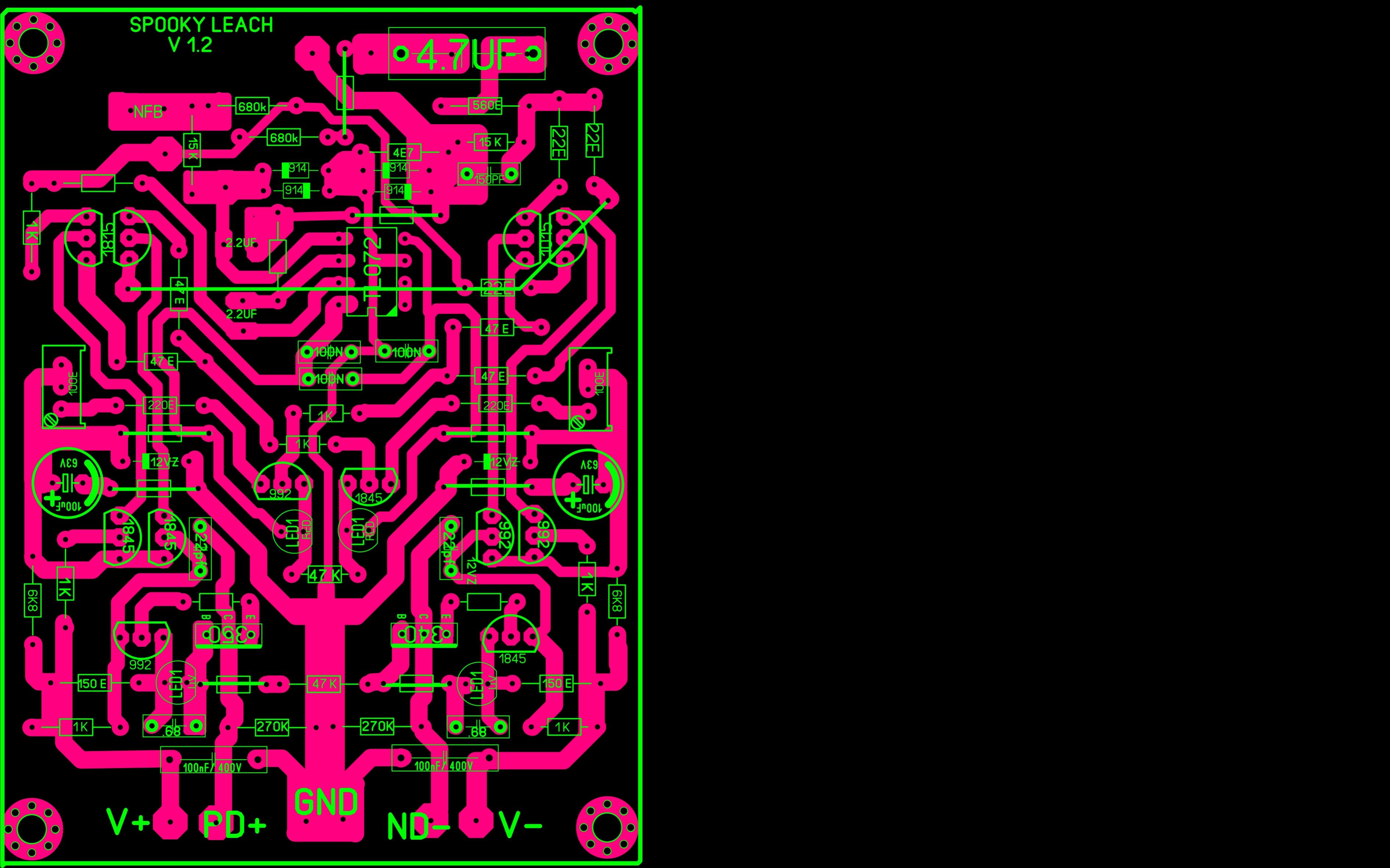

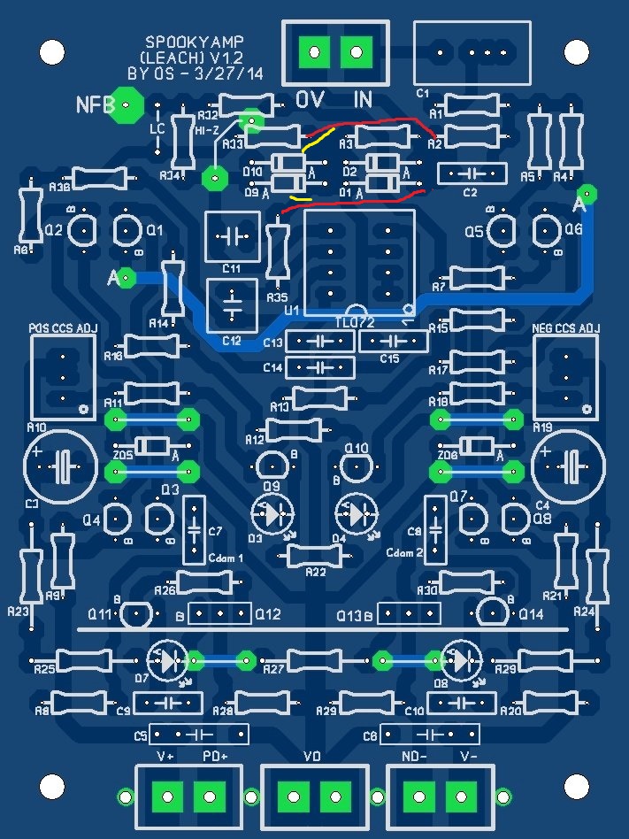

Hello
greetings trying to make spooky leach IPS i am following post #1400
along with blue pcb modifications can any one please check if it is
correct on the pink pcb component layout i have posted i have waited
for a long time to make spooky leach at that time components were
not available in my city now i have all the components to make it
warm regards
Andrew

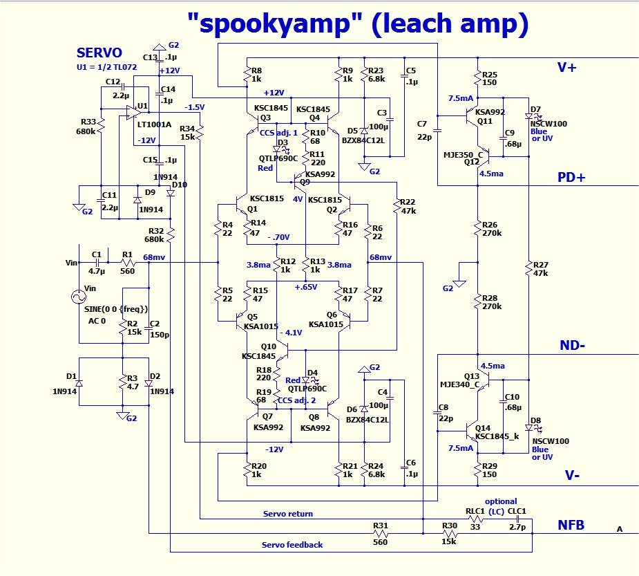

Hello
greetings R26/R30 schematic shows Q12 emitter going direct to Q11
collector if this was a modification i cant find values of the above
mentioned resistors can anyone help me PLEASE
warm regards
Andrew😕
