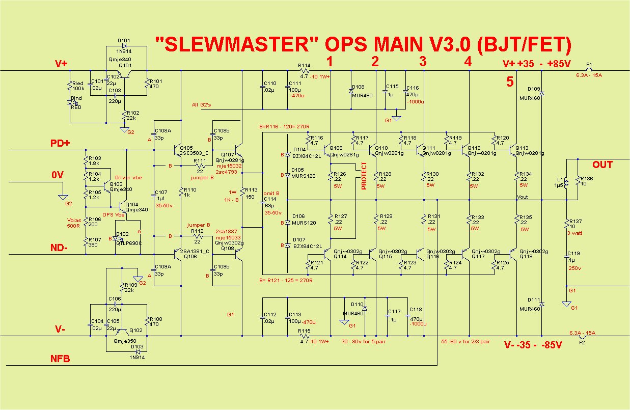

Meanman, this is more or less what I have used.
Yes, I build the 5 pair fet version, very happy with it !😉 I have used the KND IP stage, sound is very clean with superb midrange and bass.

Pete, my Slewmaster is still keeping me extremely happy, thanks again. Very good to have you back !!😀😀

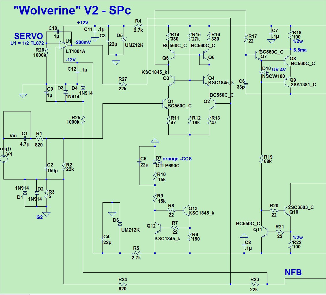

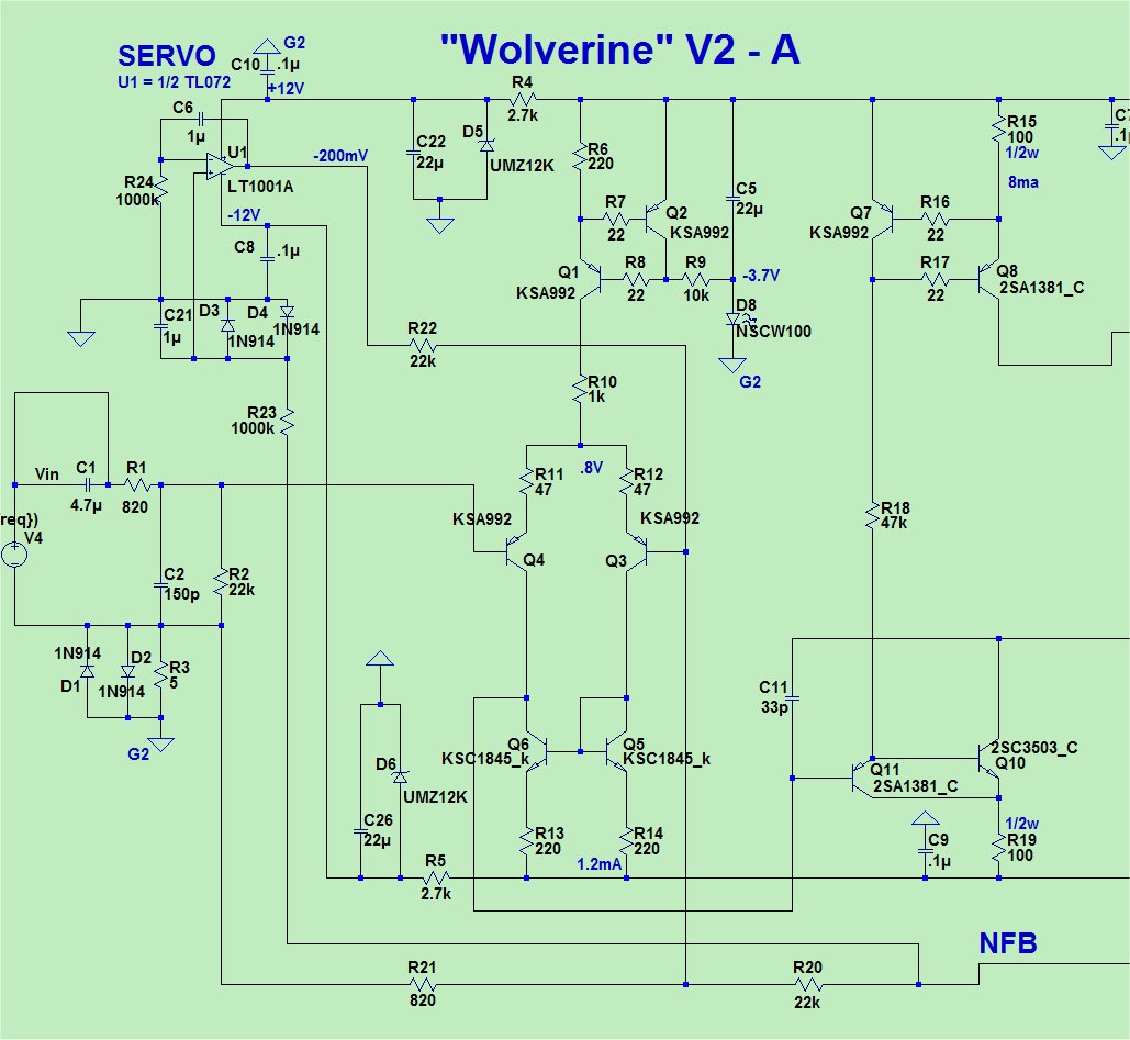

VERY pleased ...
Wolverine 2b = 16ppm thd 20K + 200nv offset. (below).
The "blameless design" really likes the superpair 😀 .
I might cascode the VAS and use TMC compensation to get <10ppm 20khz.
You will just have to plug this one in - idiotproof (nothing derogatory meant).
servo + simple LPT/current mirror AND clip-proof with less components.

Why you use KSA1381 in position Q11.. is it important?
I have a very few of these transistors, Could I use BC560 instead ?
Super-pair likes to have a matched Cob (base capacitance) , I tried a KSA992/BC Q11 ....
more parasitic oscillations without similar devices.
If I cascode the super-pair With a KSC3503 , I could use a bc560/550 pair.
I'm not quite done.
OS
Now I'm done.
(below) Schema ,ASC , and models.
14-15ppm 20k , no (heavy) saturation , no stability issues.
Compared to the Badger , a little better.\\
1-10Khz = .5ppm 10-20Khz = 2 -15ppm 20K.
OS

Hi Pete, I like this kind of asymmetric VAS arrangement with CCS on one side
Valery
Valery
Why ? Distortion products ...
