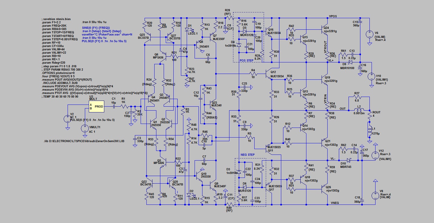

Nope , class G modulated AB OP stage and a super-pair based spooky (below) are
the next hurtles.
Output runs the pos/neg modulating steps. SOA is 2.5X 4 devices =<200w ,
8 OP devices = 500W . All at 70+ % efficiency.
Run it with SMPS's , cool .... but still a linear AB(Gmod).

Looks interesting but how does it work? Does a voltage droop at V+ cause current flow from the VPOS rail?
NO droops ??

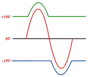

It runs on 2 rail sets (60-0-60v) V6+V8 and 20-0-20V V10+V12.
When the main output at R50/55 reaches +/-15V , (V6 minus the zener voltage of D4 /D3) - (5.6v) ....
, the positive step devices Q16-15/24 conduct (a little) of the higher step voltage
to the amps main output trannies.
Q16-15 drop 1.2V , so D4's boost (of Q 15/24) is always about 4V more
than any transient waveform present at the output.
Over 20V , the OP device rails follow the waveform (+4V always) dynamically.
The OP devices also typically retain the SOA @ 20V. % of time modulated
above 20V can be factored into the SOA , but it is always MUCH higher than
straight AB running at 60V rails.
Hope this simplifies the concept , J.
Edit , so the rail will look like this (below).
Edit 2- if you were to run flat out a 110v p-p signal , SOA would also be split between the upper/lower
step devices. >2X the power from the same BJT's.

Okay, now it makes sense! Is this ready for layout and testing or are you still tweaking it?
You move fast , J ??
You see all those transient equations in the simulation ...
"pos/neg step" has to be faster than the fastest transient the input stage can
throw at it - (the step modulators).
Also , the R/C of those modulators also moderate the small switching glitches
of the power schottkey rectifiers. There is no "real" switching (like in a class G
low Rdson - mosfet - setup) , but the transition from the lower 20v supply to the modulated
higher one is not without glitches.
Wait till 2019. PS - glad it made sense ! 😀
OS

You should add resistor at colector of current mirror. According Bob Cordell's book, in symmetry topology with current mirror as LTP's load, the value of VAS current is unknown. It can work intermittent like Randy Sloan design.
