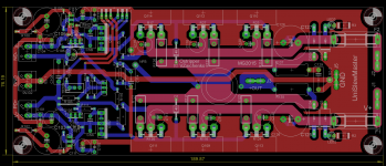

I know the fact about thermal. I try to spread ops as much as i can with available space. But i don't be anxious about that.....as the Vrail will be +/-50VDC. I planed to build a MJL3281/1302 (i have good matched triplets). The package on the picture is the TO264 one so i have a little bit space, they are not so close as in the monster version. For the BJT OPS i have quite generous heatsink (265x140x75mm with 16mm base). The other version i will build is the Vfet one with TO247 margin space will be more consequent. This version will be mount on 300x120x40mm with 10mm base). In both case i think thermal will not be an issue.
The picture under show the 3 situations : TO264/MT200/TO247

I would just make a 2 pair out of your design. The 2 pair mt-200 (or
semelab MGxxxx) would be a healthy 200W+ OPS.
In the space where the middle pair is - place the OP inductor.

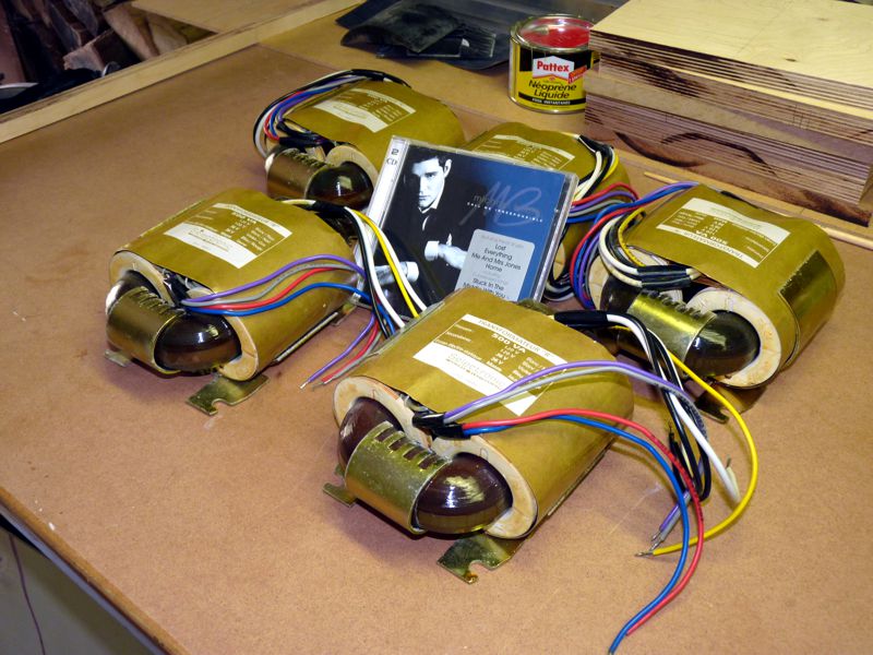

That will not be me as i don't see what i will do with that monster in 15m² listening room. The +/-50VDC choice in fact is because i have 4 nice 500Va 2x35V Rcore trafo. I will use one per chanel.
For MT200 what would be your choice : 2SC2922/2SA1216 or 2SC3264/2SA1295?

Nice trafo's !!
2922 vs. 3264 = almost the same.
Cob and ft are similar.
3264 is a bit faster/newer model.
3264 is higher voltage , better SOA @ 60V.
With your 53-54V rails ( I have a 35-0-35 as my tester trafo) ,
both would be the same.

So it will be 3264/1295 as they are 30-40% cheaper....

So more "Uni", inductor in the midle, but keeping the other package possibility as the pair output....

Then with the extra space left over near the fuses , reposition and
allow for a 16-18mm main decoupling caps.
18mm is still the same 7.5mm LS and can be 2400uf@ 63V/1800@80/1K-100.
16mm can be 1800/1200/820u.
Those electrolytics at the output collectors are not essential. If they are too
small , your rails will "ring".
My idea for these on the slew V1.x came from the edmond stuart "camp".
They used no main decoupling , Just 4 smd 100-100V units at the collectors.
No inductance before the collector pads.
Omit them and just use a big 1Kuf at the beginning of a 30A Imax rail , you
would see the same signal at the collectors.

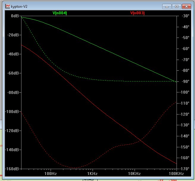

The secondary decoupling that feeds the driver/pre-driver rail is 4.7R -10R
plus a 47-470uf R/C combo. (below 1) green = R/C at drivers , red= the cap multiplier output.
The multiplier is a real good edition (below 2)green = input pair pssr , red= the final amp output after NFB.
This with a CFA !!! -120db is very good. That is why no slewmaster blows
up. Also , the ops is the best to compare with ... as CFA and VFA are
both have quite low PSRR. Some VFA's can drop to -150db using the multiplier.

Hi
Is these type of transformer better quality than Plitron LONO.
I have to order 2PC 32V 100VA transformer. I know Plitron great quality but I never had the chance to test one like yours on the picture.

I'm your man.....would only need to put the os together and could go right into it's home. +-82 volt 800 watt supply and big heatsinks.
You realize the V2.0 OPS will even fit the same bolt holes ?
Not much redrilling. Use the same HS's.
The secondary decoupling can be 2X 470u and the primary can be 2 X 1000uF.
A 500W amp like this would need .01-.03C/W (7U 300+mm) of sink.
There is no way a V1.x OPS could dissipate that amount of heat.
All 5 would be in the thermal space of just positions 2-4 on the new OPS.
Pair 1 and 5 on the new one would be 200mm apart.
ONLY 50mm left to each end of the sink. ALL the outputs would therefore
have about the same dissipation area (on a 300mm extrusion).
PS- .01 would be a 20C rise at <2KW. .02-03 would max out at 65C.
This would be absolutely necessary to dissipate up to 2KW. Even
with a 7U , you might need a bit of fan to help convection.
