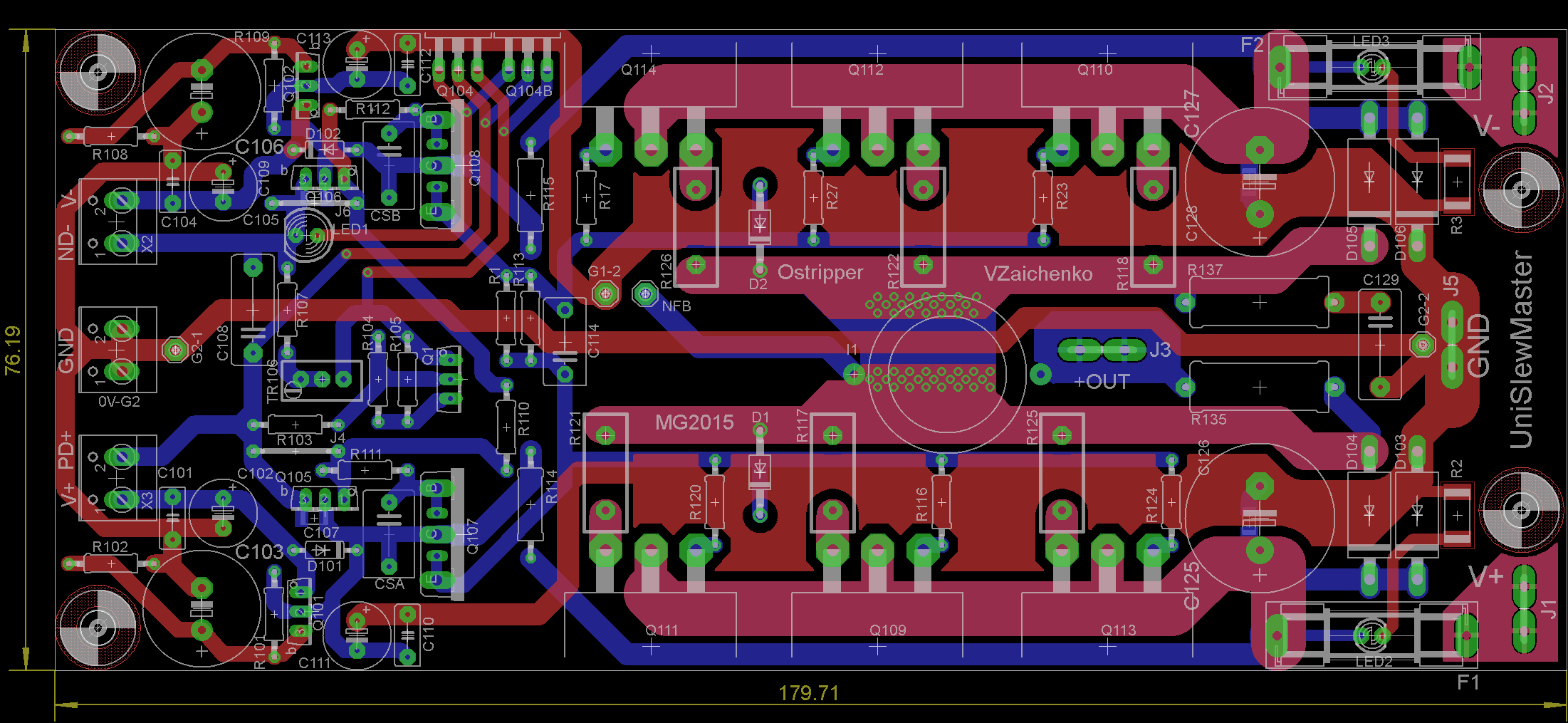

Then with the extra space left over near the fuses , reposition and
allow for a 16-18mm main decoupling caps.
18mm is still the same 7.5mm LS and can be 2400uf@ 63V/1800@80/1K-100.
16mm can be 1800/1200/820u.
Those electrolytics at the output collectors are not essential. If they are too
small , your rails will "ring".
My idea for these on the slew V1.x came from the edmond stuart "camp".
They used no main decoupling , Just 4 smd 100-100V units at the collectors.
No inductance before the collector pads.
Omit them and just use a big 1Kuf at the beginning of a 30A Imax rail , you
would see the same signal at the collectors.
The secondary decoupling that feeds the driver/pre-driver rail is 4.7R -10R
plus a 47-470uf R/C combo. (below 1) green = R/C at drivers , red= the cap multiplier output.
The multiplier is a real good edition (below 2)green = input pair pssr , red= the final amp output after NFB.
This with a CFA !!! -120db is very good. That is why no slewmaster blows
up. Also , the ops is the best to compare with ... as CFA and VFA are
both have quite low PSRR. Some VFA's can drop to -150db using the multiplier.

On the layout, main cap are already 18mm.....
Marc

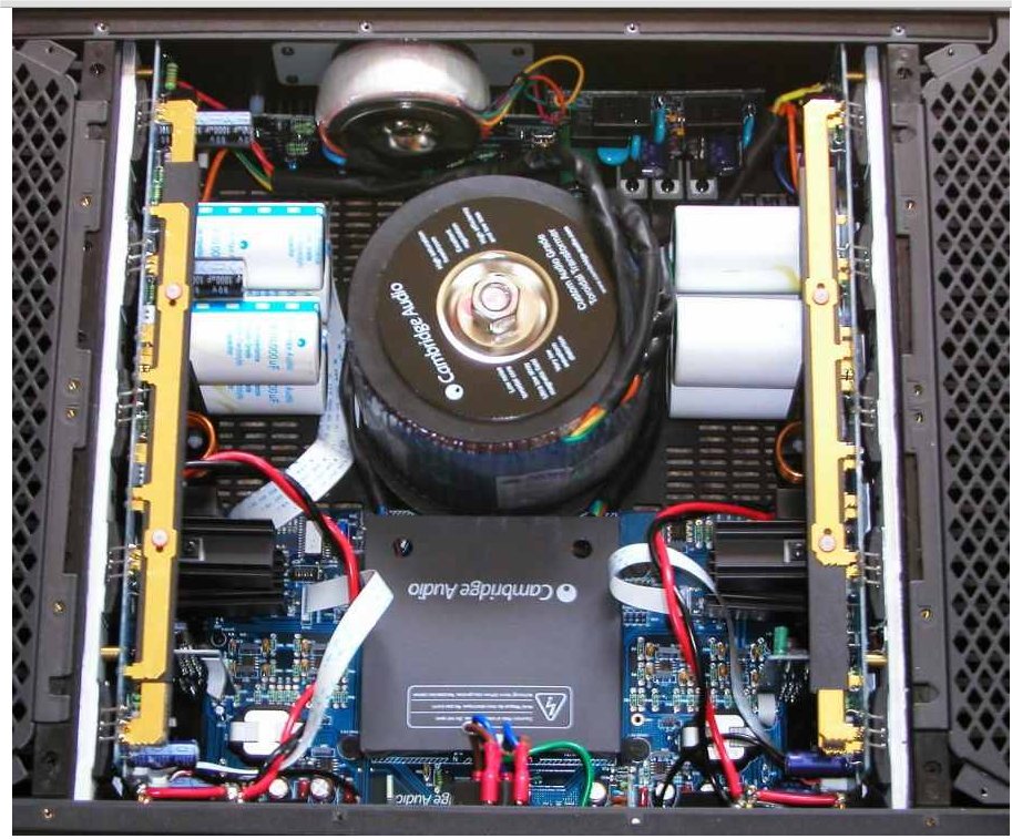

I did find one amp (below) , that not only uses 5 pair MT-200 ....
but is laid out nearly exactly to the Slew 2.0.
They really conservatively rate it at 250/380W , but you can bridge it
for 500/1000. Usually , most recommend double the outputs for a bridge.
Not here. I suspect the small toroid and power supply "collapses" to
bring the single channel power down. Or, it has lower rails.
Nice amp .... regardless (Cambridge audio).

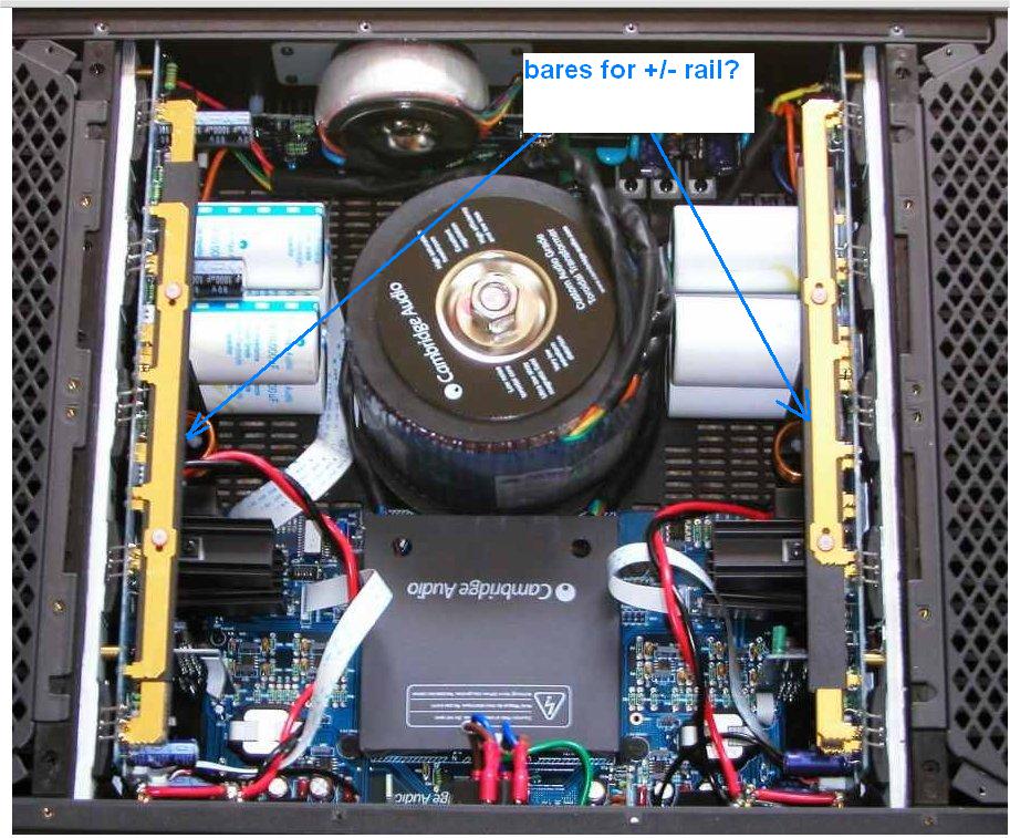

OS,
So they ran those power rails that way to keep the pcb narrower than they would have had to otherwise or was that so they could run the power rails all stacked for some cancellation effects such as you would do with a double sided board with plus and minus rail on top of each other?
OS,
Most likely for both reasons. The amp specs out real good. No fancy
stuff , just 2 big amps and control circuitry/PS.

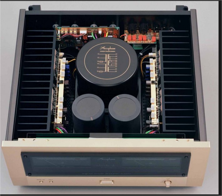

I've also seen accuphase do this. (below)
