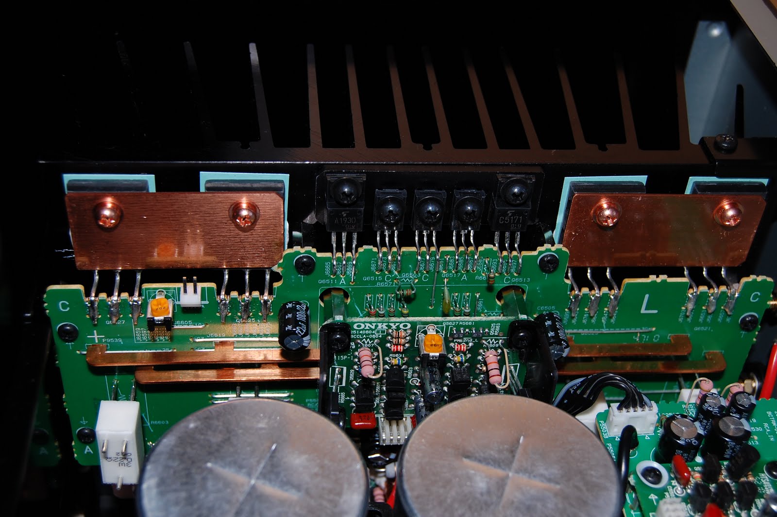

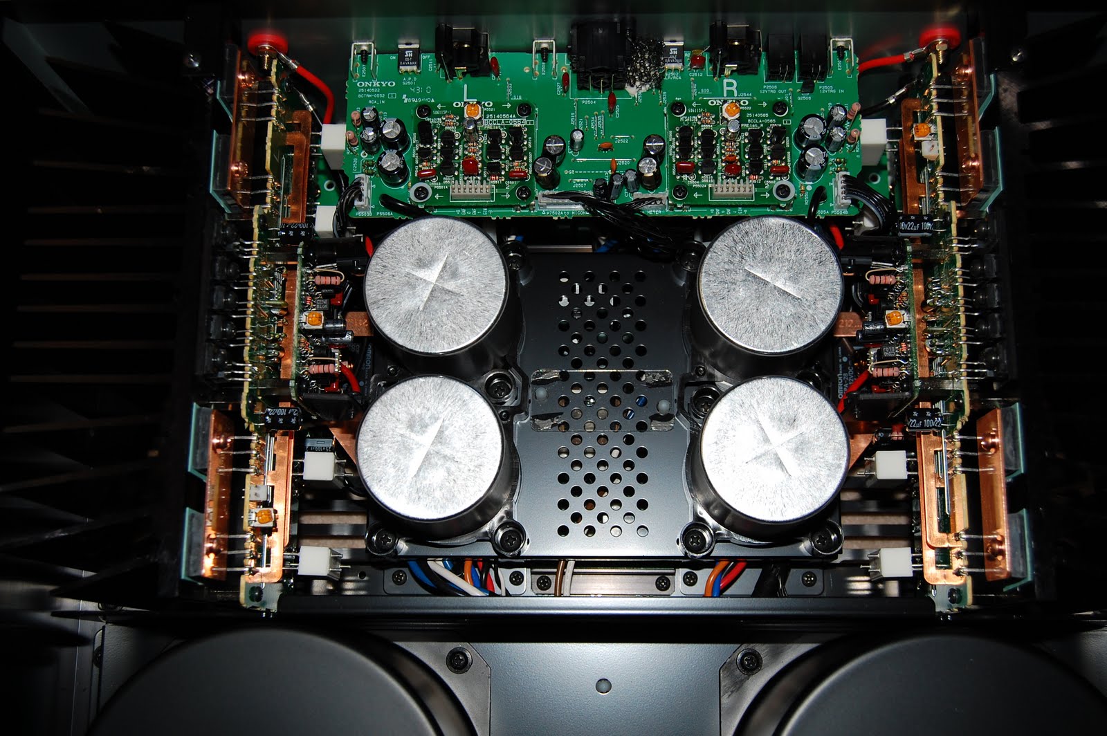

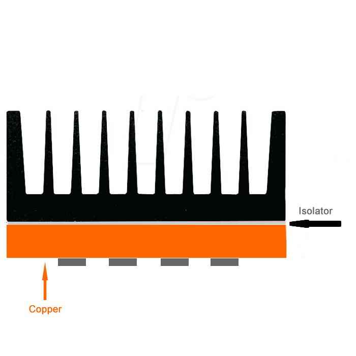

I think you should use thermal paste with copper powder, for lower thermal resistance and better electrical conduction. What material you will use to isolate the heatsink from the chassis ground?
Or those conductive inks we use to repair PBs ? They are made of very thin silver and nicely fluid. But take care of not using aluminium Heat sink. Aluminium oxide itself instantly in contact with air, covering itself with "alumina" witch is a very good... isolator ;-)I think you should use thermal paste with copper powder, for lower thermal resistance and better electrical conduction.
Copper and aluminum aren't a good mix when conducting electricity. Many houses have burned down from this.
I would to that, using Nylon screews to fix the copper plate to the heat sink.
The copper base will allow to equalize further the temps between the power devices. The big surface of the isolator reduce its thermal resistance. You can mount the aluminium heat sing normally on the chassis, to earth. Of course, collectors need to be powered as habit by its pin in the same time by security.
This actually looks like a good idea. Depending on your choice of output devices steel screws could be used too as TO 247 and MT-200 devices have insulated through holes. If everything was machined accurately shorting wouldn't be an issue.There wouldn't be that huge piece of live aluminum begging to have something fall on it and shorting out either.
Looking at the pictures just posted by carcass my question is does the transistor radiate equal heat on both sides of the package or is the internal die closer to the side we normally mount them on? If it is equal then those copper plates make a lot of sense for increasing the radiated surface ares to lower the die temperatures. I guess those little copper plates could end up being a secondary small finned heat sink.
