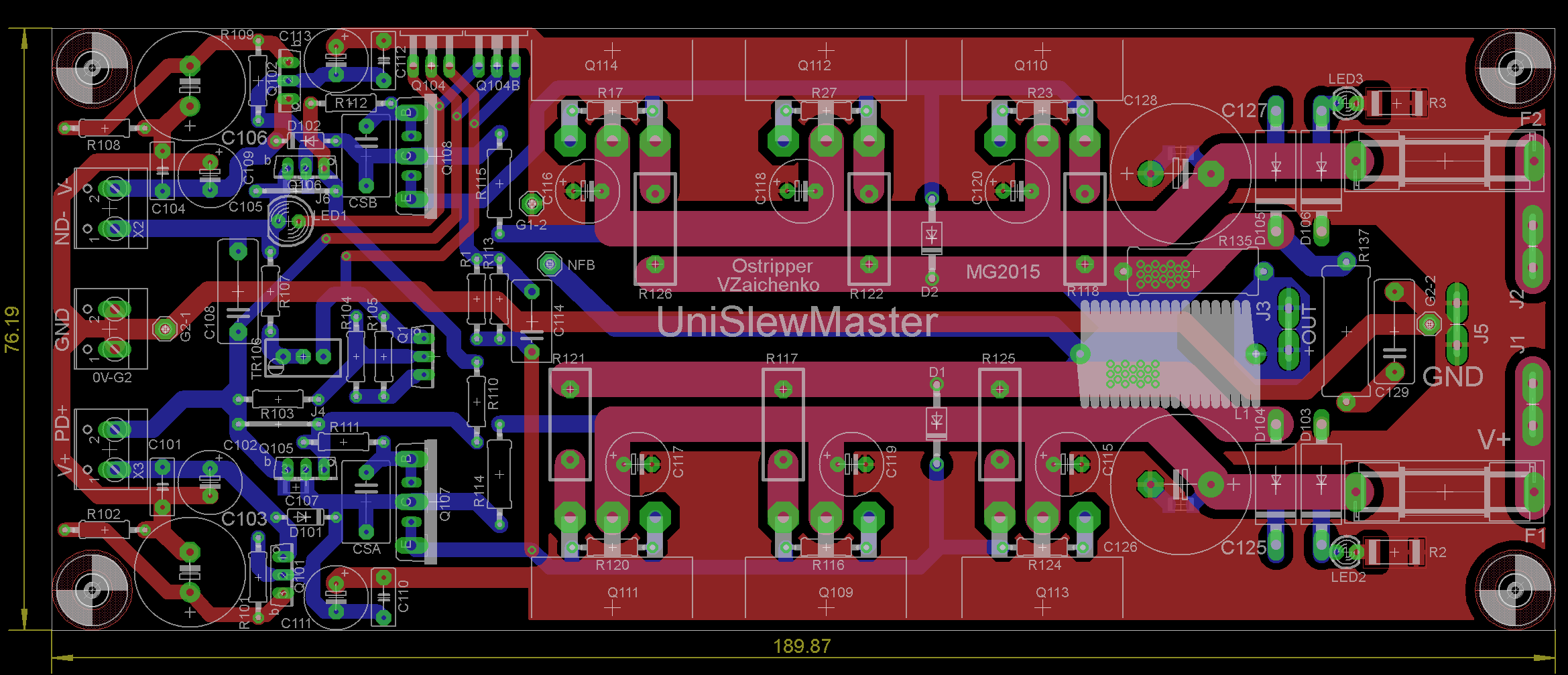

I'm wondering if RN60(vishay resistors)seat well here,i don't think so ,what your opinion?Bimo, I plan on very soon putting up a PDF drill template to make preparing a heat sink easier. That will allow folks to print it at 100%, tape it down, centre punch the hole locations and drill accurately. As for tapping, the correct drill size for the tap is important as is the correct lubricant. I would avoid tapping with power tools, it is to hard to feel what is going on And ultimately breaking the tap.
I'll check the specs and get back to you on that shortly.
For sure not. Use RN55, that is smaller, the size of RN60 is equal with a common 1W resistor...

Thanks for answers ,i will see on RN55For sure not. Use RN55, that is smaller, the size of RN60 is equal with a common 1W resistor...

The hole spacing on the boards is 0.400", and the CMF60 (RN60) has a maximum specified length of about 0.375", so it should fit albeit snugly. The CMF55 (RN55) is substantially smaller.
Unfortunately not fit, as the not painted lenght is 0.425", and You have to add the diameters of the terminals (0.025"). I used many of RN60D and RN55D. My experience that 0.4" necessary for RN55D and 0.5" for the RN60D.
Check the attached picture, one of my amplifier board using this values.

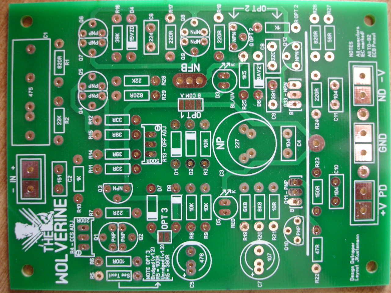

Hi OS and all,
As Borys on his thread explain his finding on using dual layer and closing Gnd Track to Power tracks
I try to apply this to my board layout (picture under). GND is a kind of "partial ground plane". He follow rigth power tracks. Did any one see a issue to do this way?
Dual layer pcb gives a lot of advantages. I have made some measurements to compare the standard single layer OPS and dual layer OPS and there is slight measurable improvement in dual layer OPS. I run the V+ and V- rails very close (on top of each other), even better would be to run V+ and V- rails next to each other and putt GND track right above them, if the GND track would be a current return tor speaker than all the electromagnetic should cancel out.

That is good , seen on the "silicon image blameless" kit.
The trend i'm seeing is the tight grouping of 3 or more pairs on the PCB.
2 pair you can get away with it , heat will dissipate symetrically in each
direction . 2-pair will act as 1 BIG pair.
3-pair is different , the center pair will reach SOA much quicker by
the thermal derating. If the OPS is pushed to the limit , this pair will
fail first ..... a weak link in the chain. It will also be "hogging" current ,
pushing it still faster to the ends of SOA.
The electrical and thermal differences between my spaced 3 pair
and tightly packed 5 pair setups are striking. 😱
PS - this effect is greatly reduced with 6-7U heatsinks , heat transmits
in 4 directions - but it still happens here.

Thanks for answer.
I know the fact about thermal. I try to spread ops as much as i can with available space. But i don't be anxious about that.....as the Vrail will be +/-50VDC. I planed to build a MJL3281/1302 (i have good matched triplets). The package on the picture is the TO264 one so i have a little bit space, they are not so close as in the monster version. For the BJT OPS i have quite generous heatsink (265x140x75mm with 16mm base). The other version i will build is the Vfet one with TO247 margin space will be more consequent. This version will be mount on 300x120x40mm with 10mm base). In both case i think thermal will not be an issue.
The picture under show the 3 situations : TO264/MT200/TO247

Ground planes and such .....
In the "silicon chip" amp kit - Silicon Chip Online - Ultra-LD Mk.2 200W Power Amplifier Module
They do the rail/ground plane "trick" in dual layer. But look at the rest of
their circuit , it straddles these high current inputs(tracks).
I see why they would almost NEED to do this , with this type layout.
Any radiated track fields would infect the low level circuitry they have
almost on top of it.
Our type amps keep the inductor/high currents feeds and returns at
distance. Likely facing the toroid in a typical setup .
Separated by distance and sitting behind 20K virtual capacitance is
the IPS , with it's separate isolated rail feeds and ground.
The OPS's radiated field would only be seen by the very low Z tracks
of the final stage of the EF3 , even the predrivers and Vbe of the Slews
is in a clean zone , separated by distance.
The reason for the twisted/weaved rail lines in power amps , is so they
won't radiate to a low level circuit in passing. Dual layer rails to reduce
L/R would be a better use of the second layer.
A small amp with all on one board might benefit from a layout like the
silicon chip LD (link ). The use of this "trick" is very design dependent.
