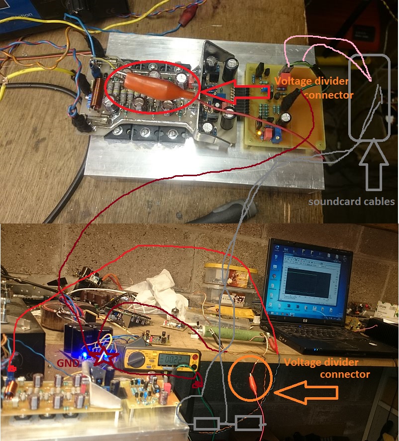

I can't see the voltage divider and the way this is connected to laptopthimios

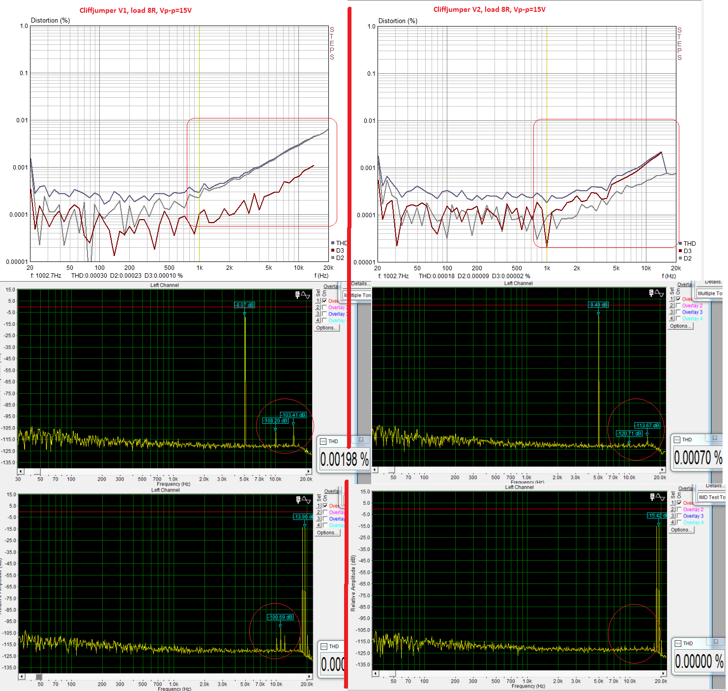

Yes the load is connected, the graph in STEPS looks linear but at higher F the distortions are rising up a bit. At the higher amplitude THD is rising too, but amp sounds really OK.
I am doing STEPS graphs to see if the amp has the same harmonics spectrum threw all audio band. Take a look at my setup bellow (you can see the ''linear'' graph on the laptop and 8R resistor and the clamp meter).
Sometimes thd graph is showing some design problems. For me THD figure does not mater much but I like to test it anyway to confirm that all is ok.

Bellow is my clean and tidy setup 😀 (please do not coment it, I know how it looks like)
The gnd return is connected to the clean ground. I am using same (I think) gnd layout as apex, the main star gnd is in the psu (the heavy current returns are spreaded, it looks like there are two star points at the pcb board). I am using 1k/47k divider, the return from it goes threw signal cable to the pcb board and than to the psu unit.
Sorry but I can not describe it better.

I have made small current adjustment adn speeded up a bit the Cliffjumper (up to approx 70V/us), the high freq performance have improved a bit. Bellow compared two versions (few resistor values changed only).

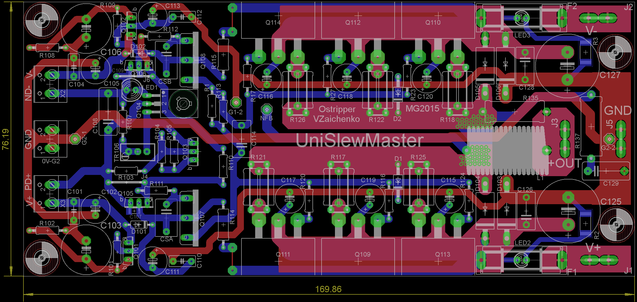

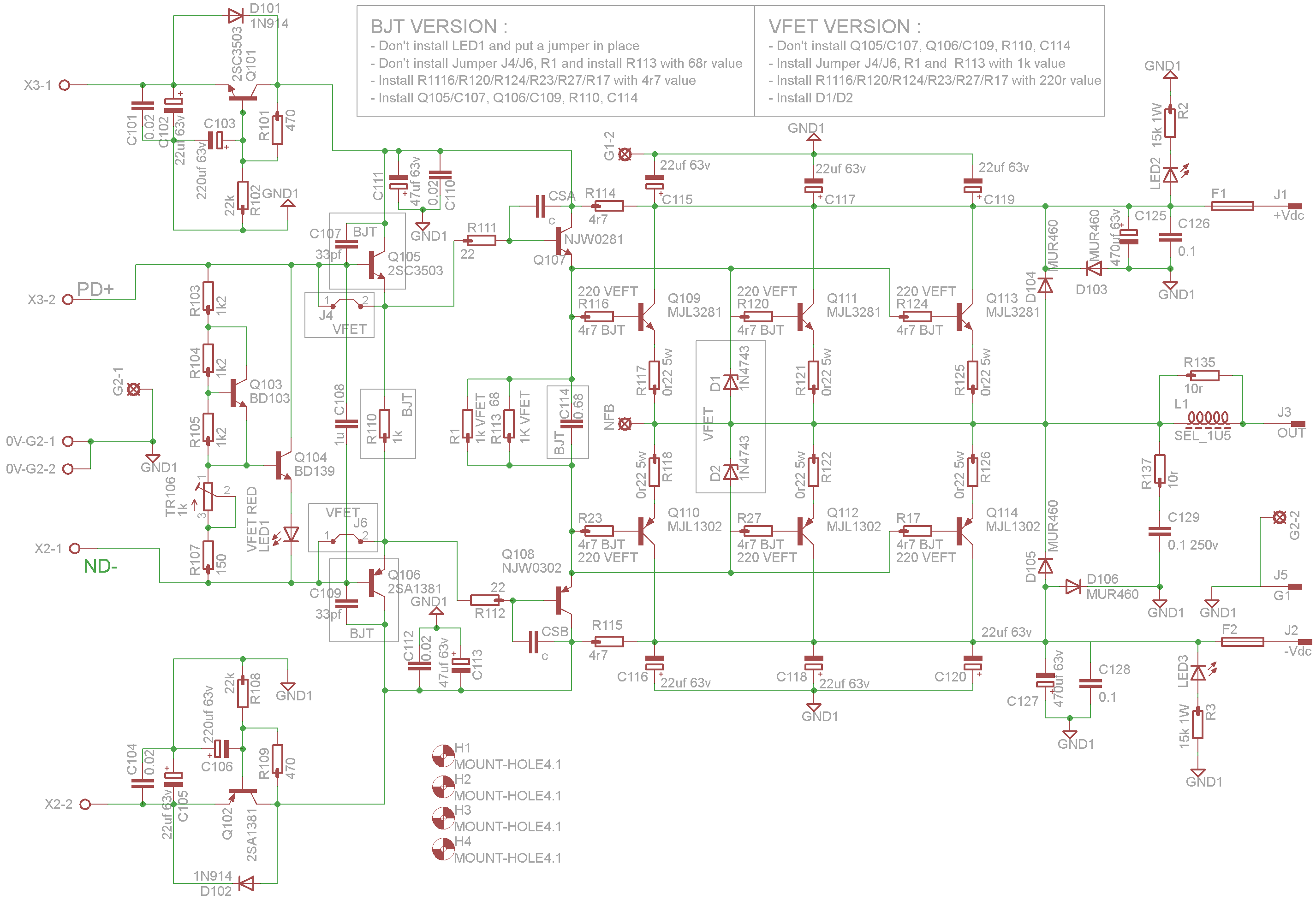

I had in mind to give a try at both BJT and VFET OPS so i decide to root a "universal board" with all option that allow to swap from FVET to BJT by just install or not install parts/jumper. Instruction are summerized on Schematic. With this Uni version one bath of 5 board from pcbCompagny allow to built both Ops with one spare board (min 5 board order)

Yes for sure. If some people can take a look at the two pictures for checking...I have to let a little time appart because spend to much time on and don't seen anything...

It would be a good idea to spread your output devices apart farther. The temperature and bias current runs higher on the center devices when they are that close together. OS has noticed this too.
Yes Jason i read OS on that. I will take a look on how to but don't want to grown to much the board. The goal is to keep OPS and IPS on on a 300x120mm heatsink face. I don't remember if in OS case he has 3 or 5 output pair...
Here modification board take 1cm more in lentgh so OPS have 5mm more between them. On picture OPS package is TO264.

There's a couple other design upgrades that might be worth looking into.
Q104 might benefit from being mounted closer to one of the output devices so it can get a faster response to output device temperature changes.
Power rail feeds come through the fuses, feed to the two big reservoir caps, then the current reverses down the same trace to the output devices creating a very current area on the trace. Randy Slone recommended having a distinct current in and out path to eliminate this. The same issue is there with the output device decoupling caps.

For Q104 one way to go is to screwit right on a output device and connect it with wire. I've done that on my NBIP drom Quasi
