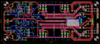

OK so the difference is the mounting hole for the larger device? Seems that could just be drilled into the existing boards. Any other changes?
The plastic body of the part is larger and longer for double di as for Renesas. Double die has package from MJL3281/1302 and i wanted that output fit under board the more i can so due To264 package i had to move pin pad more to the middle of the board.

since you are talking about double die ALF parts would these be equivalent to two pairs of output devices with two of these on your new board layout? Just curious if I am understanding correctly.

Yes it's rigth that. Single die are rated at 8A as double die are rated at 16A. So no need to match to single die. Double are those that lazy use in his first one. Exicon has the same parts

Here is the version i will probably build. I don't need extreme power range as my listening room has only 15m². So 2 pairs either Vfet or BJT (MJL3281/1302 or 2SC2922/2SA1302) will be more than enough at +/-50Vdc rail to drive even 4 ohms speakers. I have KSC2690/KSA1220 for cap mu, KSC3503/KSA1381 and 2SC4793/2SA1837 for pre driver and driver in stock. For OP i have matched IRFP240/9240 and MJL3281/1302 in stock but i would give a try to genuine 2SC2922/2SA1216 (purchase from Profusion PLC)

Look great! I'm sure you will be very pleased with this. Now you just have the task of settling on an IPS. I have built them all and there isn't a bad one in the bunch. Well, maybe the Krypton-V. That includes Valery's and Borys' IPS. This is DIY heaven.

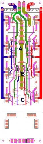

I see the dreaded word "flaming" and such ....
What keeps it all together is the local driver decoupling and the general
layout. (below A and C).
A = the main decoupling , C= the driver decoupling. On this one , all this
dirty decoupling can stay right where it belongs - between the outputs
and rails.
B is the added 3-4A Diode protections AND gate protection for MOSFETS.
This OPS will not have any G1 (dirty) past where the green traces are.
I even think I can fit the cap multipliers on the output side. Just the
Vbe and predrivers will have a very "quiet neighborhood" to unleash
all that POWER ! Multiplier caps and final decoupling will be the clean
G2 that is either separate or taken from the center of G1.
My attempt a year ago to play by these rules worked out well - no
This is the "next generation" (bigger and more "anal" 😱 ) - here we
might actually have (the biggest and longest 😀😀 ) ... MT-200's.
