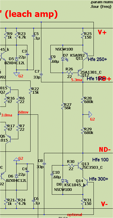

2sc3503/2sa1381 replacement for Spooky IPS
Did anyone build the Spooky (or other) IPS using MJE340/MJE350 instead of 2sc3503/2sa1381 and compare the difference?
I'm unable to find proper 2sc3503/2sa1381, even Mouser stocks only KSC3503D and KSA1381E, which is not ideal either (I mean using different transistor grade in a pair).
Is the MJE340/MJE350 the only replacement for those?
And how much worse will the amp sound with the MJE pair?

No ... don't. Why not be smart. You have a "weaker" 3503 ,pair it with a
higher beta super pair (bc550/560) or ksc 1845.
The cascoded VAS plus the EF3 eliminate the 20'th century matching BS
-period !!
Even if you did not do this , it would surely beat a high Cob 340/350 setup.
PS - the 340/350 would work , but slew and bandwidth would suffer.
The primary input pair (or pairs) are much more important to at least get
close.
As are the beta's of your groups of P and N output devices , to keep any
one of them from "hogging" current.
Edit - the kypton ND (best of the CFA's) shows 1ppm change using a ksa1381/ toshiba 2sc4793 pair
as VAS cascode ! Thd DOES rise with a mismatched input pair , as predicted.
OS

No , NO , you DON'T have to alter anything. When you are testing out
transistors .... just do a "controlled mismatch" on the VAS.
The gain of the cascoded VAS-hawksford ... is (active device + cascode) . So ,
offset the weaker 3503 or any other device (you could even use a
1837/4793 toshiba pair - reversed) in the VAS.
Just has to have a higher Ft and lower Cob - wide range will work.
Maybe a pix will show (below). SOOOOO simple a concept.
super-pair cascode is even more sensitive , just 10% more beta on
the weaker 3503 (for example) bc550/560's will counteract any imbalance.
You will end up with a perfect VAS , as good as a curve traced ,"anal"
matching. super -pair might not even matter .... just picoamps of
load on the input pair(s).
Edit - just save a few of your "oddball" higher gain 1845's to offset the 3503.
OS
