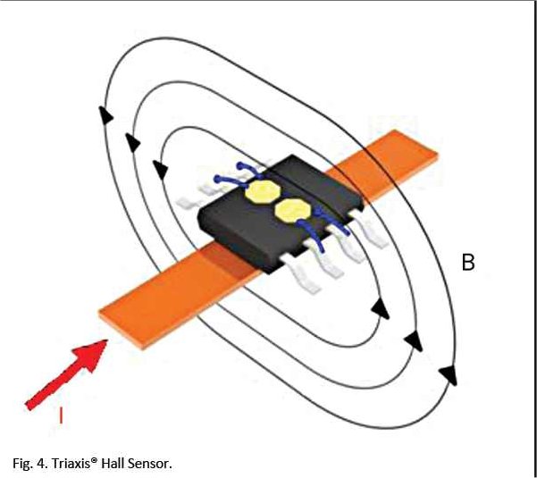

what we want to do is eliminate the series resistance down to just a
DMOS junction. Up till now you would need at least a 100m ohm "sense"
resistance to directly measure current.
Look to the industrial (even electric car) industry. Jerkhead elon Musk uses
this stuff in the tesla - ACS712ELCTR-30A-T Allegro MicroSystems, LLC | 620-1191-2-ND | DigiKey
That type has 4 of the SOIC pins as a 1mOHM conductor and the other 4
as the supply / sensor. Some others are where you mount the soic right
over a trace , with the hall sensor sensing the PCB trace directly under it (below).
Neat , cheap (1-2$) - in tandem with a power mosfet could make a dual
use voltage output current monitor AND resettable fuse (latching circuit).
I'll look at more application circuits , Many to choose from ! 😎

I was thinking a little bigger to keep the resistance down. http://www.farnell.com/datasheets/1934117.pdf
I ran it already. Output voltage goes positive from 2.5V on forward current flow and goes negative on reverse current flow. It would have been easier to make a bidirectional unit if it went positive with any direction of current flow. If we feed this to the inverting input of an op amp and have an adjustable voltage reference on the non-inverting input we can easily set current limits. We'll likely need to slow down the output from the sensor. This thing would have a hair trigger. The output from the op amp would be able to directly feed the optocoupler to run the mosfet. We just need to regulate rail voltage to +5 and whatever the op amp needs and bring a ground to it. I'll breadboard a circuit later today and draw up a schematic to explain all this gibberish.
The next issue will be selecting a current threshold. Because of the speed of this unit we will need to limit current at a much higher limit. We will loose some constant current protection to gain speed. We will likely need to select maximum SOA current for the output devices instead conventional wire current limits. For proper protection these types of circuits are used with a fuse in series, which defeats the purpose.
Ahh , we think alike. I was thinking a zener to knock the rail down to
12V and a 5 V pre-regulator to power the sensor and op-amp.
