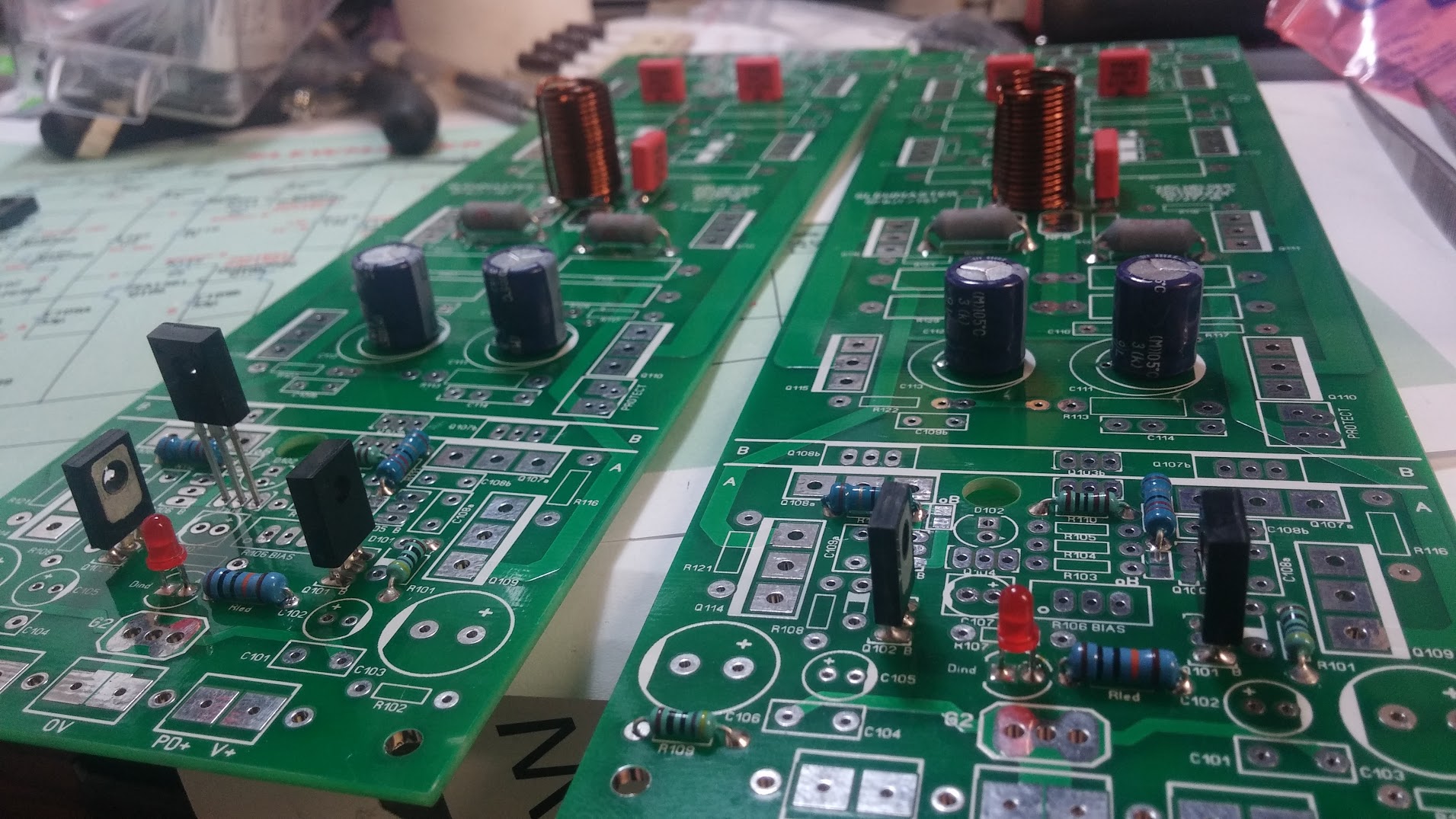

Yesterday i started work on Evans PCB´s. It is little bit difficult to do it without BOM and silk screen... No caps voltage... is it there something more, than schematic only? Anyone finished? 😀
mine are done and tested with 1 pair.
ALL caps are 100v except maybe the 1 uf Vbe cap (35-100V).
It will work with a huge range for the big electro's.
I've measured almost no ripple at load with as little as 47u for the multiplier caps.
The OPS's don't have many different parts. Even as I am making a book ,
The PCB itself will have the values on the next round of boards.

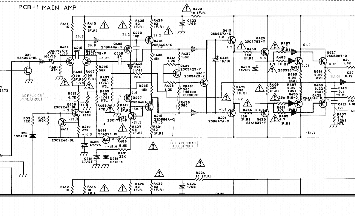

Do you mean a commercial amplifier uses 2 pairs mt-100 as output with 2sa-2sc as driver?
Re, you mean R113=220R?
680 runs 2 pair mt-100 with the toshibas with a 220R driver Re
Yes , R113 ... and yes (below- 680) - Slewmaster's "Daddy".
OS
Edit. I see you mean Harman Kardon HK680680 runs 2 pair mt-100 with the toshibas with a 220R driver Re

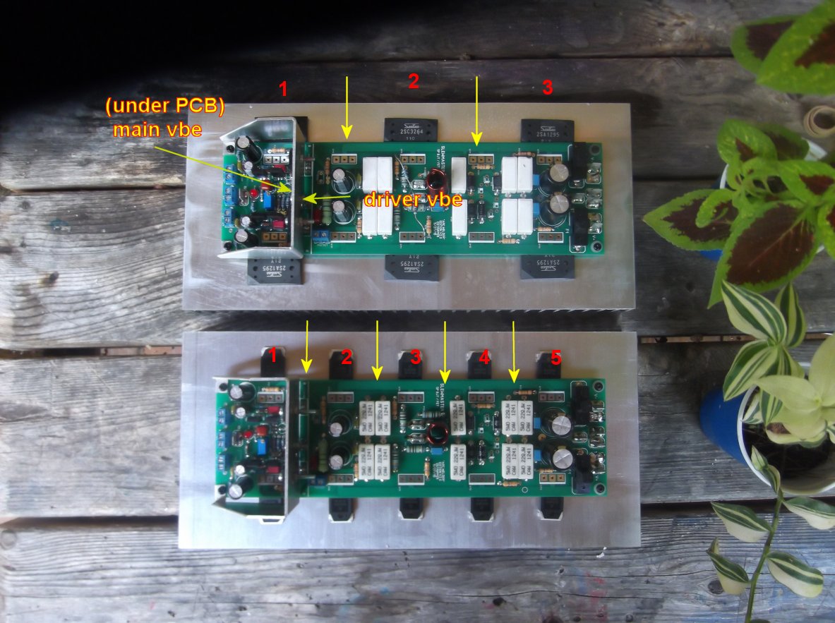

optimum 250W slewmasters ...
3 pair mt-200 or 5 pair NJW spread out optimally over
a .4C/W extrusion.
5 pair "arcwelder" (MT-200) , I would recommend double
the extrusion (.2C/W 300mm X 300mm).
Either way , a calculated and tested 40C idle , <50C heavy use
can be expected. Extrusions should be within 1C - end to end.
OS
