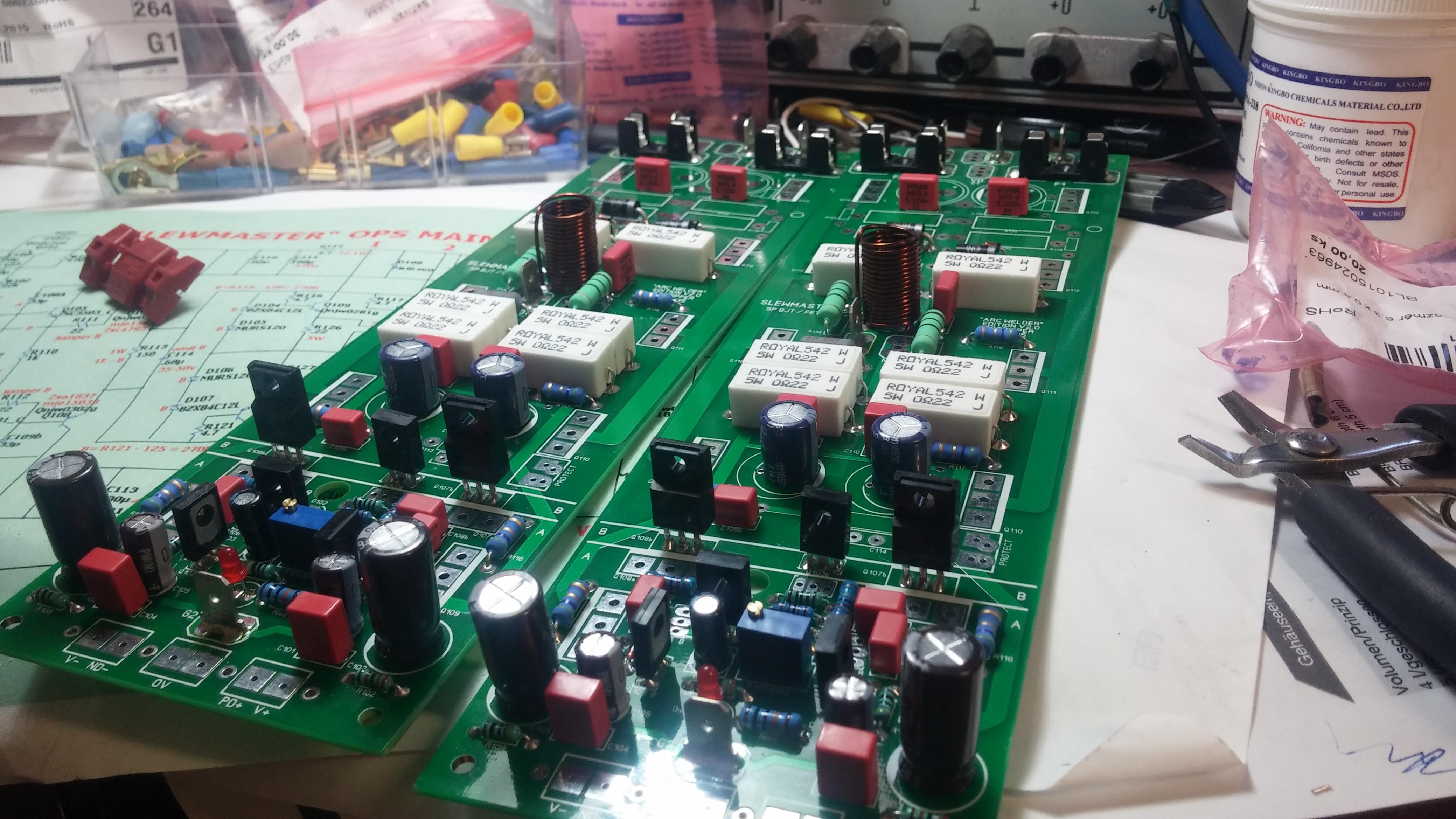

Hi Pete,
I have a couple of questions.
In the pic you posted showing the two different arc welder boards, you have all the emitter resistors mounted, even on the board with three pair of Sankens. Do you have them all tied in somehow?
Also, you have 1/2w resistors installed for the base stoppers. When I run the Ltspice file I don't see anywhere near 1/4W across those. What is the reason for using 1/2W there?
Thanks, Terry

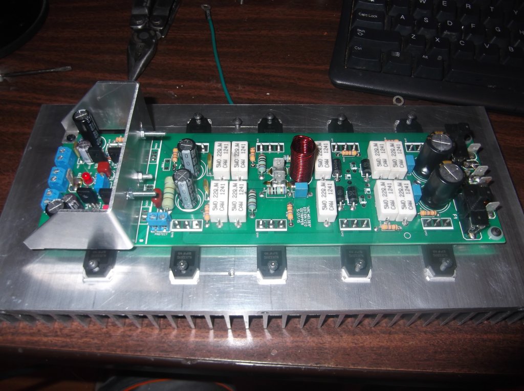

Nope , I was just showing two possible configurations. I would of showed
the "full monty" , but I only have 3 pair MT200.
Both will be my NJW "little guys" (200W).
1/2 W basestoppers - Many things on the slew are way over-rated.
Edit - way over-rated = no thermal cycling with load ...
These resistors could pass closer to 1/2W with a short or 1R load.
1/2W just assures that they will not be a weak link. Use 1/4W if
you like - I just used what I had.
I used the caps I had - 470/100/100 for the electro's , and all
my old 10R's for the 2W resistors.

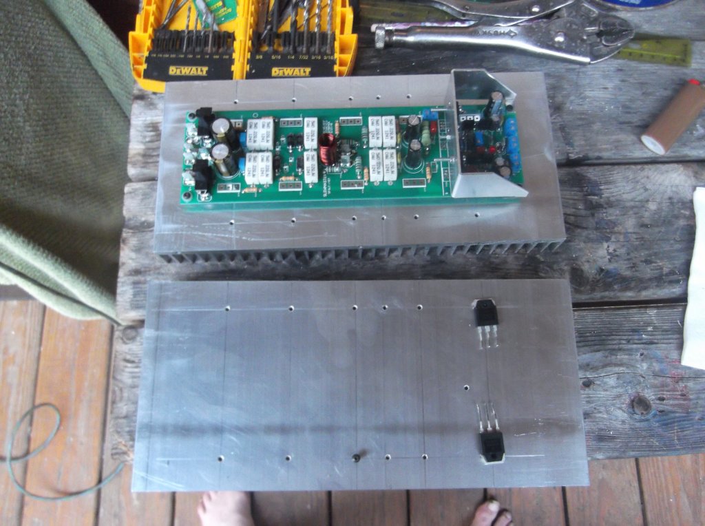

I'm about to tap today - all USA tools - extrusion. Hope it works out.
OS
people will say "it's easy"...but tapping sucks. One mis-twist...the tap breaks and all 19 holes all ready done are wasted time.
There's definitely an art to tapping aluminum. It starts with proper drilling. Heat control is the key. If you get aluminum warm anywhere in the process the tap will bung up and break.
I used to use 4-40 screws and I broke taps too often. I switched to 3M screws and have not broken a tap since. Maybe the finer threads give the tap a little more mass. Be sure to use oil and clean the tap after each hole. It is also important back off 1/2 turn every revolution or so to break off the burr.

All tapped out ...
OH ! I hate tappin'
(perfection - below 1) 100mm distance between rows will allow TO-264
MT-100 or TO-3P , two extra holes for ground and thermal protection
and the main vbe to-126 .... whewwhhhh !
NO broken nothing with all USA material/tools and JW's advice.
In fact , the easiest tappin' i've ever done. Extrusions fit
the Chinese case with 25mm extra space in the front/back .
25mm HW store angle will fit exactly. (below 2).
Now to the part I really really like .... getting it working and
jammin' at 200W !! 😀😀
PS - I need a glass of wine (or shine) after that "stress" ...
