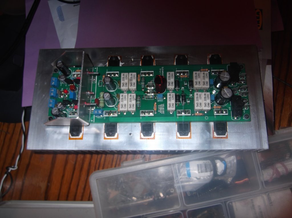

Don't underestimate 1500w worth of NJW's. Thermal conductivity ,
SOA vs. Voltage are the real players.
MT-200's have a much lower conductivity between die and slug.
NJW die is a similar size.
This V3 slew is better just by that fact , heat is dissipated out over more
"acreage". There ... my first "wine" post.

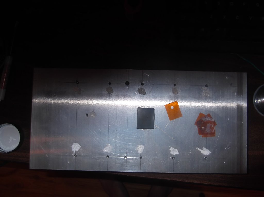

Wine post # 2 -
Even with kapton insulators , ZNO grease will fill in microgrooves on an
imperfect extrusion. Short of polishing , a little grease does wonders.

Can we do the same with irfp240-9240?
OS, That central mje340, in the middle of the HS, did you measure it relative to the pcb or will it run with wires as Terry did it? (or maybe there is an updated HS drilling plan for V3??) Thanks
thimios, I matched gate to source voltage for the irfp 240/9240 parts. I think this is a good idea.

It lives !!
Initial results are good. I decided to throw this OPS to "the dogs"
and just connect to the big 72V (below).
First power bias was 0 (I set the voltage 1.050v before). 3 turns I was
at 12.5mV re (@60ma).
When cool , I got between 11 - 13mv Re down the rows .... evened out to
12-13mv when it reached thermal equilibrium (38C).
The heatsink has ZERO C change from one end to the other - YAHHH !
And it is the predicted few degrees celsius lower globally.
The .4C/W extrusion rating .... my room is 20C (.4 X 45w = 18) wow , 38C !
Cool !

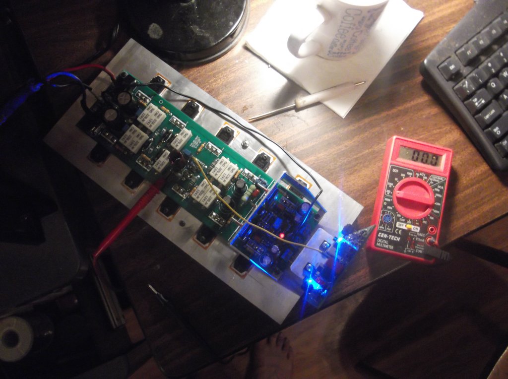

scary time on #2 !
One tip - double check everything. One driver was shorted through the
insulator to the driver HS. Caught that with the meter - a burr under the
kapton.
Then I hooked it up , one output shot up to 20mv real quick . It was not
tightened down (enough).
An observation .... cycled through the warmup the first time , Re mV's
were within 3mv. Turned it off , warmed it up again within 1 mv ??
Do outputs "burn-in" ?
OK , both are a burnin' good. Music tomorrow.
Very interesting to see 5 pairs share the load with equal thermal
conductivity. No middle current hog , mV's deviations are quite
random.
