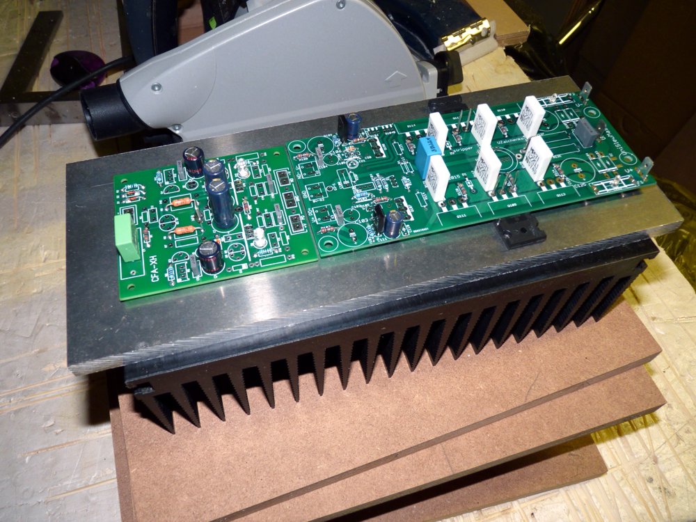

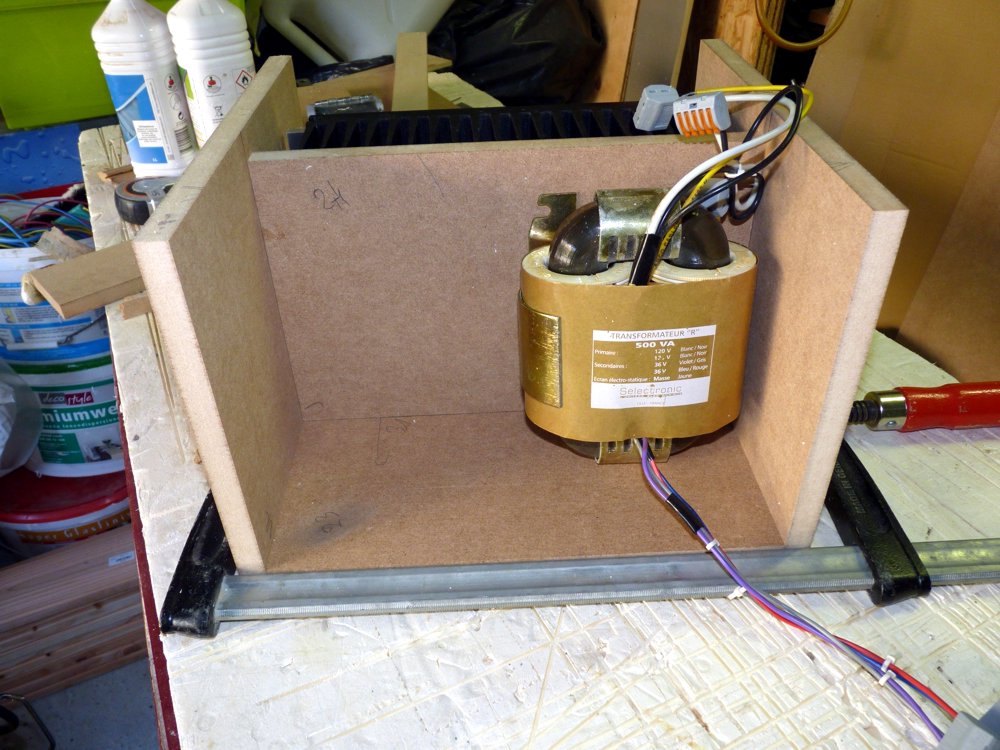

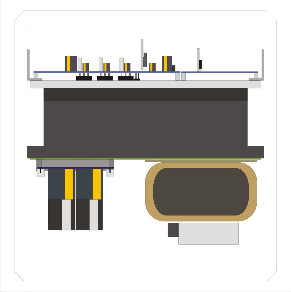

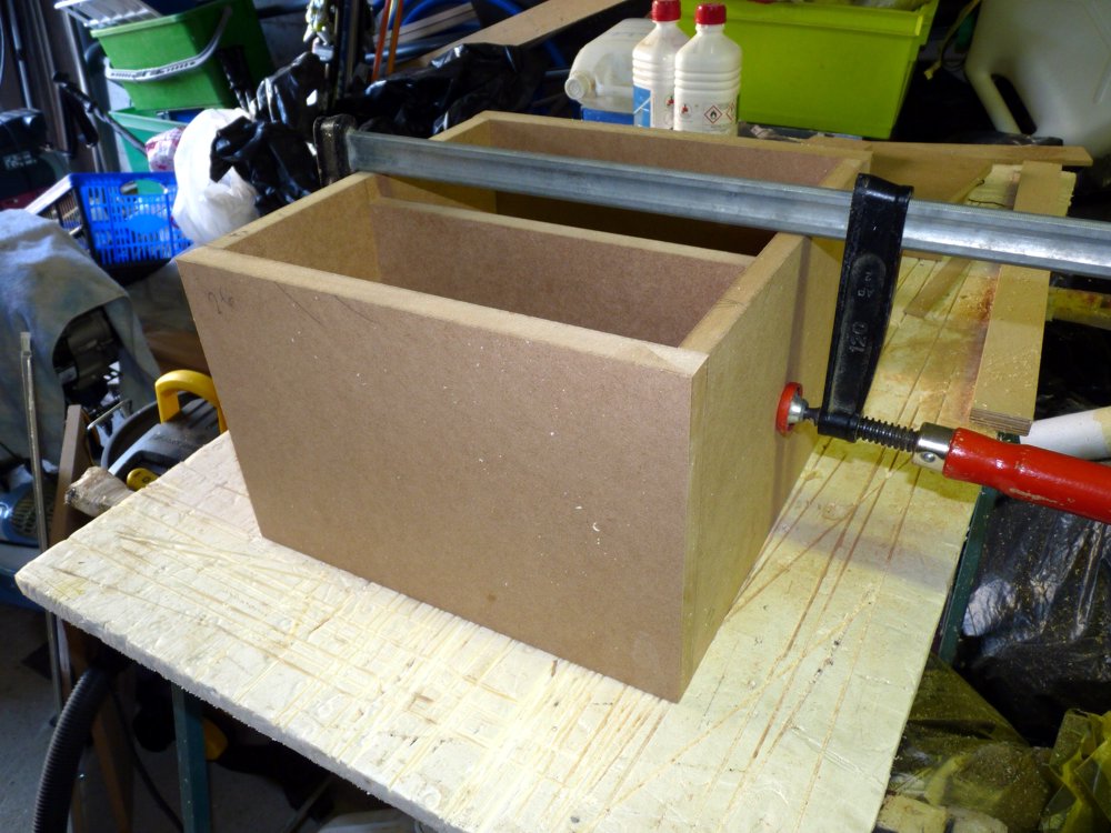

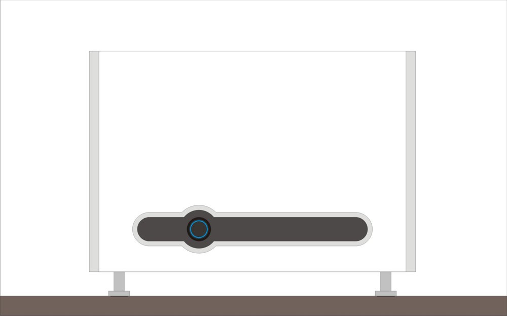

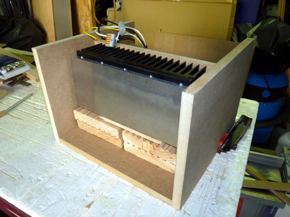

Real life slewmaster build is lunched....I need to purchase some more electoniqc parts so i begun casing build : Project is about two mono bloc with each one Rcore 500Va 2x36V trafo and 18mF-0R2 10W-15mF filtering. For cas building i use MDF that will be primed with epoxy resin and than painted in white with automotiv 2K paint sprayguned. This afternoon i cut the differents MDF case pieces from sheet i had in stock. I join you under the project sketches, and first picture from cases. They need a lot more work before thay can host Slewmaster electronics...

Hi evan did you plan to build some case in the way the work you show in your web pages? I wish i had a little amout of you talent and probably wood work equipement. I love wood work but handling raw wood in a little car basement garage is quite complicated....
Marc

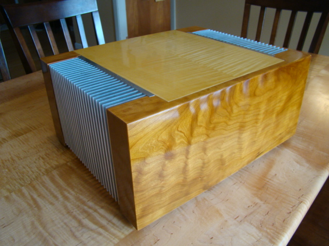

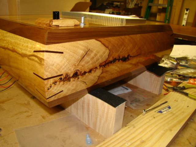

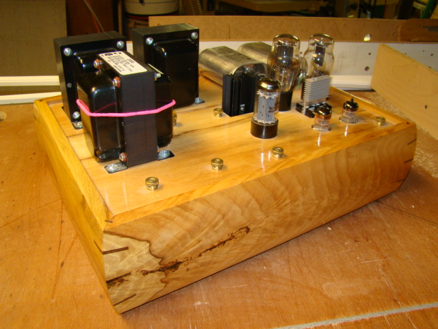

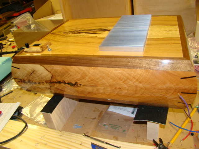

my first few amps had nice case work....Since then I have gotten lazy. I may need to get off my a$$....These amps are worth the time.

The two latest are gorgeus. I always falling in love with those Wood/Aluminum mix. I can't work with raw wood so the only solution for my is vennering but it became quite silly to deal with when i have to handel with cut off in middle of the pieces....

Those last two are the most unique I've ever seen. I could only imagine
what your speakers look like ! 😱
OS

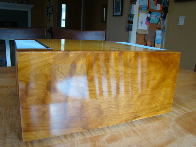

Nice veneer work Evan. I know how difficult that can be. Evan are your cabinets maple, that looks like curly maple in the pictures?

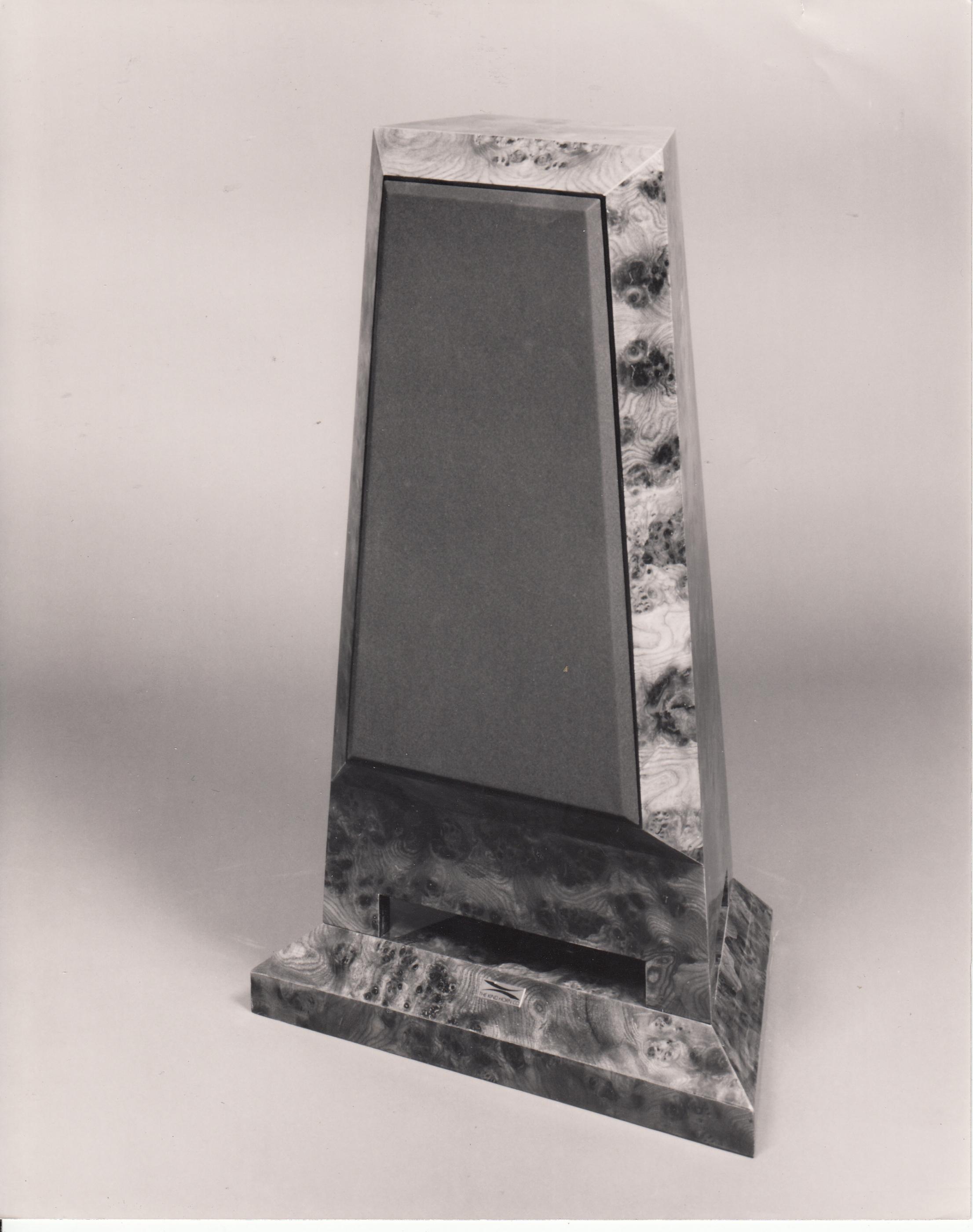

Here is a cabinet I made for a friend of mine, a graphic designer, he needed something out of the ordinary.
Sorry the pictures are so bad. That is Carpathean Elm Burl. Don't even ask the price of that veneer it was insanely expensive.
