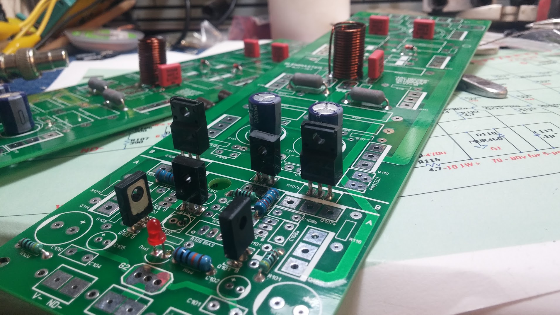

With 3 pair mt200 what would be the ideal transformer VA size and capacitor bank needed for the 250W?
Nice builds
Os,
Nice builds
I'm running my 3 -pair MT-200 on 40Kuf total / with a 400VA ( +/- 65V rails.)
5 pair X 2 on 82Kuf total with a 1KVA (+/- 72V rails).
All 3 amps never are stressed or strained in the least. 🙂

With our huge driver stage , the Cob is no problem and Ft >30mhz is our
target. Might be cheaper just to use NJW ON's.
But the MT-200 package will give better SOA just by it's greater
thermal conductivity.
ANY of them will work , I've had 4 different output stages with 4
types , no difference ?
Driver specs are more important.

I use 1381/3503 - 2sa1294/2sc3263 - njw0281/0302 , I can hook 90V rails
to the thing.
While the 2SA1186/2SC2837 have better specs , you would be limited to
<70V rails.
In real world performance - no difference. Simulation shows that
using a high Ft- lower Cob driver pair can allow the OPS to circumvent
it's 300V/us "speed limit". kypton ND and the failed "infidel" plotted
at 350+ and 500V/us with toshiba drivers. 300V is the limit with
my setup above.
Isn't 300V/us enough ?? That's quite speedy ....
OS
just thinking about Q105/106 2SC3503/2SA1381... is it there some replacement? I can´t order this trans here...
I don't know exactly what you have available there.
It should to be a to-126 (to fit). ECB pinout. A to-92L / to-92
can also be used. Make sure of pinout.
- High Vceo > 250V , lower Cob < 30pf , High Ft >60mhz.
-don't use mje340/350 for Q105/106 , Q101-104 , 340/350 are OK .
Hope this helps. You might have to read a few spec sheets , feel free
to run any choices by me ....
OS
and, question about D102... any replacement? something like 5V/30mA ?
D102 = any red led with Vf 1.6-1.8V. In circuit , it passes about
80% of the input stages Ivas. Most reds are rated >20ma.
OS
