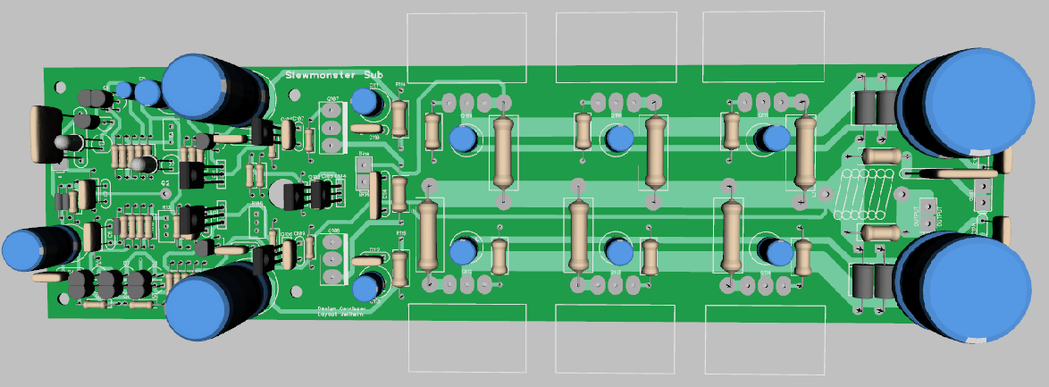

I see you used the vertical design for your output inductor. I like the look of them but mine always end up getting bent. The wood filler is a good idea while working on the amp. I might try that in the future.
The wood core sit in place and isn't just for working on PCB...

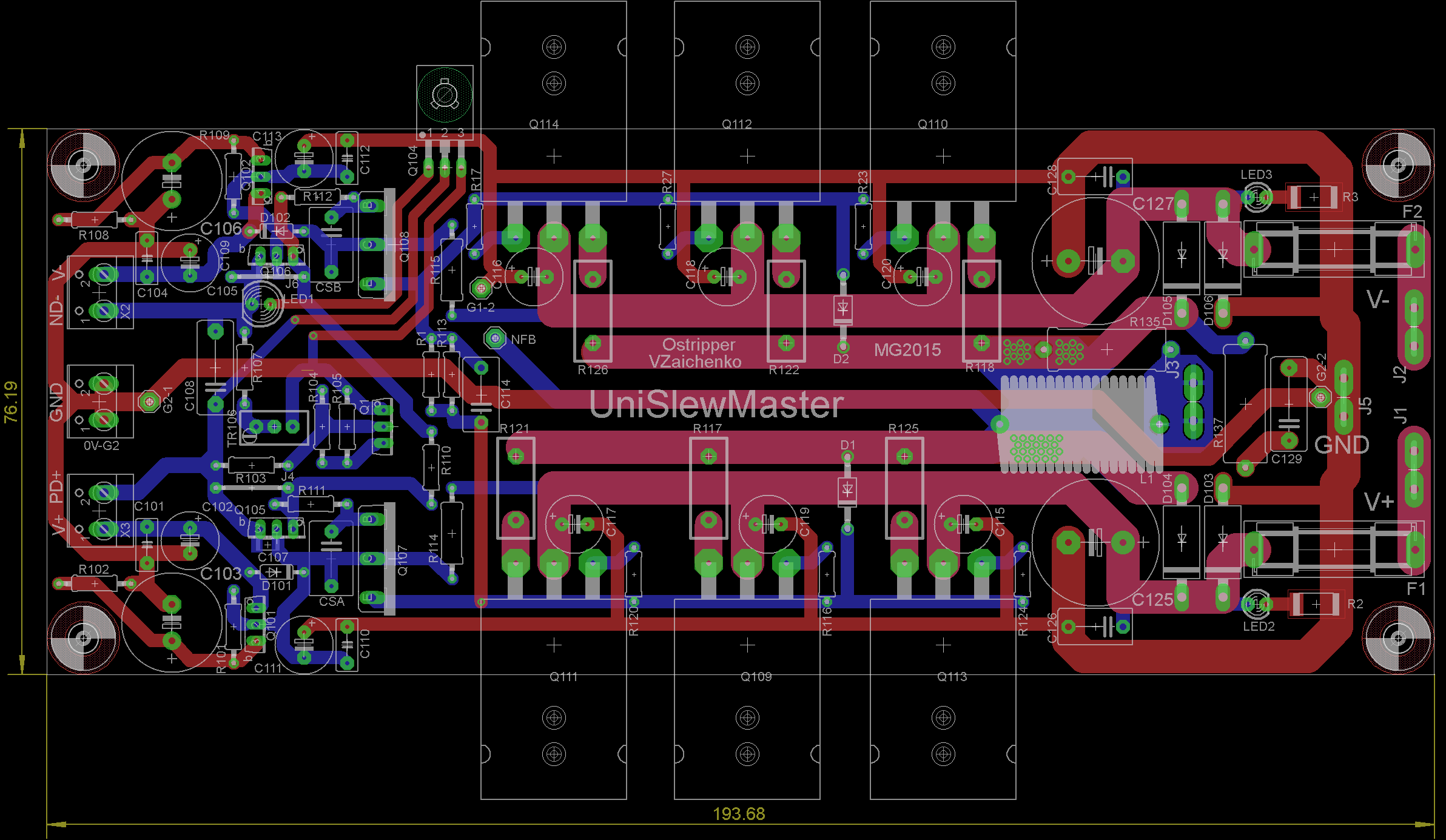

Placing the 22uf near to OP collector is quite difficult in respect of curent flow. Will it an issue to put then a little less narrow collector leg, reduce the number of them (3->2) may be growing their value from 22 to 33 or 47uf?
I put 100uF in mine. This is one time the axial version RE resistor works out better.

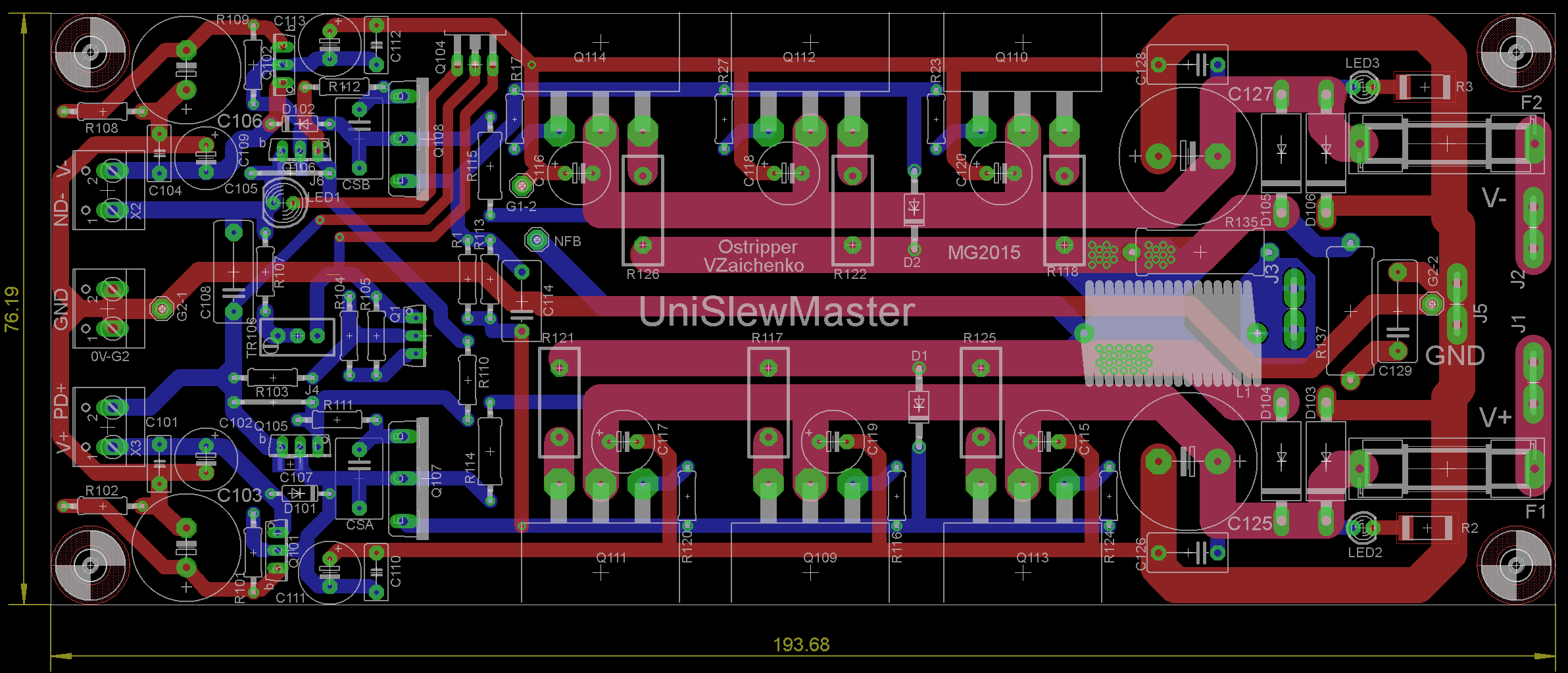

The main caps look much better now. If you could squeeze the ground in with the power rails it would be perfect but there's not enough room for that with those RE resistors.
I'm Jeff by the way. Jason does much nicer looking boards than I do.😉
Sorry for name mistake Jeff. Yes There is not enough room for those ground route with MPC71...but i have a full buckett of them and they are good non inductive resistors...Thank for all advices Jeff.

I've seen other designs where the power rail runs on the top side of the board and the ground runs directly below it. The caps are placed through both rails and connected like you would in a plane. I've always been curious if the two rails would cancel each others noise emissions out or if the ground would just pick up hum. In your application that would require 2 oz copper which would really raise the cost though.
Could an overlay of a thin trace with some 12 or 14 ga. solid house wire be doable?
I've seen a silicon image amp kit PCB with the V+/V- on opposite sides.
Running the rail opposite ground would provide some cancellation of half wave
current pulses for that rail. You would then lose the ability to make a double sided
20A+ Xmax rail ... another trade-off !
But , I have noticed it is the circuit "behind" the initial driver/predriver decoupling
that is sensitive to EMF.
Anything radiated by the typical OPS layout is in "good company" with the
inductor , twisted triplet , and being in close proximity with a trafo (in a
typical chassis layout).
For MT200's or a 5 pair setup .... greater thermal spacing is ideal.
The MT- 200's have a larger heat spreader -- with 3 pair , it tests ideal.
If you were to have 5 of them , that's a LOT of dissipation ! (2300W of
device). Spread this as far apart as possible.
Edit - the accuphase and other "esoteric" high current amps have NO
rail traces. They run a stamped copper bus across the top of the board
soldered at each output collector pad. Sony 5 channel HT receivers do this , as well.
OS

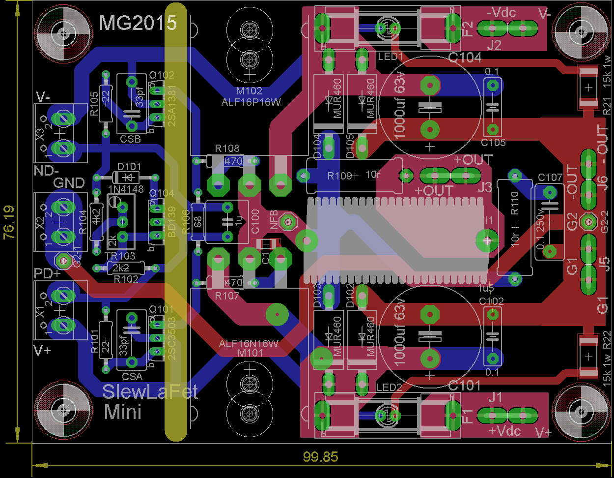

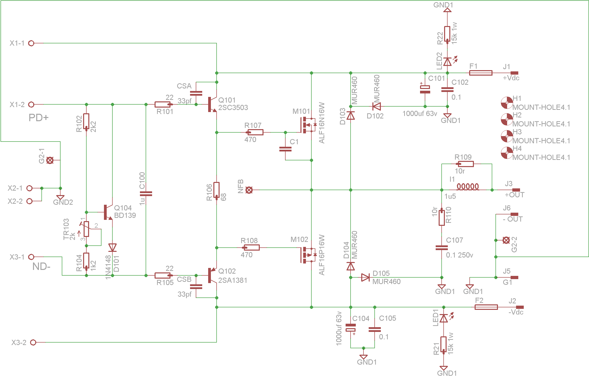

Hi all, i have some questions about latfet slew version. I redrawn layout to be abble to use AFL16N16/ALF16P16 double die version. I suppose doubling die means reworking biasing but i unabble to do it. Could some one advise me. I would use this OPS with +/- 42 or 50Vdc rail. I join you the schematic and the redrawn layout.
Looks like the ALF16n16w is the same pinout as the Renesas devices so I'm confused as to why a new layout is needed. What am I missing?
What you mis is that AFL16x16 is a To264 package as Renesas are To3p so smaller but with same pin pattern. You can see on my layout 2 hole per To264 package=> the second hole is for single die version => similare to To247 package.
Marc
