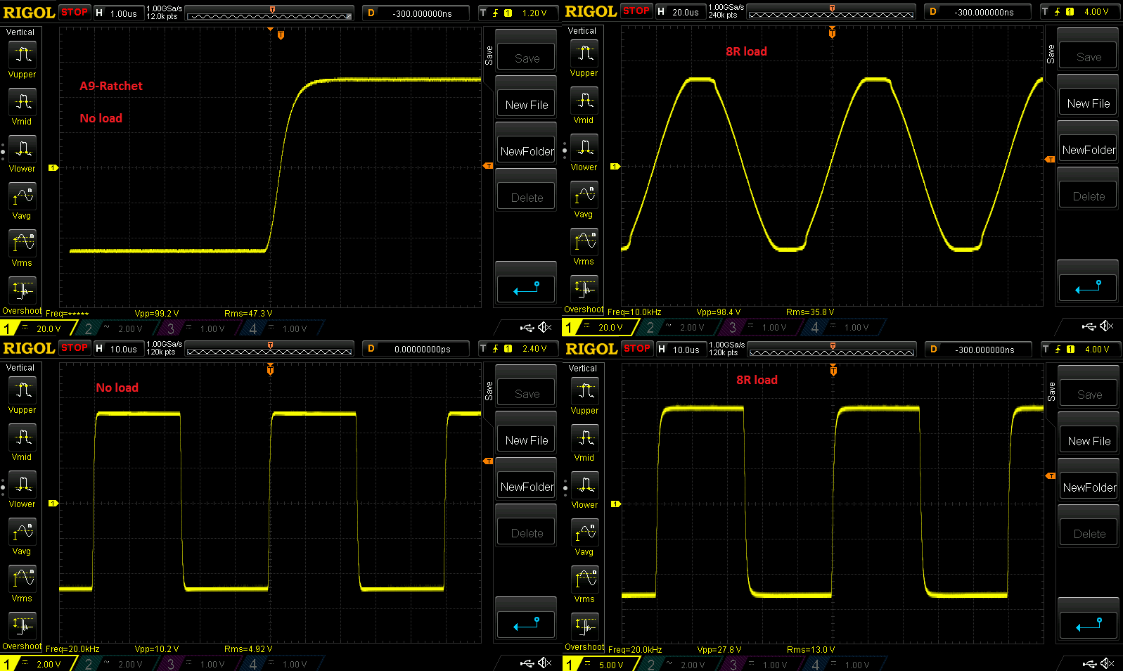

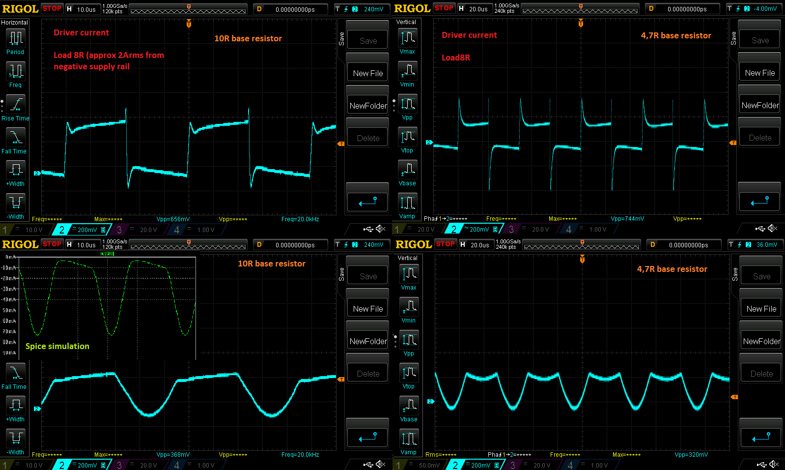

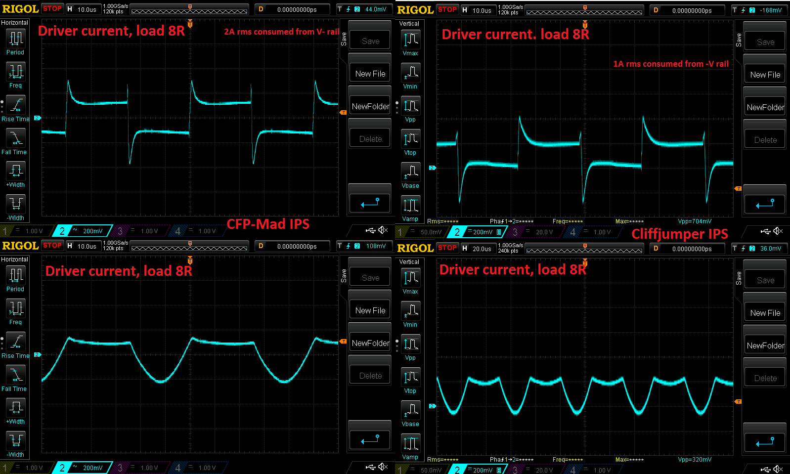

Some tests results as promissed.
I was doing fallowing tests:
- current consumption at fast square waves with load and without the load
- driver current tests
- capactive load test (8R + 0,47uF)
I found that fancy R22 resistor is causing driver instability at the fast transients. Above 50kHz there is a point where current is rising rapidly.
I have changed the base stoppers to 10R and all bad stuff is gone.
I did not have any flames or explosions ( huhh) but I think here was the problem.
I have applied square at the input of the amp, load 8R and I have adjusted 1A rms current (and than 2A rms current) consumed from the one of the rails. Than I was increasing frequency, from 1kHz to 50kHz the current have the same value and at 100kHz is 1A + 20mA (according to my meter).
Please take a closer look at the driver current wave formos (load 8R), the spikes are much lower. I do not understand all mechanisms here (driver current with sine wave - 2 bottom pictures), but it looks better anyway.

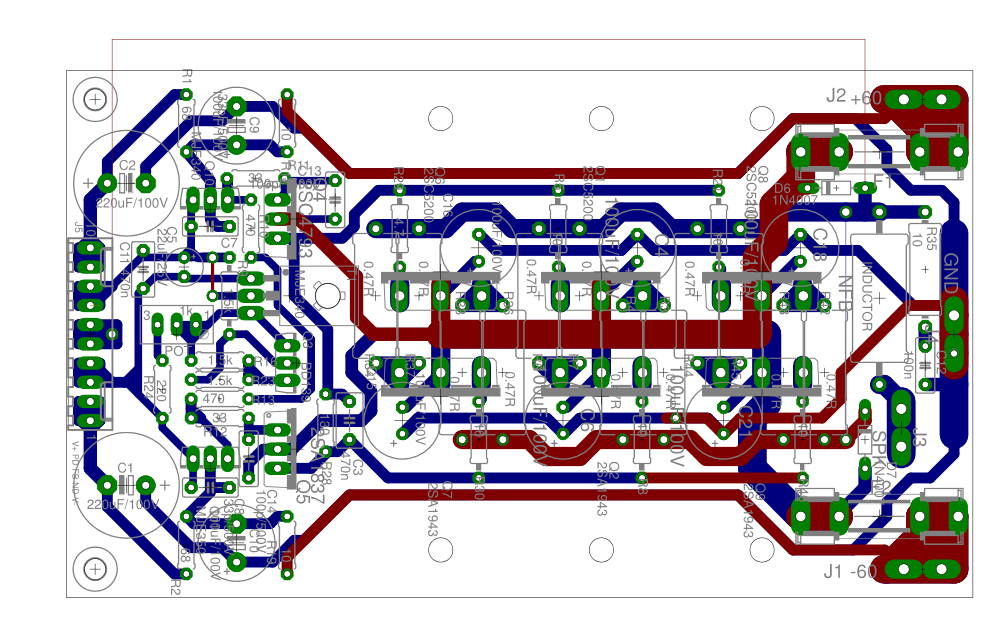

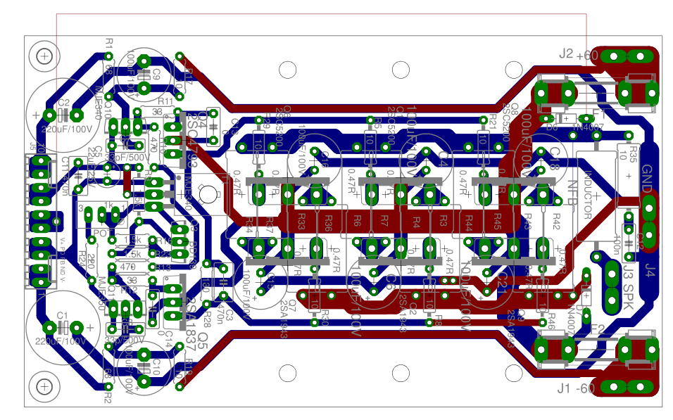

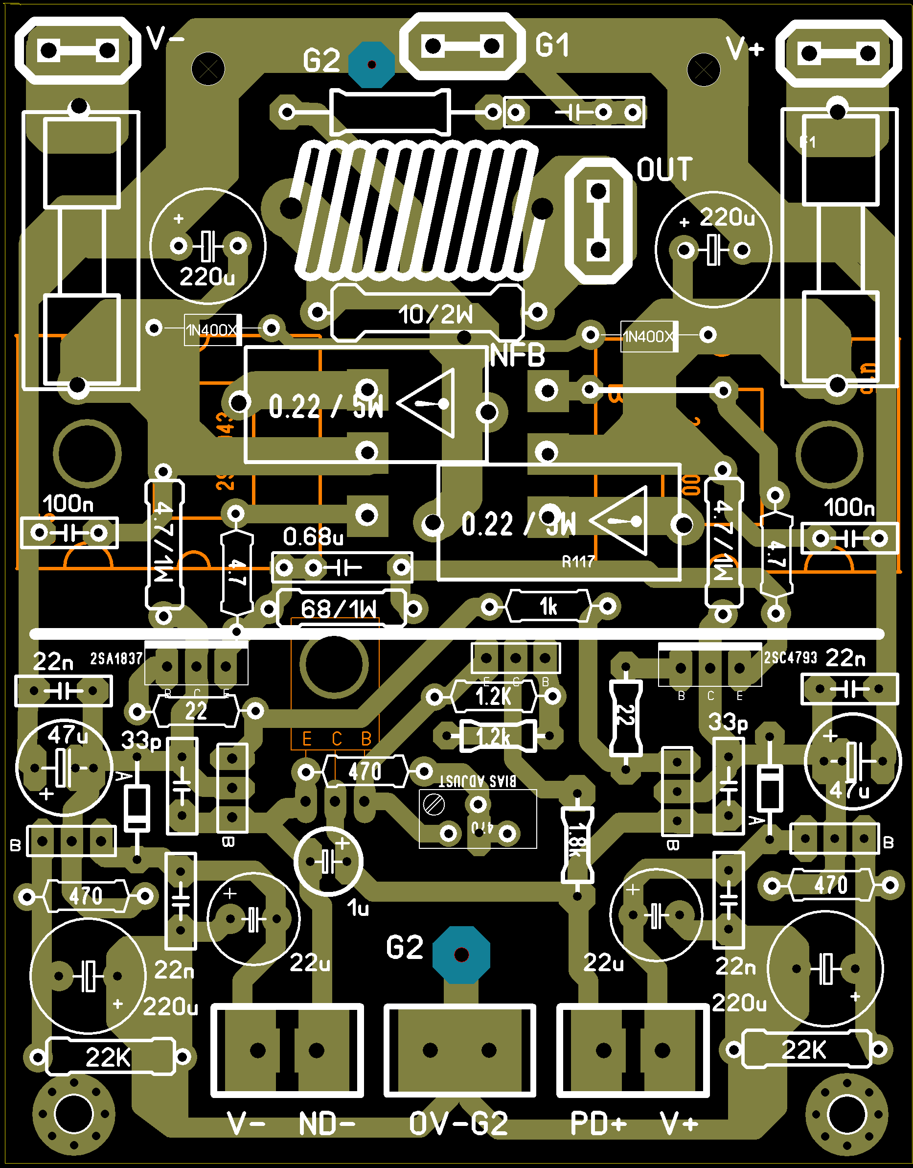

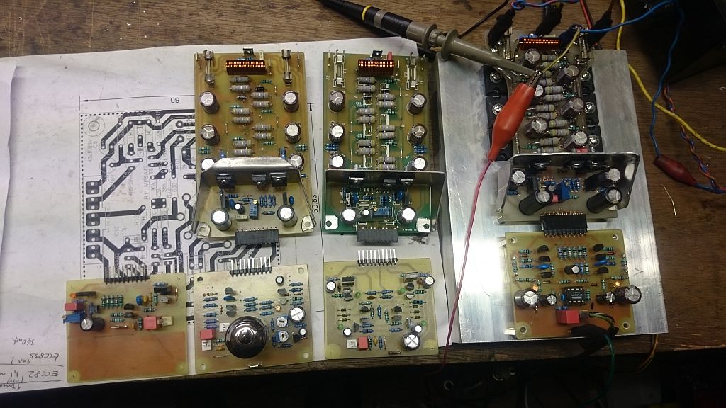

I made a single pair output stage based mostly on Ostripper's layout. I cant tell if layout meets all proper rules for good stability and performance.I would be gratefull if anyone is interested in giving it a try and test it with an oscilloscope. it is about 10mm x 7.9mm
I have finished up the board with motorola output (10R base stoppers). Amp is playing whole morning (couple hours so far). All looks fine, the driver current curves are looking a bit differend than on toshiba OP transistors (the input capactance of the OP transistors make's a difference I think). I have checked the capactive load too - all is fine.

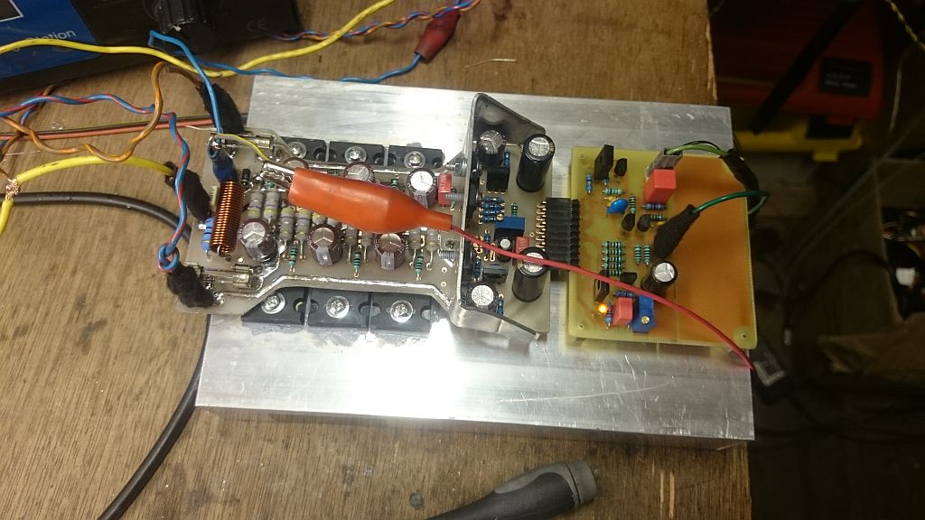

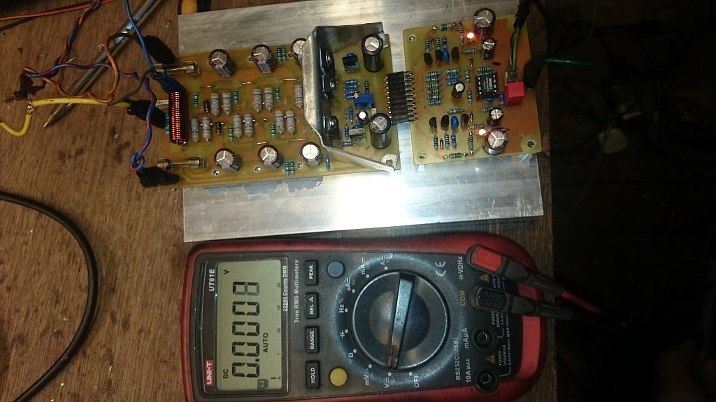

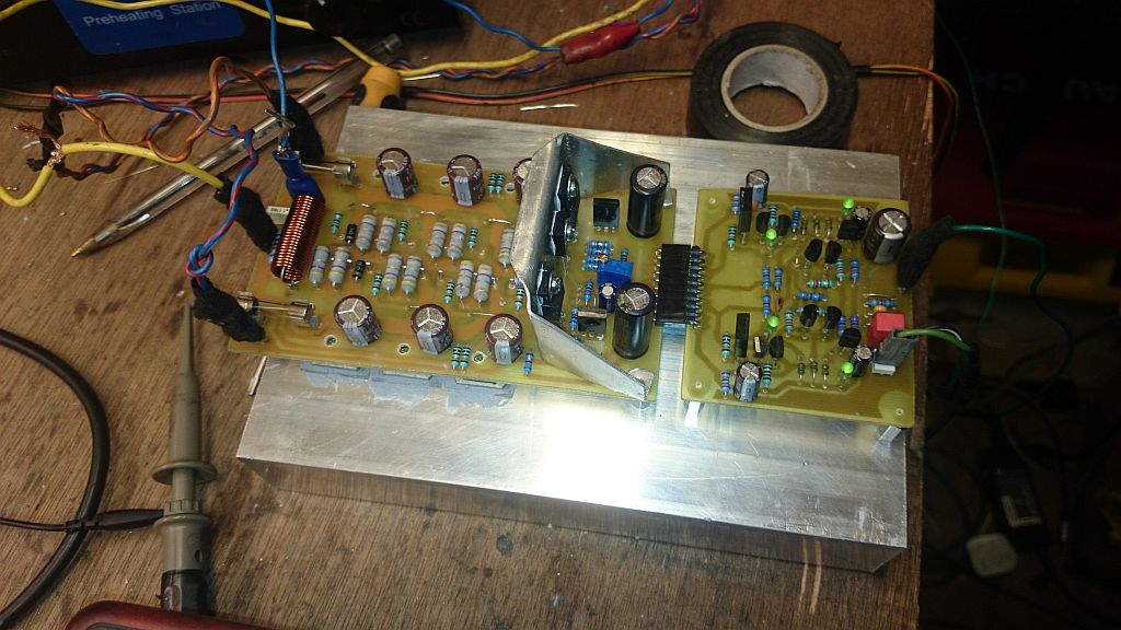

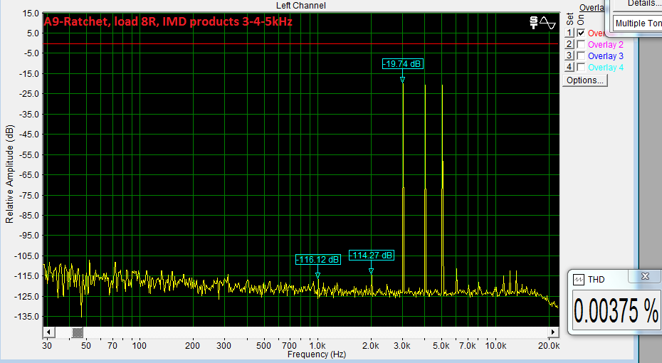

I have soldered together the apex A9 IPS (A9-Ratchet, small and easy). I have lovered the front stage bias to 1mA, inserted double to92 VAS (6,5mA total) and added RC network inbetween the 15V zener supply.
Sound is really good with OPA2134 as an input amp. The offset is bellow 1mV all the time and servo is fast (220kR@10uF). The IPS is playing with new board anyway.
I am so puzzled why Terry's board is making troubles. Maybe the NFB rute is a bit differend ?

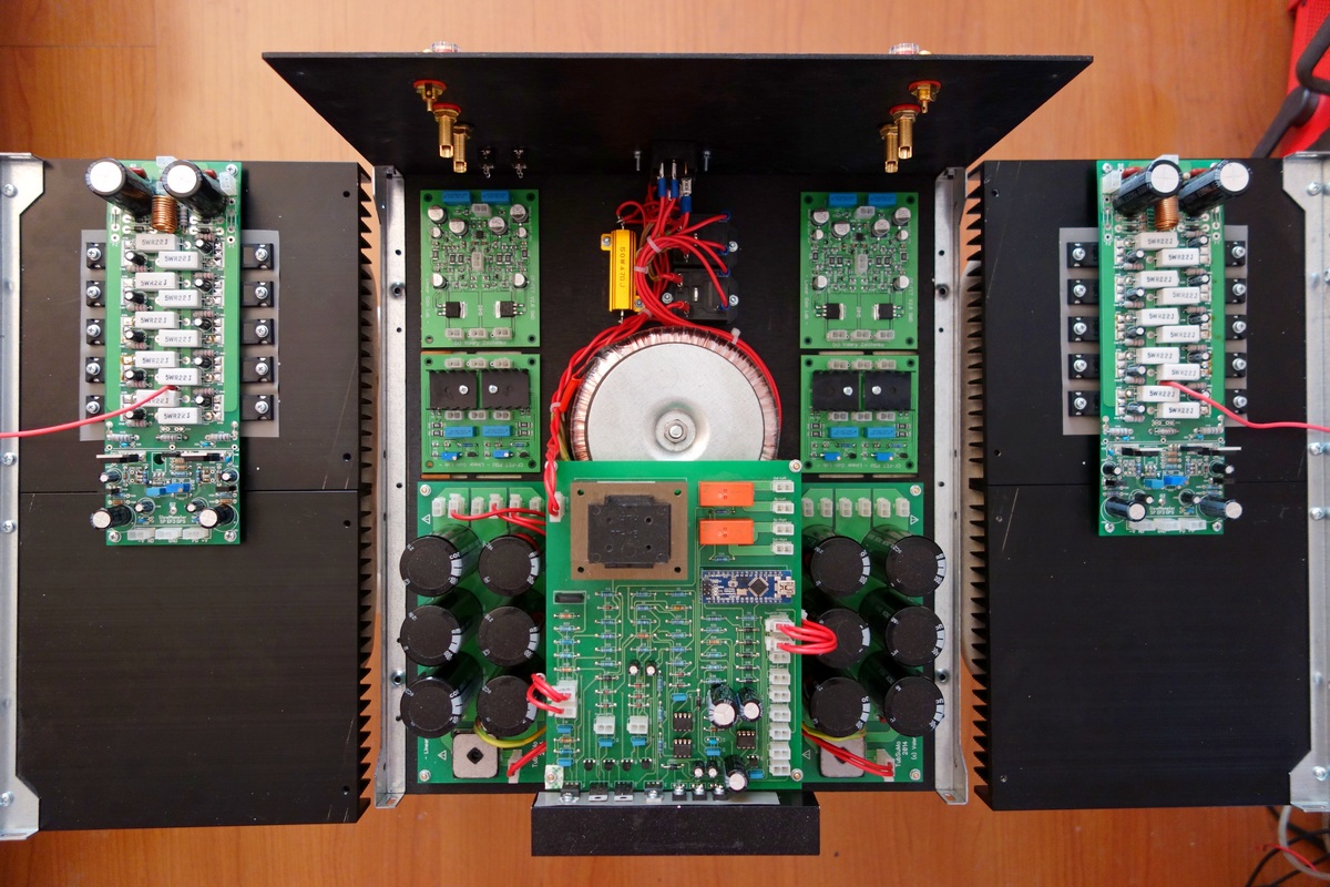

Good!OPS boards are finally on the "production" heatsinks 😎
The holes were drilled not as precisely as I expected, but acceptable, and what I really like - it's done.
Time for some more wiring. Fat wire is in stock already 😉

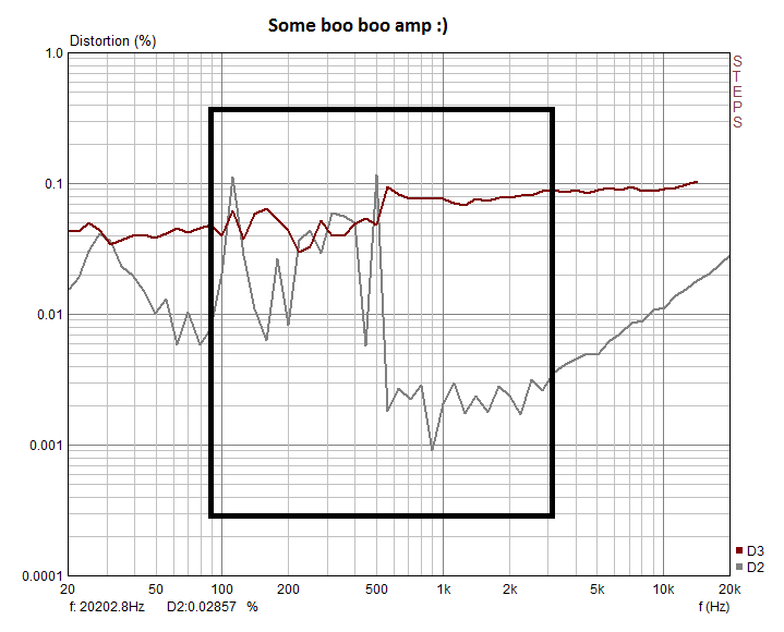

Hi borys ,i can't understand why STEPS graph is a linear graph.Are you sure that is with load connected?I have finished up the board with motorola output (10R base stoppers). Amp is playing whole morning (couple hours so far). All looks fine, the driver current curves are looking a bit differend than on toshiba OP transistors (the input capactance of the OP transistors make's a difference I think). I have checked the capactive load too - all is fine.
thimios

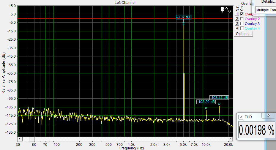

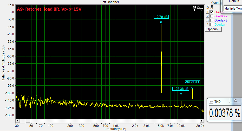

Yes the load is connected, the graph in STEPS looks linear but at higher F the distortions are rising up a bit. At the higher amplitude THD is rising too, but amp sounds really OK.

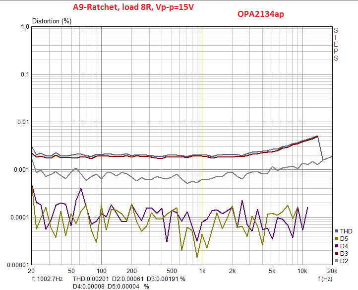

I am doing STEPS graphs to see if the amp has the same harmonics spectrum threw all audio band. Take a look at my setup bellow (you can see the ''linear'' graph on the laptop and 8R resistor and the clamp meter).
Sometimes thd graph is showing some design problems. For me THD figure does not mater much but I like to test it anyway to confirm that all is ok.

I will make double layer OPS prototype just for my learning process, heavy current track are as close together as possible. The PCB can be cut to make more room for the OP tranies.

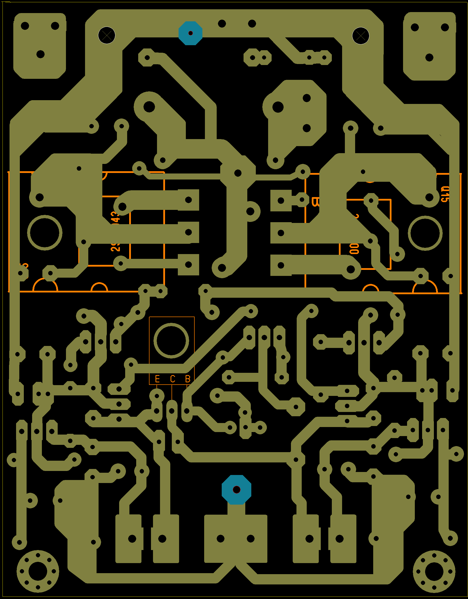

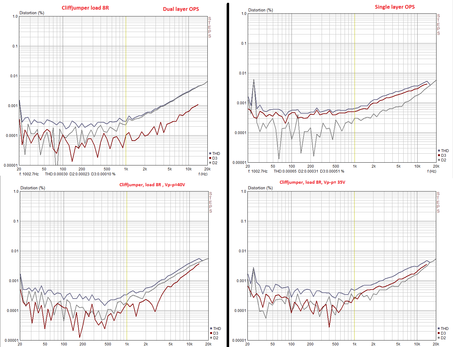

I got the dual layer small OPS up and running, the performance has improved a bit (I hope)
V+ and V- rails are as close as possible, small current tracks are screaned with ground track now, ground returns are separate, speaker GND is taken from the main PSU (as in apex amplifiers). Transistors are easy to mount now.
The only problem is that the board is not easy to make.

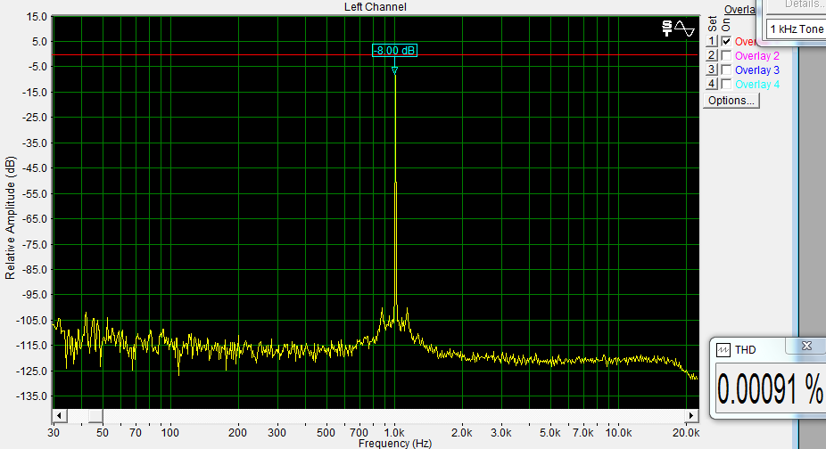

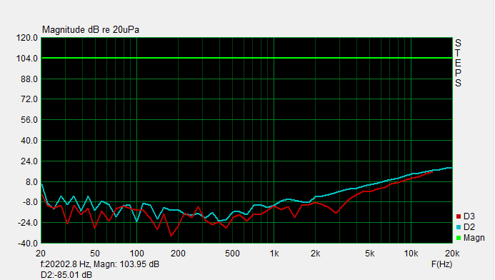

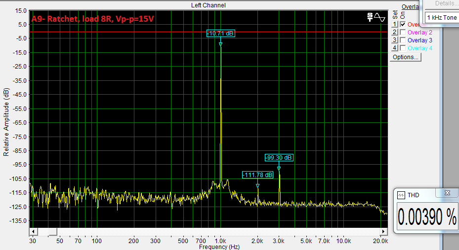

Bellow few screanshots from Cliffjumper (99% finished edition). THD measures are taken with 8R load and 15V Vp-p.
