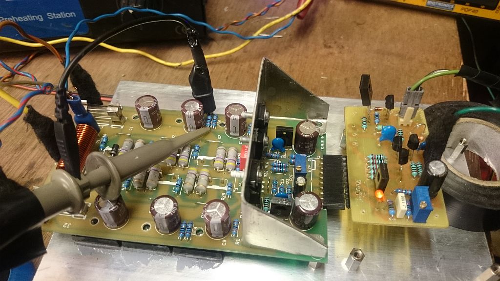

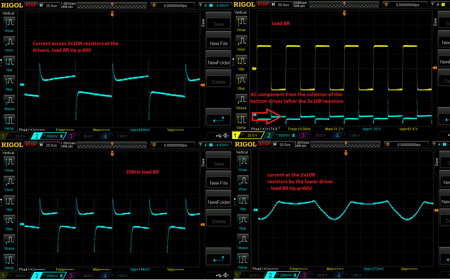

I have done some measurements today. Maybe not 100% correctly but it gives some picture (or not?).
I have plugged all stuff as build and than I have removed the R13,R14 and R22 resistors (predrivers base stoppers and fancy Vbe resitor), and I didn't spoted any diffrence.
I have also replaced 220R resistor biasing the drivers with 180R and there is a bit of the improvement --> the outputs are switching off quicker (current measurement with no load at fast square/sine waves).
The one thing spotted --> the fancy Vbe resistor R22 really works, the OP bias vs VAS bias is more stable with it. But this doesn't matter now.
But all stuff was done with Toshiba OP transistors.
Now I am making second board for the onsemi transistors with few changes:
-more air in between the tracks
-separate ground return for decoupling caps
-separate ground return for RC networks
-less copper at the low current part of the PCB (smaller copper track area schould help here)
-added second resistor for biasing the predrivers --> so the bases of the predrivers will see less of the copper track
-added spaces for Miller caps at the drivers (just in case)
-removed base stoppers at predrivers
I really tryed to see the fire (like in Ed Sheeran's song 😛) but no joy.
I was thinking about ''fusing'' the drivers and OP transistors together but to check it out I will need the board with the problem on it.

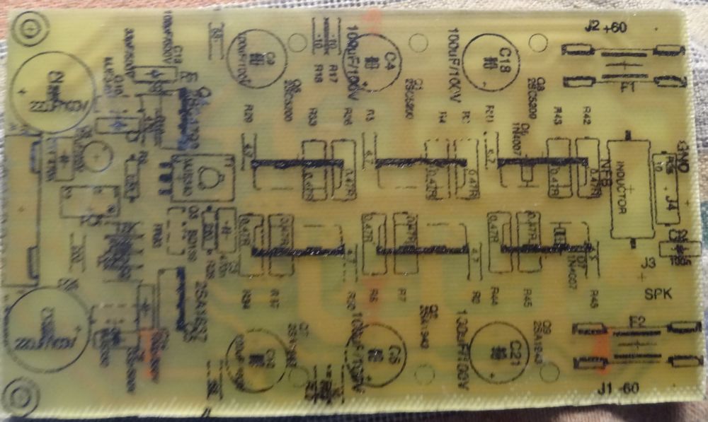

I will make this board with MJL outputs anyway - I am well puzzled really.
The thing with the fuses can be easly checked --> You can throw the fuses away and putt the jumper instead.
The files are bellow. I have changed the base stoppers to 10R (many amps are using 10R stoppers).
The 100pF caps at the drivers will not make any damage.
Tomorrow I will solder the resistors instead of fuses to simulate the bad connection so If you can wait till tomorrow I will know the answer for that questoin and the layout can be redone in 10s.

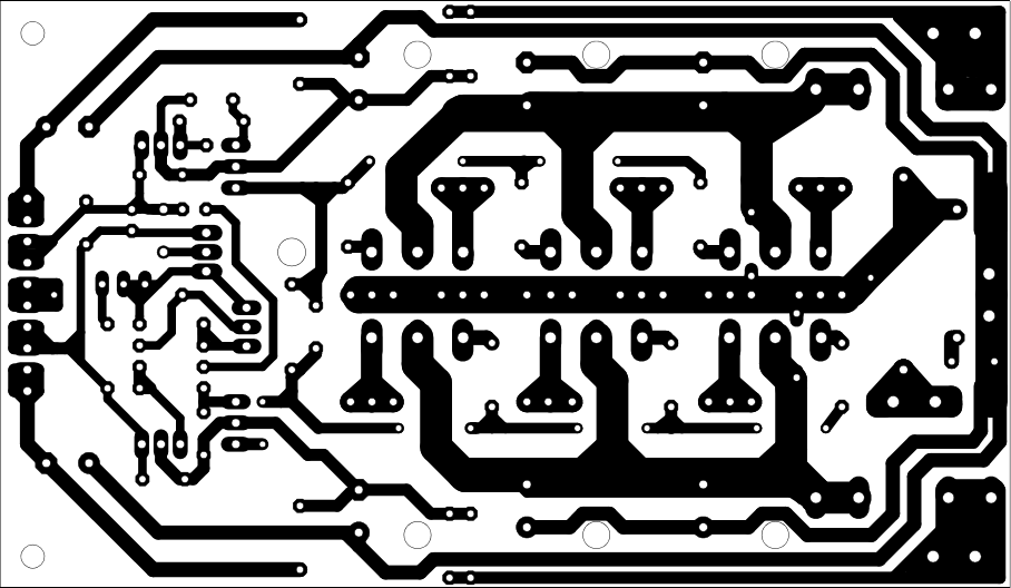

I have moved second RC network behind the drivers. New files in atatchment.

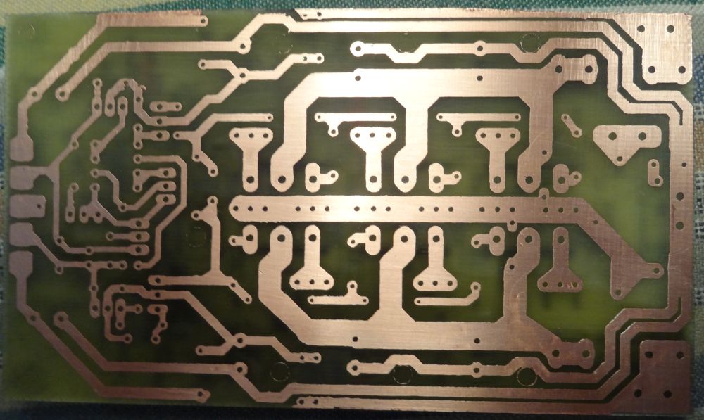

Borys, here we go again.

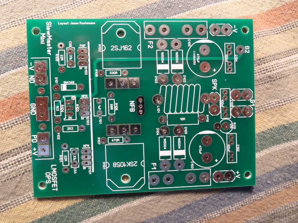

Thanks Terry,
So how is this board you are working on now different than that besides the board layout? Is that single pair enough to drive you pair of JBL speakers to a decent level?
I built the little Latfet board before Jason narrowed it and it drives my JBL's just fine.
Borys' board is slightly longer and slightly narrower. The good thing is, with the three pair it can handle +-60V maybe more.

Thank you again Terry. I'm guess just by looking at the proportions that Jason's board is about 3" x 4"? That is nice that Borys's board will take three pairs of op devices. Not much bigger in length and definitely narrower. What is the board size on Borys's boards?
Jason's board is 7.6cm x 10cm and Borys' board is 7cm x 12cm. Jason's was 3"x4" but I asked him to trim it down to 10cm to meet the limit for the prototype discount.
Terry,
Could you point me to the schematic for that mosfet mini OPS?? Thanks
Hi Carl,
You can find it in post #181 in the group buy thread.
