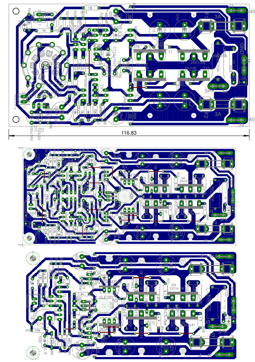

Am I mistaken that the difference between the output section you are now having trouble with and the Slewmaster is just a change in layout with the output devices moved closer together or is there some other changes to the circuit? Trying to follow along with what you are doing and wondering what other things besides layout has changed. Great work as always, I think I would have been a bit discouraged after a few sets of resistors went up in flames but you just keep on going. Thanks for letting the rest of us in on what you are doing.

Hi Kind,
The main differences are change in layout, TO-220 drivers and no cap multiplier. I am doing this mainly to learn so getting it working is important lest I learn nothing. Hopefully others will benefit as well from the process. Since all of the bonifide Slewmasters have been well covered and OS hasn't released another one yet it gives us something to work on. The two IPS that I just built play very nicely with the Slewmaster ops. This ops is a really nice size for someone who is limited in height as it is less than 3" tall. Bimo says his works fine so I must have done something wrong. If I can find the problem, it may help me in the future should I see this symptom again.

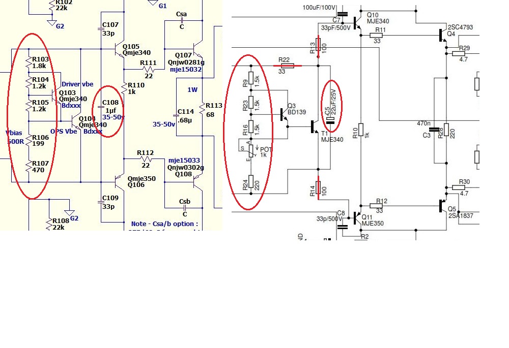

After playing about in the simulator I suggest actually reducing the base stoppers in value. I was finding a peak when the base stoppers were too high. I have settled on output stoppers as 2R2 and driver stoppers as10R in the simulator I used 2R2 om my SlewMasters to good effect. Also stoppers in the pre-drivers don't help anything and actually make things worse, as ostripper has already mentioned. If heat is manageable you could also run the pre-driver and driver a harder by bringing down the values of R10 and R28, maybe 470R and 120R respectively. That can also help to settle things too by getting the device's into a current range where their gain is more linear.
Hi Jason,
That's interesting. My Slewmasters use 4R7 per the schematic without issue. I can't find the schematic I used for the 2p ops. It uses TO-220 drivers so those values should work on this board. I will try the values you have offered here and see what happens. Thanks again for your always kind help.

Thanks Terry, The reason that I am very interested was because I do need to use a narrow package and this looked like one way to do that. I was considering having the output devices perpendicular to the main board on the normal Slewmaster and this way that isn't necessary. What was the intention of removing the cap multiplier if you know? I'll keep watching and see when you solve this problem. This output with a Krypton-C type input section would be as close as I think I can get to a smaller package. The 2p Slew would be my other option with the outputs turned 90 degrees from the board.

I have made another layout of the small OPS board (more air in between the traces and as advised I have removed few resistors). Will post it on Thursday.

If everything else looks good I would solder 100pF B-C caps at the drivers and see.

Terry Have you tryed to solder the 100pF caps at the drivers? I will solder MJL outputs and see why it is killing the drivers. Slewmaster uses 30mhz drivers with 400pf cob, the to220 drivers are 100MHz and very low cob. Worth of trying.

I have made several amps with this layout (but I have used compensaiton caps at the drivers with EF3, the top layers bellow). One of them is playing music every day at my home. I am looking forward to back to my lab.

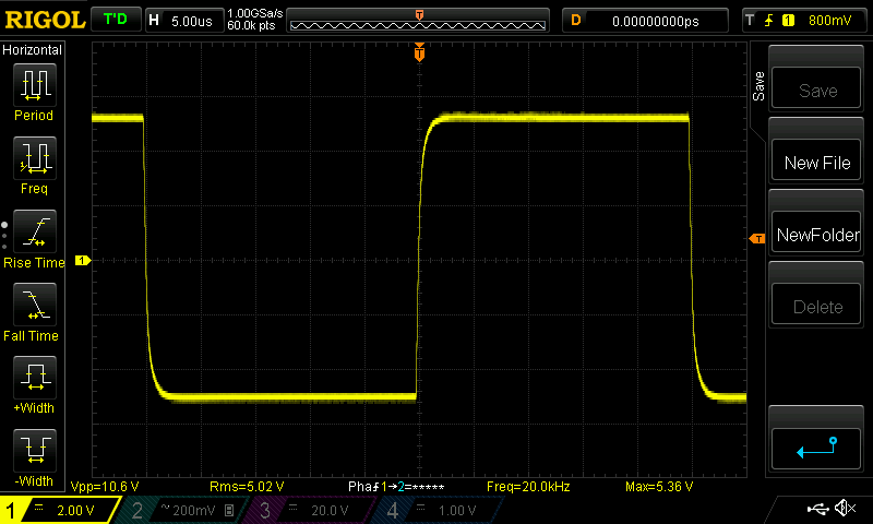

I am also wondering why You are getting a bit overcompensated resaults form cliffjumper, please take a closer look at my scope reading at 20kHz@8R load, doesn't look as rounded. Heh there will be no sleep at all next few days 😀

The "father" of the slewmaster , (the HK680 EF3) uses the 4793/1837 pair !
I have 2 amps with 35mhz Ft drivers and 2 more with 60mhz Ft devices. ALL
are perfect with the 4 IPS's I've used. These Sanken's are also between
400p and 150p Cob.
But , all 4 amps use 1381/3503 predrivers (5-10p Cob).
1 amp also does not have the multipliers (my sub amp) - still perfect.

What about the large cap across the vbe multiplier? 1u on the Slewmasters and 22u on borys'? Could this cause the lockup?
