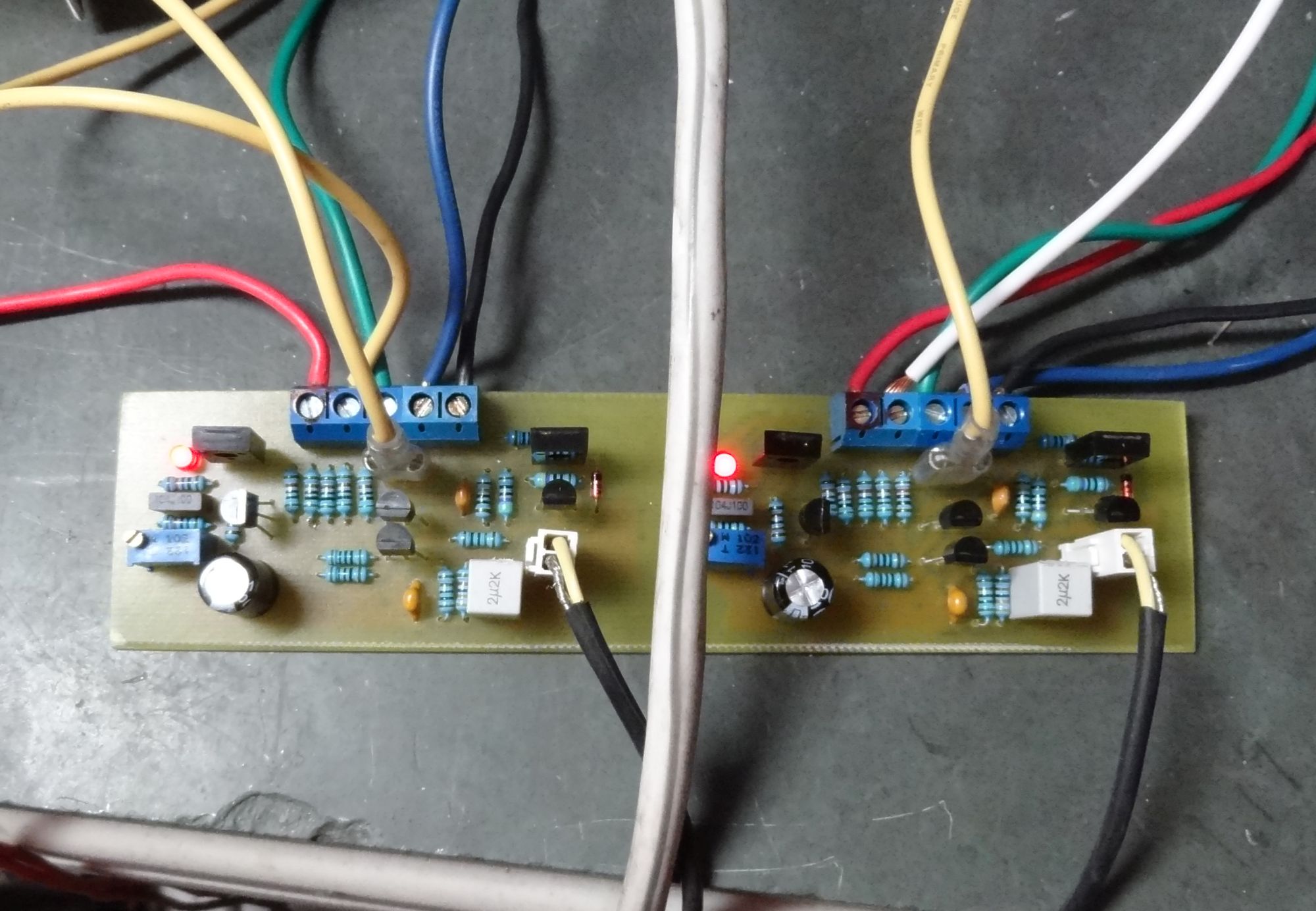

Ready to populate. I changed the layout slightly to better match up with the Slewmaster.Bellow 3 IPS boards --> files for thermotransfer, the 4th one Ill check after my holidays.
There is still some work left on all of them but they are safe to solder anyway.
IMPORTANT --> tube IPS is causing full DC at the output of the amp before cathodes are heated up so it can be used only with DC protection circuit (it needs approx 5-8s before NFB starts to correct DC).

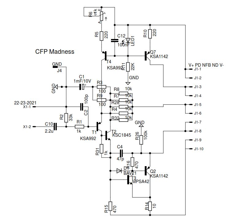

The CFP-Mad, was tested on +/-45V psu so far.

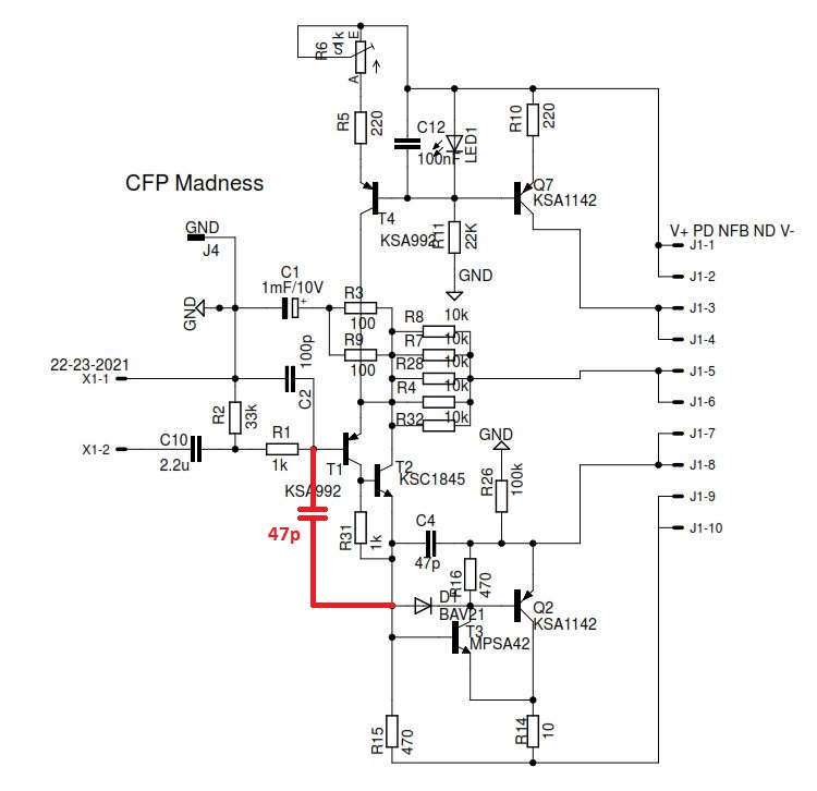

The CFP Madness is singing but it has a little oscillation. No oscillation without a load.
I'm open for suggestions.
One note, the schematic calls for KSA1142 and I used 2SA1362.
Thanks, Terry
Thanks, Terry

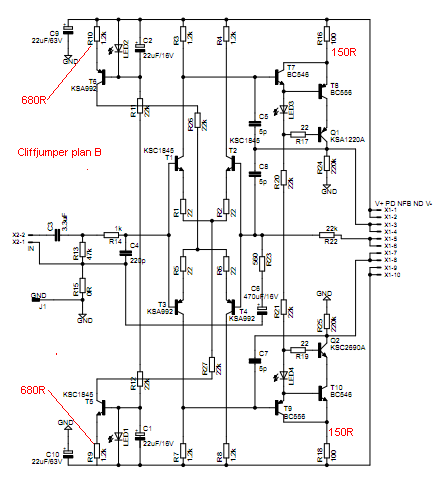

The Cliffjumper --> the LTP's at the front are very low biased (approx 1mA total 2x0,5mA), use standard small diode with forward voltage drop around 1,8V.
There is plan B for that IPS too but not tested yet (pic bellow)

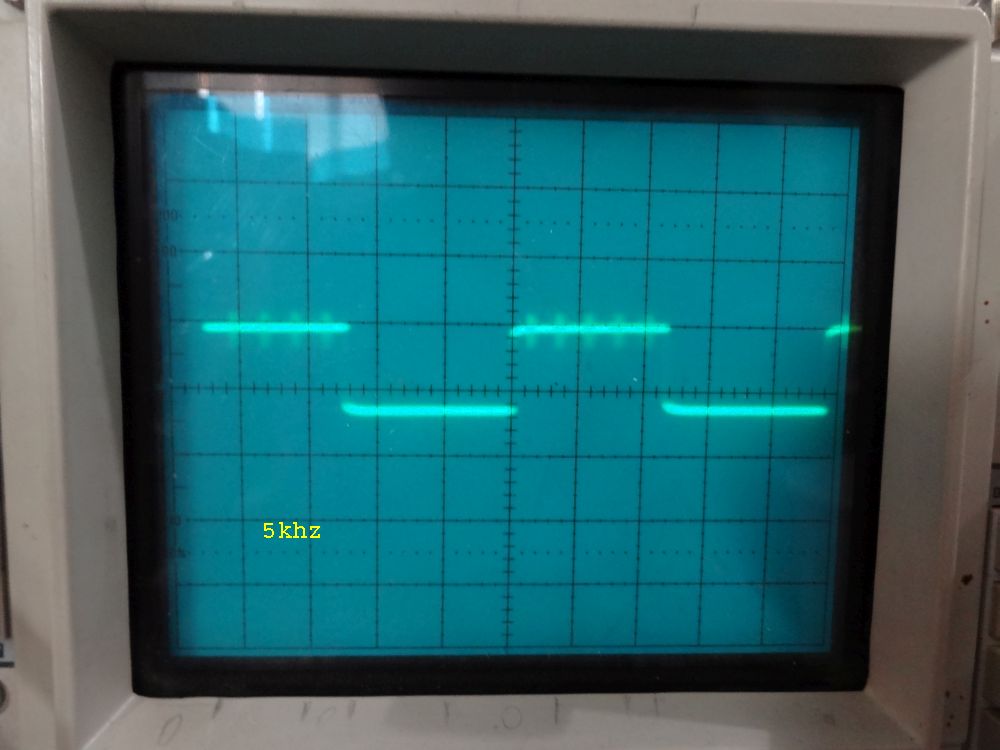

Hi Terry,
I would add a cap like this to the input pair and see if it reduces those HF spikes.
Valery

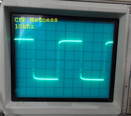

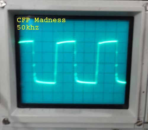

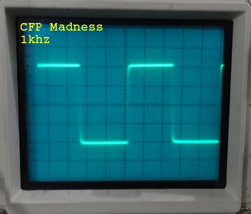

Hi Valery,
I installed the 47p. I'm attaching a 1k scope shot.

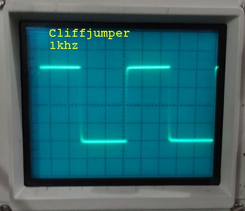

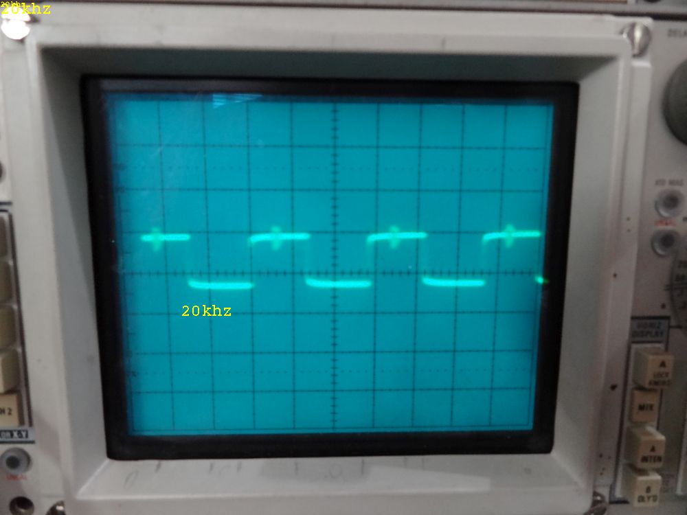

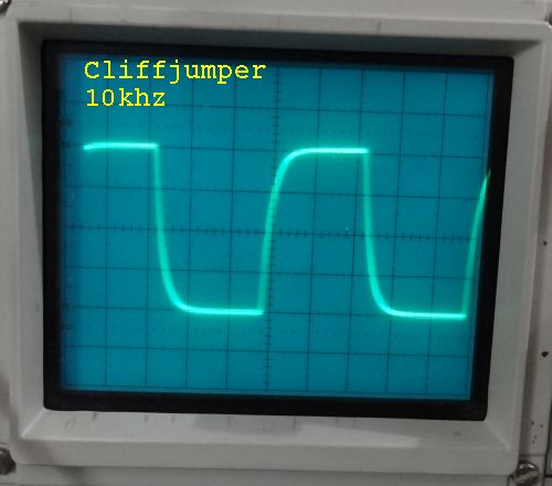

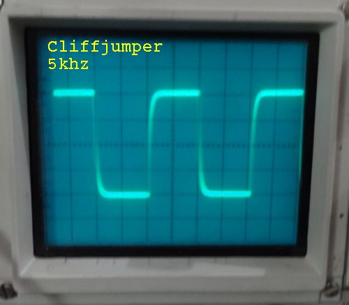

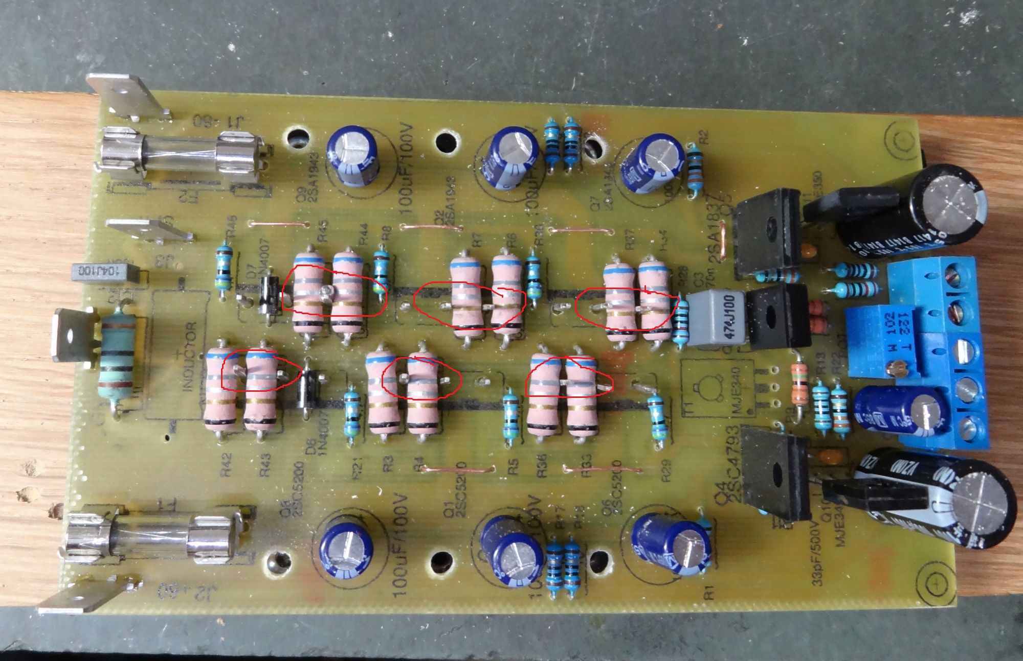

The Cliffjumper is singing. Sounds fine. Square waves look a little rounded. I used 2u2 for the input cap cause I didn't have 3u3. I thought this might be the reason so I bypassed it. When taking readings after this the square waves looked the same but after a few seconds the driver on the - side shorted again and burned the resistors again and of course blew the fuse. Strange stuff.
Hi Valery,
OK, 47p is a bit too much - it removes oscillation but limits the bandwidth a bit more than we need. Try to decrease it to, say, 10p.

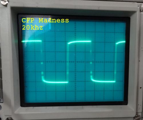

With 10p the oscillation is back just like before.

Let me get back to you. I want to try it with a bona-fide Slewmaster OPS and see if I see the same thing.
One more question. I didn't use KSA1142. Is there something different about those? I used 2AS1362.

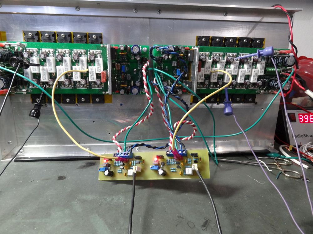

Update,
I hooked it up to my 5P Slewmaster OPS. No oscillation with or without the cap. So it is related to the small OPS.

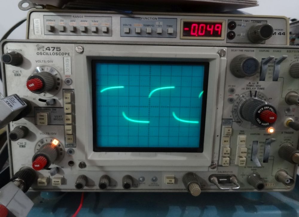

It sounds really good and the amp is dead quiet.
There are some funny nodes on the verticals but the tops stay pretty straight. This is with the 10p cap installed.
I also have a 2u2 input cap rather than the 3u3 called for. I'm not sure if that matters.

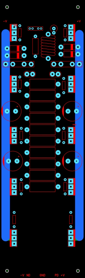

I was looking at your slew setup to moderate my next "move".
I think I can get the "hulk" (below) to be "drop-in" compatible with the
original 5P slewmaster.
Just a little longer (247mm = 9.75").
Why the hulk ?
MT-200 = 5- pair , thermals spread out better for 2Kw of devices.
With 3 pair of whatever , still ... better thermals. (pretty universal)
300W - 500W !! (<800/4R) - your choice.
