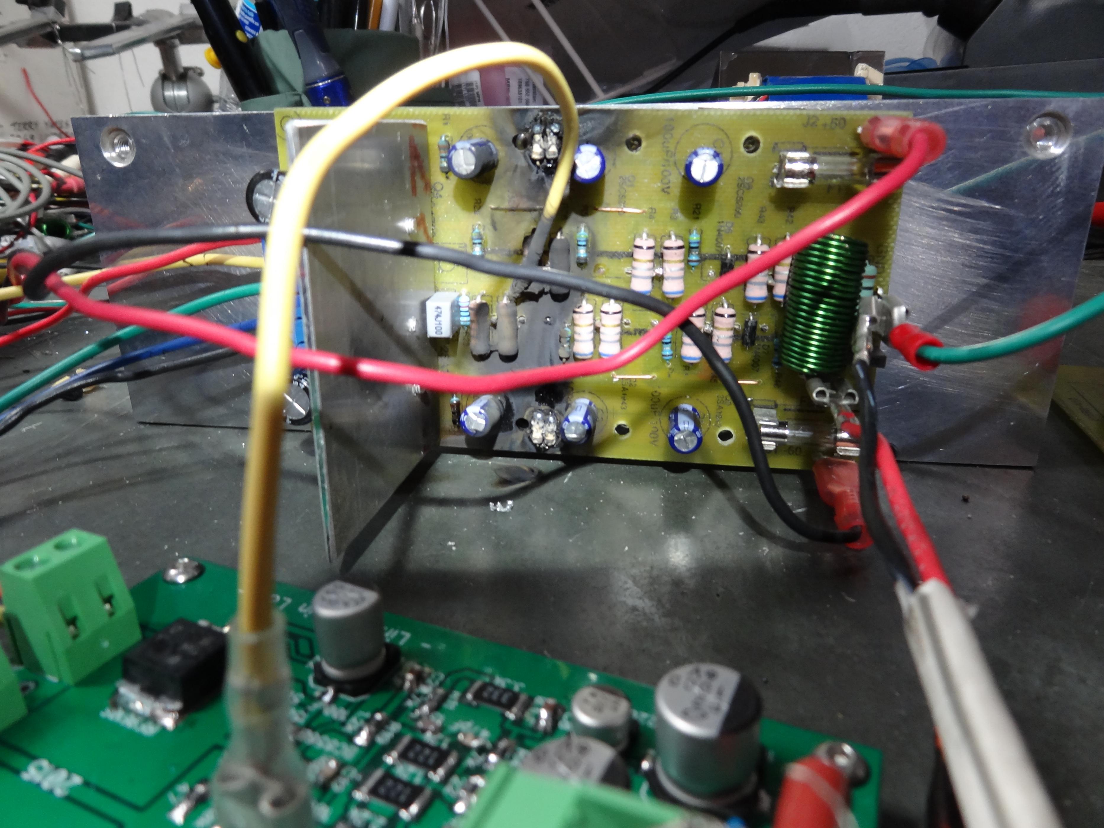

Well testing didn't go as well as hoped. It looked good at first. I played music through it using a Krypton C IPS and all seemed fine. The bias is near the end of adjustment so it looks like it can handle a hot VAS. I then tried the CF-FET through it and it looked fine through my Variac. But then I hooked it up to my A/B setup and it seemed fine still until I turned up the input and then R17-20 caught fire. I wasn't looking at the bias at the moment so I don't know if it shot up but now one of my boards is really ugly. Enough for today.
No pictures of the carnage?
I should have probably measured across those resistors, because I noticed that OPS pulls a bit of current even with the bias adjusted to 0.00v so the drivers must be drawing a pretty good load. I guess with the added load of the IPS it was just too much. The CF-CET has only been used through the Tubsumo OPS so far. I guess I had better test how much it draws too. Anyway, here's a pic.
I just checked and the drivers are shorted. For some reason the CF-FET is not a good match. I'm going to have to investigate why that is.
I said I was done for the day but I couldn't stay away. I replaced the drivers and R17-20. I checked the OPS with 15K resistors and everything looks fine. So I dialed the bias all the way down and hooked up the IPS again it looked good. I ran sine waves and square waves through it and all looked good. So then I hooked it up to a CD and played music through it. Looked good for about 5 minutes when the 2SA shorted and R19,20 went up in flames again. So now I'm thining there is definitely something amiss in the CF-FET. I repair it again and try other Slew IPS's.

post the voltages (schema) before you "blow" it ...

Terry you should invest in a Variac then bring them up slowly.
I use a variac and a light bulb. Once everything is working I then by-pass them so I can raise the bias. I doubt even the light bulb will save a 1/2 watt resistor when a transistor shorts.

Looks like he tested on both his VFET/LFET output stages , but not on a
BJT OPS.
Just like the infidel and the first "kypton V" , there are certain IPS's that do
not interact well with the EF3.
Lack of VAS cpacitance and other factors have to be simulated with the
original slew OPS.
Typically , any that work with the BJT will work with the FET OPS's.
Sometimes , the opposite might not be true. Hard to accurately sim
the MOSFET OPS's ... build it and cross yer' fingers ... 🙄

I'll try to simulate/investigate what happens with EF3 BJT over the next few days.
Pete, you're right - I tested only with VFET/LFET ones and those ran smoothly for weeks.
IRF610/9610 VAS is rather high-current (20 mA) - better linearity in this region - and the whole thing is rather fast. Something causes the current shoot-through in the OPS...

He would have to run the FET VAS in a non-linear region to get <10ma
VAS I. At 20ma , I'm not sure you could even bias the EF3 ?
Another factor ... that looks like Borys's OPS (burned up) ??
