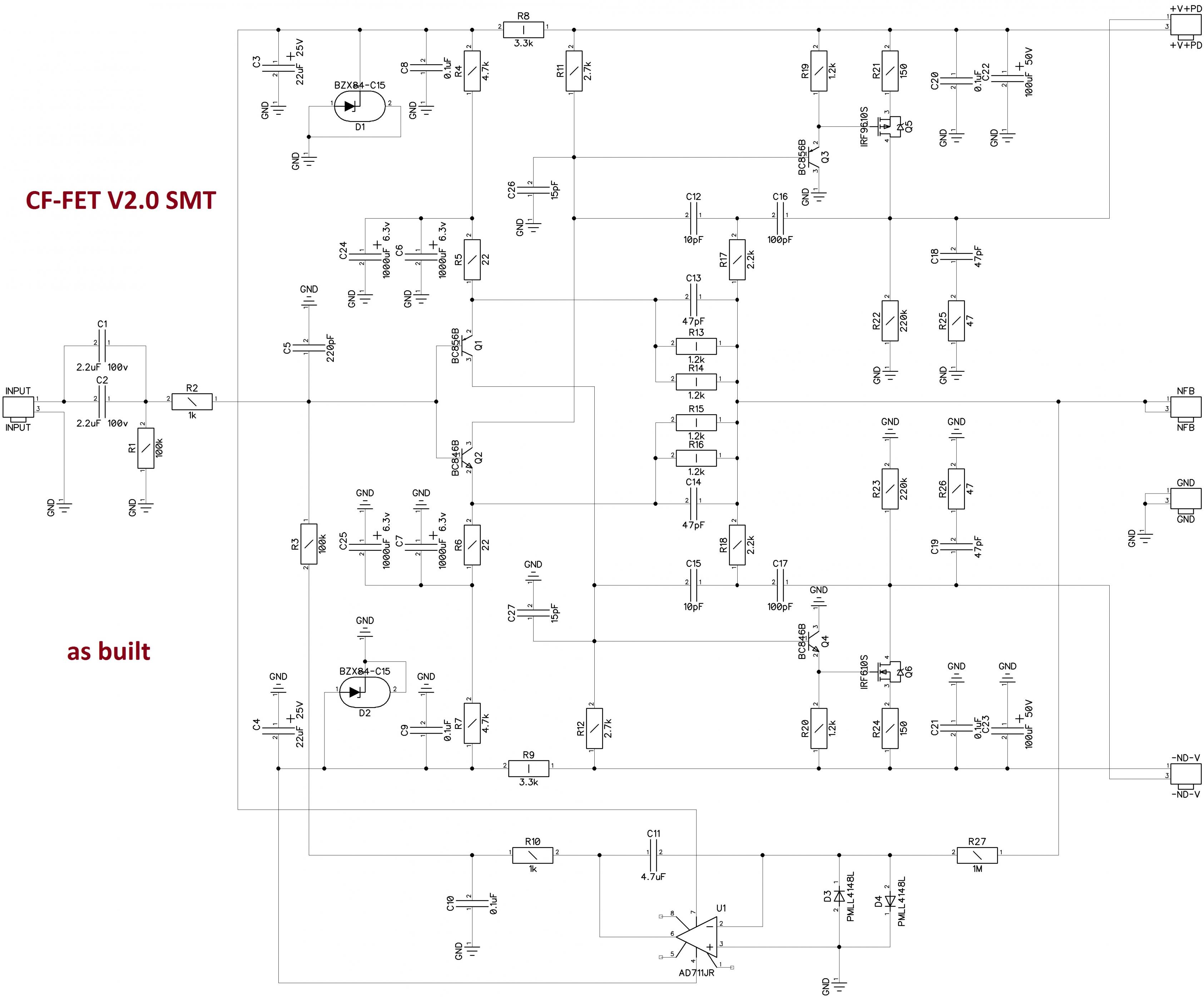

Compensation differences
Hello All,
I have researched the issue and... it could be avoided if I would do it earlier 🙄
Even for IRFP-based OPS, compensation caps values are slightly different from the initial ones, designed for LFET OPS. With EF3 BJT OPS and original compensation, both gain and phase responses go absolutely crazy. This option requires much deeper compensation. So, the optimal values look like this:
LFET OPS (TubSuMo):
C12, C15: 10pF
C16, C17: 100pF
IRFP-based SlewMasters:
C12, C15: 100pF
C16, C17: 330pF
Original BJT EF3 SlewMasters (and Borys's OPS):
C12, C15: 150pF
C16, C17: 470pF
Although, for IRFP-based OPS initial values are not optimal, but acceptable, for EF3 BJT they are very bad - way too low, leaving the amp at the edge of stability.
I will test/measure the new optimal values for IRFP OPS tomorrow.
I will also copy this info to my CF-FET thread for the benefit of the members visiting that thread.
Terry - many thanks for bringing this up - I hope we all have learned something (or confirmed something we already had a clue about 🙂) today :up:
Schematic is attached for your reference.
Valery
Hi Valery,
What would be the drawback to just running the values for the bjt for all of them? What does over compensation do? I'm glad I only fried this little board and not one of my 5p Slewmasters. Thanks again for always being so prompt at finding answers.
Blessings, test dummy Terry 😀
Hi Terry,
Yeah, sometimes you build faster than I think 😀
Setting these individual values I'm trying to maintain stability, keeping the circuit as fast and wide-bandwidth as possible at the same time, getting the most from it.
Overcompensation will result in rounded square wave response and overall slow-down of the circuit. Although, it would be interesting to see - to what extent, really.
Valery

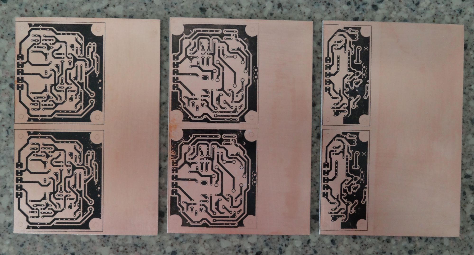

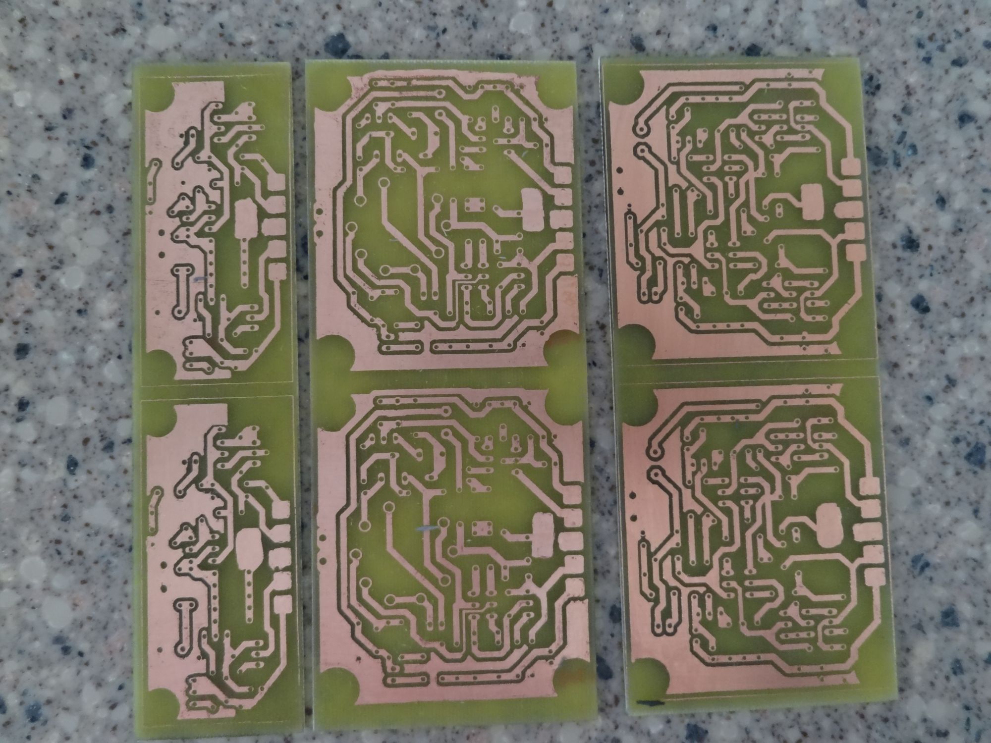

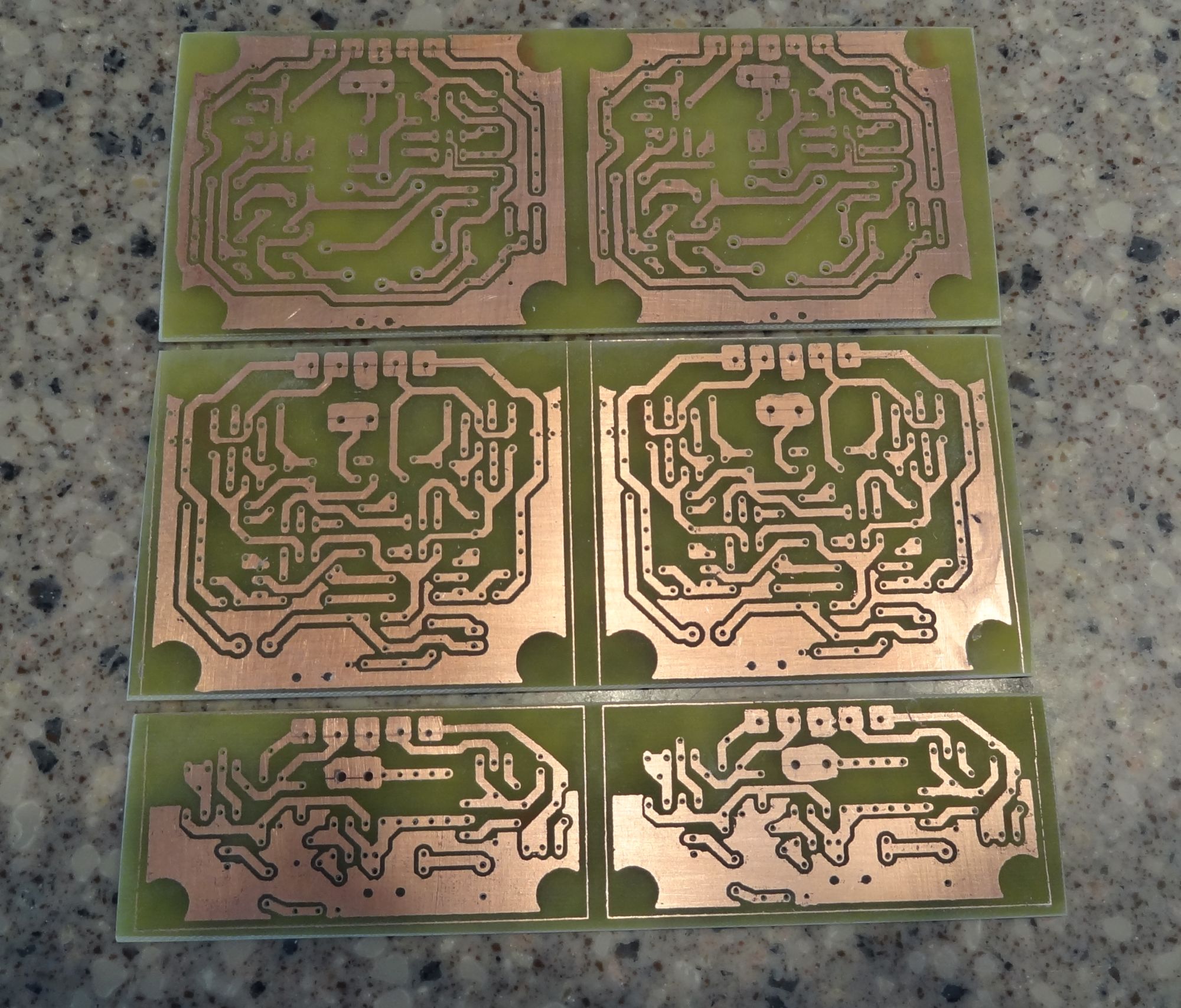

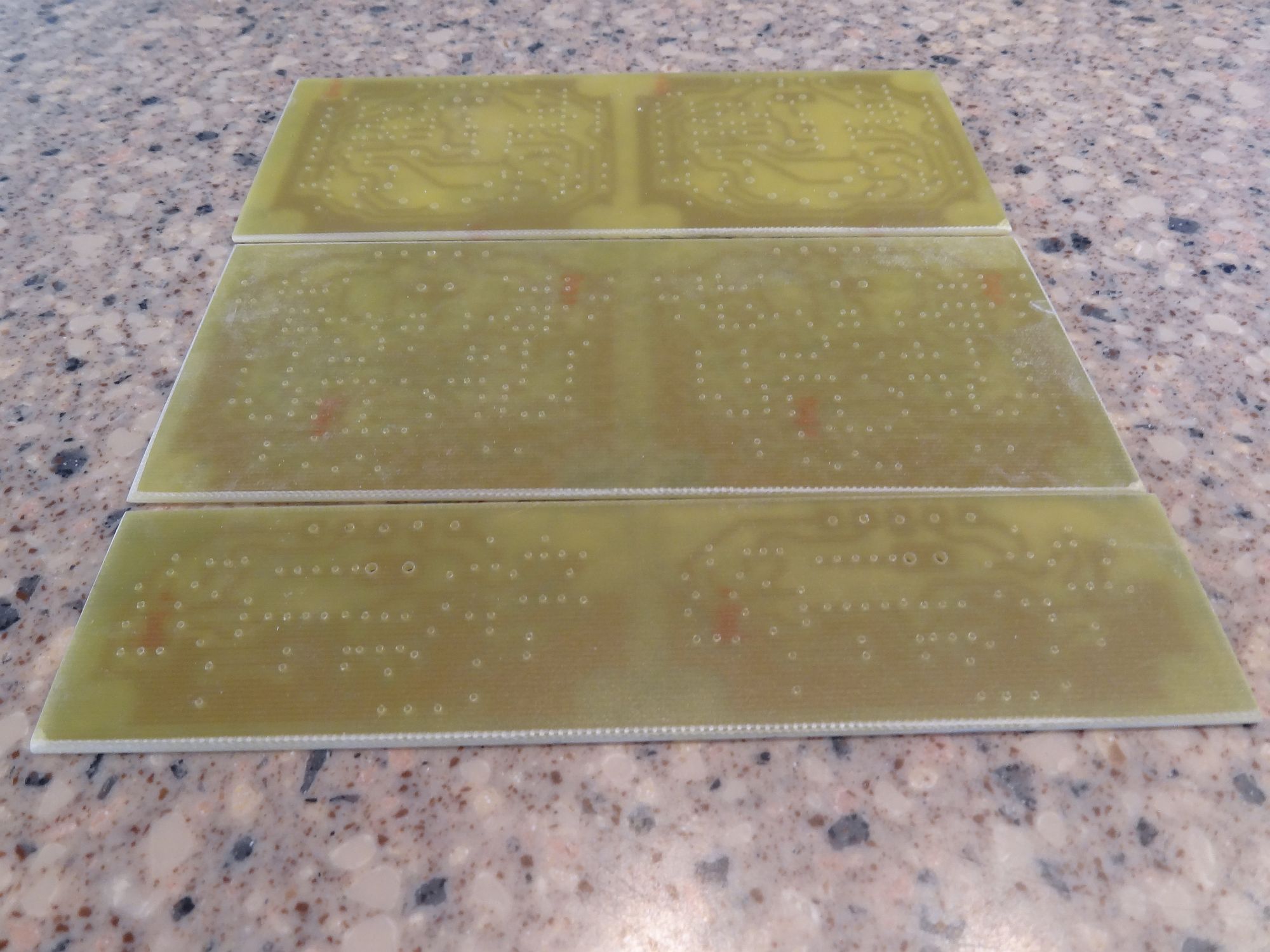

Bellow 3 IPS boards --> files for thermotransfer, the 4th one Ill check after my holidays.
There is still some work left on all of them but they are safe to solder anyway.
IMPORTANT --> tube IPS is causing full DC at the output of the amp before cathodes are heated up so it can be used only with DC protection circuit (it needs approx 5-8s before NFB starts to correct DC).
The CFP-Mad, was tested on +/-45V psu so far.
Ready to populate. I changed the layout slightly to better match up with the Slewmaster.
