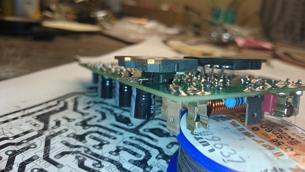

Silk mirror in atatchment, it is a bit measy but it may help a bit. I am allways printing the top layer in two times bigger scale on A4 paper sheet as a soldering helper - it is easier this way for me. I do not have spirit file, I am using eagle so I can post eagle file if U would like.
GKF
I spot that radiator on one of the slewmaster builds and it is briliant and simple idea.
And bellow a pic how to solder/line up the transistors under the board.
The to220 devices have same thicknes as OP transistors, just ''sandwitch'' them together and grab with one hand, than solder only one leg of OP transistor, inspect and solder rest of the 2 legs. After that just tilt the transistor a bit and put the screw in.
Regards Peter

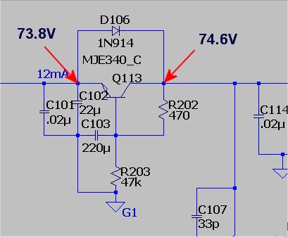

My question is about the capacitance multiplier included in OS SlewMaster..I don't know if current is enough for valve IPS.

The only thing that would happen to the slew OPS is a slight
drop in voltage at the multipliers. You would need 100's of milliamps load to exceed
the beta of the pass transistors.
Even a MJE340/350 here would need >50ma load for that first additional volt
(drop).
OS
Voltage does not matter , you could reduce the base to collector resistor
on the multiplier to only have a .6 - .8V drop in the circuit as a whole.
49V+ is not too bad. Increasing the resistor to ground will have the same effect. (below example)
OS

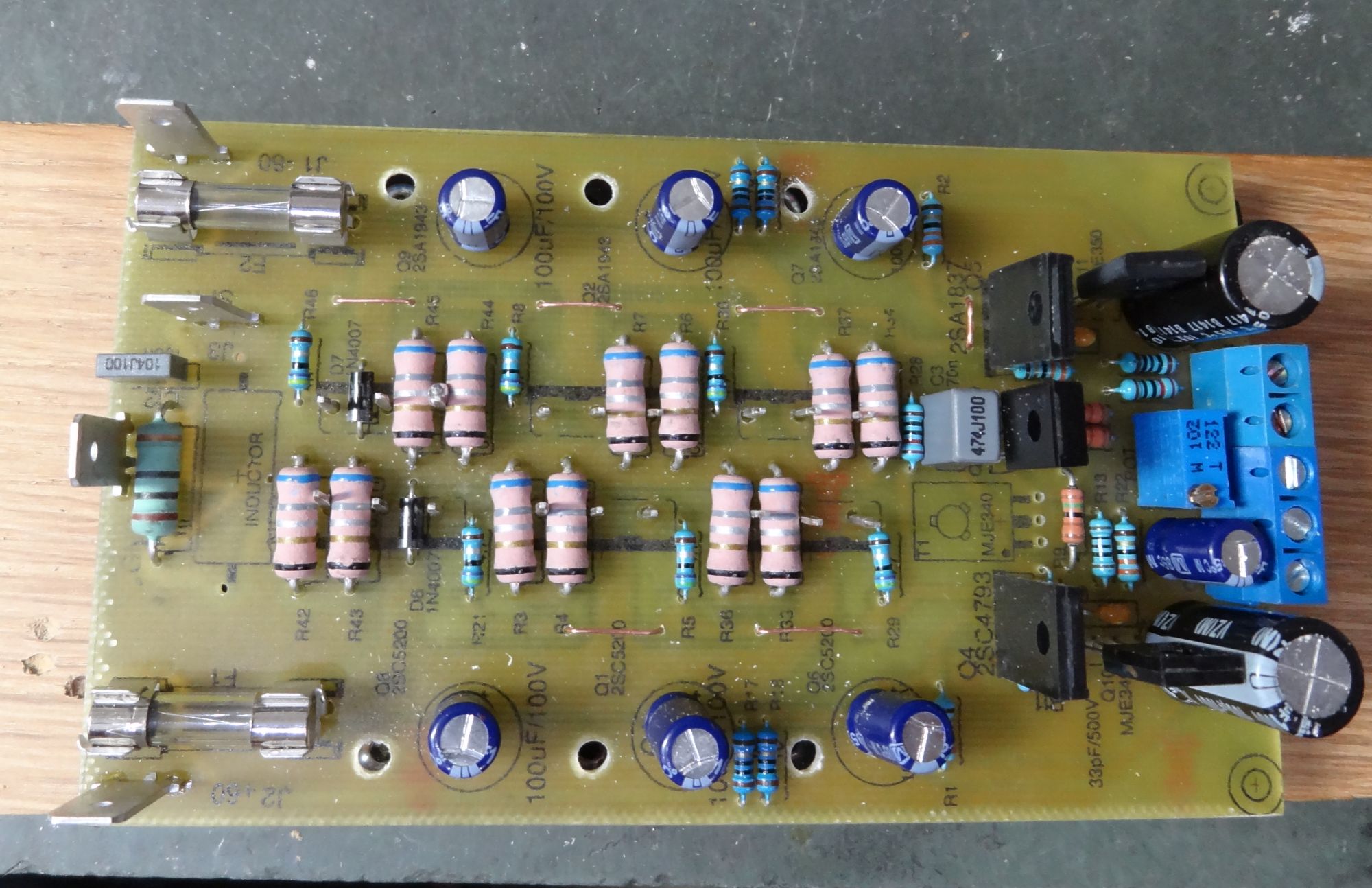

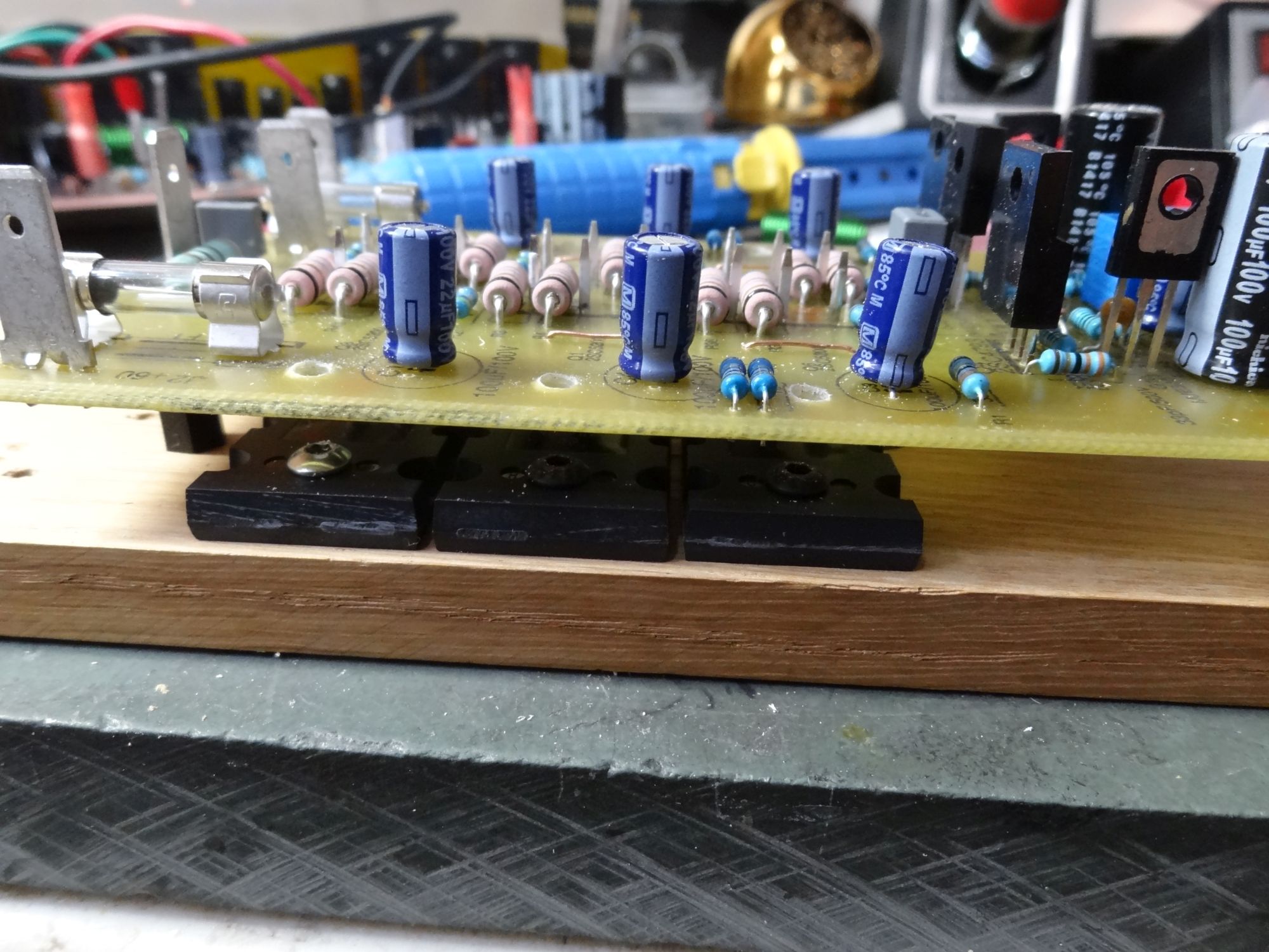

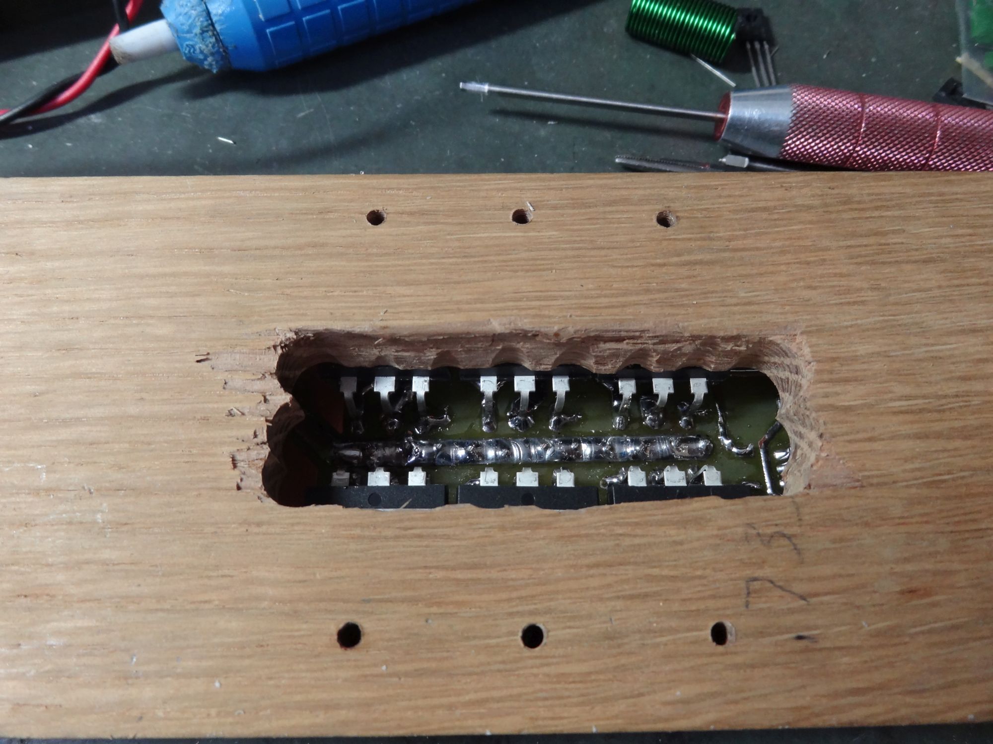

Hi Borys,
Just about ready for testing. I like your idea with using a TO-220 for a spacer but it doesn't work too well on tinned boards. I built a jig out of some oak so I could hold everything in place for soldering. I had to change a few values based on what I had in the bin. Emitters are a pair of 0R68 instead of 0R47 so I have 0R34 instead of 0R23. Should be OK but if not I will add a third 0R68. I also used 22uF for the caps on the outputs like the Slewmaster because I didn't have enough 100uF/100v. I have MJL4281/4302 in the outputs for the same reason. I plan to fly the VBE on wires and mount it on top of one of the outputs. As soon as I get that done and install the inductor I will test.
Thanks for a cool little layout. Terry
EDIT: I forgot to mention, I plan to make the center terminal the ground and bring the NFB out on a wire like the Slewmaster. It will make it easier to use with my other Slewmaster IPS's.

Terry
You are so quick !! WOW
The emiter resistors 0,68R you can use even 3 per OP transistor if U would like, there is third hole on the board. Soldering jig is briliant idea !!

Well testing didn't go as well as hoped. It looked good at first. I played music through it using a Krypton C IPS and all seemed fine. The bias is near the end of adjustment so it looks like it can handle a hot VAS. I then tried the CF-FET through it and it looked fine through my Variac. But then I hooked it up to my A/B setup and it seemed fine still until I turned up the input and then R17-20 caught fire. I wasn't looking at the bias at the moment so I don't know if it shot up but now one of my boards is really ugly. Enough for today.
