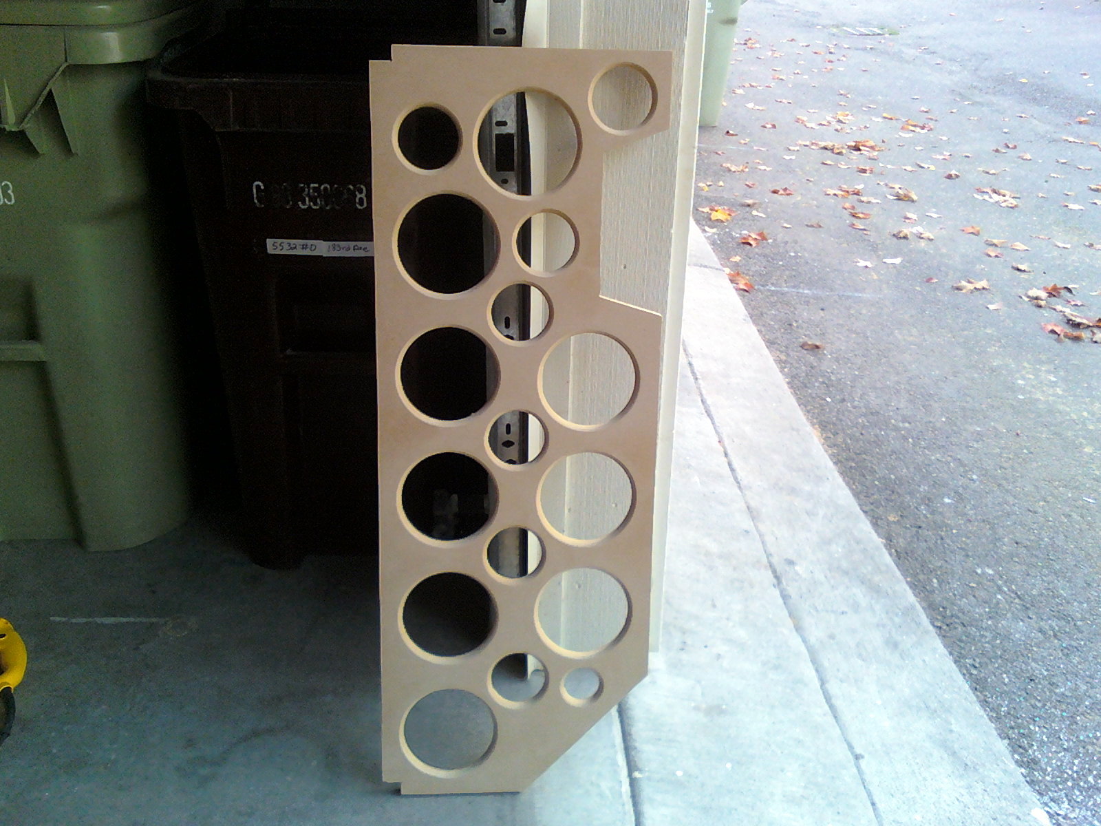

Got the main holy bracing cut and one of them is in and gluing (didn't have enough long clamps to do them both at the same time). They turned out pretty good although I think I may have done too many holes. Oh well 🙂
as long as the brace doesn't break before fully installed, I'd say better a "few too many"? holes than not enough
Well they're in and glued and didn't break so I guess we're good 🙂 Thanks Chris!

Good work Scott, getting these braces done is quite a task 🙂
Thanks Zia! I have the smaller side braces all cut to size, holes cut/rounded and glued in place. They're currently clamped and drying. The bracing really was a lot more work than I thought it was going to be. It wouldn't have been nearly as difficult if I still had a table saw. Oh well; I should be able to start painting this week, finally! LOL!

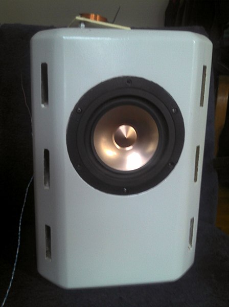

Finally managed to take pictures, sadly it was quite dark outside again so the quality isn't all too good, also due to the fact that these are made with a phone. Hope you get the idea of the colour.
Also these aren't finished yet, only primer and first layer of colour, the final colour will probably be a little darker - I made the mistake of mounting the drivers too early - don't do that.
The coil on top is part of a small bsc circuit, without the gen1 Alpair 10's where a little too edgy in the treble.
Nice! The finish looks very smooth ... Are you shooting with a gun or with rattle can spray paint?

Agreed and after seeing that I'm tempted to do my Pensils in white too! LOL! I really like a nice white but I don't have the means to shoot it properly so I have to roll it making the finish much less appealing ... HMM 😕
Actually it's rolled and then slightly sanded with 400 grit. As I said only primer and first layer of finish, should be much better once I convince myself to do the whole painting/sanding/....
The camera is good at hiding imperfections.
It's not really white but a very light grey, got the idea after mounting the drivers in the primed cabinets (white primer). But I didn't want to do these in pure white cause that seemed to close to Apple designs to me. Besides that I'm sure white works well in combination with the gold/copper drivers.

Actually rolling works too, you just have to be really patient and sand a lot. Another trick I picked up on a German forum is using a water-based paint and spray the surface with a little water from a water spray bottle for plants. You really have to try this on scraps first to get the distance and amount of water right, but it really helps with a smooth finish.
