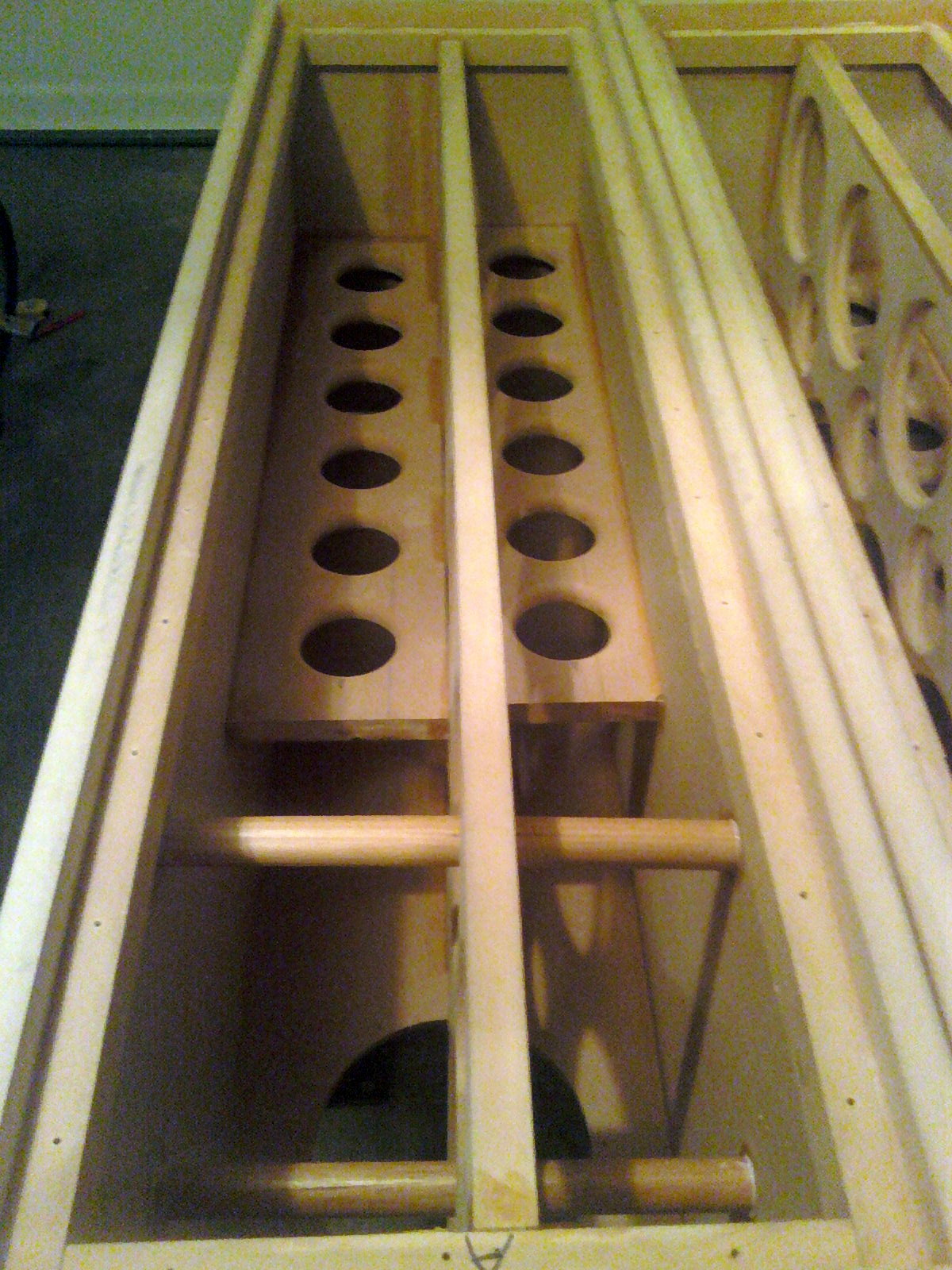

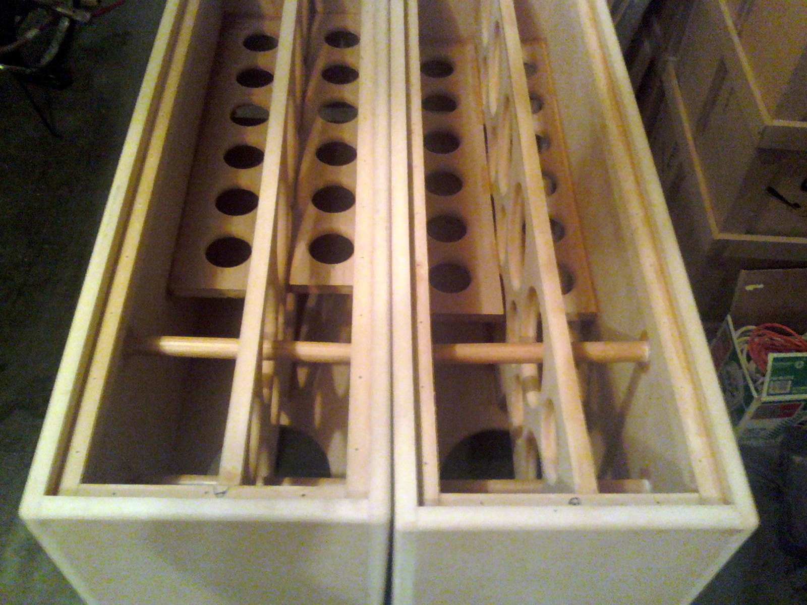

Alright I added more bracing. I bought a broom handle and cut down 2 pieces per cabinet for side/side bracing. They were VERY tight and basically just pressure fit themselves into place. Of course I glued them and now they're sitting in the garage drying. Resonance is GREATLY reduced at the top of the cabinet. I would highly recommend anyone building these cabinets to do this. It cost 6 bucks for the rod, took about 2 minutes to cut the pieces to size then another 5 minutes to get them glued into place. Cheap, easy and works; doesn't get better than that!
The pictures make the dowels look crooked but its just the picture, they're perfectly straight 🙂

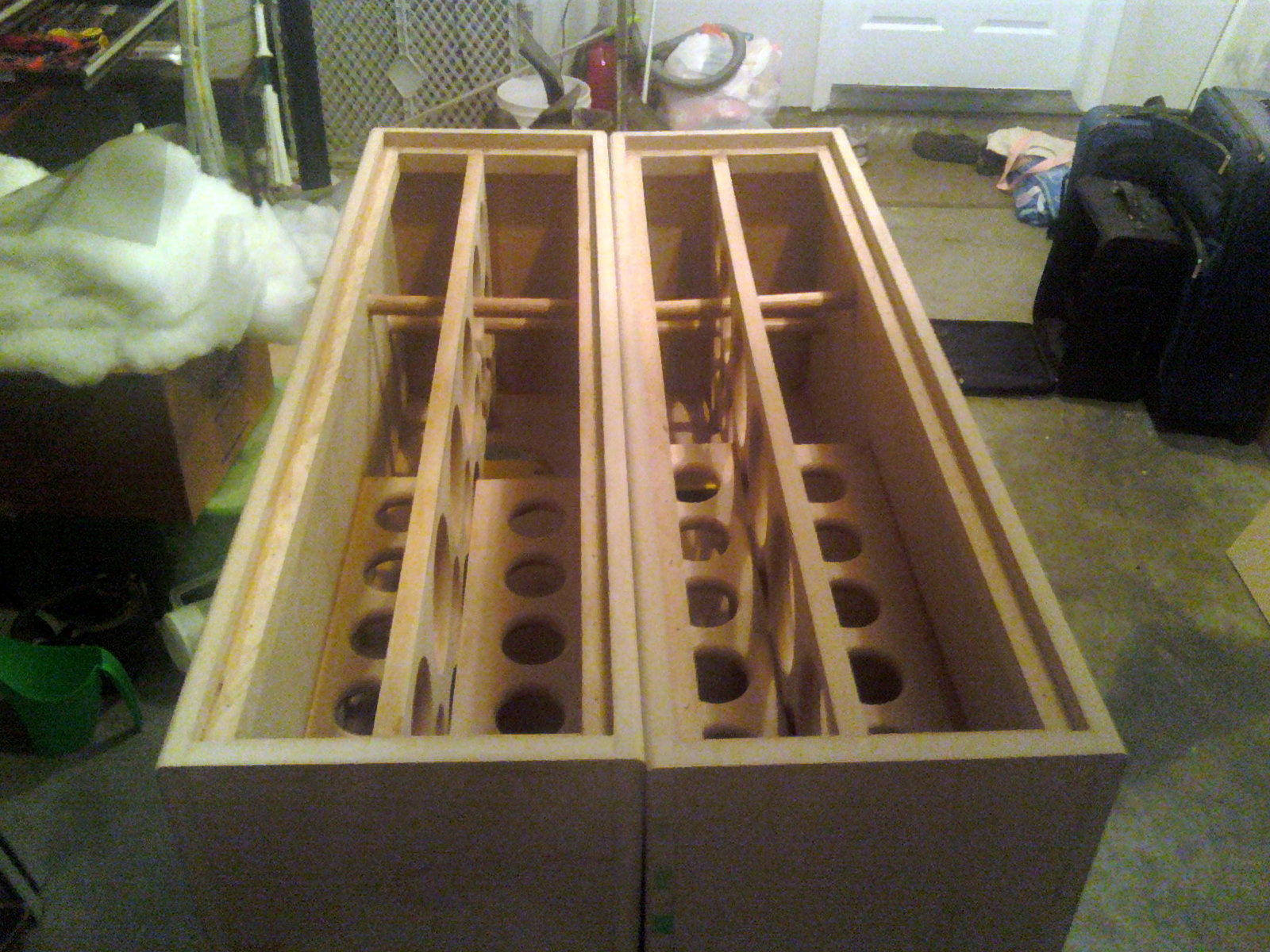

FINALLY finished with construction!! LOL! I'm now onto sanding/priming/painting. Planning on sealing the "endgrain" of the MDF with drywall spackle then sanding smooth. Any other better ideas? I've heard glue/water in a 50/50 mix but is that better/easier/worse than spackle?

Just sand it to about 220grit, prime, sand, and continue with the finishing schedule. Spackle probably wouldn't penetrate into the MDF deeply enough anyway.
So don't even worry about sealing the end grain with the glue/water mixture? Just lay on coats of primer?

I personally avoid MDF whenever possible, and even then would finish with either veneer or plastic laminate - but believe this subject has been discussed frequently.
I guess the products to use would depend on the quality of finish/texture you'd like to attain, but likely the advice would be to not use any water based / high content sealers or pore fillers on the first coat- you'll have enough sanding as it is during the painting process. It's no fun trying to flatten out that mushrooming that will happen around screw holes and exposed edge"grain" on MDF when exposed to even heavy atmospheric humidity, much less direct application of water based products. .
There are special primers and sealers for working with MDF, and IINM, a lot of builders here tend towards auto finishing products - but no matter which, a lot of sanding between several coats of primer / sealer / color / top coats is likely to be involved.

Yeah yeah yeah I know, MDF = BAD with a lot of people but being my very first build AND my very first foray in FR Drivers I didn't want to spend too much money into wood if I wasn't going to like the outcome to begin with. I'd never heard a FR driver before buying these speakers and building the cabinets. Maybe the next build I'll try and do BB ... But again, that's been hashed out before 😀
Ok so no water based fillers, got it. I'm going to roll on the finish with a foam roller. With such large cabinets I didn't want to spray the whole things with rattle can paint (I don't have a sprayer or booth) and thought a nice texture with an eggshell finish would look nice. I'm expecting lots of sanding so that's not an issue (just bought LOTS of sandpaper!!). Ok well I guess I'll just get it all to 220 and start up with the priming. Fun fun!

I get better results using oil based finishes, but Latex can work OK, too. Use one coat of primer and let it dry well! Don't "lay it on"!
Practice on scrap to get your technique worked out. Multiple thin coats will usually be more successful than fewer thick coats.

Ok so an oil based paint with the MDF? Oil based primer too? I've usually only used latex paint so not really used to oil based.

Latex will work well, but oil based gives a deeper quality to the finish, and it feels harder too. Latex always has a kind of softer, plastic, feel, in comparison.
Dust control is a bigger issue with oil based finishes as the paint has a longer open time.

Ahh got ya. Well I want a harder finish. Maybe latex for the coats then finish with an oil based spray or do they even make them or is that a dumb idea? A hard finish is ideal for sure.
Have you considered a "flay alkyd" wall paint? It's an oil-based wall paint that has a very fine rough texture after it dries (it's a wall paint after all). That fine roughness provides a bit of porous nature to the finish and allows varnish to get some "traction" and penetration into the coating. Furthermore, there is some compatibility between the oil-based wall paint and oil-based varnish (or urethane / polyurethane) You can put a couple of coats of oil-based paints on the cabinets (I think at least two coats) then start to build on coats of varnish sanding VERY LIGHTLY between the first couple of coats of varnish. After about 3 coats of varnish, a good gloss should appear.
If you want a good glossy finish, apply 4 - 6 coats high gloss polyurethane, sand lightly with very fine sandpaper (even 320 is OK) between coats. After the last coat go over the surface with 0000 steel wool, then rub with pumice and buff with "rotten stone" or automotive finish compound. Always remove the dust with a tack cloth (cheesecloth dampened with varnish). The result will be a hard glossy finish that can be enhanced and protected with wax or fine furniture polish.

I've never heard of that wall paint. Seems like quite the process and maybe more than I'd want to do for a first try attempt on such large cabinets. Maybe if I build surrounds though?? I think it would look good from what you describe and a hard finish would be nice ... Thanks for the RECO!!

Any enamel will work under varnish, you can even use floor urethanes, as long as you don't put water based over oil based. The other way round is OK, though.
Try this, though. Prime to seal and build a base. Sand thoroughly to 220. Build your colour coats, sand to 220, apply a clear coat, sand to 360, rub out with 0000 steel wool, then apply a couple coats of Tung oil, one per day. You'll get the colour, and the Tung oil will give a deep luster...and no dust problems.!
