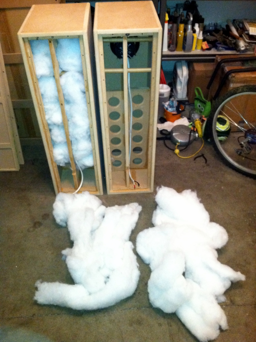

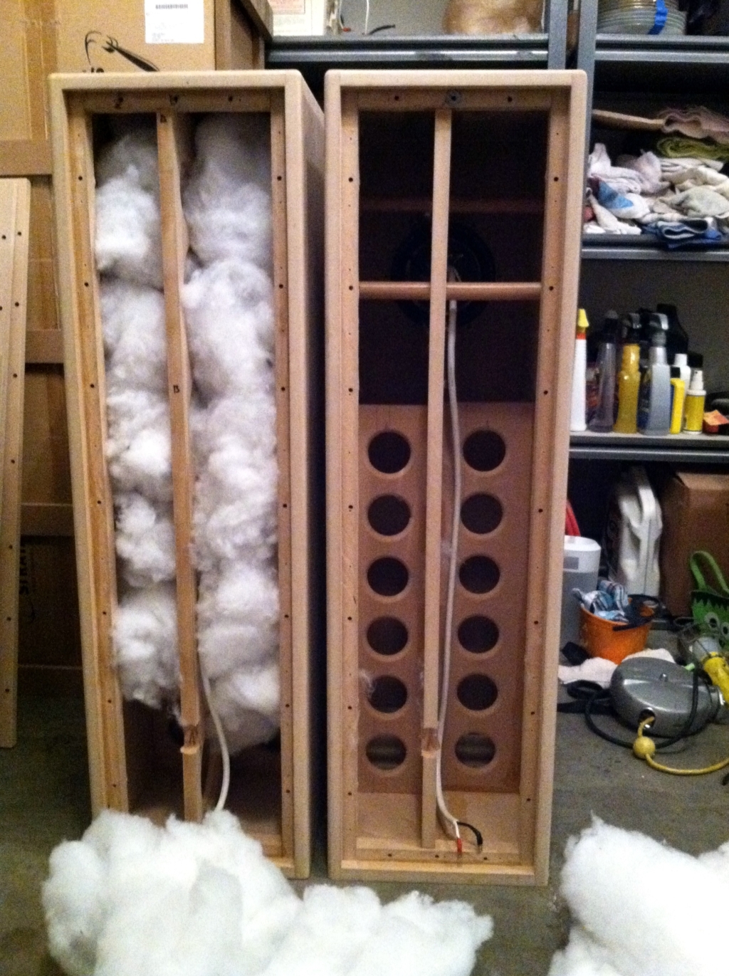

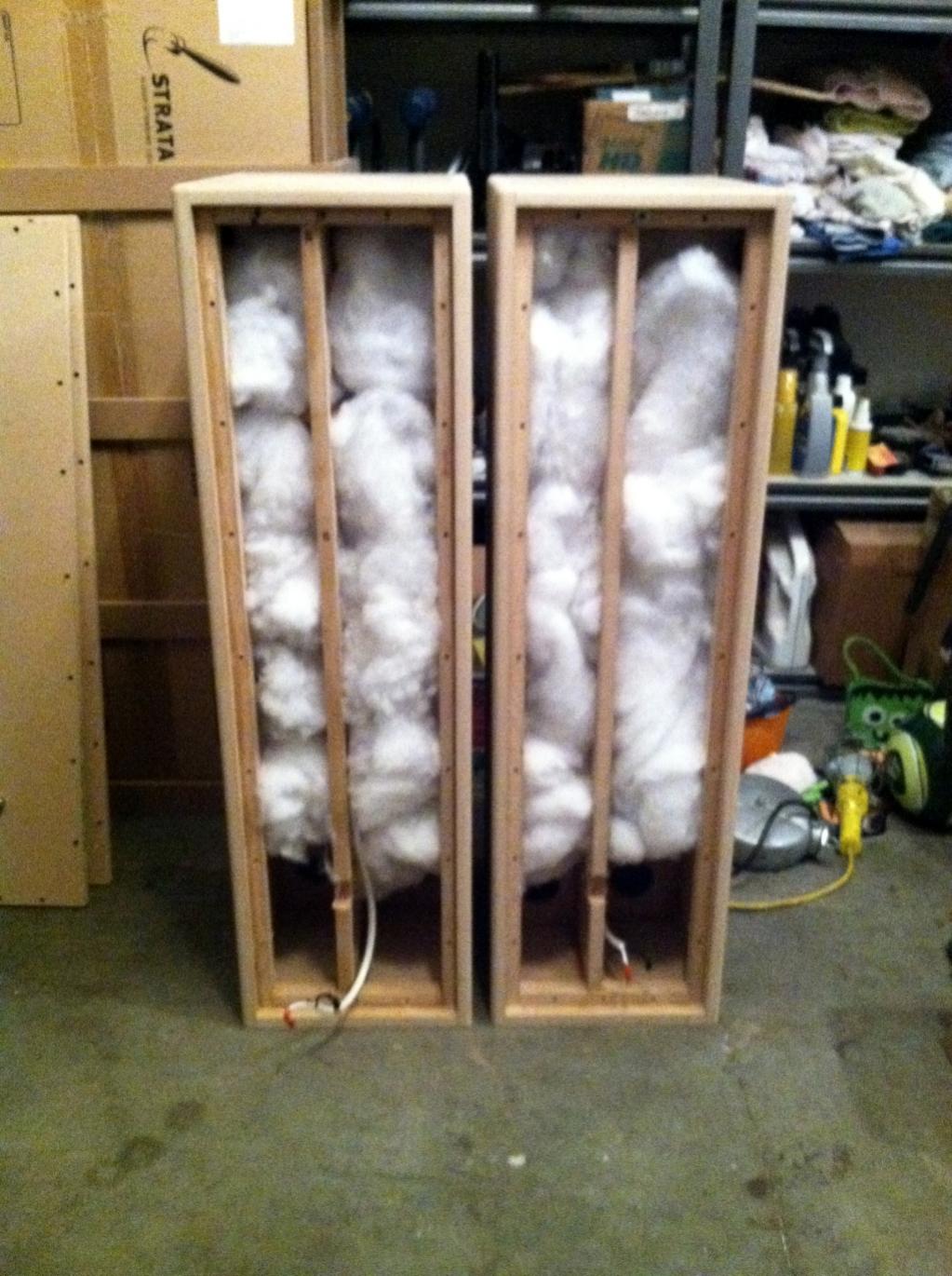

Finally kicked myself last night and took these downstairs to finish. I picked out my color: Stealth Jet in Eggshell and will go pick up the paint tomorrow morning. Hopefully I can get them done this weekend but don't want to rush so it may not be till early next week. I'll post pics during the progress but here they are taken apart and showing the "extra bracing" I did.
