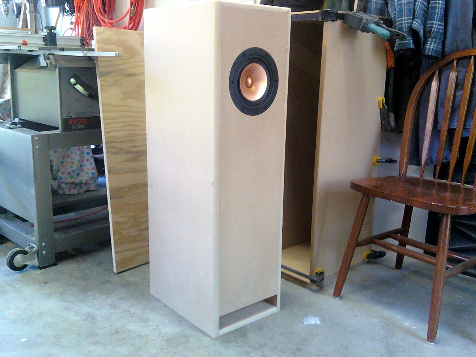

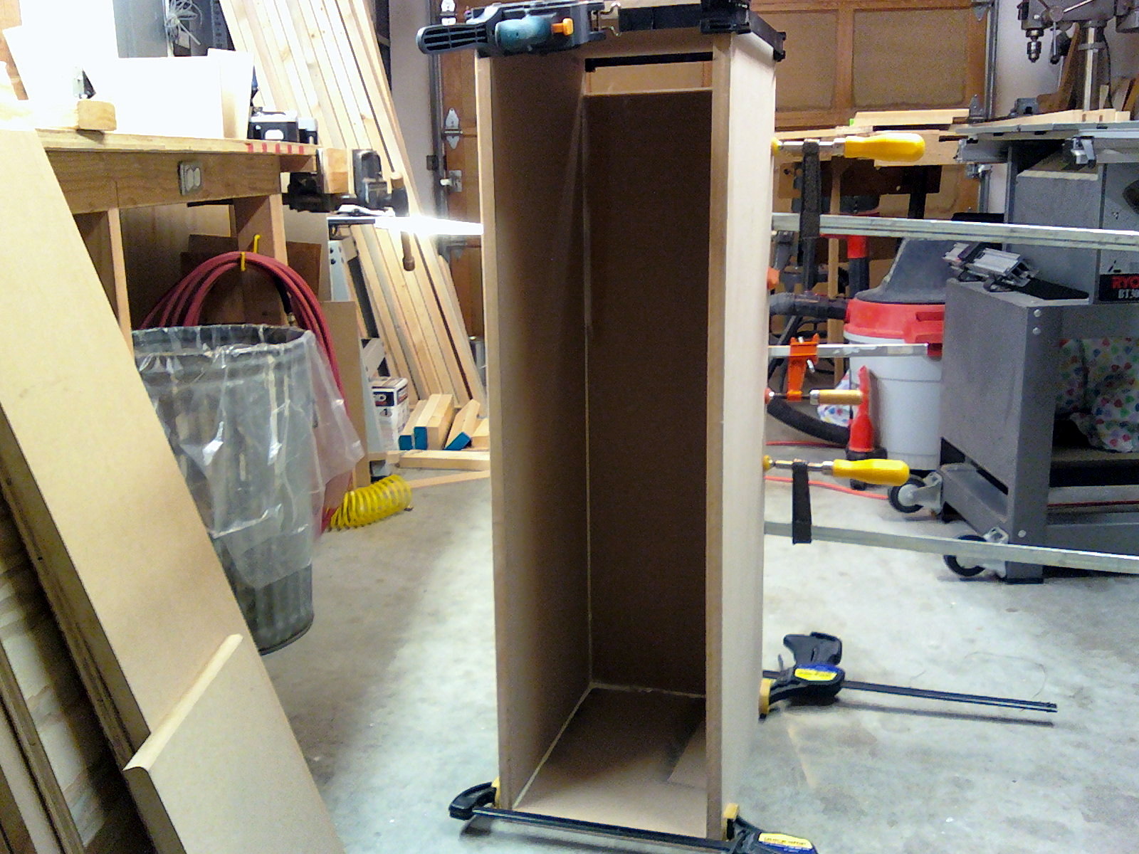

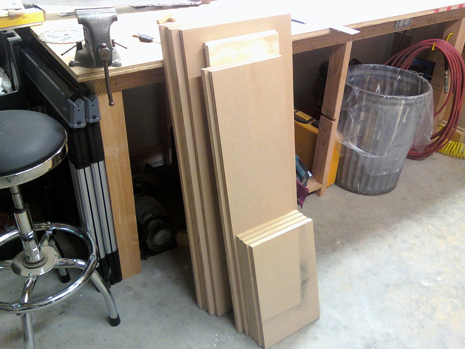

Its been a while since I've been able to do any work and finally was able to get over to my parent's where my dad has a table saw. We got all the boards cut except the braces and got one of the cabinets mostly glued up. Just have the cleats and the back left. Gonna get the other all glued up tomorrow so hopefully can get these at least making sound before the weekend is over. Here's a couple pics at least of the progress 🙂
Cool Scott, looks like you'll beat me to it! Are you doing the braces, or skipping them?
I am also geared up for the veneering this Sunday, followed by the color/finish later in the week.
Keep the updates coming.

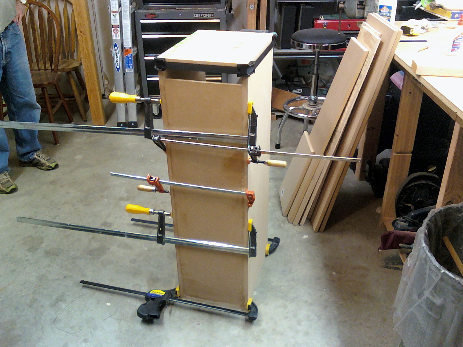

One cabinet pretty much done. Started sanding and its SOLID and HEAVY! Wow, this sucker is really going to be very heavy when its done!! Going over to the rents tomorrow morning to glue up cabinet #2 and get the holes cut in the fronts of cabinet #1 and 2. Should be fun! We're also going to do a lot of sanding (wearing masks of course) so we're REALLY going to make a lot of dust!! Great start to a Saturday 😀

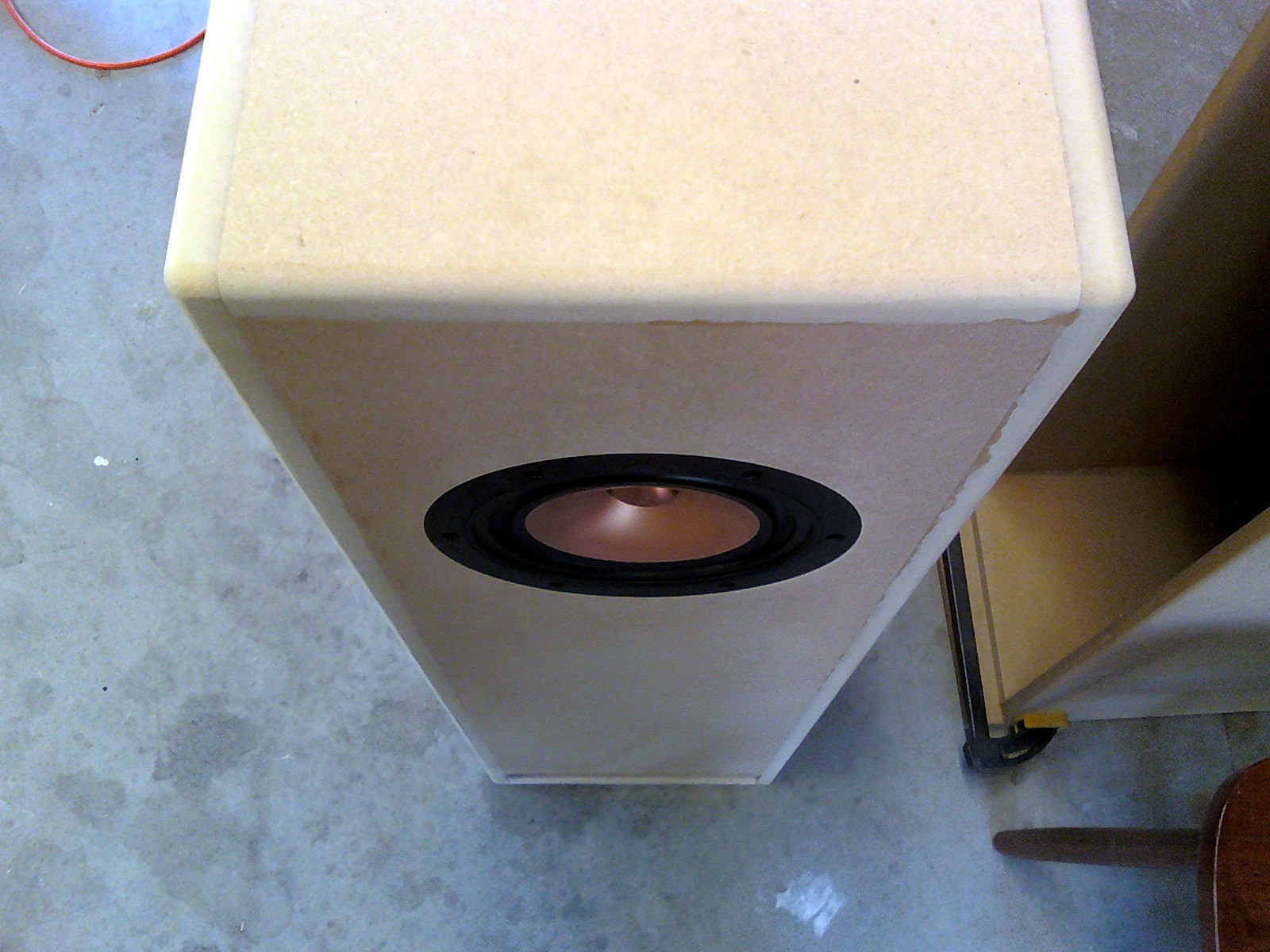

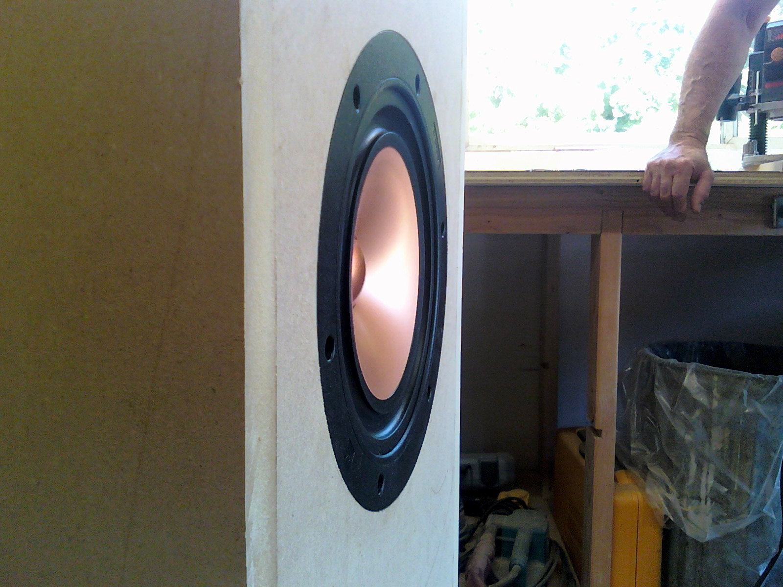

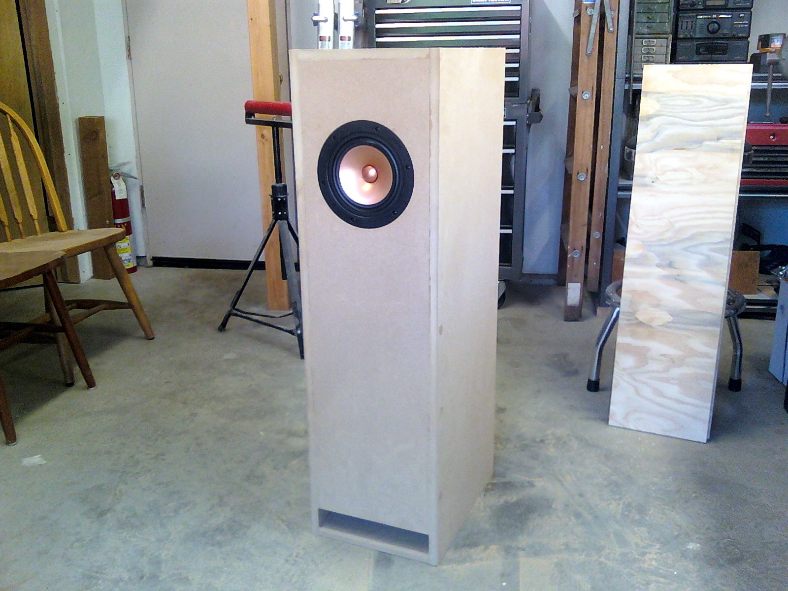

Got the second cabinet all glued together and its drying now. The cleats are installed in the first cabinet and all of the corners have been routed and its all sanded ready for paint 🙂

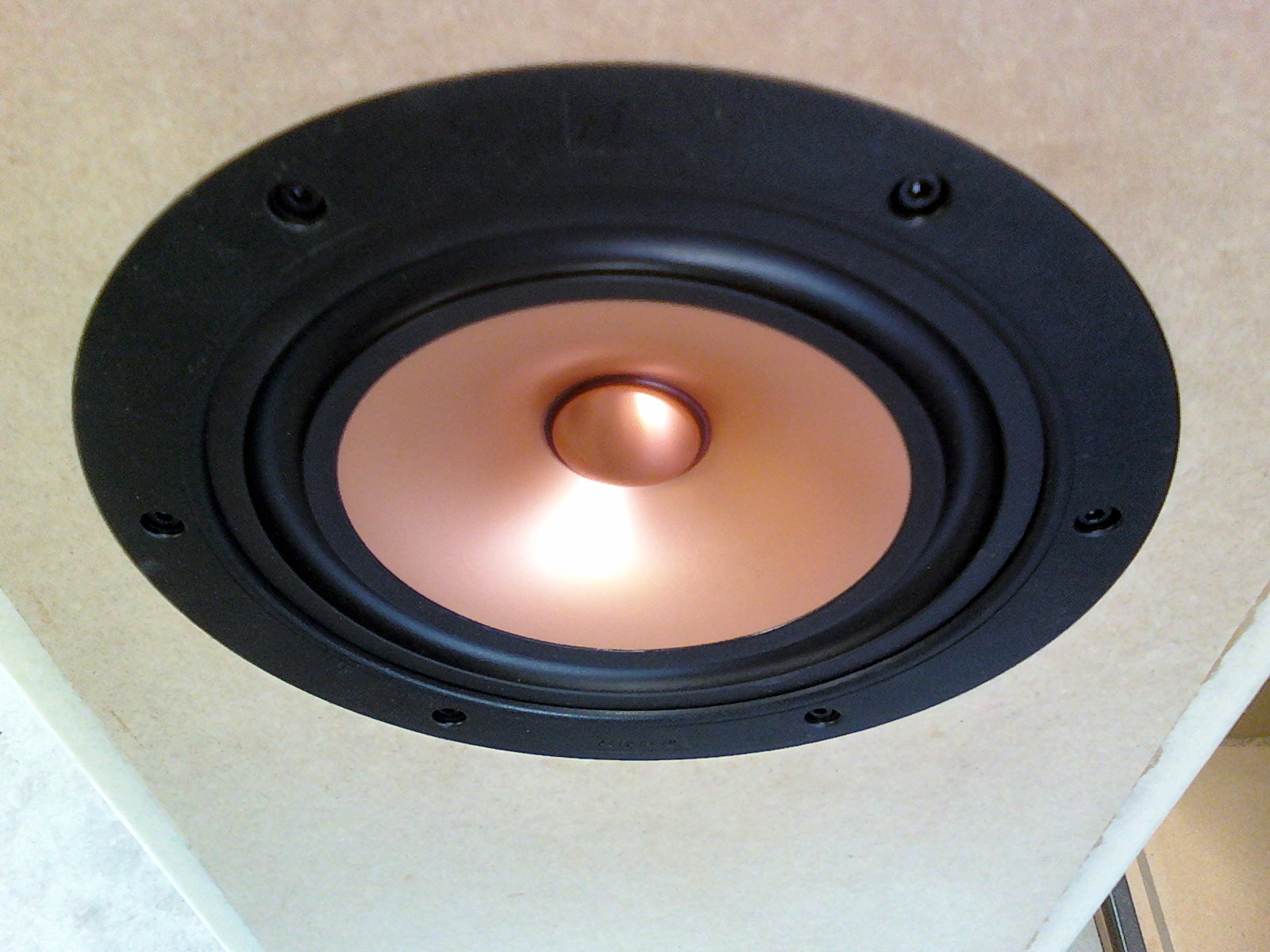

This was my first time using a jasper jig for circle cutting and it worked PERFECTLY with my Bosch plunge router. Once we figured it out it made very quick work (and LOTS of dust) of the job. The driver fits absolutely perfect in it!
Here's a couple pictures of the work so far before routing.
And here's some after doing the round overs. Its starting to come together! The goal is for them to be making sound tomorrow 🙂 They won't be painted but the stuffing will be in. This will give me the closest I'll be able to hear them before putting a ton more work into the bracing. The jasper jig will make very quick work of the bracing though.
I think the size of these are just about perfect for me. They could be a little bigger but overall I think they're a great size. They're going to look very good in my living room 🙂

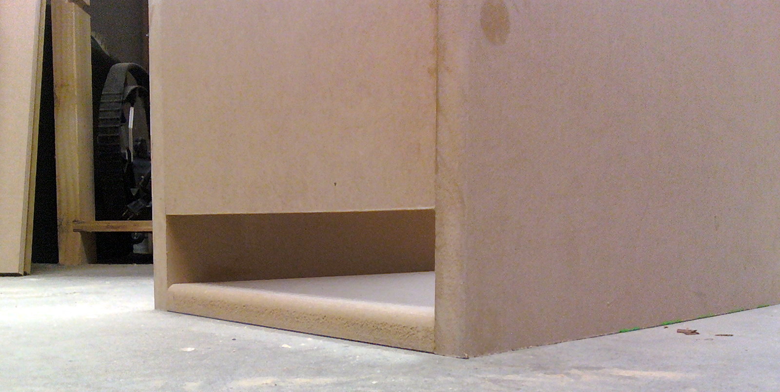

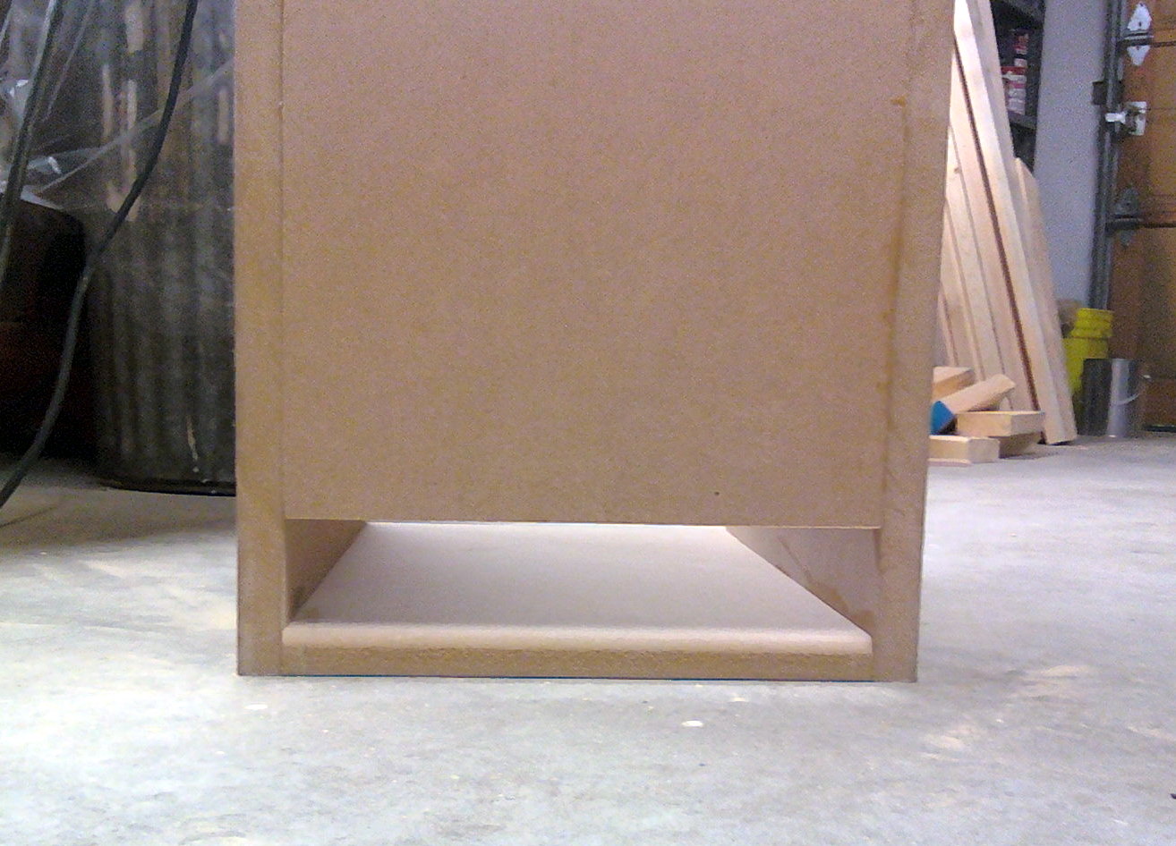

Dave,
Is the rounding over corners in the case of Super Pensil 12 mainly a choice of aesthetics, or does it provide any acoustic benefits also e.g. like the chamfers on an Onken? I vaguely recall a thread recommending rounding over for other speakers too.
-Zia
