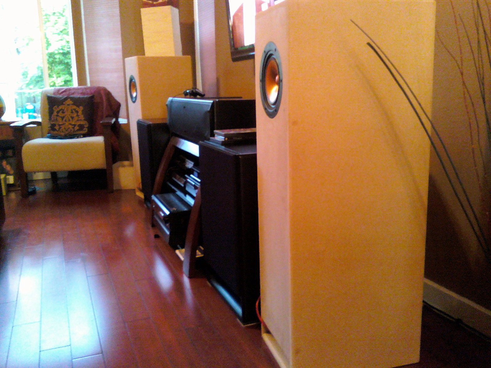

Well, they are all put together now, sans bracing. There seems to be a decent amount of panel resonance so I'm definitely going to build the bracing for them. The big side panels I'm guessing are the main culprits. I put 1.5lbs of stuffing in and the bass seems about right; not muddy at all. Initial impressions by both my wife and myself are that they sound very good, much better than we had thought they were going to. They are imaging incredibly well. Highs are definitely there and are crisp, clear and articulate without being harsh. Bass is surprising and what I was really worried about: its there! Haha! I'm coming from mains with built in 8" subs with a 350w amp so I'm used to a lot of low end reinforcement. While these aren't outputting the quantity of bass, they are definitely putting out quality bass and I don't feel that its lacking at all. I'm extremely surprised and impressed!!
All that said, I made a mistake on the 2nd cabinet and ended up putting the driver 1-1/4" too high. I don't know how I did it but I obviously measured wrong so I'm going to have to build another cabinet. Not a huge deal but a pain none-the-less.
Anyway, I have to say I'm VERY impressed and really liking what I hear. I've only been listening for about 1/2 hour so these are all initial impressions. I'm going to give it a while and work at redoing the other cabinet and build all the bracing.

Dave had given me the idea of using the Classic Golden Ratio Mar-Ken12 and turning it on its side. That's definitely an option but I was kinda hoping for something bigger. I'd really like to have an f3 in the 50's or 60's so I can be totally flat to 80hz where I cross over to my subs. Any suggestions or will the GRMK12 get there?

Couldn't you just replace the front panel?
Good job. I almost built a pair of Super Pensils, but opted for the Studio Monitors instead. Mine are just a developmental project, so if I did the Super Pensils I was afraid of getting too attached to them!
I could try but it would end up being a lot of finish work as they are completely glued solid. So I'd have to cut it out the cut a new panel and get it in there. Its such an easy build that it will probably only take me a little over an hour to get a new box all cut and glued up. Then another hour or so to cut the hole and do all the sanding. Its really a very simple build. The complicated part is the bracing but that shouldn't be bad either with the Jasper Jig. That thing is amazing!!
The studio monitors are cool! Nice choice. I really like floor standers and wanted more bass so I opted for the biggest. WAF is not an issue.
