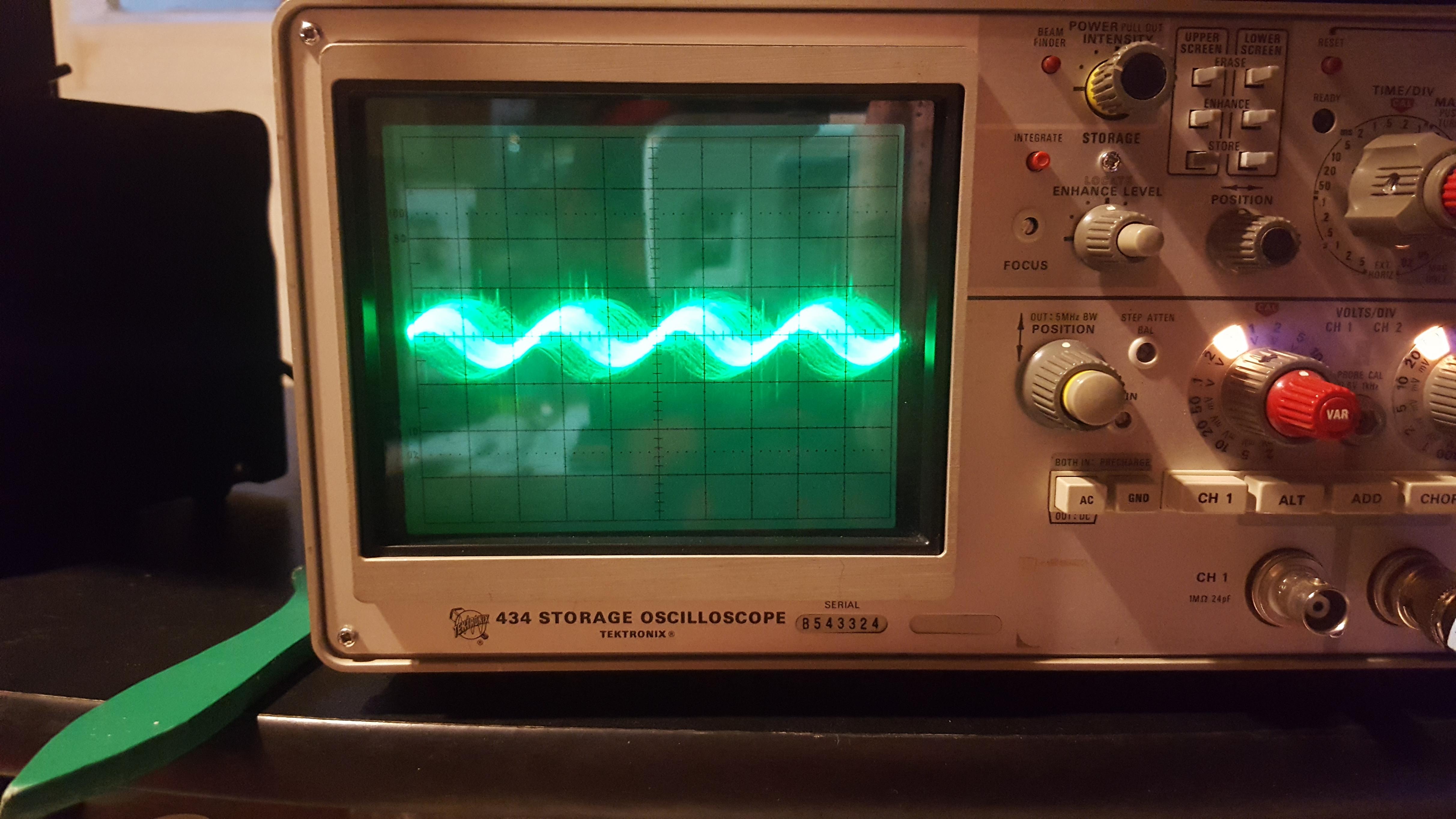

Ok Perry the bulb has not lit up yet.
I don't see any excessive noise on the rails.

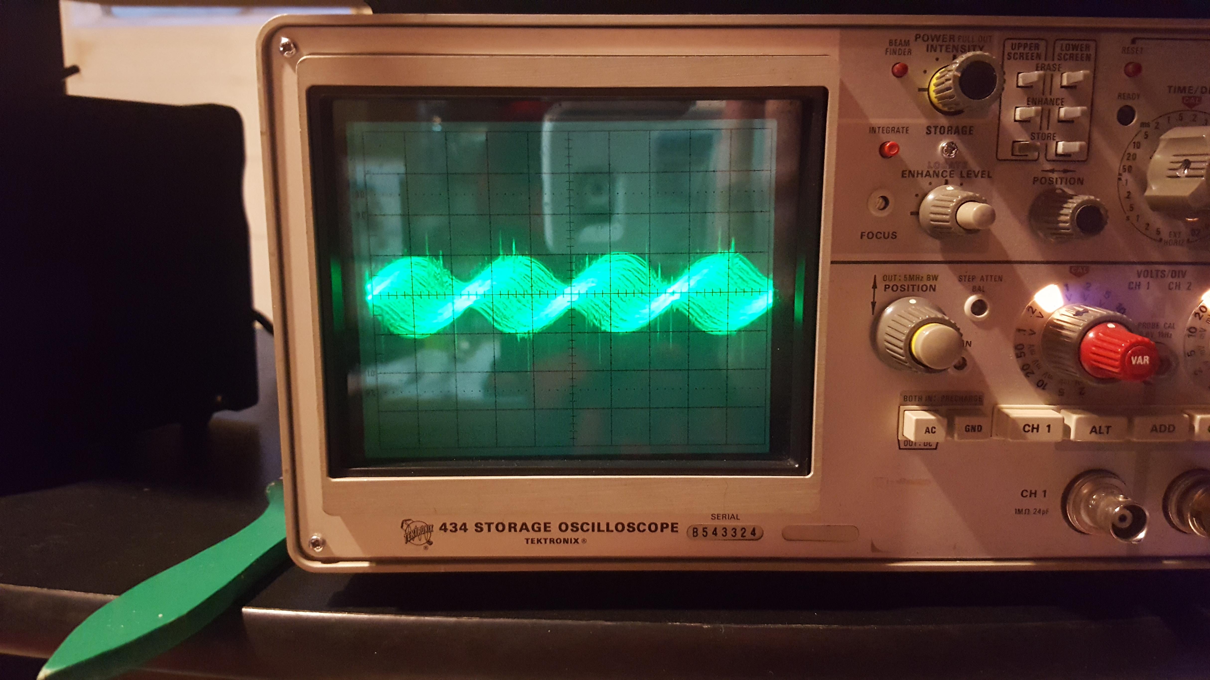

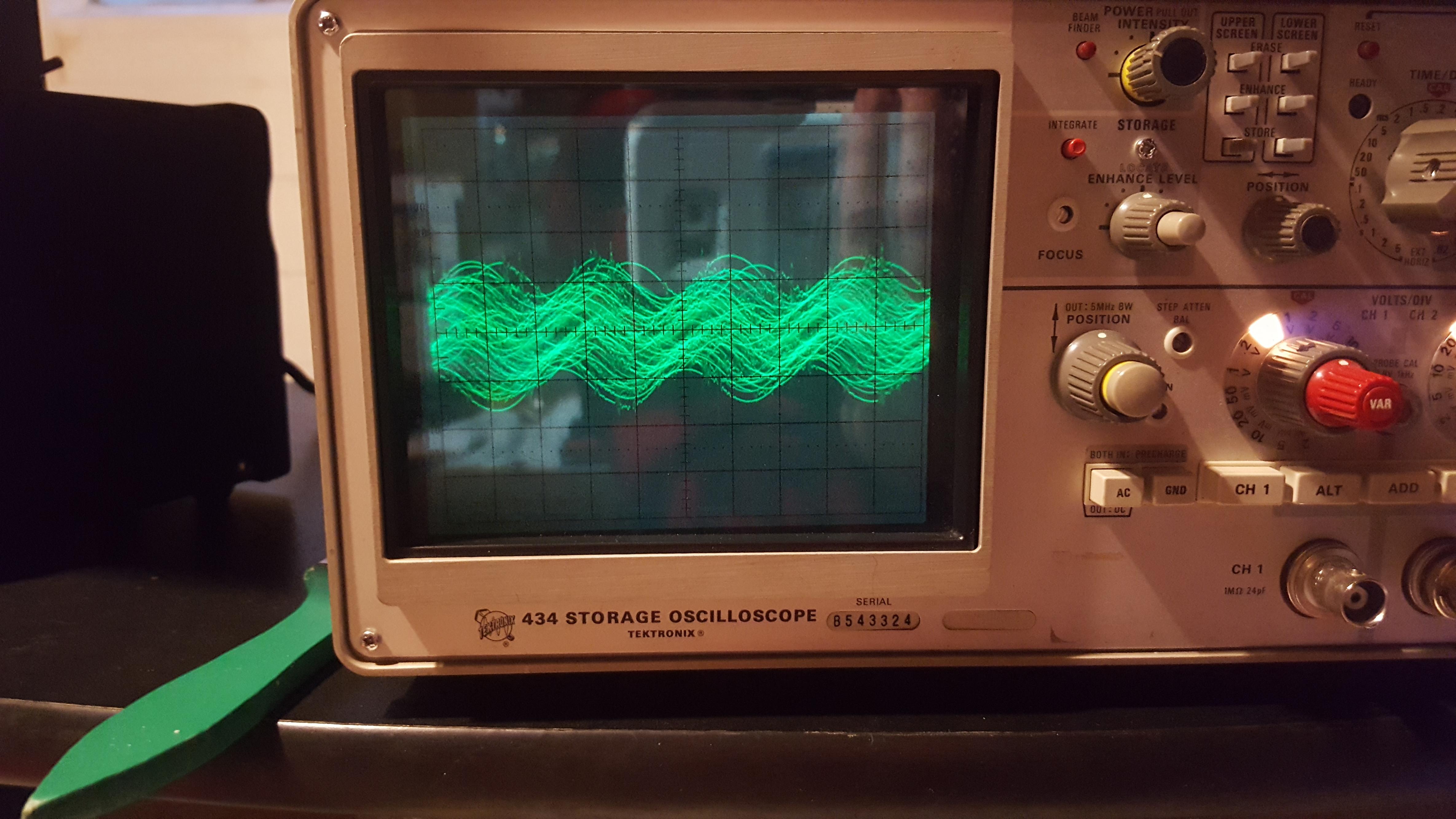

And the inductors there's a clean sqaurewave on one side and the other side the signal im not sure about pic below to help both inductors are identical.
SCOPE SETTINGS FOR PICS 50mv / 10us x10

Oh perry i forgot to mention that the screeching and that signal in the pic above are in sync with each if it screeches the signal move in sync with it
I don't think you can hear anything with that high of a frequency. Put the scope on about 1ms to see if anything shows up.

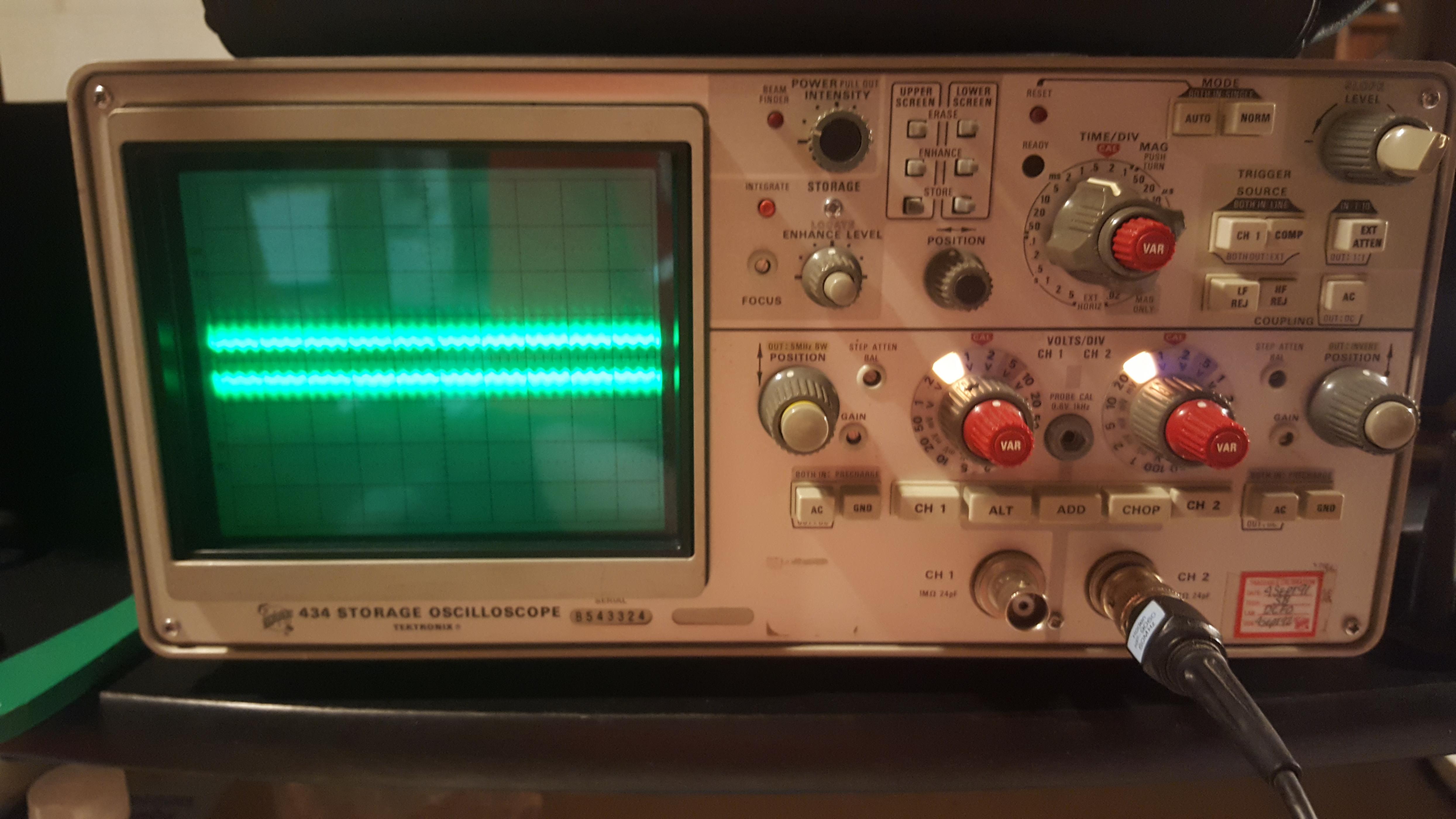

Here's a pic below of scope setting 50mv / 1ms x10

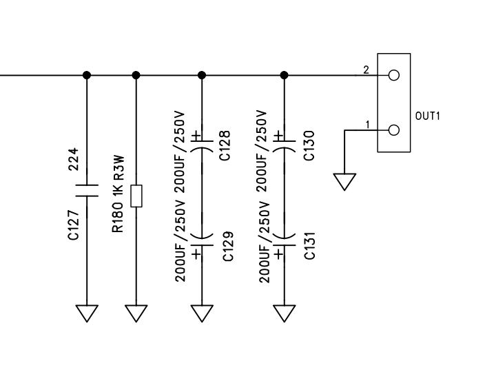

Do you have a capacitor that you could parallel with the speaker to see if that stops the noise?
Anything suitable for an output filter capacitor. Mylar of 10uF is very good. Two polarized caps in series but with a reverse connection is also OK. 22uF or larger (I've used up to two 220uF).
Ok so when you say two polarized caps in series but with a reverse connection are you meaning to put the two caps in series and put in reverse on the speaker terminal?
Does voltage rating matter on the caps
The negatives are generally connected together when they are connected in series. This is a fairly common practice in amps that need any significant filter capacitance at high voltage.
Voltage isn't an issue when working with the low rail voltage.
Attached shows one example.
So hook them up positive to positive instead of negative to negative?

Sorry don't mean to ask so many questions but in the diagram you sent there in series with the negative sides together should I do it like in the diagram or in reverse
When you said a reverse connection is ok also it threw me off a little sry
Ok so just hook it across the + and - speaker terminals with sub still hooked up as well just wanna make sure I'm getting right
