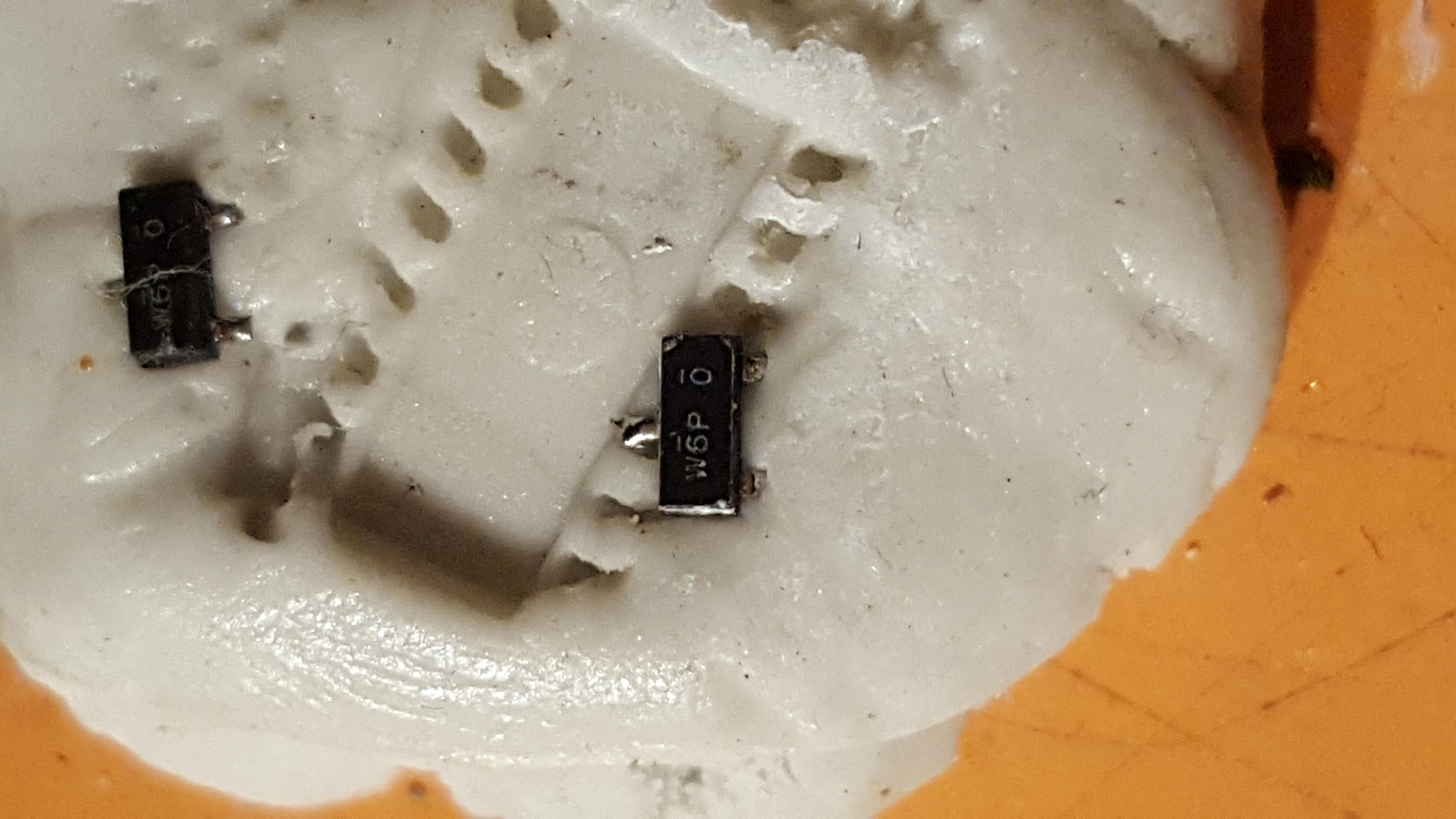

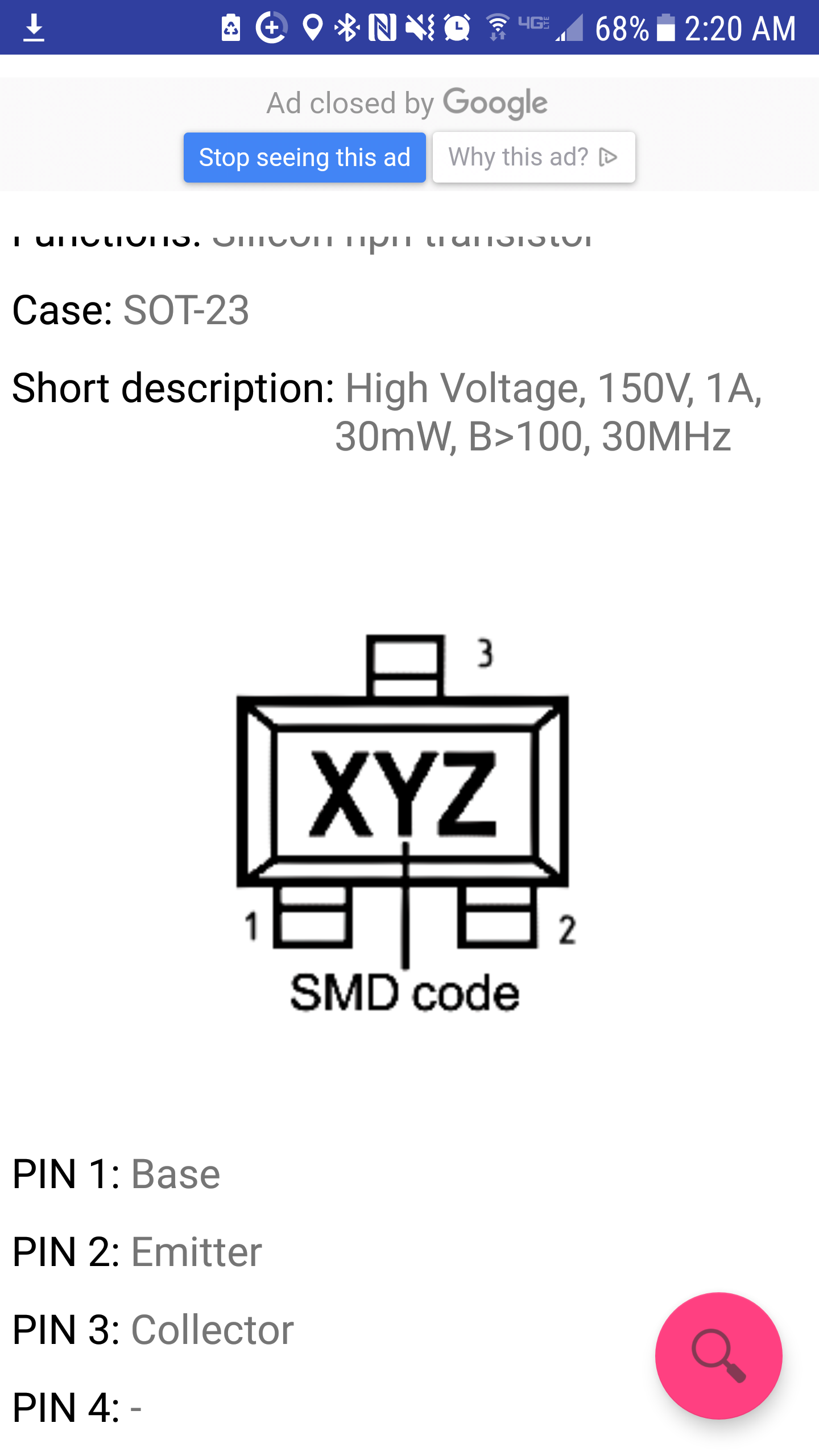

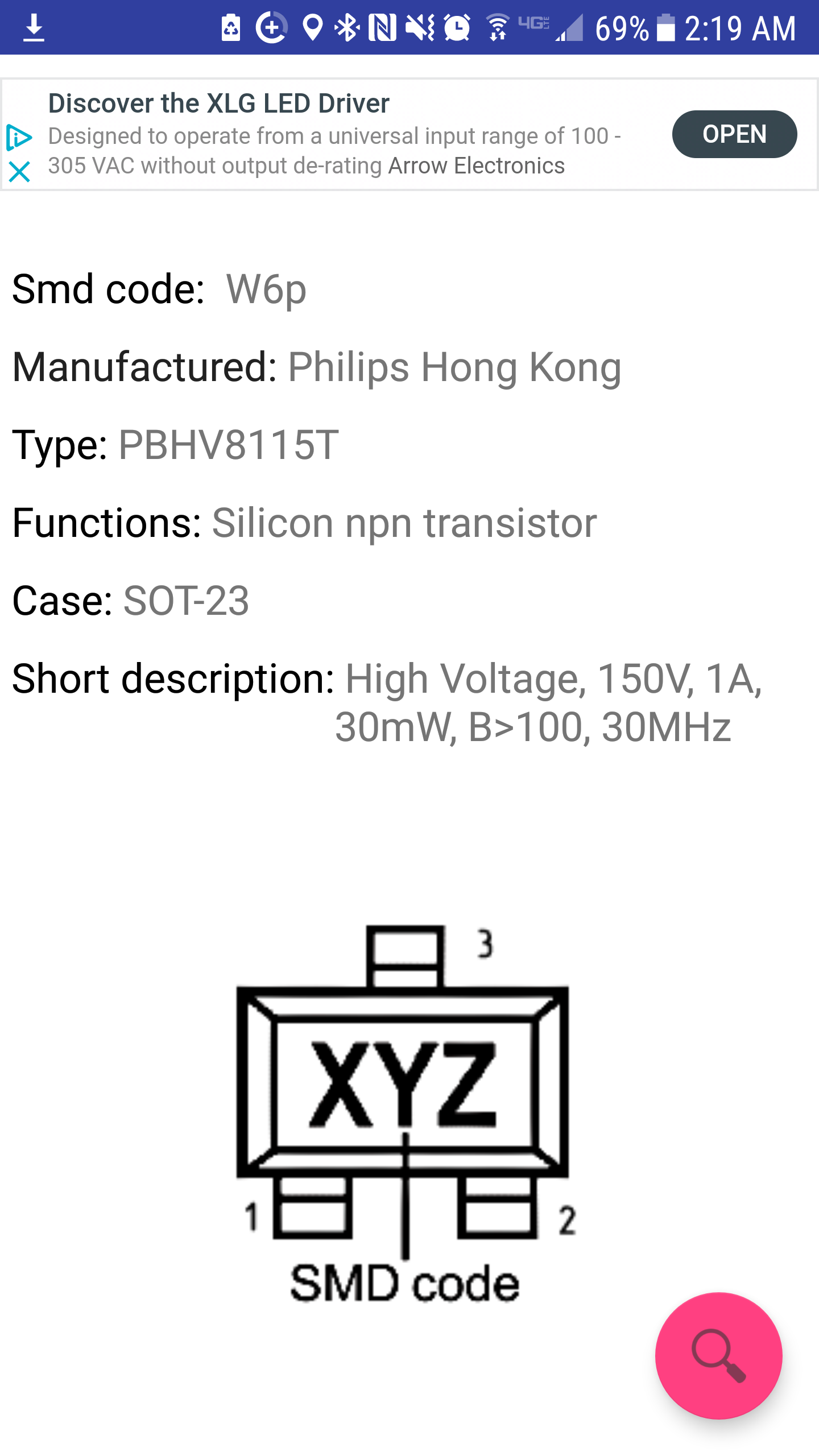

Still having the squealing noise issue amp plays good but has a noticeable squealing noise so I've been trouble shooting and have found 2 smd transistors that may be shorted but can't tell or find out what they are I've tried Google and the smd code book but can't seem to find it any help would be greatly appreciated
AND TRANSISTORS READ (W6P 0) pic below
To have the same readings across two transistors is against the odds.
They could be jfets. Where are they being used in the circuit?
Yea that's what I was thinking when they both read the same one is part of the dc offset protection circuit it's connected to Q225&Q226
The other one it goes threw a few caps diodes and resistors but is connected to the input leg of the L7812
