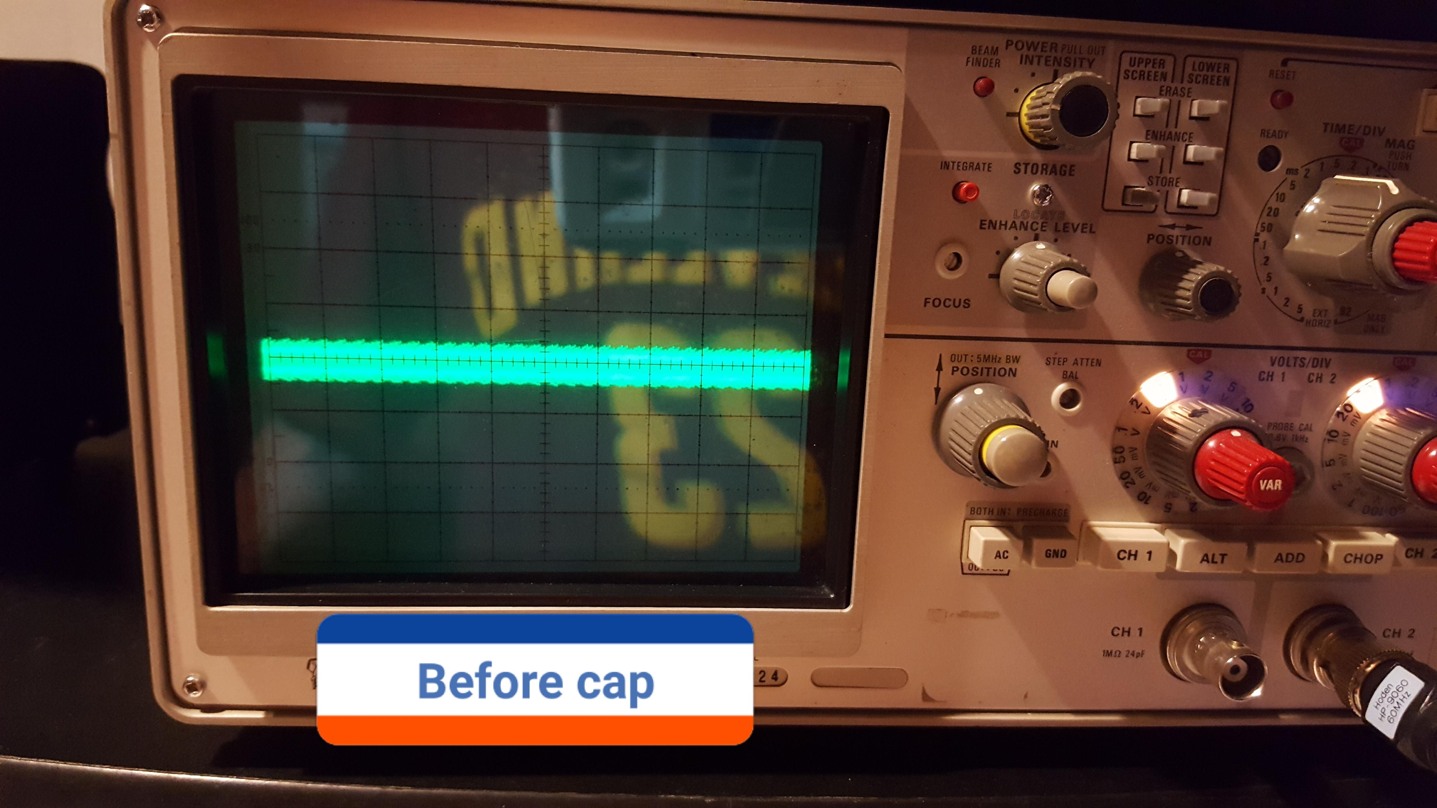

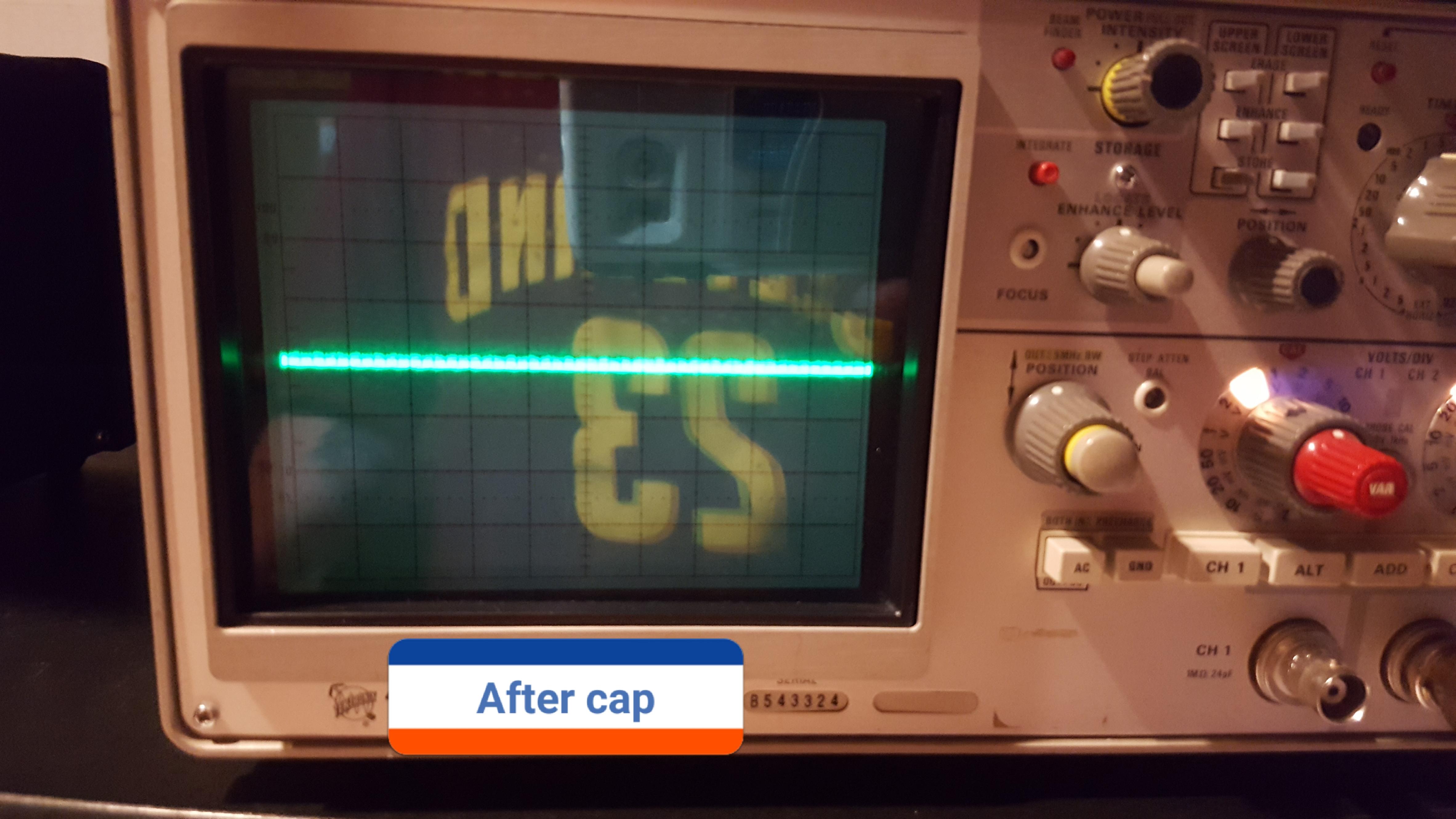

The capacitor did make a visible difference it made the noisy signal smaller as you can see in the pics below
SCOPE SETTINGS 1ms / 50mv x10

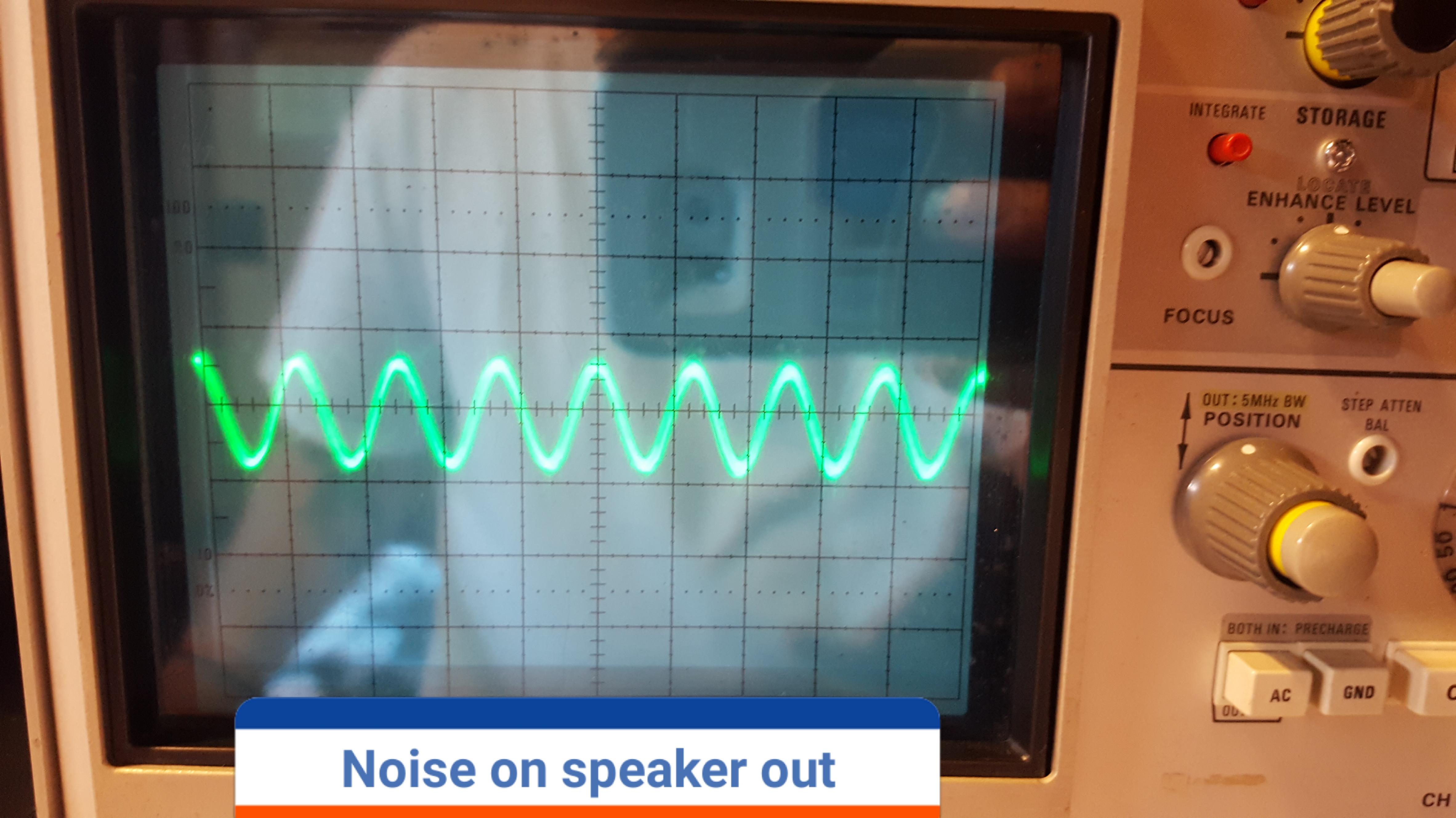

Yes that amp produces audio it looks somewhat fuzzy and it does clean up with the cap it takes away the fuzziness of the signal

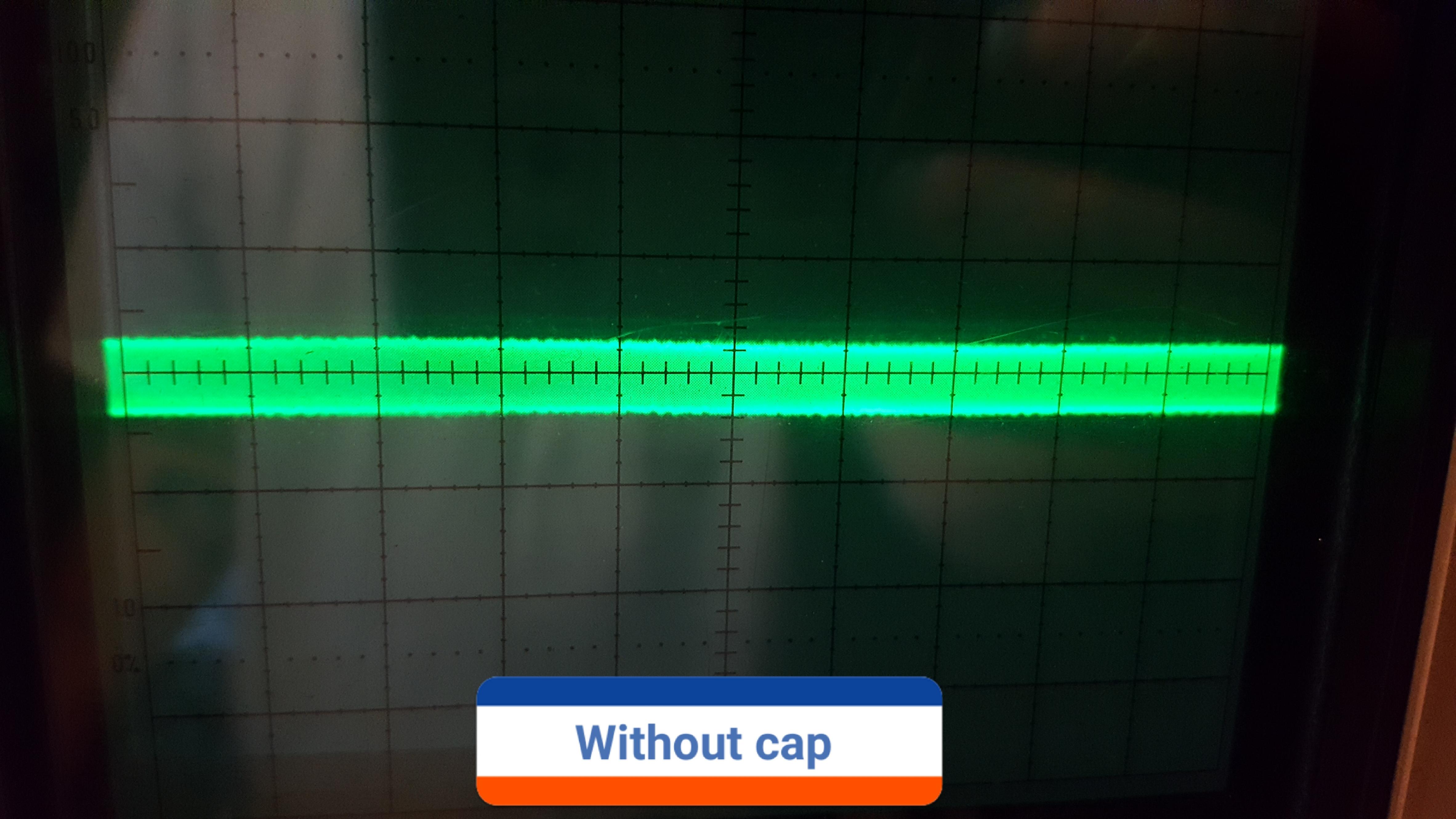

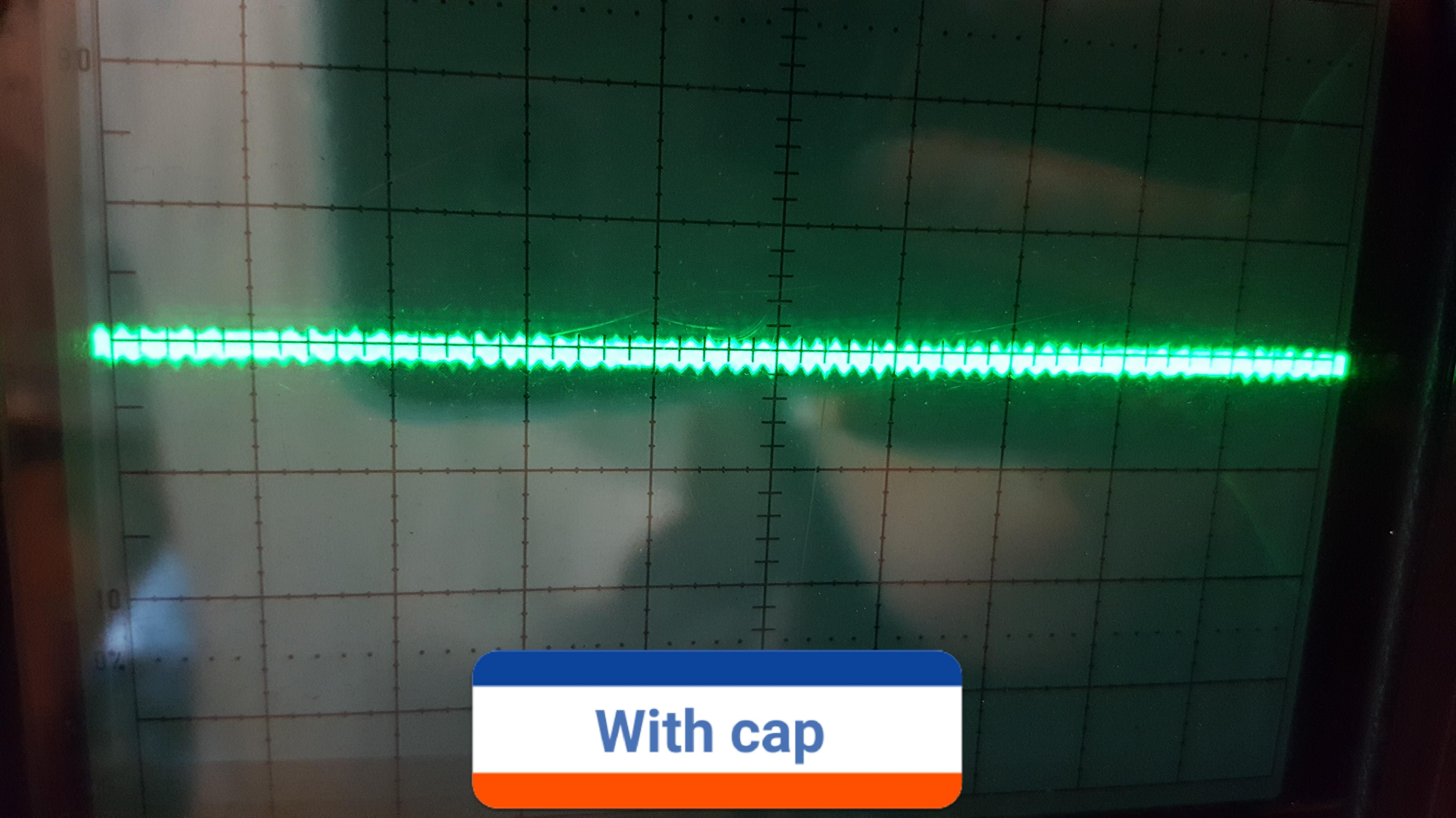

In the pic below is the signal on the speaker terminal with no audio injected I also noticed if I do twist and pull on the inductors fairly hard it will clean the signal in the pic below up or cause it to get fuzzy again but it does the same when I move around power wire to amp
SCOPE SETTINGS FOR pic below 20mv / 20us x10

For the most part, you evaluate the amount of noise on the output of a class D amp with the scope on 2ms and 5v/div (with or without audio).
