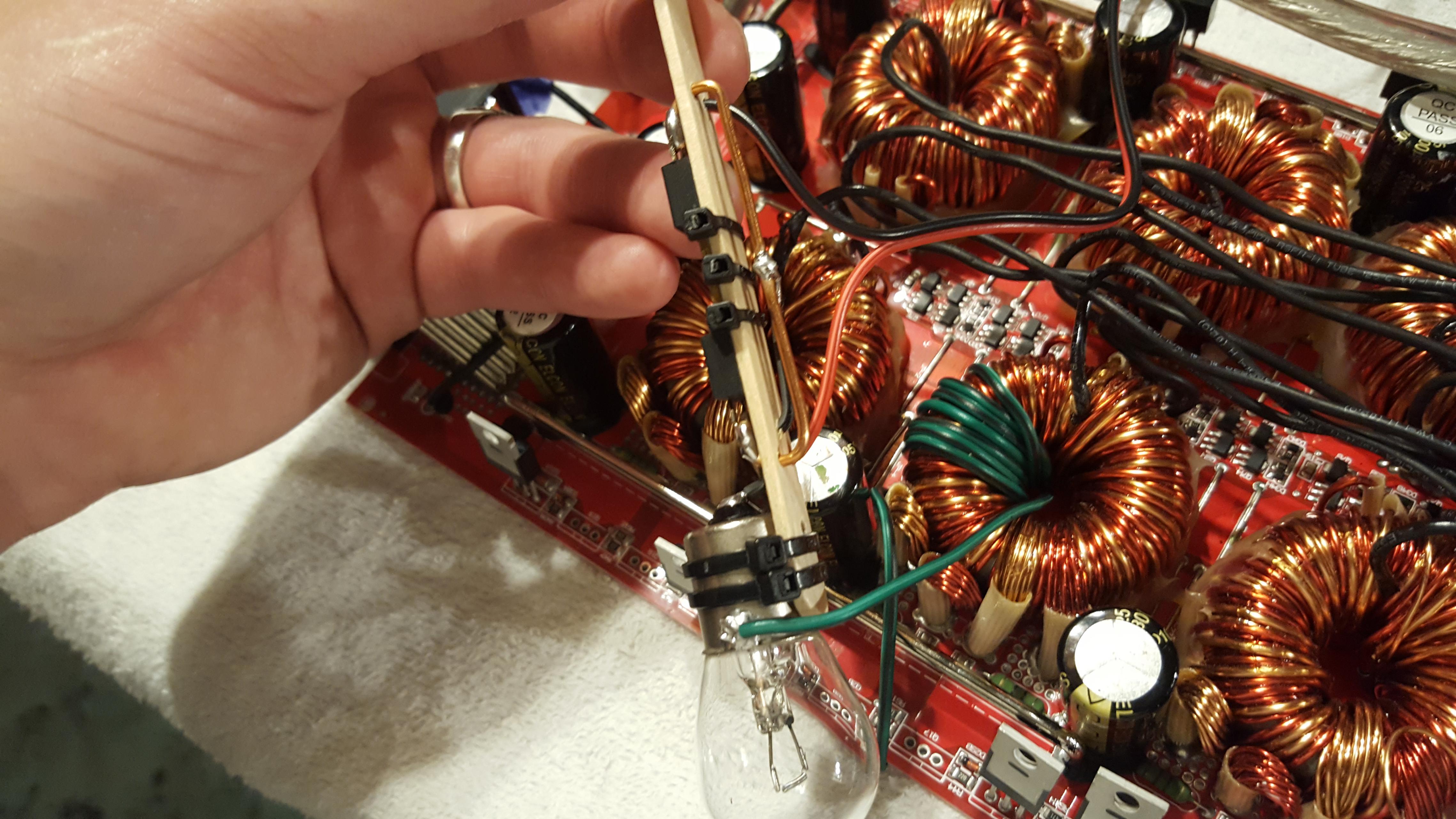

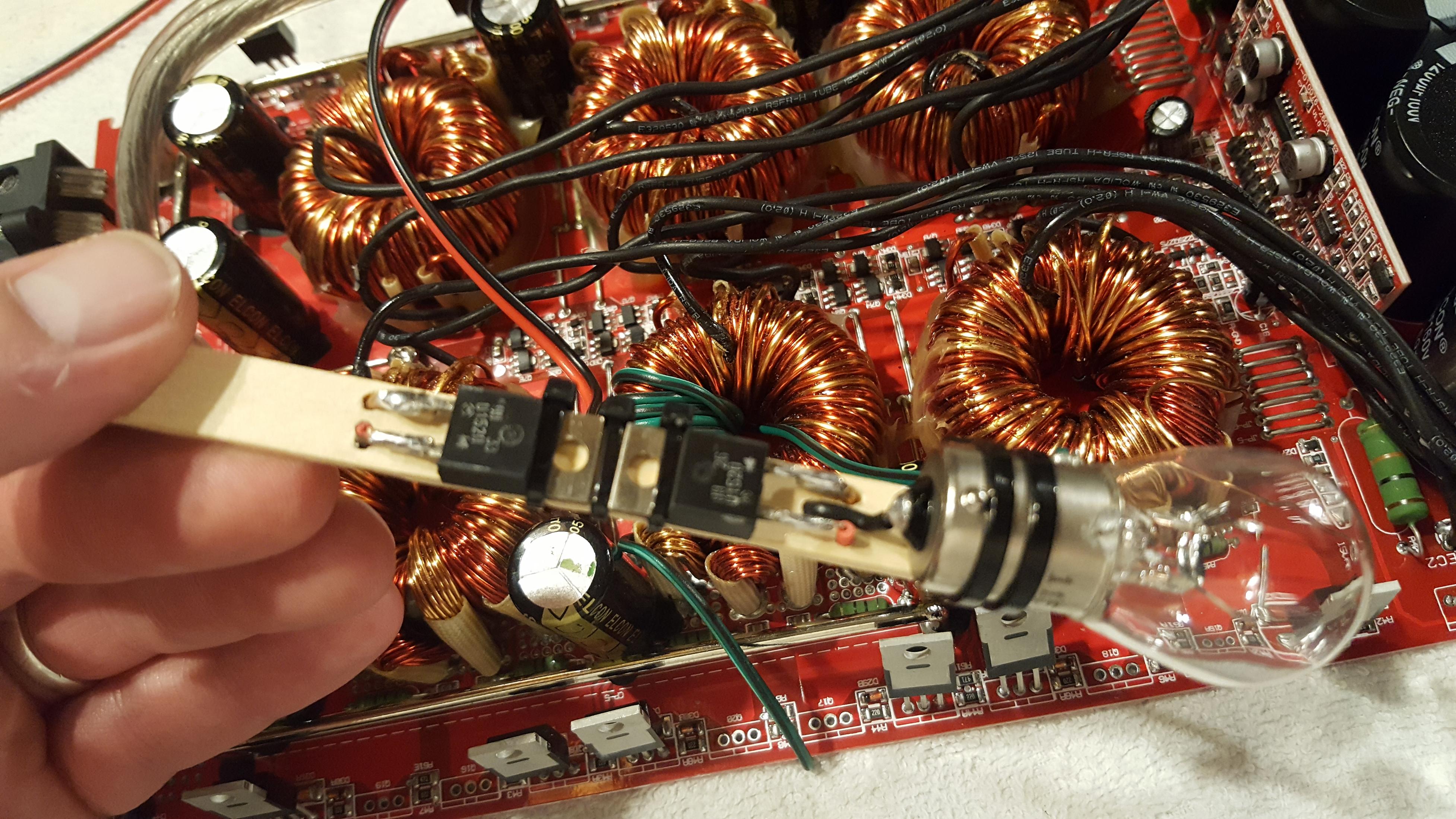

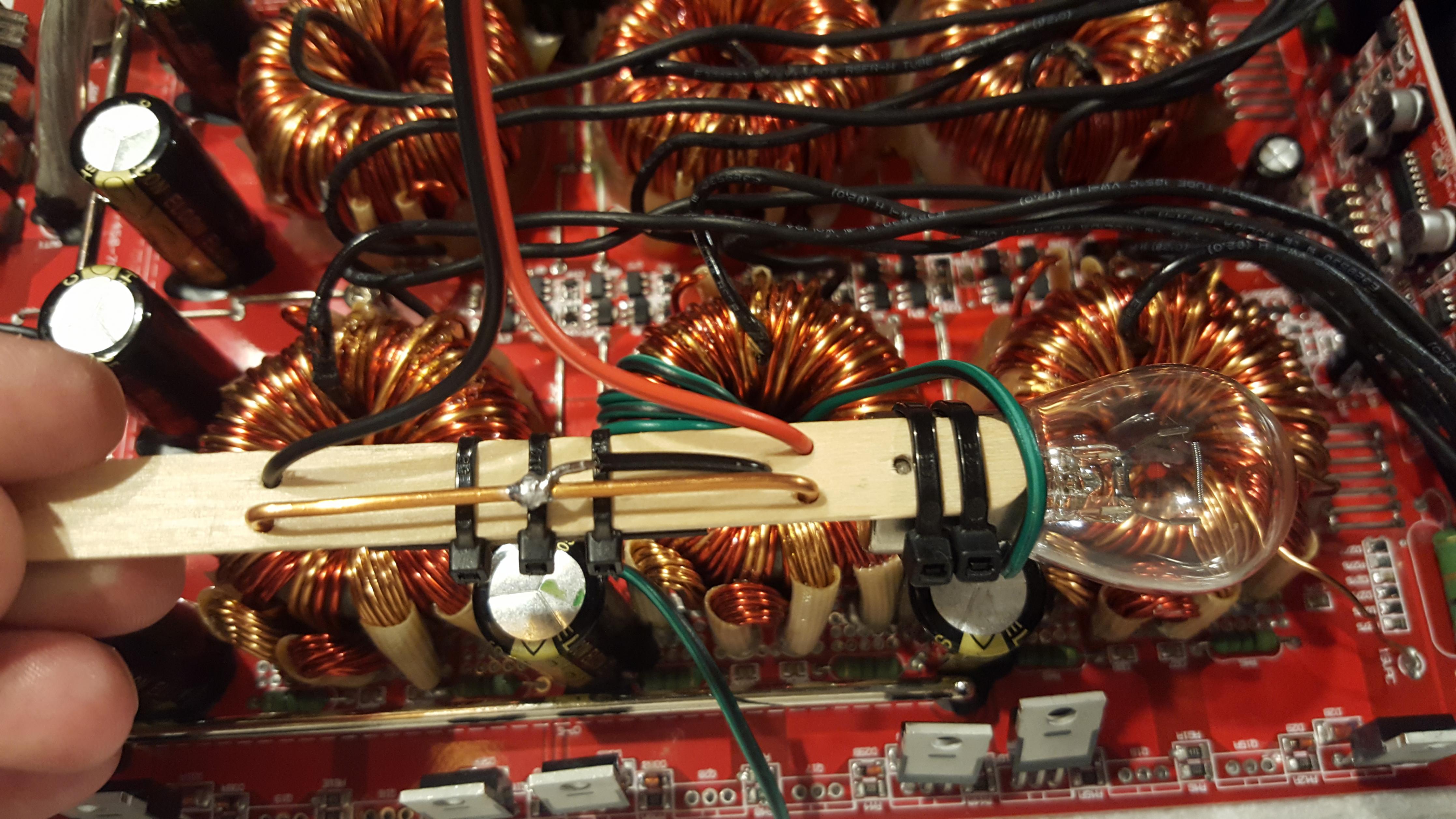

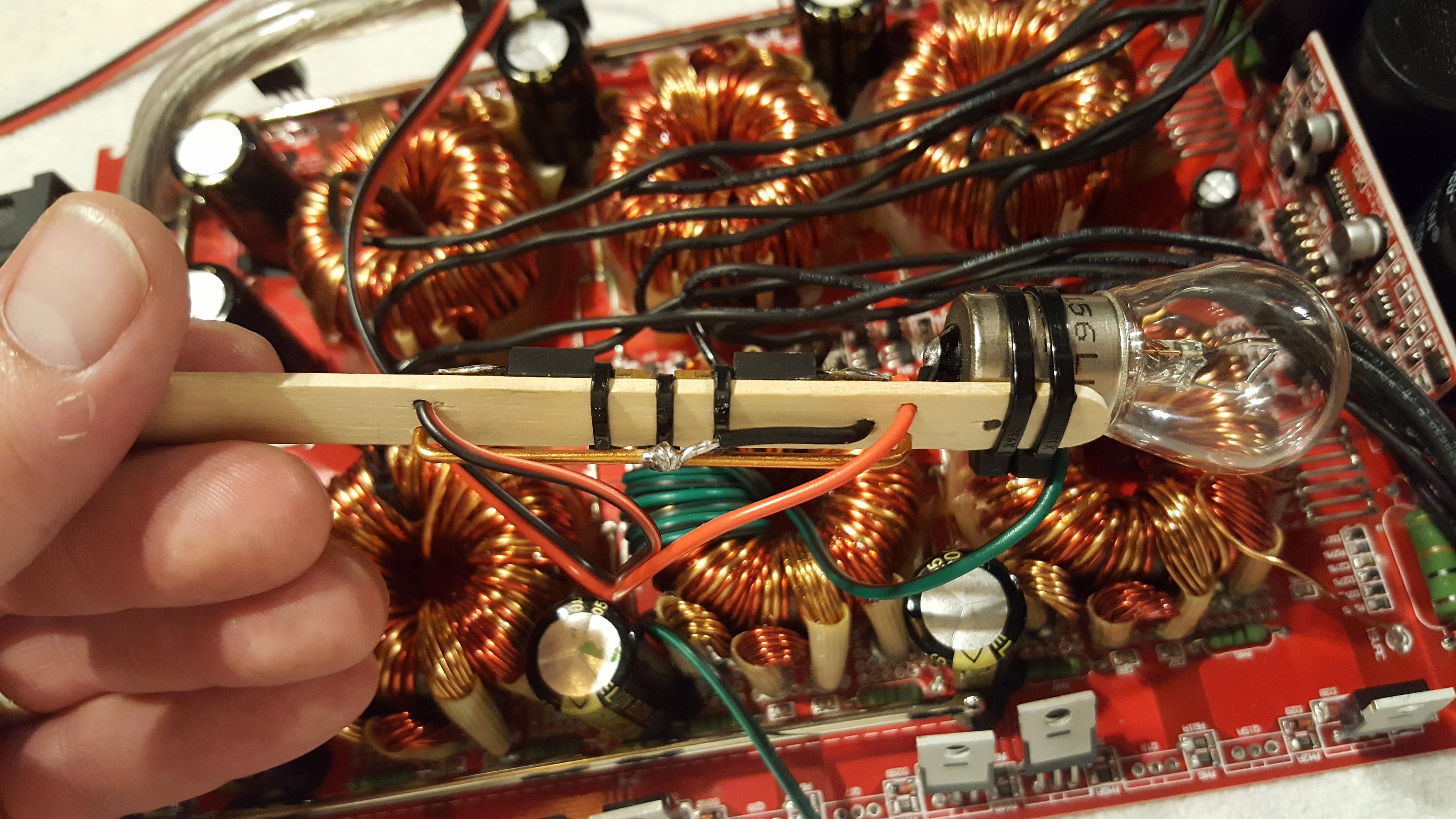

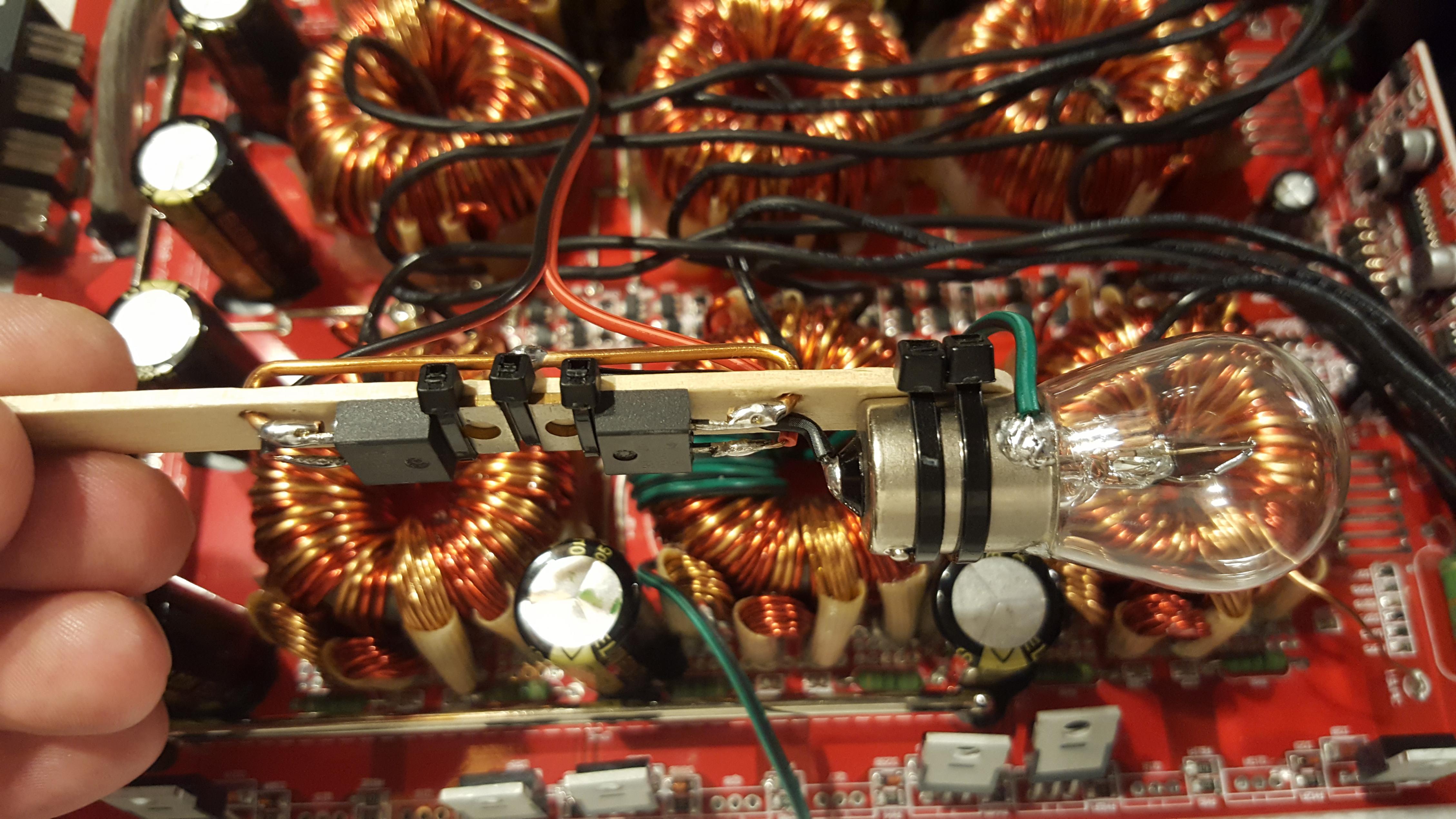

Here's my test rig I made does it look correct I tried my best to build off the info in type 3.
I think it's right. The 1157 is in a different location but should work.
There is virtually no way tat you can do any damage connecting this to the amp so connect it and see if you get the ±15v.
Be sure to connect the positive and negative rectifiers to the right points.
This may seem like a pain right now but after you do it a couple of times, it will take about 2 minutes to set up and it's worth the reduced risk to the outputs and drive stage.
If the primary and secondary grounds aren't directly connected, you may need to place the black probe on the secondary ground.

Yea its a little confusing at times but i want to learn this stuff so bad sometimes i get to a head of myself in my head lol.

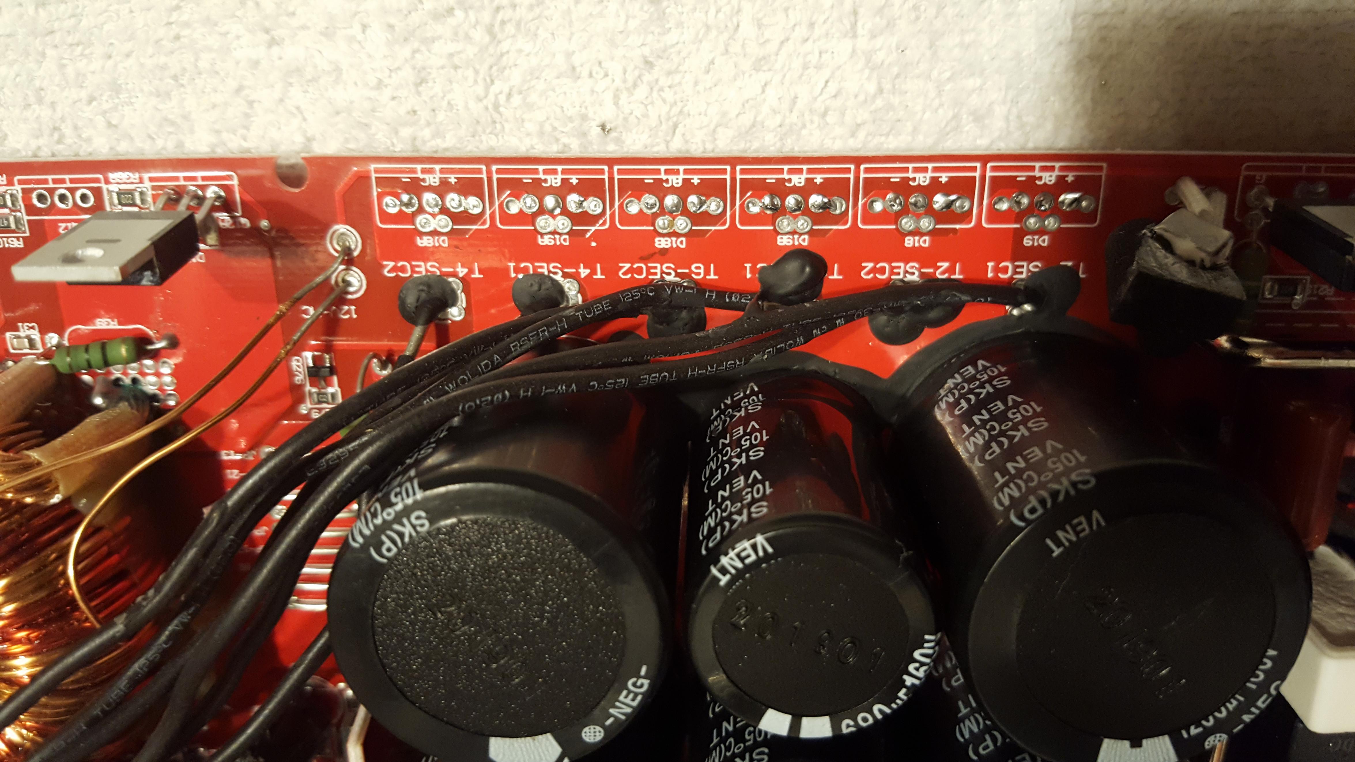

However I am a little unsure were the positive and negative rectifier outs go on the board and dont want to do it backwards
The original rectifiers have same facing diodes so I'm alil thrown can you tell me were my positive and negative would go
Pics below
On the test rig the red wire from diode is positive out and black wire off other diode is negative output? That's what I'm getting in my head.
Pics below
The positive rectifier from the LV jig will go to the pointy end of one arrow. The negative output from the jig will go to the other outer terminal.
Confirm that the positive output connects to the rail cap positive terminals and the negative output connects to the negative side of the rest of the rail caps.

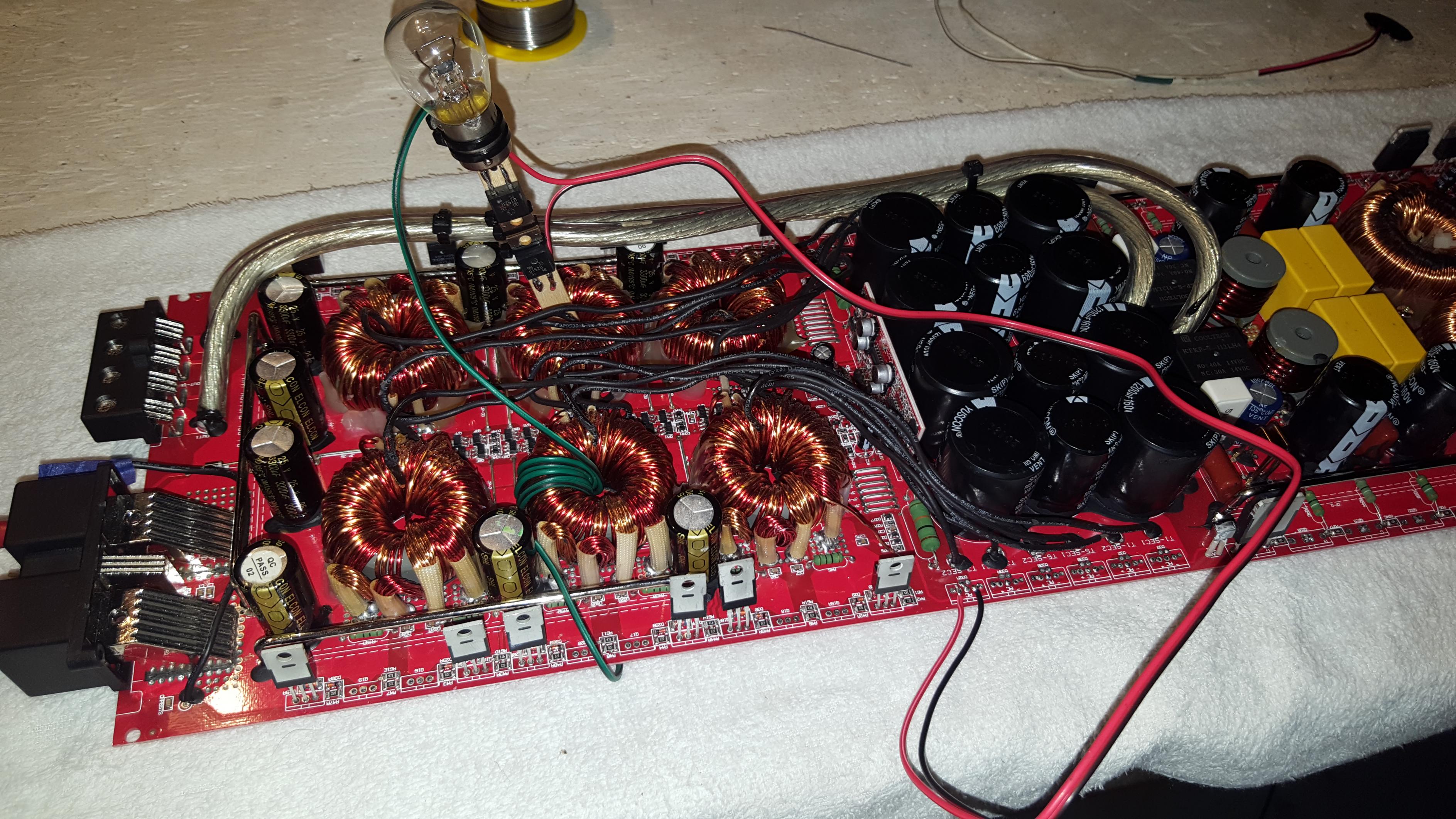

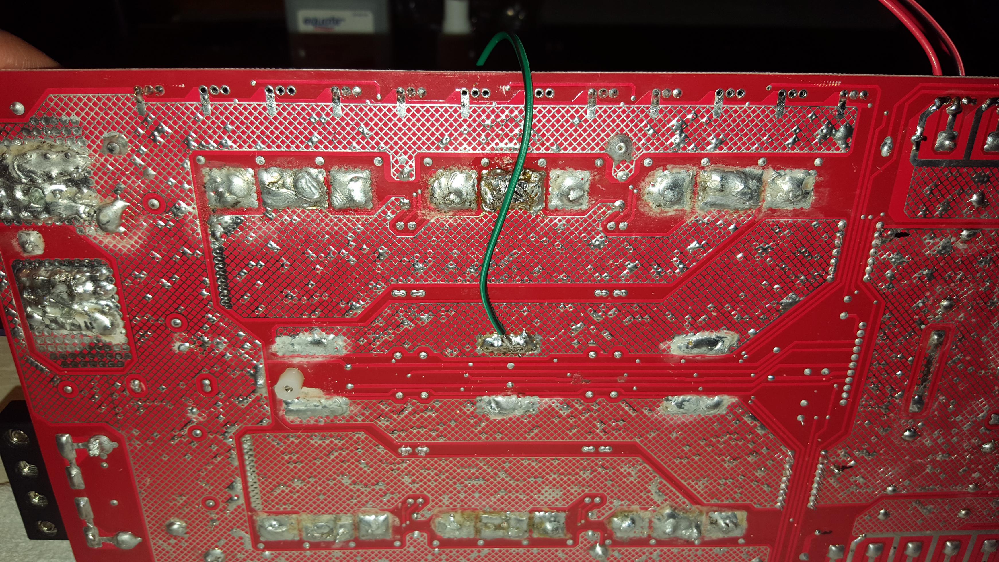

Okay I figured it out I do have a question am I only using the LV Supply on half the rail caps do I need to jump over and power the left side rail caps.

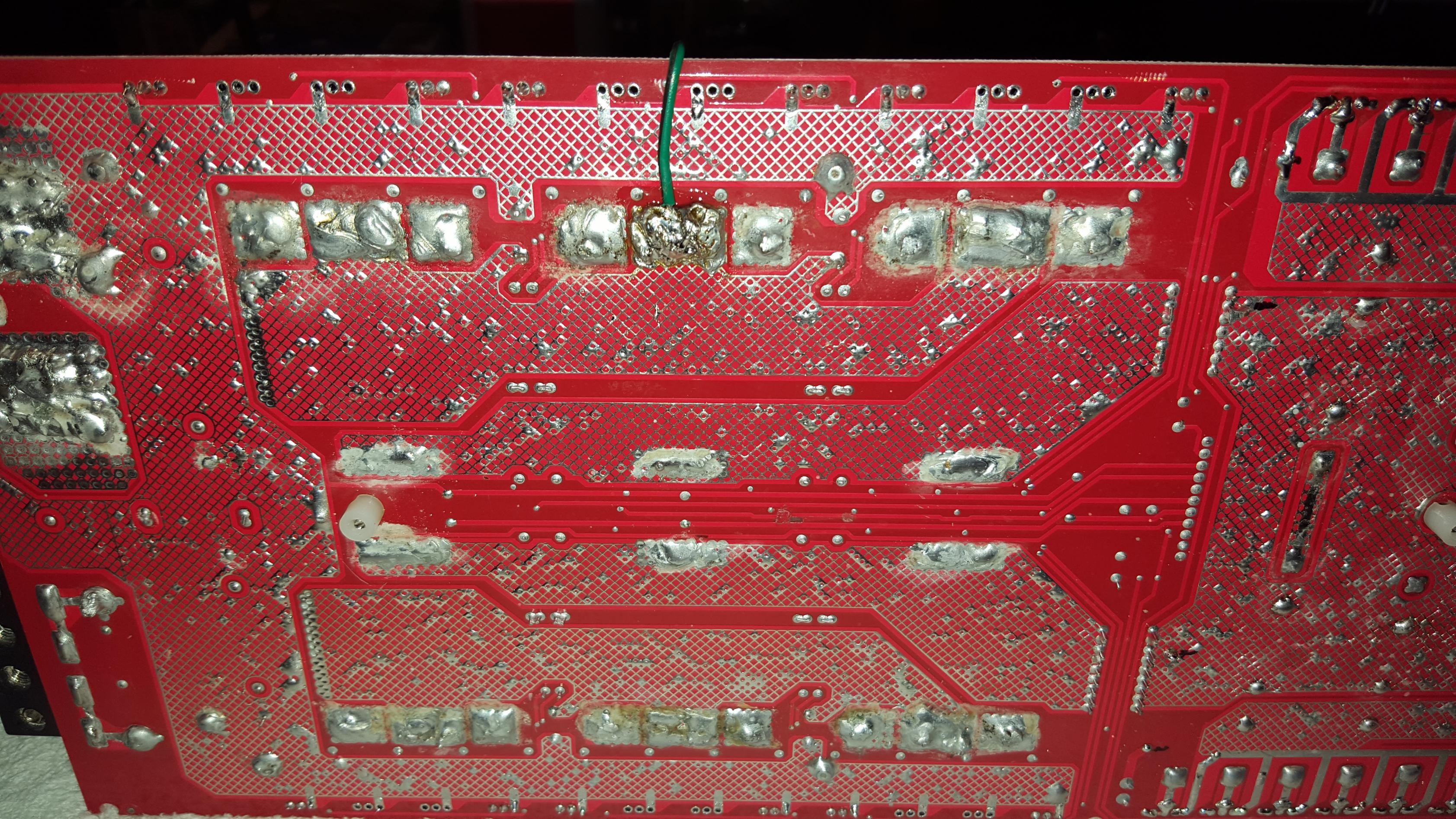

If I'm on the primary in the pic below where is the secondary ground?

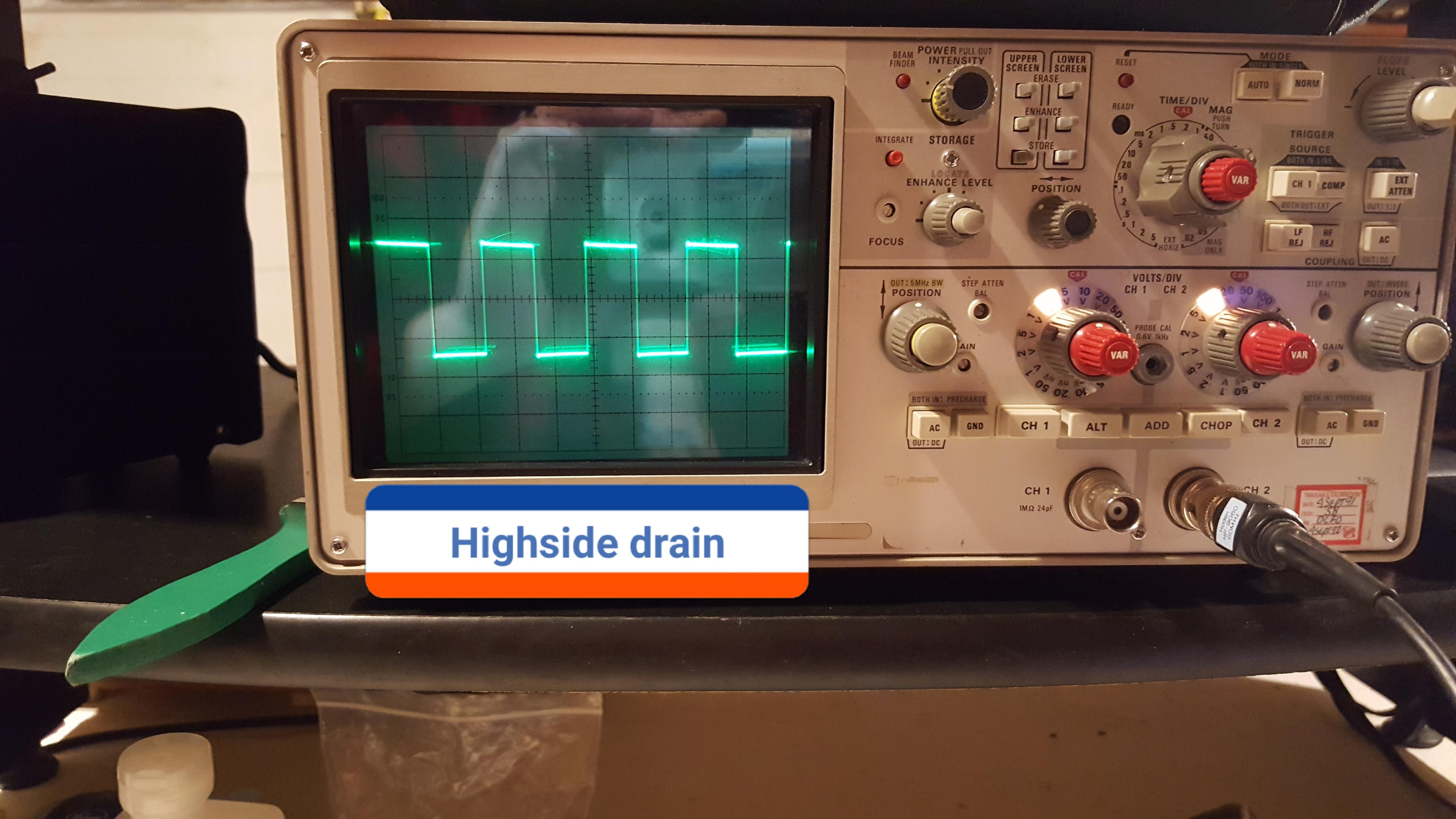

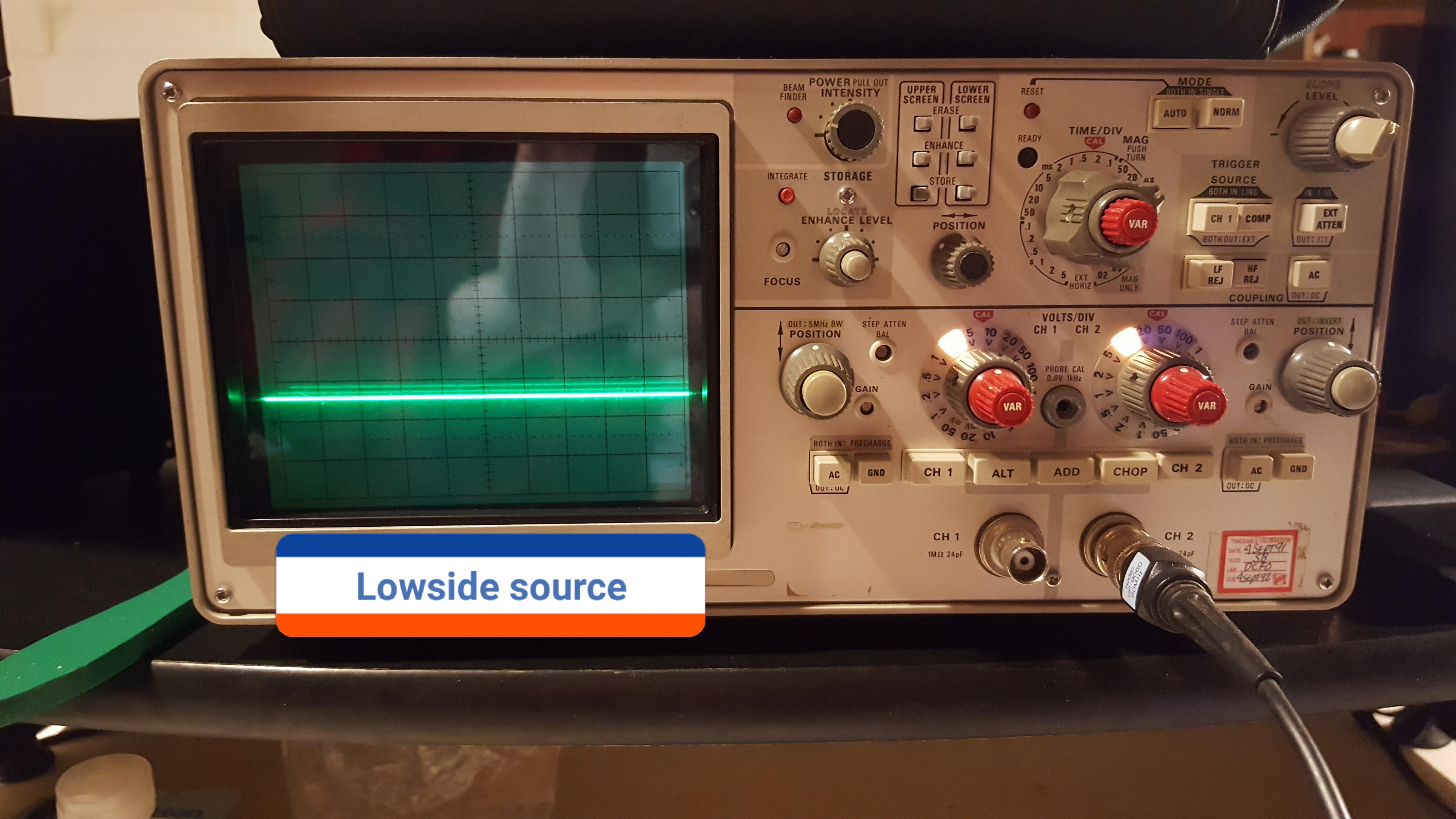

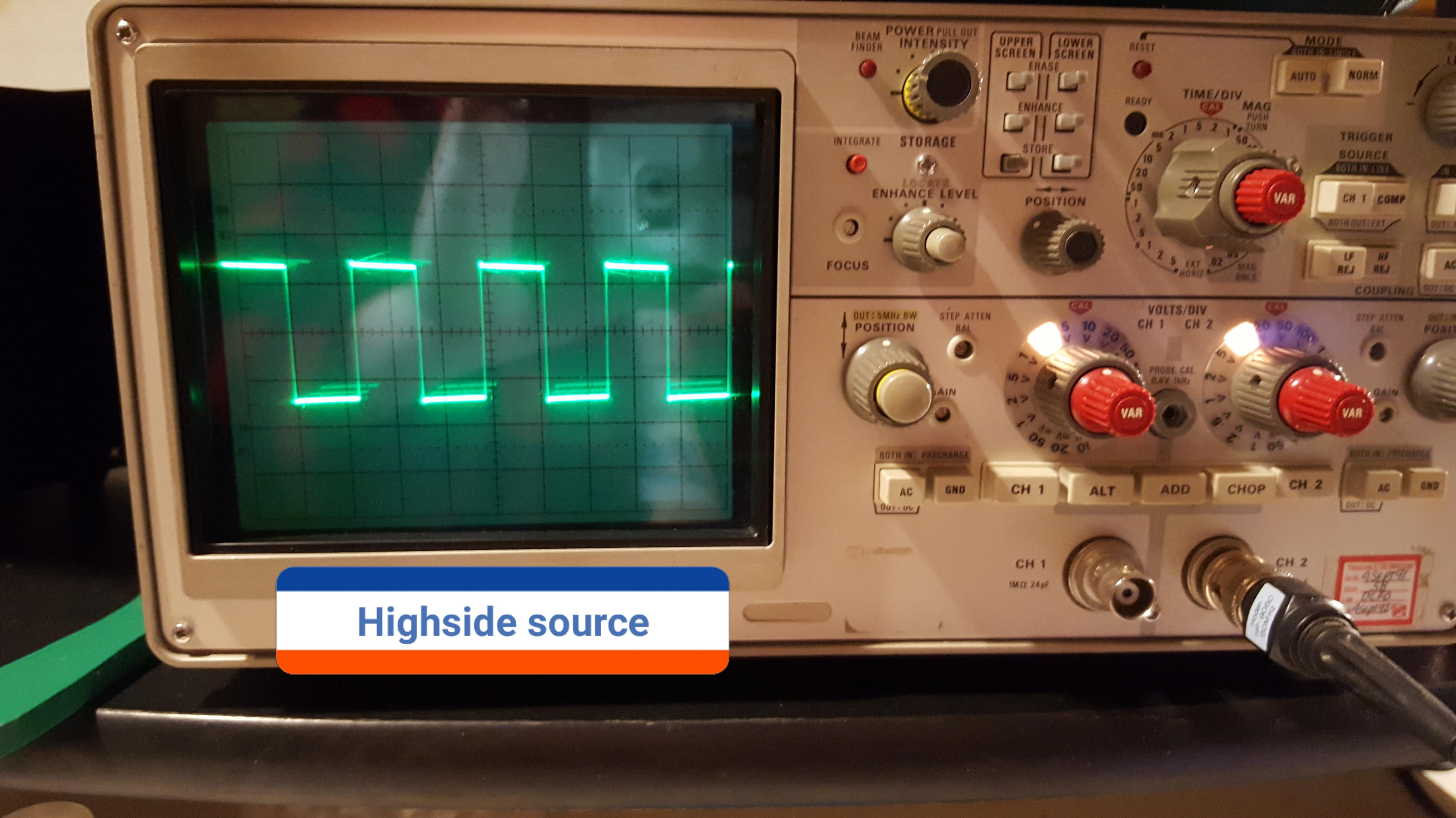

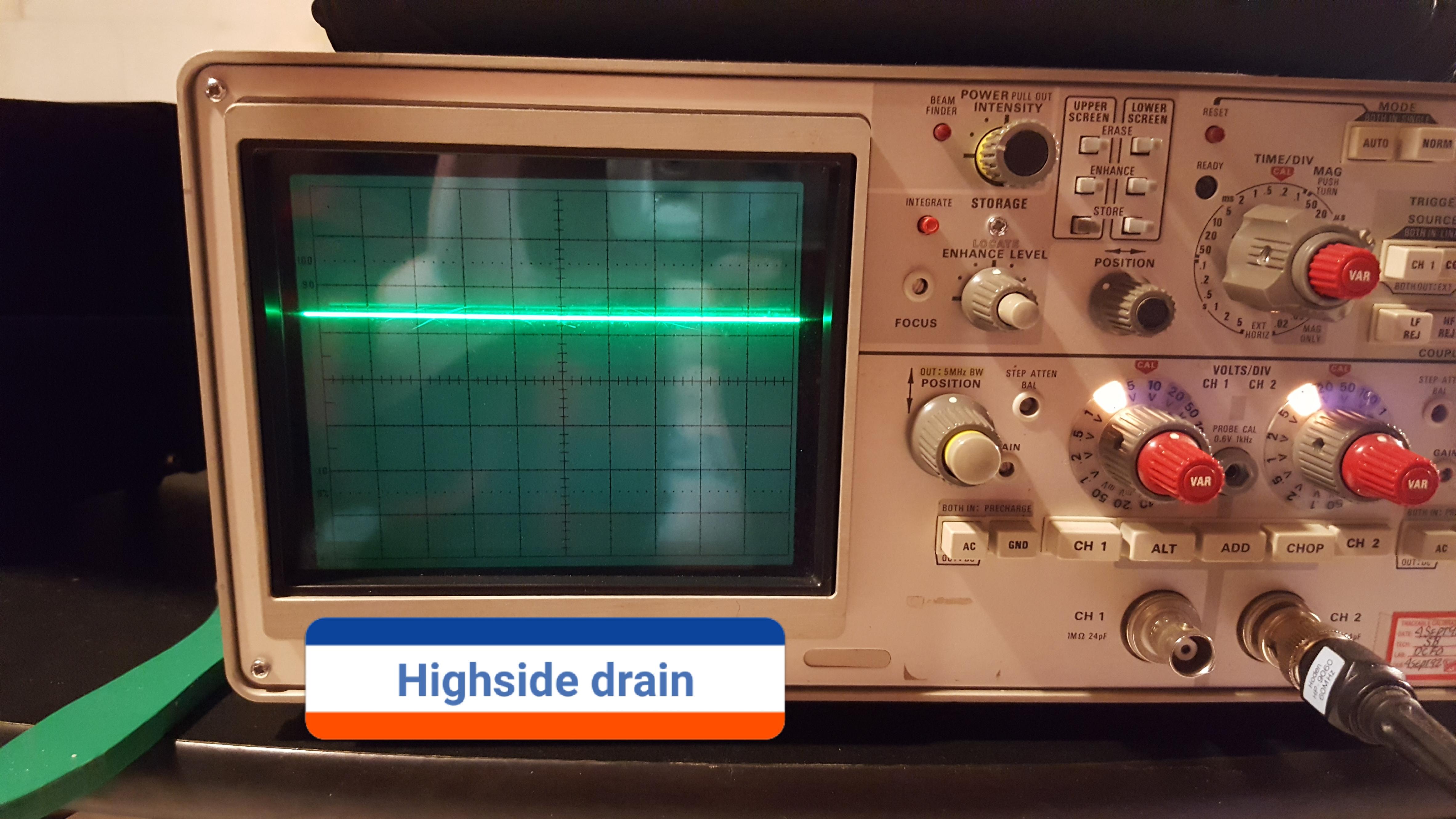

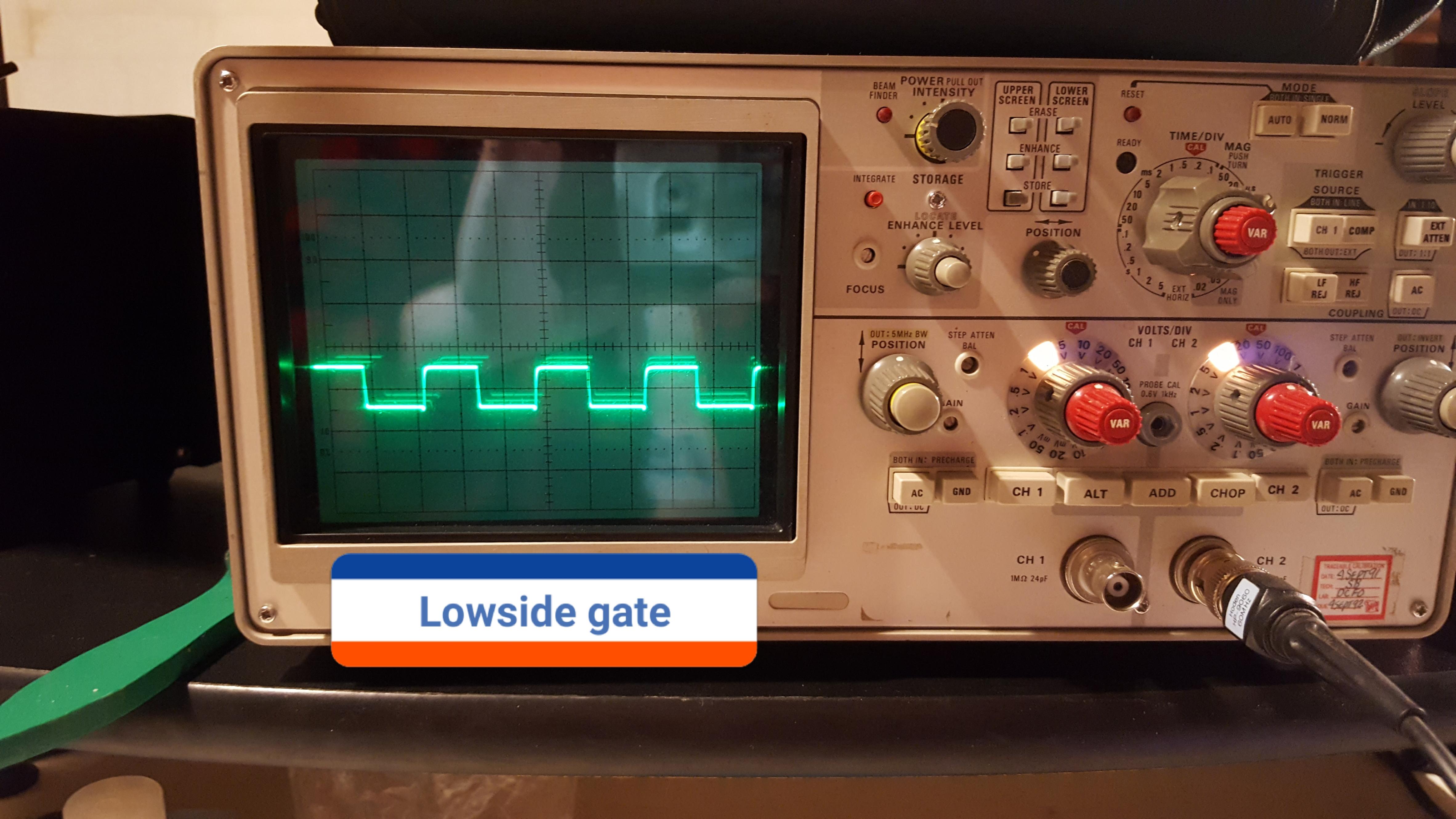

If I measure in dc on the dmm on the outputs I get the following. lowside Source leg I have -16.78vdc and lowside gate -11.47vdc and on the highside drain I have 16.86vdc
I moved from the primary to what I think mite be the secondary in pic below
Ok thats where i moved it to so thats good to know and this how it's hooked up
Just wondering if that sounds about right for voltage measurements for the outputs on the LV supply

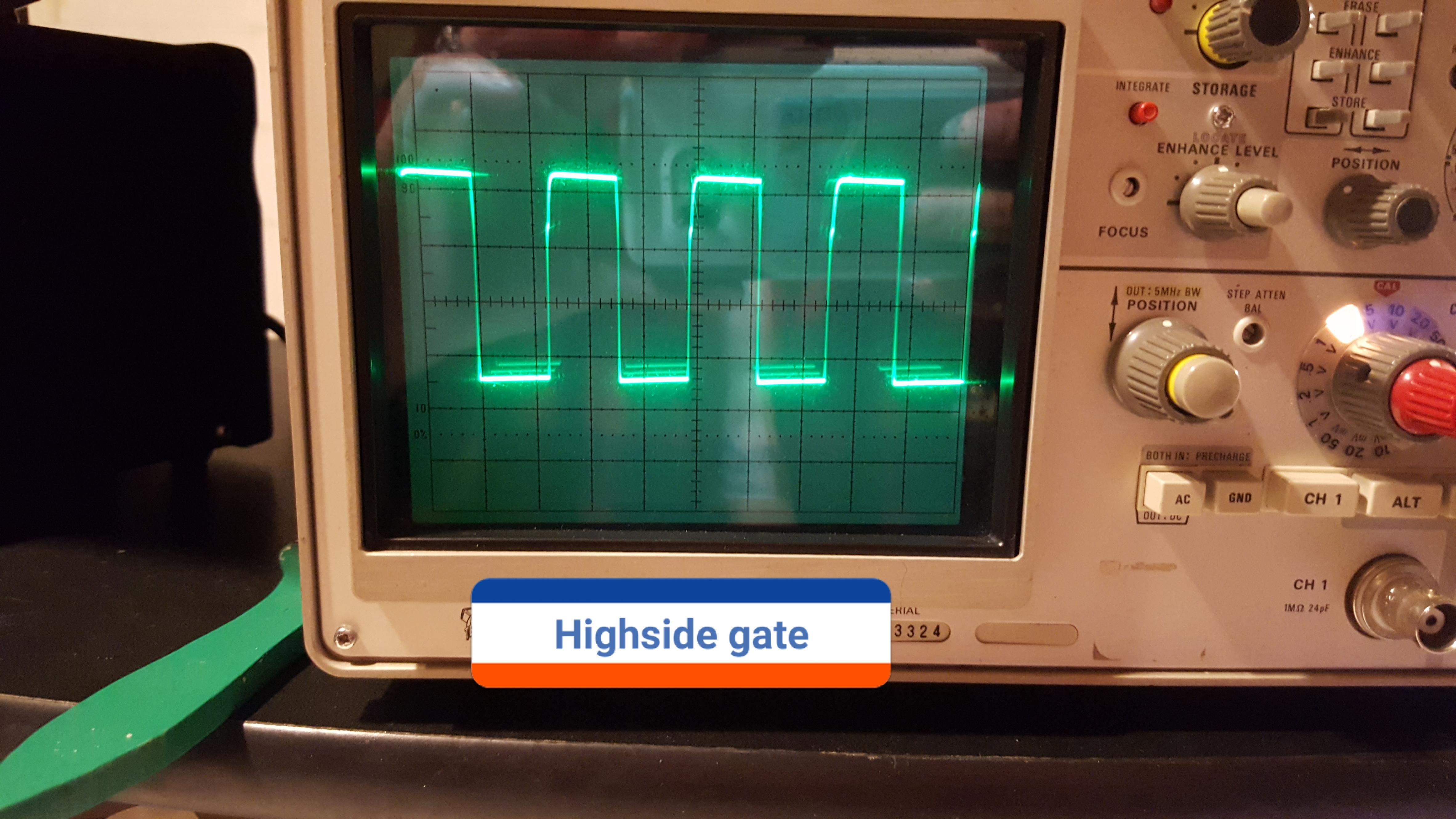

The rails are about right but a DC voltage on the gate doesn't tell me much. Does it have a drive signal?
What frequency?
Do you have rail-rail oscillation?
What frequency?
Here's the waveforms in pics below.
It appears I have rail-rail
How do I see the frequency my scope dosent tell me?
SCOPE SETTINGS ARE 10V 10US
It looks good.
