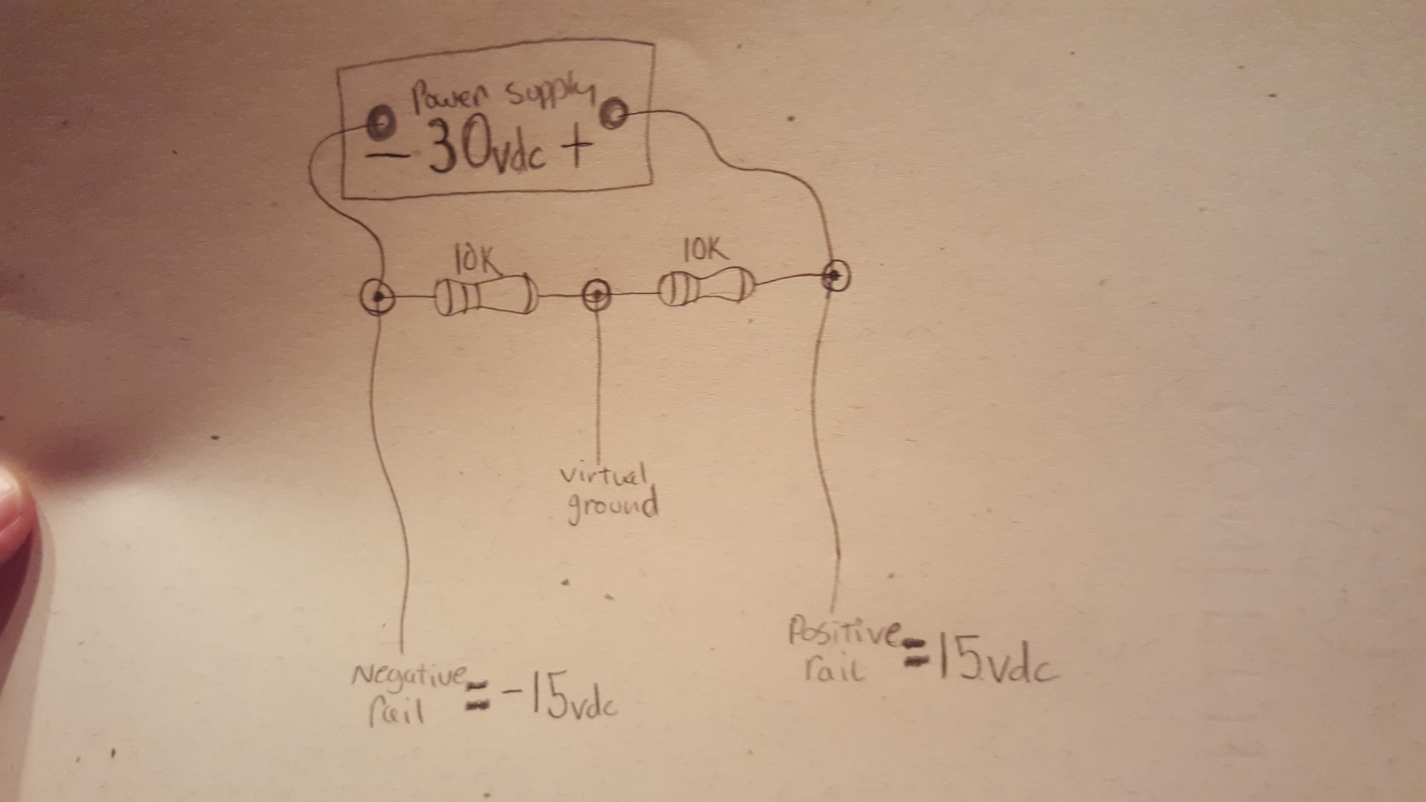

Or should this be where I use the 9v on the negative rail caps
No Perry I haven't I need to order parts for the jig the mr852 and 1157 bulbs
Can i use the 9v battery for testing
I might have to consider making a different power supply other then using a transformer from this amp they are all covered in silicon very well

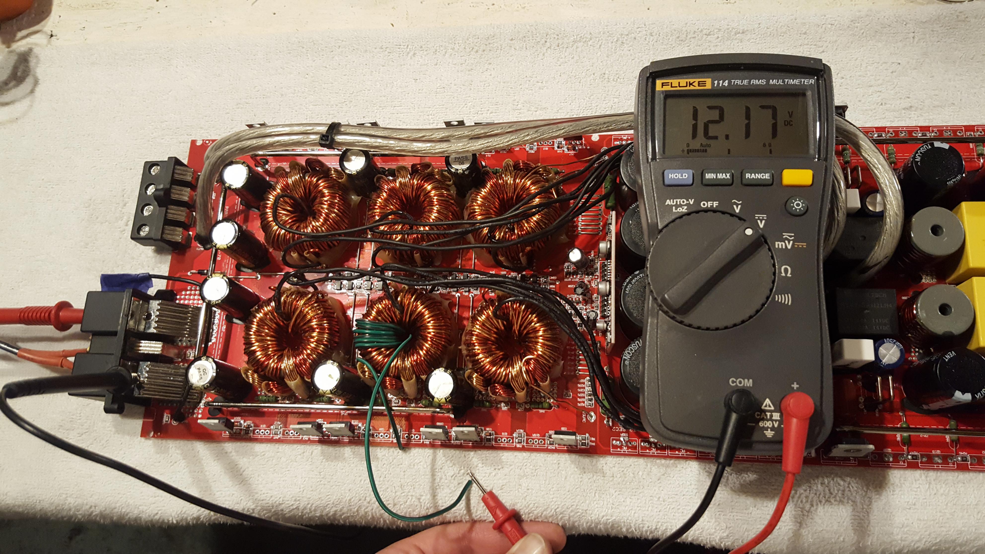

Hi Perry so I have wrapped a 22 gauge length of wire around one of the transformers i had 5 wraps it read 12vdc so I put another wrap which now makes 6 wraps and it's essentially the same it reads 12.7vdc and I have no more room for more wraps it was very difficult to get it 6 around it any suggestions
Pic below.
Pic below.
That's the primary CT. Confirm by measuring resistance to the B+ terminal.
You will still need a rectifier and cap. If you just use a rectifier and connect to the output of the original rectifier (originals out of the circuit), the rail caps will be the cap that you need.
You will need to back the turns down from 11 to stay around 15v DC.
