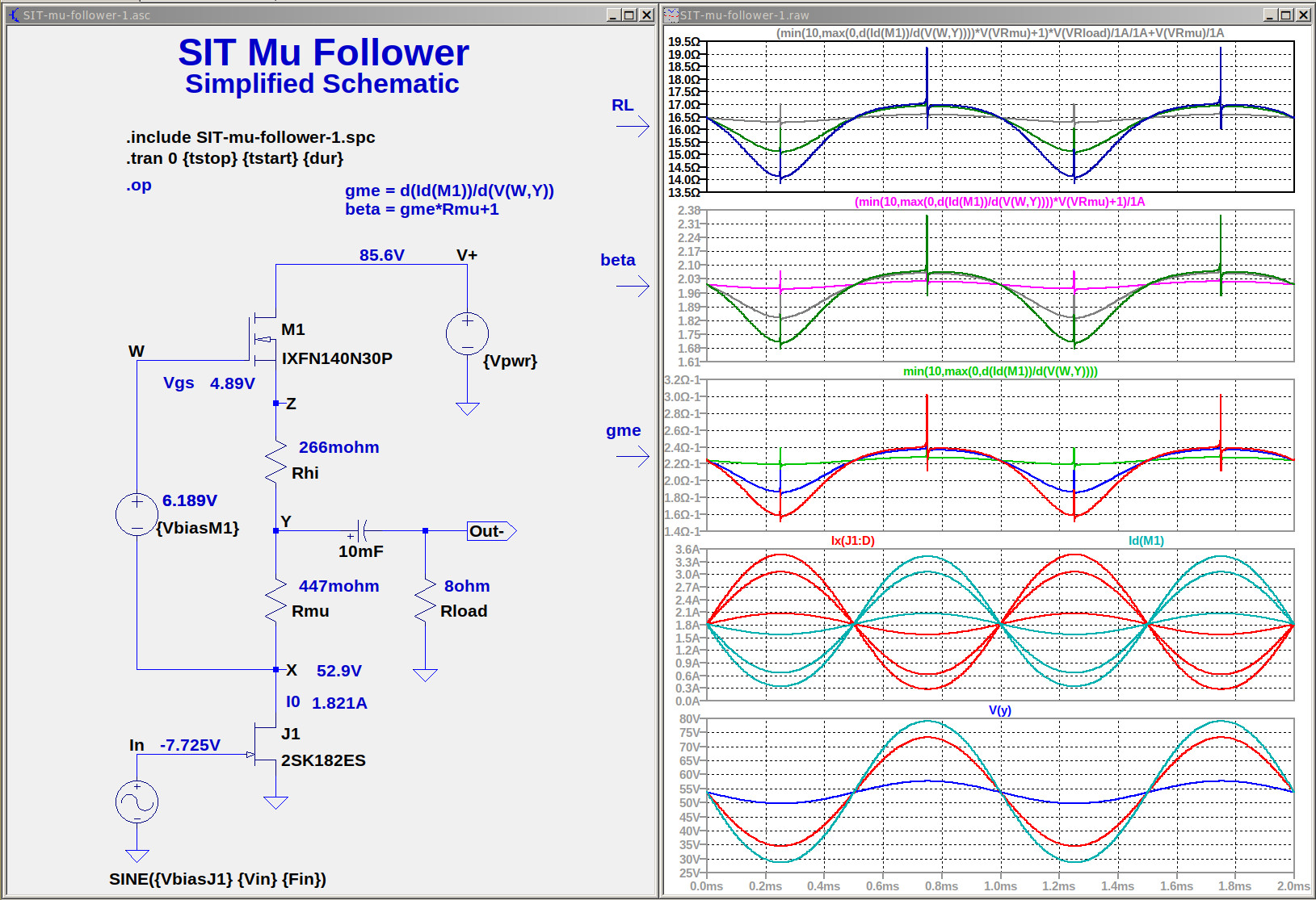

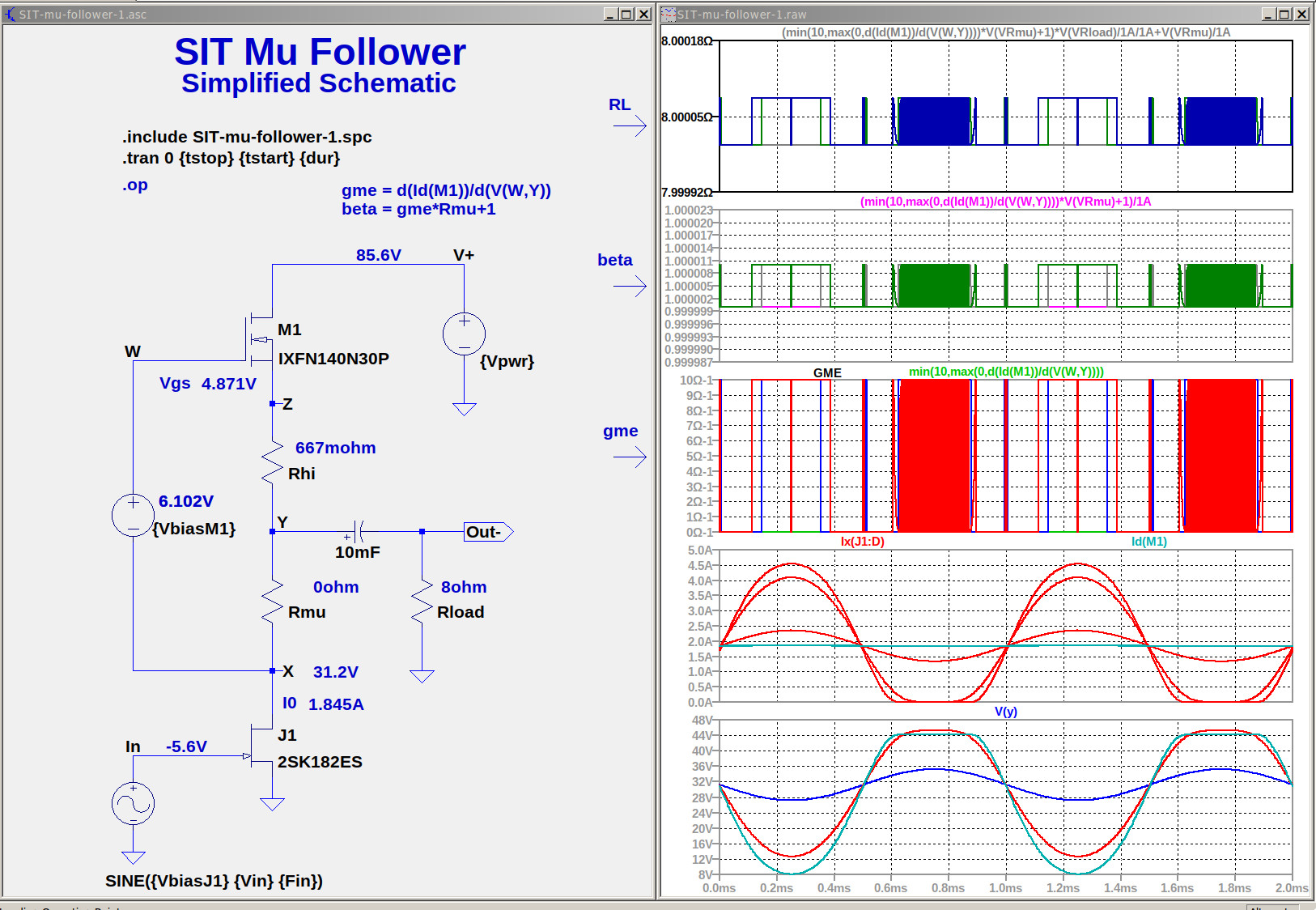

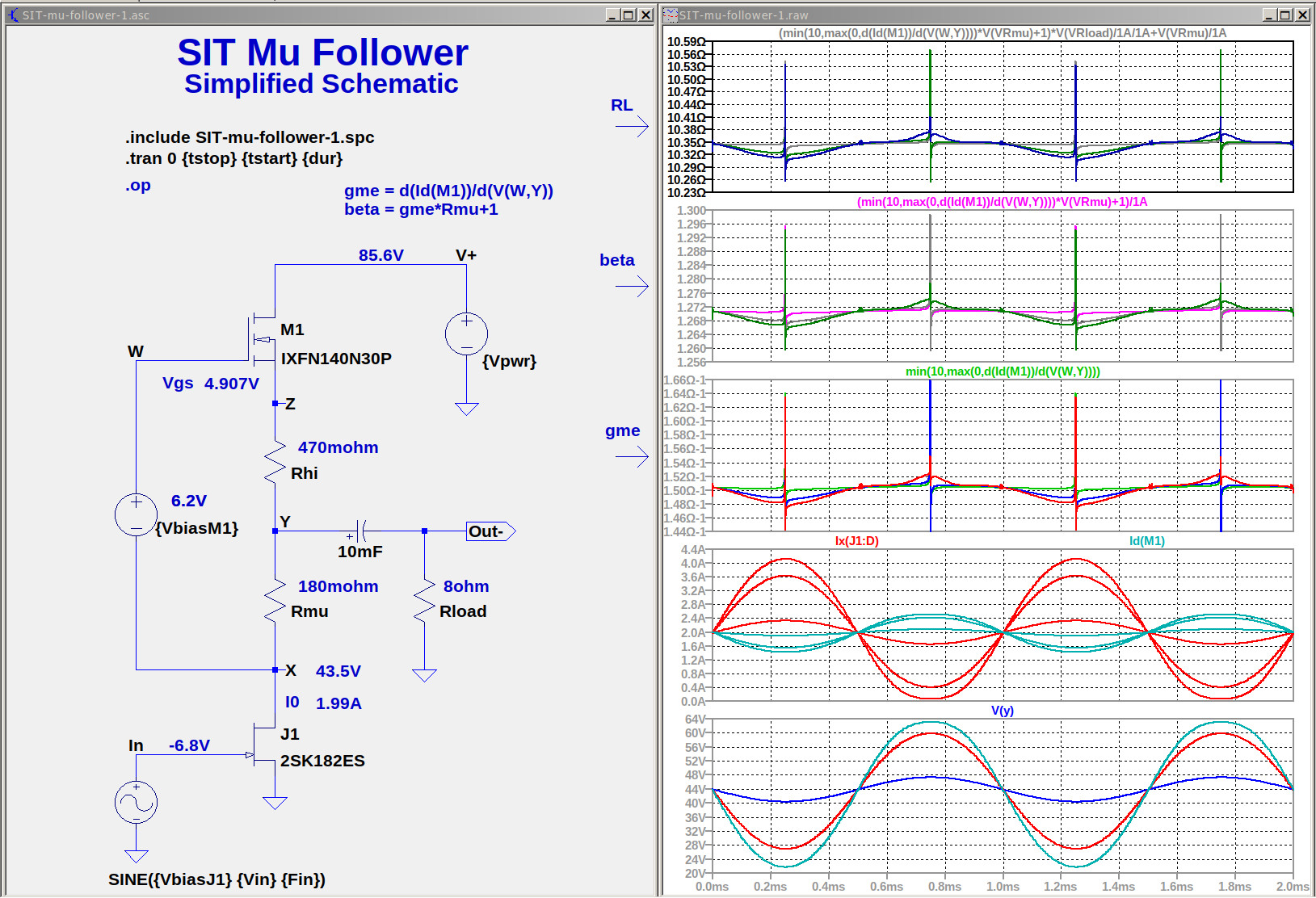

SIT MU Follower Large Signal Behavior
Here are some interesting simulations showing the behavior of the mu follower output stage for a variety of circuit parameters. These simulations agree fairly well with actual bench tests, even though the 2SK182ES SPICE model is in poor agreement with my actual devices.
Although the circuit shown below has been maximally simplified, it captures the behavior of the real circuit. The simulations show that at high power levels the mu follower current gain (beta) an the dynamic load on the SIT (RL) are not constant.
The plots below are at 1 Watt, 25 Watts, and 45 Watts into an 8 Ohm load. From top to bottom the plots are: RL, beta, gme, Id(M1) and Id(J1), and V(Y).
In the first image, the mu follower operates as a constant current source, where beta and RL remain constant. The amplifier clips slightly before reaching 25 Watts. This is representative of the FirstWatt SIT-1.
The remaining images show the behavior for different combinations of Rmu, Rhi, I0, and X0.

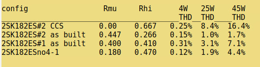

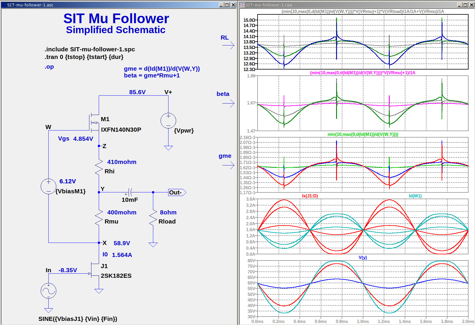

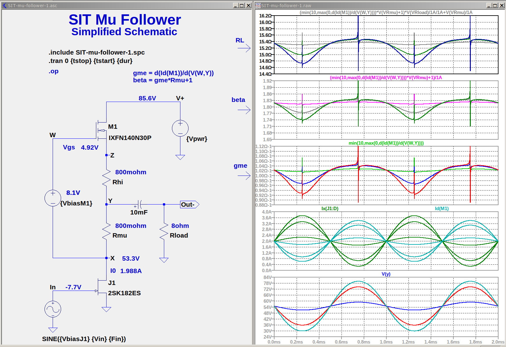

The 2nd image is the left channel of my build shown in posts #16-#19, with Rmu=0.447R Rhi=0.266R. What should be noticed is how much gme, beta, and RL vary at high power levels.
The 2nd and 3rd images show simulations of the left channel and right channels respectively of my build shown in posts #16-#19. What should be noticed is how much gme, beta, and RL vary at high power levels.
The 4th image shows a simulation at a much lower beta of around 1.26.
The last image constains a summary of the THD levels in the simulation.
Conjecture:
As beta increases, the mu-follower behavior will differ from the pure single-ended triode of the FirstWatt SIT-1, probably affecting how it sounds. The design goal should probably be to keep beta as low as possible consistent with achieving a given power level wuithput clipping.

Conjecture:
consistent with achieving a given power level without clipping.
SIT-2 prototypes explored this behavior and I ended up with a value
that was close to a constant current source.
While not using a mu follower, the SIT-3 exhibits a similar sort of
behavior, and the result is a preference for loads in the 4 to 8 ohm
region, even though it measures well at higher impedances.
Here is an example of high mu follower gain and enough degeneration of M1 that beta doesn't vary much. The primary downside is that the Zout (amplifier output impedance) is increased a bit.

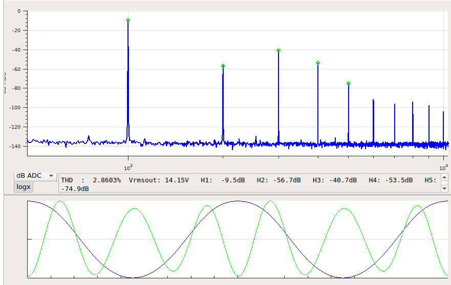

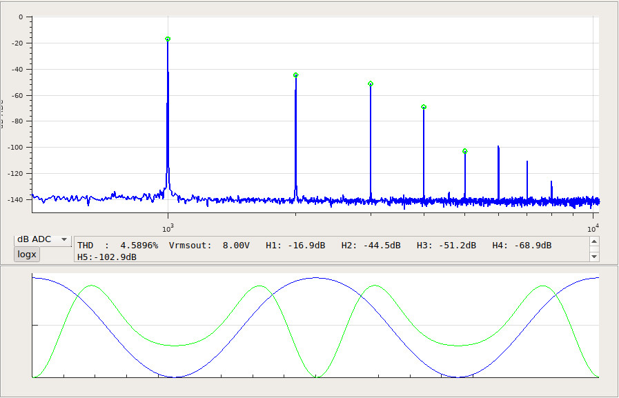

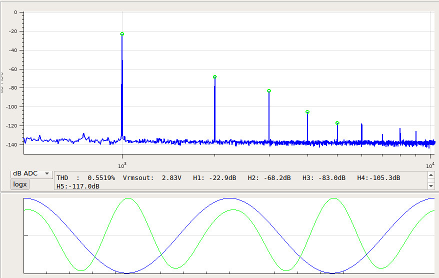

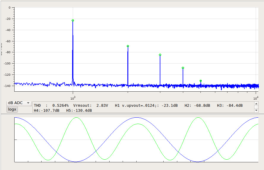

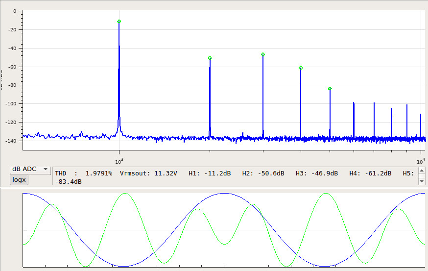

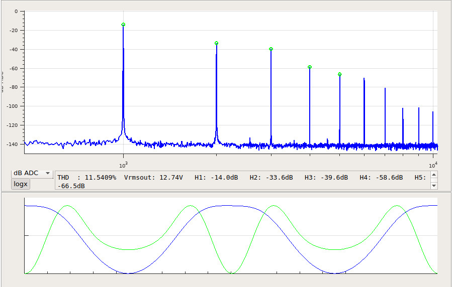

I am posting some measurements I made today one of my 2SK182ES SITS in a mu-follower with no gain. It should behave much like the FirstWatt SIT-1 with the SIT Vds adjusted for an H2 minimum into a 6R load. The bias current is 2.5A.
The first set of plots is into an 8R load at 1W, 16W, 25W and 40W.

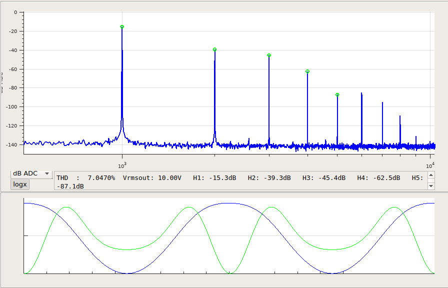

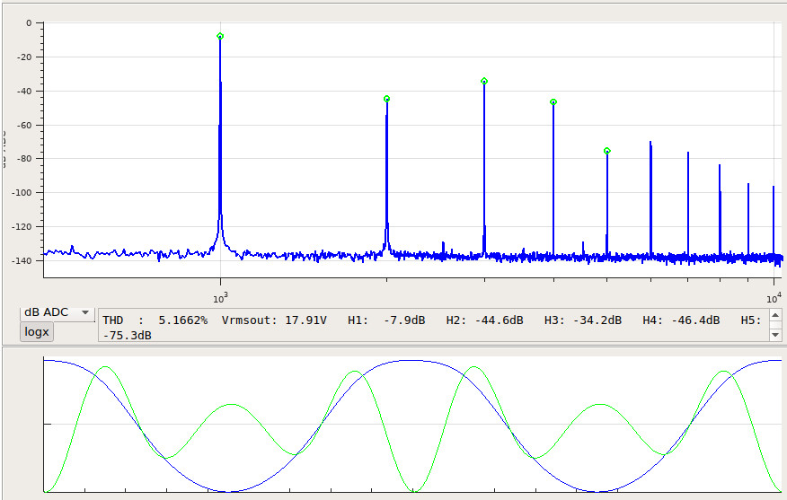

This second sets of plots is into an 4R load at 1W, 16W, 25W and 40W. Again at 2.5A bias current.
just to rehash that, for us less talented in 3R - that means plain CCS (no current gain in load)

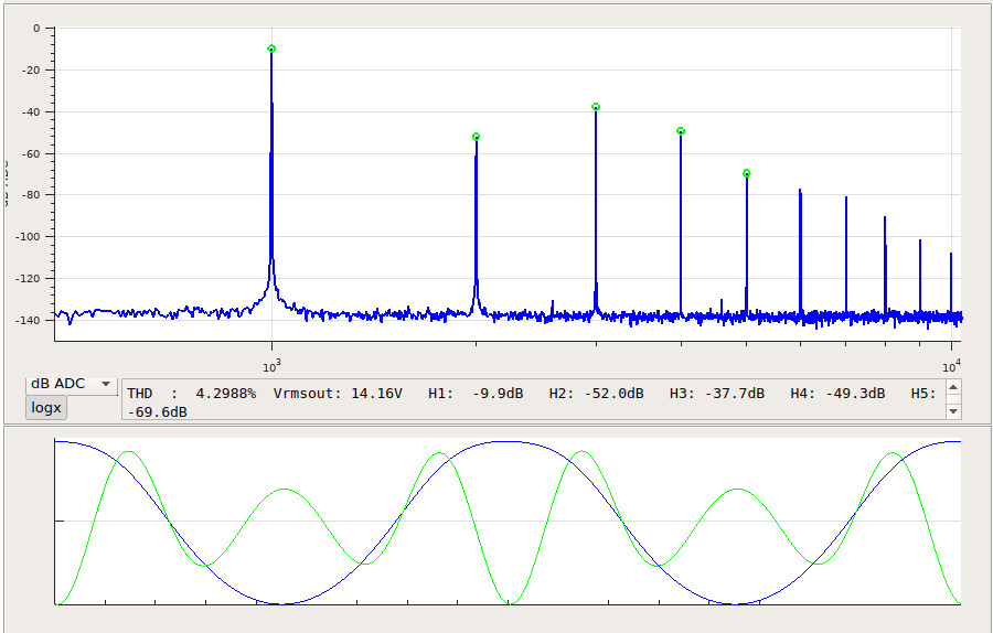

Yes. The output capacitor was connected to the bottom on the resistor ladder -- the drain of the SIT. I will show some additional spectral measurements with a modest mu follower gain of beta=4/3. This means the PPR (pullupAC/pulldownAC ratio) = beta-1 is 1/3.
My six Tokin 2SK182ES SITs all show the behavior shown in post #3 SIT measurements, Mu Follower, and amplifier build. I have been choosing mu-follower parameters so that the amplifier has a sweet-spot with an output load of 6R. This results in similar THD (and spectra) at both 4R and 8R output loads (but with opposite phase of H2).
Plots like shown in post #3 allow one to estimate the SIT operating point (bias current and Vds) for a given amount of mu-follower gain beta=PPR+1. I will explain the procedure is a future post.

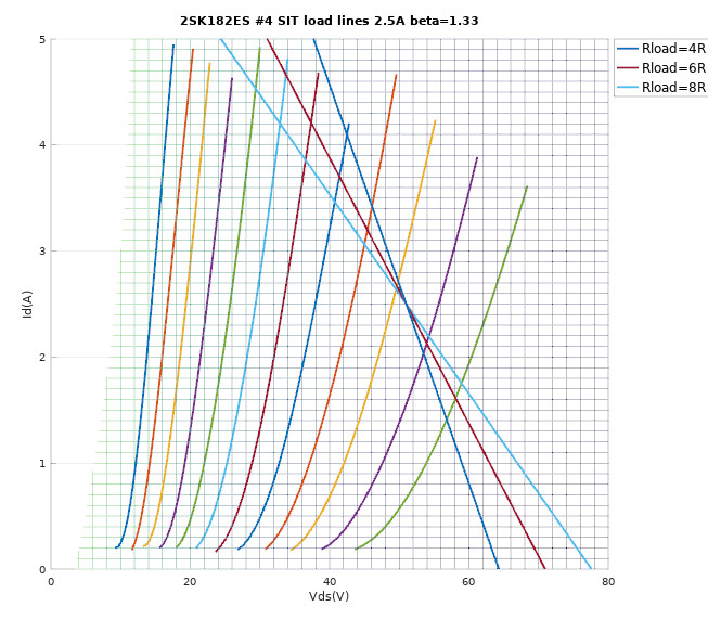

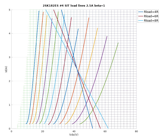

Here is an interesting plot of the SIT load lines for the CCS operating point shown in posts #93 and #94:
More to follow for a configuration with mu-follower gain of 1.33.

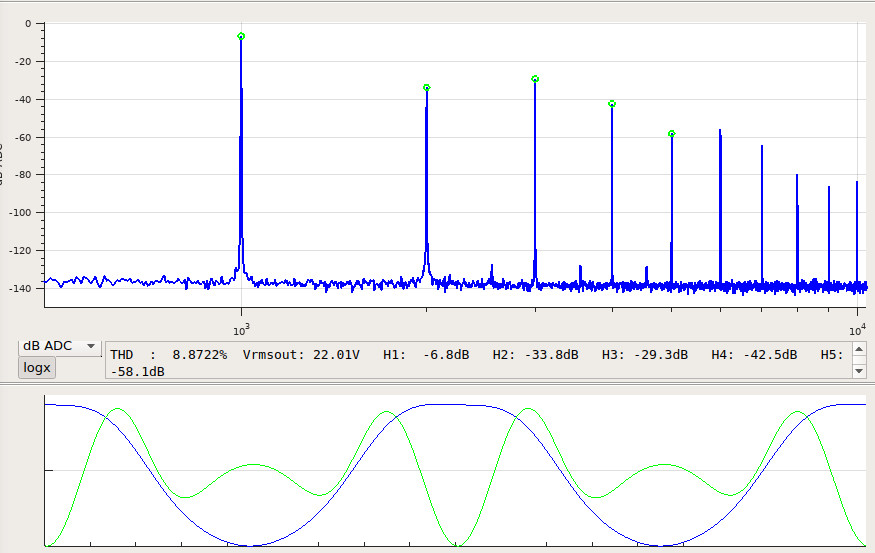

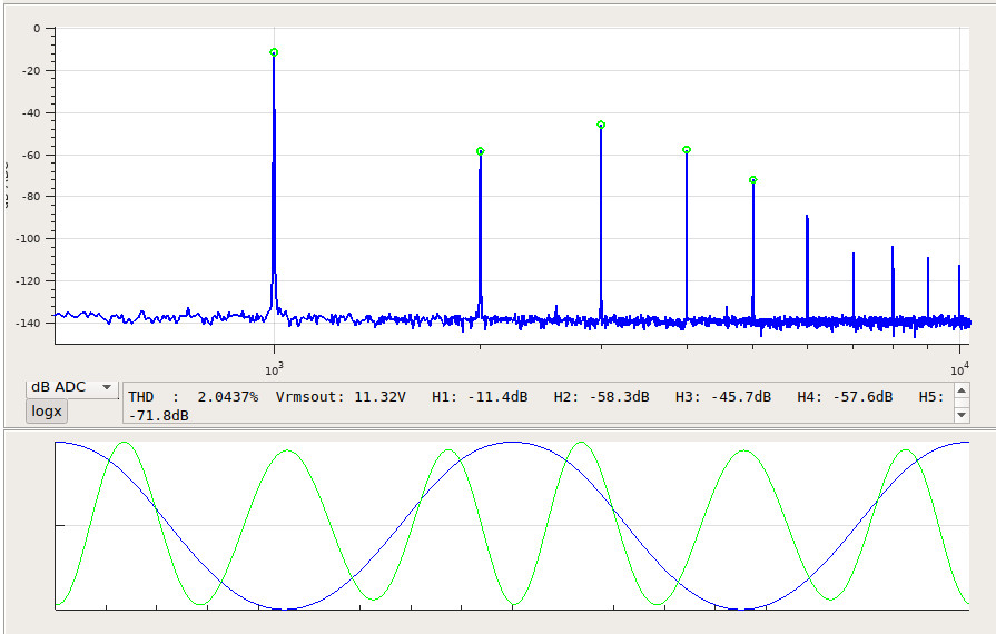

Here are the spectra for an 8 Ohm load at 1W, 16W, 25W, 40W, and 60W:
