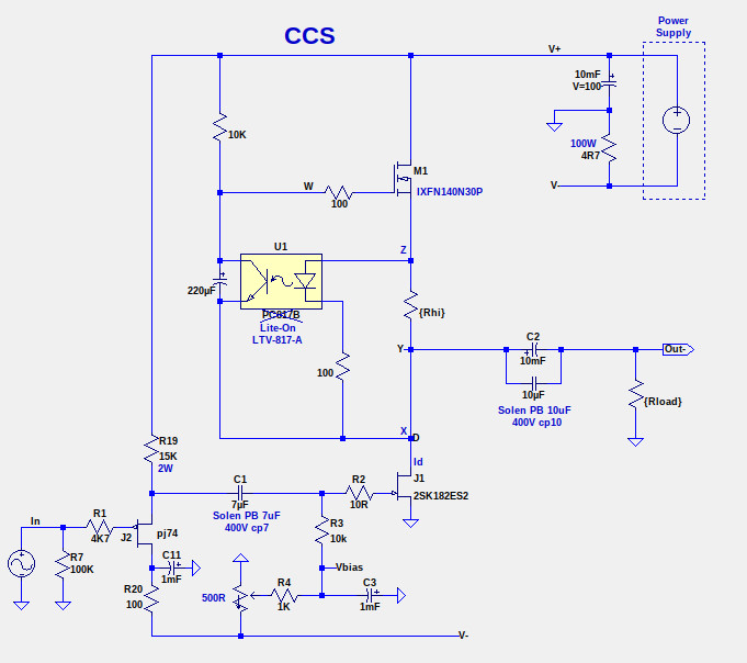

Is that another opto hiding behind the 10,000uF cap between the mystery and unobtainium transistors?
Hawk eyes!
I would say yes!

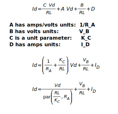

I would also like to understand any physical meaning for the A, B, C, D parameters of the sweet-spot surface, but thus far I have not found any. It is possible to assign physical units however, as shown below. (The notation par(RL/K_C,R_A) is a parallel resistance.)
Are you sure that the 6-pin DIP on the left is an opto? The 6-pin optos provide a pin connecting to the phototransistor base, but I have never seen Nelson use that connection.Hawk eyes!
I would say yes!
I can't read the top of it, so not sure of anything; from what I can see, it looks like pin 6 is not connected, I suppose we'll find out soon enough.

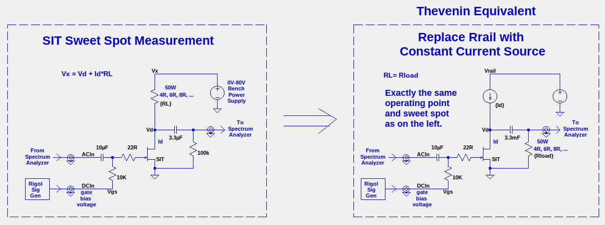

The image below shows the SIT sweet-spot bench-test circuit on the left converted to a Thevenin equivalent circuit using a constant current source. The sweet spot is unchanged, using the same values for Id, Vd, and Rload, as shown in the spectra for the two circuits. The spectra the for the bench-test and CCS circuits respectively.
The complete circuit for the CCS is shown in the 4th image.

The 'Sweet Spot" surface shown in post #10 has four parameters (A, B, C, and D). In post #44 I attached physical units to those parameters:
Id=(C*Vd)/RL+A*Vd+B/RL+D;
A has amps/volts units: 1/R_A
B has volts units: V_B
C is a unit parameter: K_C
D has amps units: I_D

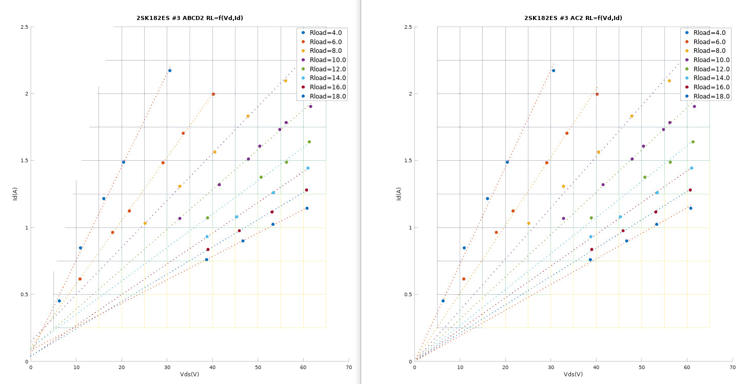

Yesterday I extended the range of of values for the load resistor RL to include 4R, 6R, 8R, 10R, 12R, 14R, 16R, and 18R values. After looking at the plots I wondered what would happen if I eliminated the B and D parameters, which has the effect of forcing the lines of constant RL to intersect the points Vd=0, Id=0, RL, as shown in the first image below. On the left are are select of lines of the form Id=a*Vd+b, whereas on the right the lines are Id=c*Vd, where the values of a,b,c depend on RL.
I went one step further and eliminated the A parameter, resulting in the equation Id = C*Vd/RL. Here is a summary of the RMS errors of the residual fit errors for the three solutions:
RMS = 0.018A of 4 parameter [A,B,C,D] fit Id = C*Vd/RL+A*Vd+B/RL+D
RMS = 0.031A of 2 parameter ___[A,C] fit Id = C*Vd/RL+A*Vd
RMS = 0.069A of 1 parameter _____[C] fit Id = C*Vd/RL

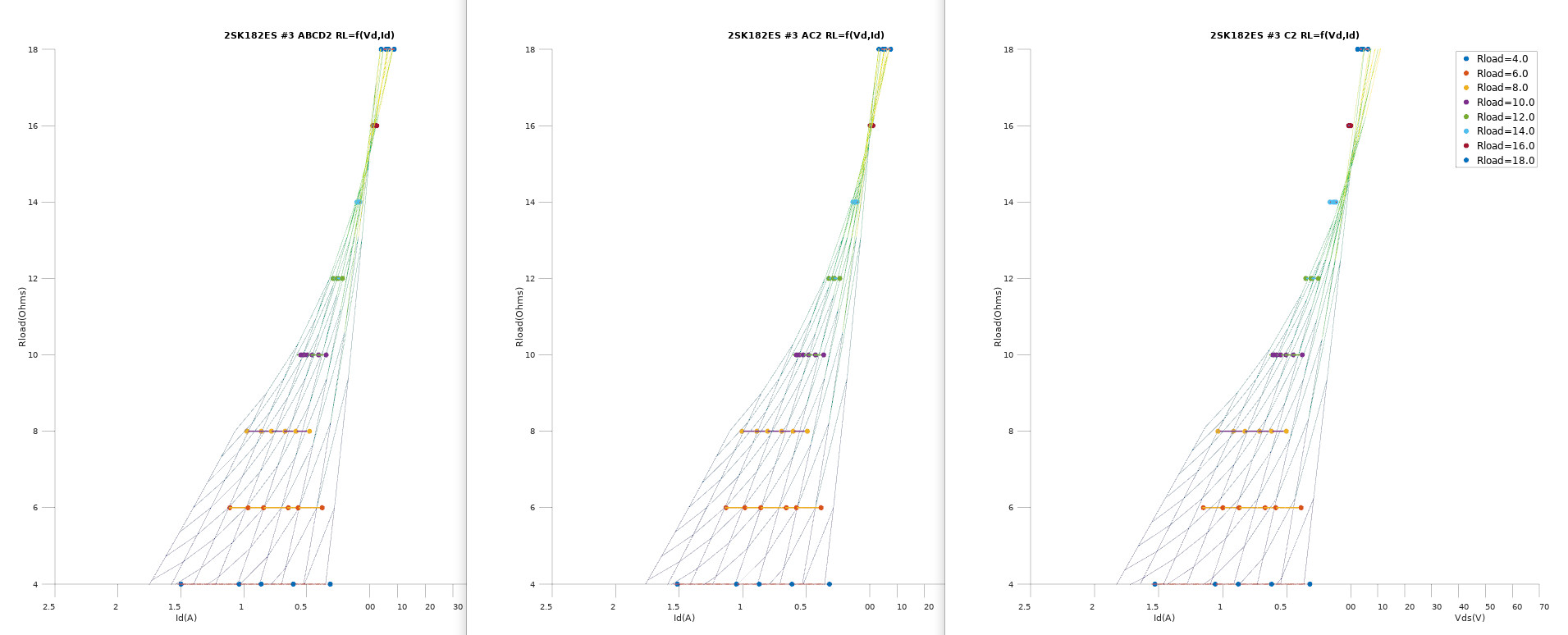

The 2nd image contains 3 plots showing the sweet spot surfaces in an orientation similar to that of post #10.

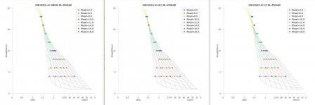

The 3rd image contains 3 plots showing the sweet spot surfaces in an orientation similar to that of post #10.
In the rightmost plots, showing the 1-parameter surface fit, the error become visible for the lines with the highest RL values.
Thus, the "Sweet Spot" equations Id = C*Vd/RL and Vd = Id*RL/C are good 1st order approximations.
