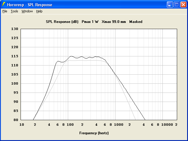

As far as tapped horns, the minimum impedance is usually quite close to the DC resistance, so is important when choosing an amp to drive the load.
The first low-impedance dip of traditional basshorns is usually very close to the DC resistance value too. The second dip is usually much higher. A 25% increase isn't uncommon. But, yeah, every basshorn I ever measured had impedance minimum in the passband that was very close to DC resistance. So I suppose I could have just slapped an ohmmeter across the leads but I always thought it was probably best to use that first dip as the Zmin value.
I also tried to explain how HornResp seems to be using some sort of steps in finding its lowest impedance point for its calculation and David explained to me in post#1379 it is limited by the graphic resolution of screen pixels.
This is what David says about the algorithm used to calculate:
Voltage Eg is automatically adjusted by Hornresp to maintain a constant 1 watt input, even though the load impedance changes with frequency.
The Hornresp model maintains power constant, not voltage. This makes impedance a non-issue with respect to drive voltage. The simulated drive voltage could be said to fluxuate, tracking the impedance curve.
We need to know Zmin when comparing measurements. To set the drive voltage for a reference power level we need to figure impedance.
Essentially, I take the speaker outdoors and use a swept sine to measure impedance. Then I examine the chart for Zmin, minimum impedance above cutoff. Next I calculate the drive voltage required to attain a specific reference power level. Then I set the (RMS AC) voltage drive to that reference value, e.g. 28.3v for 100 watts if Zmin is 8Ω. Then I position the microphone and run a sweep to get a response chart that shows SPL as a function of frequency.

When you calculate the drive voltage required to attain a specific reference power level, do you simply use the magnitude of Zmin and consider it to be a pure resistance, or do you treat Zmin as a complex impedance having both resistive and reactive components? The voltage will be slightly different for the two cases.
The attached screenprint generated using the default Hornresp record compares the true 1 watt / 1 metre response (black trace) against the response obtained by setting Eg to the voltage required to deliver 1 watt into the chosen Zmin value (gray trace). As you can see, there is a reasonable difference between the two. The only point at which the two traces exactly coincide is at the frequency of the minimum impedance within the nominated passband. For this particular example, the minimum impedance happens to be at the very top of the selected bandwidth (at around 800 hertz).

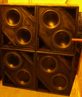

sure would be nice to see some photos of the construction of a dual lab 12, ive built dozens of subwoofers over the years but cant quite make out how the build is supposed to go from the drawings i can find and photos of finished boxes?
It is a basic BR cabinet, six sides, two triangular corner ports, all the details are in the link.
The only thing unusual at all is the ports are fairly large and have a 45 degree angle on the outside and inside so the grill frame becomes part of the last 3/4".
That detail keeps the cabinet sounding basically the same at any power level below Xmax.
I used shells from old FLH cabinets to make my 2x12", the destruction details would have been interesting, but I did not photograph them.
The placement of the in/out connectors made putting a cabinet divider difficult, if I were building from scratch I'd add one.
The photo below shows the front of four cabinets with the grills removed.
You seem to be looking for 31 Hz response, the ports could be lengthened slightly, response would flatten out and drop a bit, at the expense of a little 50 Hz area output.

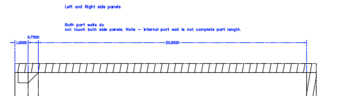

box is 21" deep, ports are 16.5 deep (longer is lower tuning) with 30 sq" area each?
Not quite, Seth H. Bass Box Pro sketch did not include the front baffle recess, you can see that in the thumbnail in the very first post, included below.
The interior depth is 20", interior height is 21 (22.5-1.5").
Reading through the two pages of posts should answer any other questions.
This is a very basic box, as long as you use big flared corner ports and keep the interior volume close to the same, it will perform fine.

The reason for the difference is mostly due to one curve being generated by a constant voltage source and the other being driven with constant power. Remember that when we measure, we're dealing with amplifiers that are essentially constant voltage sources.

Exactly - and because of this, the result is only going to be an approximation to the actual 1 watt / 1 metre performance - which is the point I was trying to make in my example 🙂.
Since the measured result is only going to be an approximation at best, why not just use the published rated impedance of the driver, rather than going to the trouble of finding a value of Zmin for the system? The difference between Re and the magnitude of Zmin will not be much. Using Re rather than Zmin would mean that it is no longer necessary to identify the passband in order to establish a value for Zmin.
Yes, that's the same point I was making. So we're square on that.
Not sure I understand what you are saying. The measured result is an approximation? Actually, the measured result is the real deal. The simulation is what is the approximation. I mean, I think the model is very good, but it is a model, after all.
But now that I consider your meaning a little more, I don't think your statement was about comparing the measurement to the model, I think you were talking about what single-point impedance value to chose when calculating drive voltage for measurements. If so, then, yes, that's the problem. That is the dilemma.
If we wish to make SPL measurements of loudspeakers at consistent power levels, then we must understand their impedances to calculate their drive voltage requirements.
