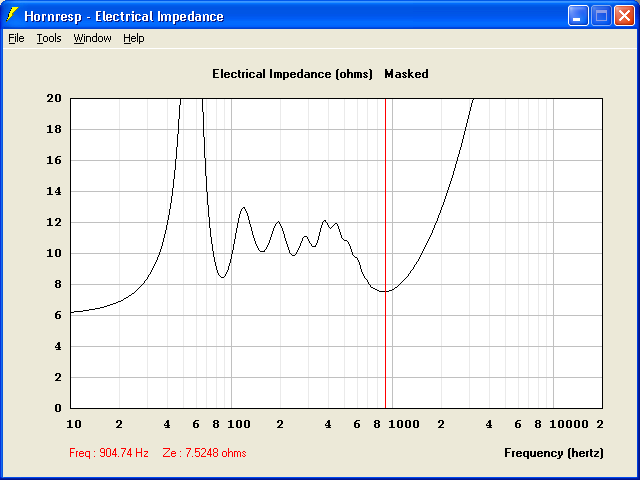

Hi Djim,
No, I mean 1.25 x Re 🙂.
To illustrate - for the Hornresp default record, and using Wayne's suggested method to find Zmin:
Zmin = 7.52 ohms at 905 hertz (see attachment).
1.25 x Re = 1.25 x 6 = 7.50 ohms.
The SPL curve generated using 1.25 x Re = 7.50 ohms is effectively identical to the one generated using Zmin = 7.52 ohms.
Kind regards,
David

Hi Djim,
In that case, if the difference in predicted SPL using either Re or Zmin is only going to be a decibel or so at most, then as Wayne says, is it really worth worrying about?
As I understand it, you would like to compare different designs in Hornresp to see which has the highest sensitivity. Consistently using Re rather than Zmin for the designs being compared, should give you that information.
Kind regards,
David
