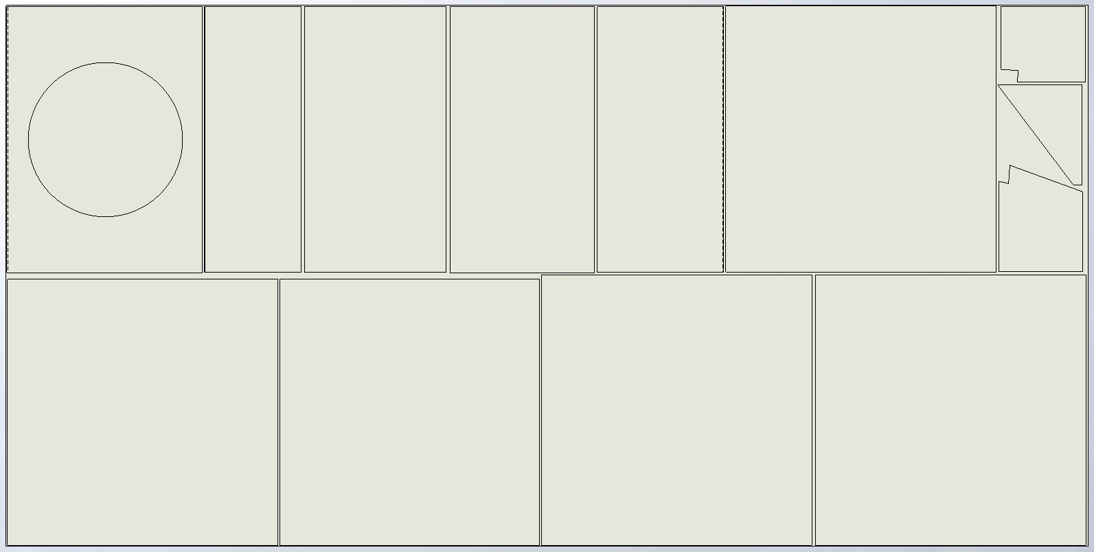

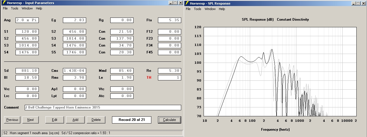

My attempt
12mm Ply 1off 8' x 4' sheet Eminence 3015LF driver
Trouble is that as you tweek the bandwidth and efficiency you loose the low frequency extension. The only way I can see to get it back is to increase the size which would take more timber....
Maybe a longer path length would be possible if the width of the horn was reduced to 400mm😀
Spl response grey line is J Bell Mini TH for comparison.
The 'iron law' still applies to a TH enclosure.
I don't think 40hz and 100dB are possible from a 2' cube.
50hz, yes, 40hz, no.
#9 is a good example of that at 90dB at 40hz.
"in reality it goes lower"
With room gain, I might buy that. In 2Pi or 4Pi, no way.
Certainly I did not use any smoke and mirrors in my attempt. I calculated the path length thru the middle of the bends - not at 0.7 of the bend width which would give a lower response. When I first tried to design a similar cabinet I ended up with a box 700 X 700 X 600 That seemed a better compromise, but would use too much timber for this challenge!
I think that J Bells original simple tapered TH will be hard to beat for its LF response.

This is not restricted to a cube, but to a 4x8 sheet -- A cube just happens to be the shape that lends itself to the taper I drew. I know I can get slightly more volume, and still get all the internal panels cut from a sheet -- but the folding/cut sheet is eluding me at the moment.
BTW -- leaving out the bottom panel and saying "just sit it on the floor" is cheating..... 😉
One last: The cube achieves 100db. 98db@40hz and 103db@120hz -- in marketing lingo thats 101db +-3db from 40-140hz.

the only way to know is to built it and measure, JBells cube measured about 5hz lower then the sim too.
The form-factor (cube) doesn't really matter, it's the net volume you can come up with.
A 2' cube has at best about 180L net volume.
In the past, I've built well braced 12mm Baltic Birch cabinets for subs. I didn't think 12mm was adequate. I think 15mm is adequate, but 18mm is better. Formica (Melamine) on 15mm about doubles the strength, but adds a lot of expense.
I've got a nice Hornresp for the Eminence 4015LF that's ±1.5dB from 40hz~150hz, and 100dB at 50hz. But it's 205L, not 180L. If you remove the external inductor and its DCR, it gives an almost identical response to yours.
I would like to see live FR and Impedance graphs with a correctly dimensioned cab drawing. Like the two posted here, most of
the time the HR sim is not what gets built.
Could you enlighten us?
I, for one, make every attempt to follow the HR sim. Of course I use CONICs and build Parabolics, but the error is small, and I know I'm off a few percent
in the corners.
When I can't follow the HR sim, I go back and update the sim with the as-built information. If the damage is too bad, I scrap the drawing.
Sims are sims, they are one dimensional equations simming a three dimensional world. We're lucky they even come close.
