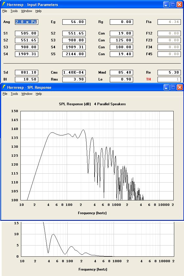

Jbell, how are you measuring the efficiency of your TH? Or are you measuring sensitivity then converting? I was assuming an 8 ohm load for my HornResp designs, then decided to use Re instead of a nominal 8 ohm load to set the "1W" voltage. That dropped the voltage and as a consequence the calculated efficiency a bit...

I ran a sim using your figures and the adjusted drive voltage - results suggest 93.2dB @ 40 Hz with 1W input. I re-ran the sim for my 4.3 cu.ft. TH and it suggests 93dB @ 40 Hz with 1W - not bad for a cabinet almost half the volume. Of course the peak SPL capability of your system will be a lot greater than what this 12" TH is capable of.

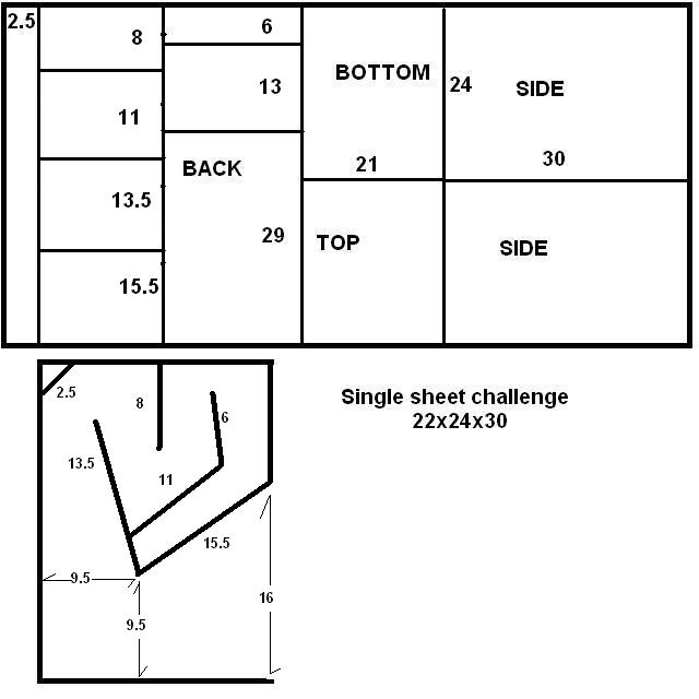

I think I got it....
Don would you run your cad on this... I think its a winner. And this one is definitely solid to 40hz, AND a better shape than a cube.
The scraps at the end are for braces/angles as I need them. Won't know exactly till it's built.
This should have the 'big box sound' in a 50lb package, instead of a 150lb package. It's giving up a couple db in sensitivity to the big box, and it's giving up about 100 watt power capacity to stay under xmax to the cube. (bigbox is good to 50v, this 56v, cube 63v).
I'd like to move the upper part up an inch, so the flare would start about 4" tall, and end at 10.5" tall. It'd have a better response, but I haven't figured out how to get the back part of the cabinet right, so the flare is continually expanding.

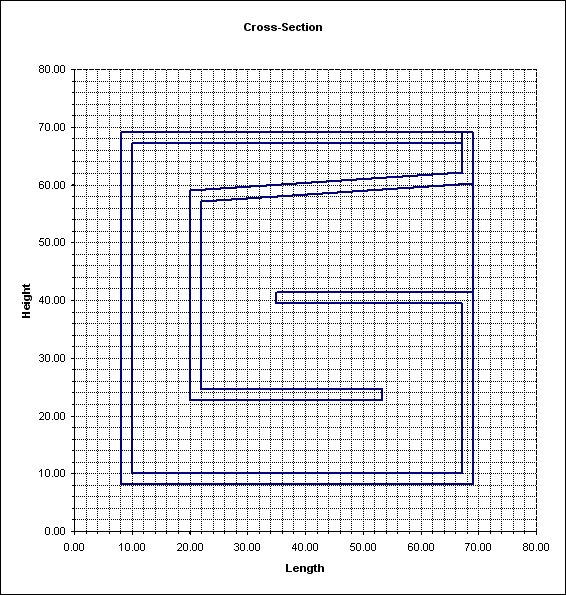

It's a bass bin, so you don't have to have a continuously expanding flare. You can "step" the sections. I built a TH with the stepped cross-section below just recently, and the measured response within its passband seems a pretty decent match for the HornResp predictions. It also allows me to top-mount the speaker (I've left the top panel removable).

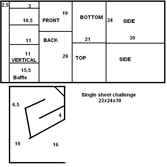

Here's another thought I'm running with. More top end (like oliver's posting awhile back) and still reasonable 40hz...

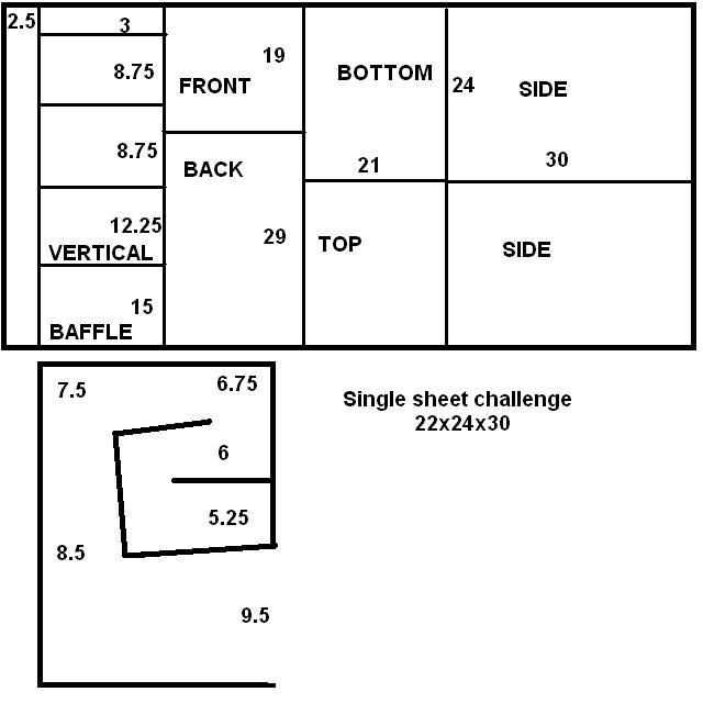

I wonder if design is possible to complete from a single sheet, I'll do the math and get back to you, it does seem small enough, if it does meet the challenge criteria this would be my entry.
You guys are cranking them out faster than I can keep up.
Jim - which one would you like first? I'll have it early monday. It really helps to have the HornRes input screen, 'cause I can see what
you were thinking!
