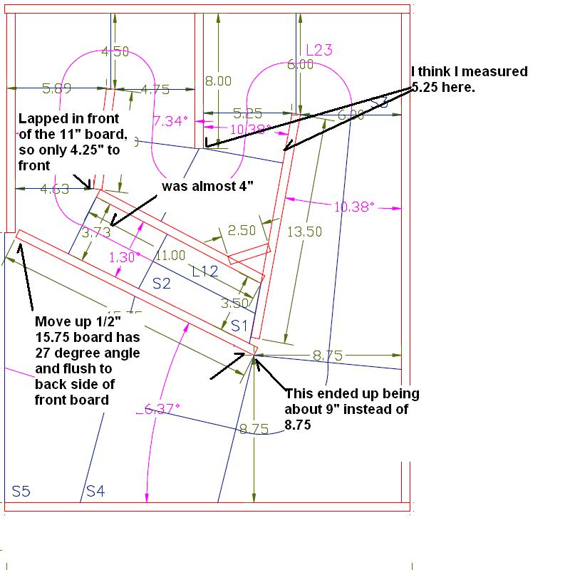

Drawing for simulation in Post #57
Hi jbell,
This is the sketch derived from your dimensions from which I build the simulation in Post #57. As you can see it is not a finished drawing, and some of the dimension just don't quite meet (in the upper left hand corner they are quite a bit of, but that depends on where you start.)
Anyhow, for what it's worth:
Oliver:
Thanks for working on this. Post 56, you can see how I lapped the boards. Here's from memory on my build some notes that will make things line up a little better.

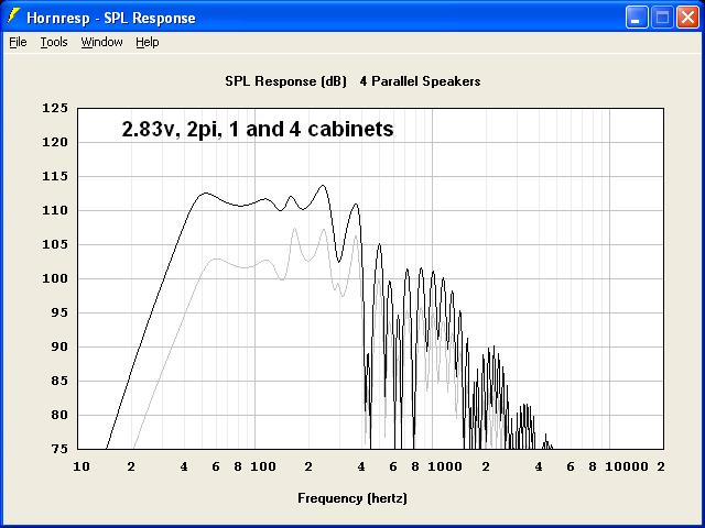

Jbell, how high can this new design go? do you have plots for 2 / 4 of them.. just out of curiosity have you simmed any other drivers in this? would try my self but Im on a mac so can't run hornsresp 🙁

I think olivers hornresp is pretty close -- however I always measure lower than what I think I'm building. I read some place on designing FLH, that you need to take into consideration the 'horn bubble' in front of the mouth. Wonder if there is something to that, and that's why my TH's always measure a little lower than I think. For that reason, I've come to design just short of 40hz in hornresp, so that what I build is closer to what I really want.
In terms of how high? I've personally measured/listened up through 200hz in 1hz increments. Other than the 170hz dip (that hornresp predicts, but predicts a much wider in frequency dip) It's smooth up through 200. I'm guessing about 250 is as far as it could be pushed before something starts sounding iffy...
Also, word to the wise... trying to measure over soggy ground over grass in the rain is NOT 2pi space... My driveway measurements at 28v look much closer to my original 2.83v... so I'm not nearly as concerned about panel flex as I was.
I attached a 2.83v 1 and 4 cabinet hornresp response. I think it's pretty close to the numbers I measured. You can see how hornresp predicts 4 cabinets should get you flat to 40. I actually think 2 cabinets will get you there.
It only costs you a sheet of ply and tube of glue to find out if this cabinet is a good one or not, have fun.

Post #63,64,70
Hi jbell,
I took your notes and "refreshed" the drawing from Post #63. The Hornresp simulation does not change sufficiently to warrant spending any more time on it. I added a few more dimensions to this drawing, and between your drawing in Post #39 and this there should be enough data for anyone who wants to build one. The builder has to be a little careful with the dimensions after cutting v. the drawing dimensions (saw cuts being about 1/8"), but small differences should not make much of a difference. You squeezed a lot of box out of one sheet of plywood. Well done.
It doesn't add up for me...
url]
[/IMG]
When I measure from back to front like in the photo above it doesn't add up. I will try to explain the best I can. Here goes...
I start at the back and come in a 1/2" and then measure 6" across to the 13.5" panel. Then add a 1/2" for the 13.5" panel. So we are at 7" so far and will add 5.25 to get to the 8" panel. Now 12.25" + 1/2"(8" panel thickness) =12.75". 12.75" + 4.75"= 17.5" to the 6" panel. Plus 1/2" (for 6" panel) gets us to 18" . And adding 4.5" with our 18" gets us to 22.50" to the front of the 13" front panel. It should be 24".
Either I need a good long break(very very very possible) or Lucy got some splaining to do!
Hi jbell,
THANK YOU oliver:
Yes, this looks very much like what I built, right down to the 8" board having the matching 27 degree cut. (the cut between the baffle and 8" board was the last cut I made)
Yes, careful cuts with a table saw are the only way I know of to get all this cut out. I literally have a pair of 2" triangles and sawdust left over.
The way I cut it out:
1. Cut a 30x48 off of one end of the ply.
2. Set fence at 21" and cut (3) 48x21, leaving a 2.5" strip for braces.
3. set fence at 23 15/16" (24" center blade) and rip one 21x48 and 30x48 into top/bottom/side/side
4. cut out the other parts, leaving the 27degree cut between baffle/8" board for last.
It really cuts out fast, and assembles fast. PL glue takes care of any of the angles that are not exactly 90 degrees.
Post #75
Hi mike james 533,
Take a look at the dimensions in the drawing in Post #74, that may help. It's more important to get the edges sealed right than exactly where they are, but it helps to get a good starting point.
