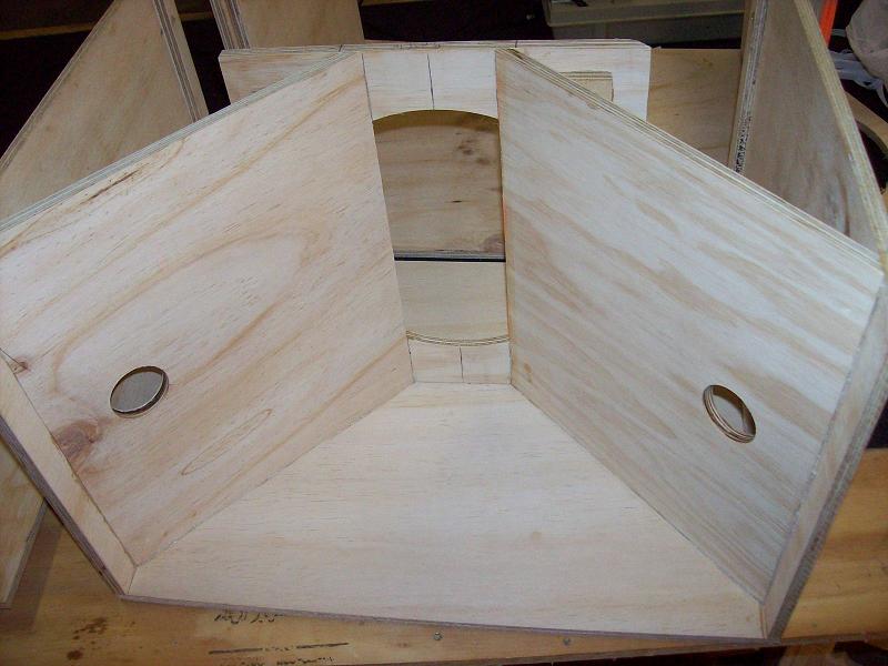

Where is a good place for the pocket handle with this new design? Do you have a name for this one yet?
Also what size hole for the ports in the flares did you use for your MCM 55-1740 tops? The pic you showed me of them on the other thread looks like you used pvc pipe. How long did you make the pipes? Also what electronics for the woofer and tweeters? Any other info you feel would help the build?

Pocket handle should fit very well directly below the 8" board.
I've built many tops, f you are referring to this top with the beta 12a-2 that's made to fit the PE 15x22.5 grills, the hole is 2" diameter which tunes port/cabinet to 80hz. That one runs the 16ohm senenium 220 and the goldwood pb500 horn with a 2.5hkz crossover. (That's another single sheet design, 2 tops, 1 sheet.) The top with the 1.5"x1.5" pvc ports was a mcm 55-1740 in a 12x12x24 box with a 6.5" long horn and 'shallow' piezo array. (piezo angle at 35, not 45 degrees)
