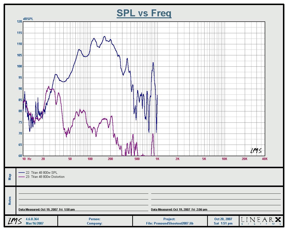

I built 2 Titans 48" x 24" loaded with the 3015lf. I was very disappointed with the results. I had to hold back 2 Otops for the subs to keep up, running them 2 tops and 2 titans at 60 volts . I was hoping the drivers would break in and they would be better. But no such luck. They are way too big for me and my bad back. It was a pain to V plate them and most times there wasn't enough room to do so at the places we play. Maybe I was asking too much of them, but they didn't live up to what I expected. I think a direct 15" box would out perform YMMV...did you ever build Titans?

Yea... I built several things that start with the Letter 'T'
-13db at 40hz vs 100hz is the perfect recipe to roast hot dogs to perfection.....
You will have to 'unlearn' what you know about sub placement with these. If you are going to 'corner load' them, that means putting them in a corner facing OUT. They work very well in front of a stage on their sides, in a line. (their coverage pattern is different on side vs standing up.) Makes a good place for monitors as well.

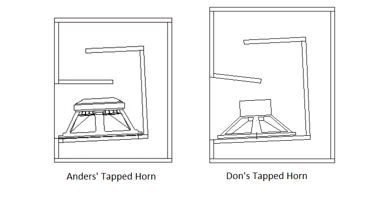

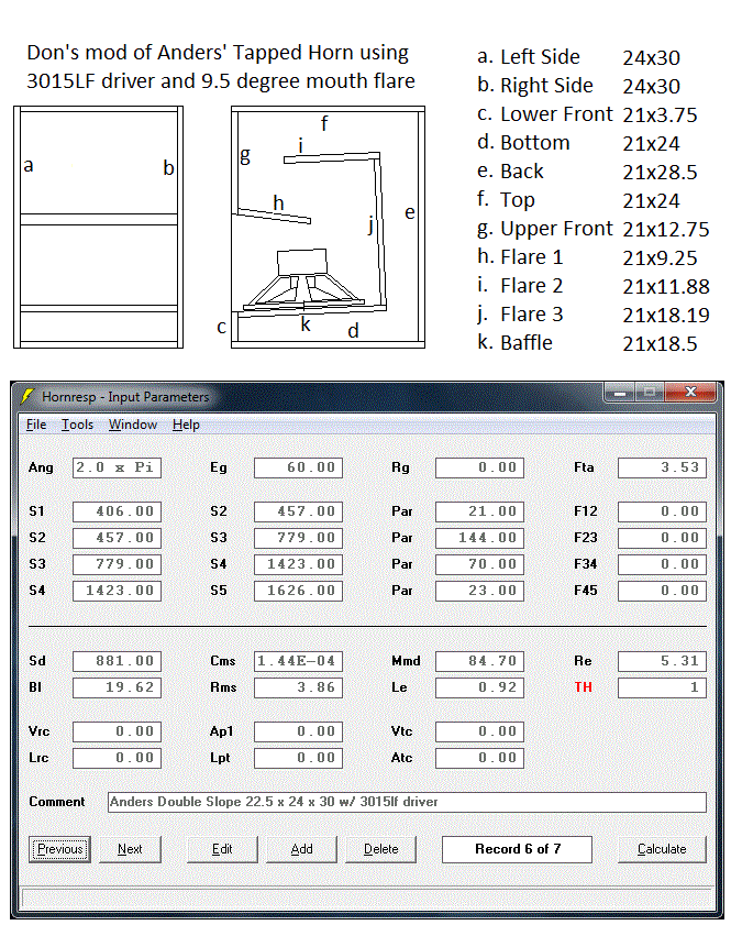

I tried to beat Jim's last cabinet, and failed. I did come up with a modification of Anders cabinet scaled up to match the size of Jim's cabinet. It's max
output is down 3dB from Jim's but it goes 5Hz lower.
If you want 40Hz in a single box, it may be your best choice.

Don:
I've built something like that. However without a shallow reflector at the bottom, and a 45 degree at the top -- things were ugly. VERY ugly.

Thanks Jim,
As good as HornResp is, it doesn't sim everything. I am surprised since my first TH was OK and Anders' horn was reported to sound so good. I may build
one and attempt to fix it by trial and error, but I'm no Screamer.
I wish Tom would critique some of these boxes, but that's asking the guy to cut his own throat.
