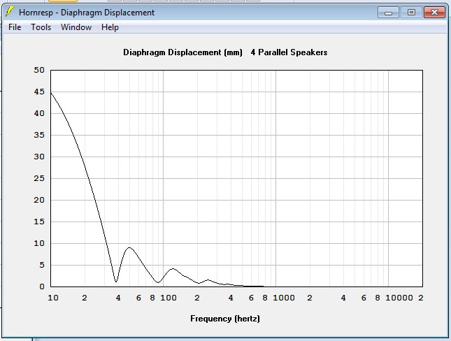

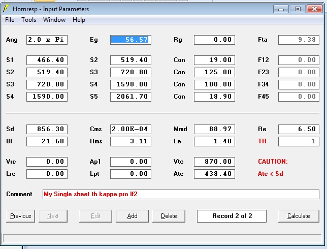

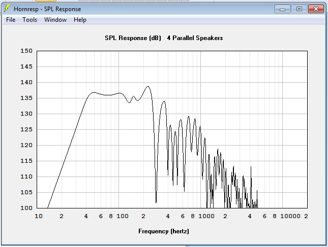

jbell I really like your plan, I have modified it for my needs.
I'm using 18mm wood and have used a square throat like in the furybox to hopefully reduce excursion at high levels. most of the dimensions have changed to accommodate the thicker wood but luckily doesn't seem to have made much difference to the output.
Its not strictly a single sheet anymore because the baffle is now two pieces but I'm using some spare 12mm wood i have.
These plots are calculated with a Kappa Pro 15lf2, any thought on using this driver? lower xmax but hornresp shows lower excursion.
I'll post plans etc soon but my laptops broken.
