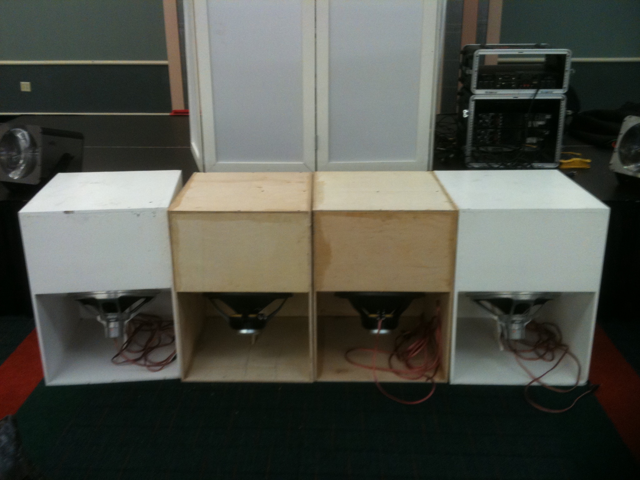

Wow, sounds very nice fhperez! .. Does the 12mm box feel rugged enough for alot af mobile use? I ask since i have allways been told that subs should be made of 18mm to be solid enough for alot af moving around.

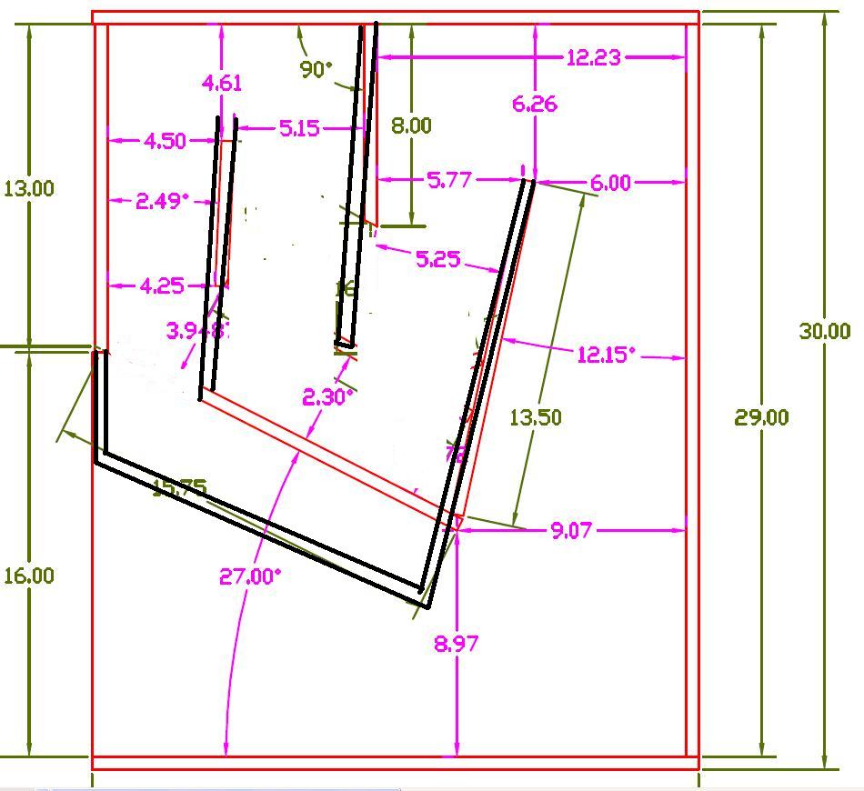

I'm just looking through the cutsheet and everything, but there is something that confuses me. I think you can help me out.
On the cutsheet, there is no shown boards for bracing (from the back to the bottom and top, as i can see on your building pics), but there is a 2,5" board, witch according to the design sketch, should be used as a reflector in the back-upper corner.
Now, all i can think is, that instead of reflector, you have used the 2,5" for the bracing? - but then i look at your picture (post #54), with all the wood has been cut, and there is both the 2,5" board and another called "brace".
I hope you understand what i'm trying to ask you :)
Edit:
Now i see, that the 2,5" reflector board has just "moved" from the back-upper corner, to sit between the 11" and the 13,5" board.
Then i just need to know where you got that board for bracing from? I just can't figure it out :)
I don't know, it's not heavy, and since they are white, I have to take super extra care of them... They feel good enough to me to resist the loading and unloading...

Quick Question... If we were to make these to 22", 23", maybe even 24 inches internally, for me, who will be making maybe 2 or 4 and be happy with them for a 'long' time, then I could reach levels of 40hz with 1 box, or does with have to be at 21" for this design to work?
Having Said that, if I do build two more, tuned to 40hz, a wider version, could I use all 4 together, or would you advice against that?
Jbell
Making them wider doesn't make them play lower. If you want lower, more cabinets accomplishes that. (to a point)
This means that for small gigs, bringing 2 or more is still advised even if you don't need the spl.
If you really want a lower design, and you don't care about fitting it out of a single sheet, I can mod it to make it play a little lower.. Keep in mind loud and low are the 2 players on the see-saw. As one goes up, the other goes down.
Here's the idea of what would be needed to make it actually go lower. (warning -- there is NO hornresp or other thought put into this, it's just a depiction of what would be needed to make the horn path longer, and therefore play lower)

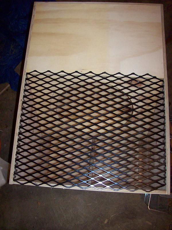

Here's a nice grill option for the ss15. 9 ga. flattened expanded mesh. Cut it to size, and bend the 'ears' down on each side. I put a thin strip of rubber between the grill and wood to keep any vibration issues from happening. It sure kills any cabinet flex issues at the mouth!!
It ends up costing under $10 a grill. I buy 4'x6' sections (half sheet) from the local steel company.

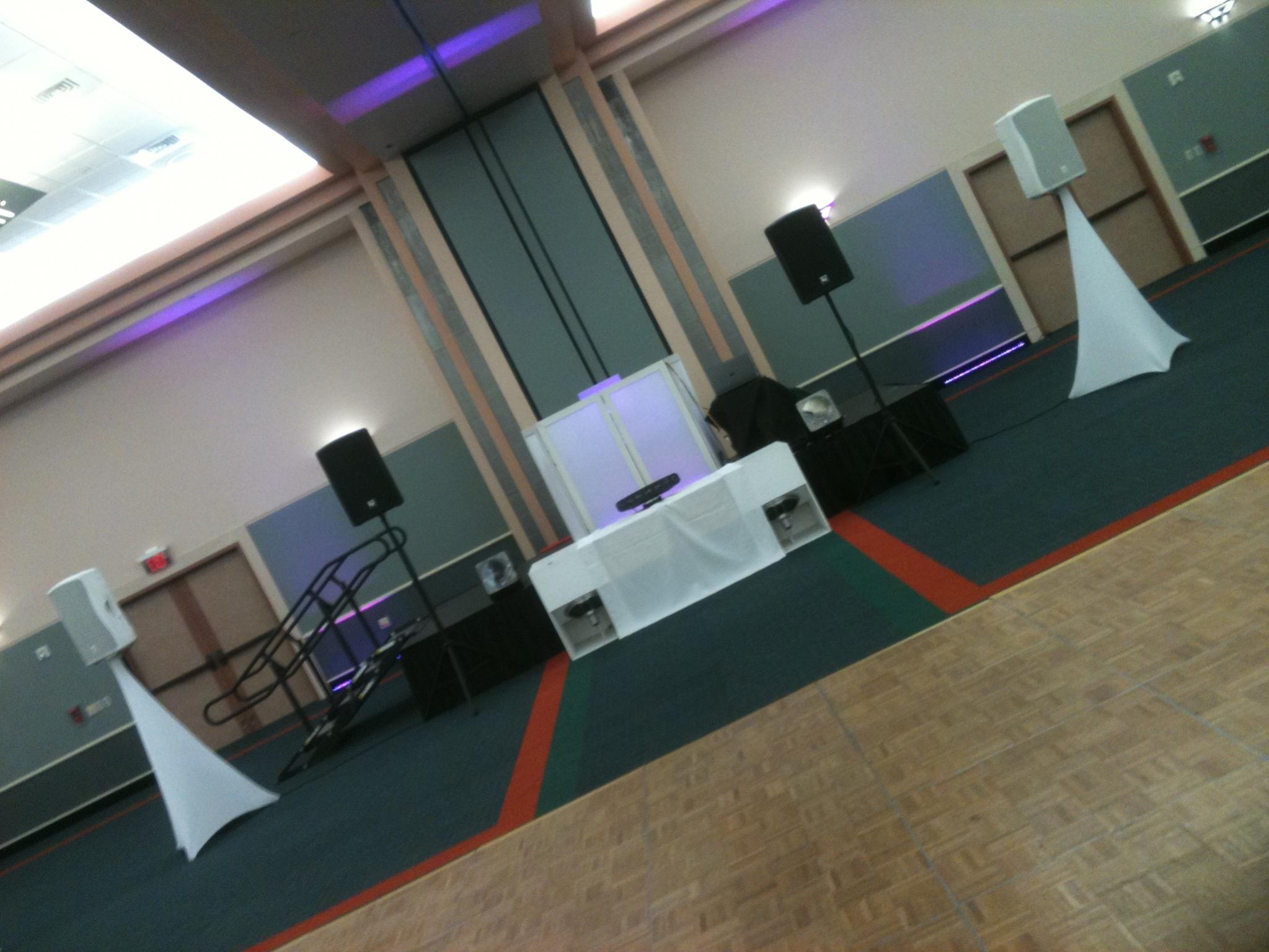

OK, I must say, I am continued to be impressed by these subs...
This past Saturday I did an event with over 300 People at a Hall/Convention Center that was 14,000 Square Feet and boy did these sound Good...
I finally finished my 2nd pair of speakers... I'm in love with these subs... Groom, being a sound guy himself, came to me and said that they sounded great!
Best thing was walking outside the venue and still hearing the bass pretty clean...
These will definitely take the place of my dual 18 cabs...

A couple questions:
How do you like the 3015lf's vs the JBL's?
white sheet? no time to paint?
You've had them standing up in all the pics I've seen, ever try laying them on their sides? A block of 4 on their sides with mouths together is very fun.....
The more I build these and listen to them, the more I'm convinced this is a design an enterprising person could build a business around... It's just a good 'all around' sub.
Jbell...
I built these Thursday... I started at around 1PM and finished around 8 PM with one break for dinner... :) :) :) that's cutting the wood, drawing out the design on the side panel, gluing down and clamping one down while I built the second one... Reason I started Thursday is because I put in an order for them over the weekend and they arrived Thursday...
Friday I had an event in the evening so I did not want to risk starting to paint them and not being able to finish... Plus I had some errands to run Friday before the weekend... :)
I did not have enough time to do a/b comparisons that day at that hall...
I thought about putting them on their sides, with the mouths facing each other... but again, there was no time to test... I had no roadie so I did all the install, cleaning up of wires and I installed the purple LED Lighting you saw on the pics... I did think about doing it though... Especially since i could have used that white sheet to cover only the bottom two a lot nicer than what it came out... but oh well...
Most of the time I won't need 4 subs... I may sell the JBL's to a friend and only 'borrow' them when I need them...
:) :) :) Yup I've even thought about selling these, I've posted pictures on my FB page and seems like some DJ's like the design...
BTW: I was pushing 4 of these with 2 qsc 2402's each amp bridged mono, so they were each getting anywhere from 1000 to 1200 watts... :) I would say I kept my main mixer to -2 db for most of the night... Amps never clipped... I played them hard from 6pm to 12 am...
