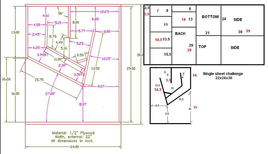

Single sheet TH challenge
Yup... That's the best part there...
You can't beat that.. and it's only my second set I make... I did one mistake that I did not correct.... the 8" board... You have 12.26 (If I recall right from my memory).. I got used to starting from the 1" mark on my tape measure, to get pretty close to the mark... that would put me at the 13.25" Marker on my tape measure... well I used the 0" mark and still put it at 13.25" Marker... I didn't see that till the glue was already dried up... so I just left it... I'm not sure what kind of audio changes that will do...
That mistake was me just trying to finish my first box that day before the sun went down, oh and I didn't put the braces on it...

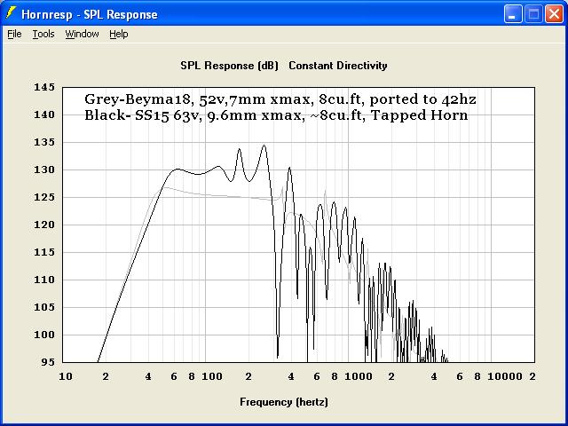

You didn't give me much to go on with the Beyma, however I made some educated guesses assuming a 40-100hz passband. At 42hz port tuning, you run out of xmax at 350watts. Obviously this is just a guess at your current cabinet.
I still haven't figured out how to get my measurements to line up with hornresp. Hornresp says 40hz should be 10db down vs 60hz on the SS15, and I only measure 5db down.
Oh, well -- the attached is max spl staying within xmax of each driver. Hope it helps.

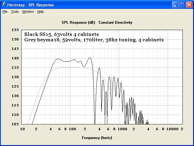

Adjusted to 170liter@38hz. It still exceeds xmax at 350watts. I also adjusted to 4 cabinets vs 4 cabinets.
The big difference is the 'quality' of the sound, the lower distortion, and the directionality of the TH vs the BR style cabinet.
Even if hornresp said they were db to db the same... distortion is lower, no port compression, etc... in the TH.
Not bad for a $150 dollar 15" vs a $300 dollar 18"

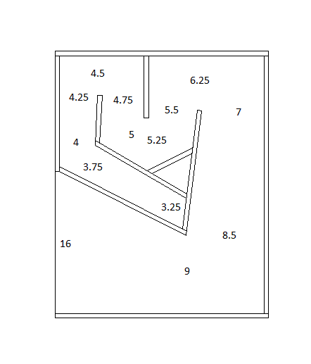

I'm sitting here wondering if this thing could be any better ... what if the expansion was just a little smoother?
How about ...
Don -- I've given it a LOT of thought on if it could be better, and still be cut out of a singlesheet. I'd like it to have just a hair more 40hz single box. Here is the only way I can think of to do it. The box would be 1" shorter at 29" and you'd have to splice one interior panel with a 6" and a 3.5" board. And you'd only have enough scrap to have a single back to bottom brace.
This should acoustically make the cabinet longer/lower, and have just a hair less upper end.
thoughts? Hornresp says it's not really worth doing.... But something in me says it's worth trying, just to see.

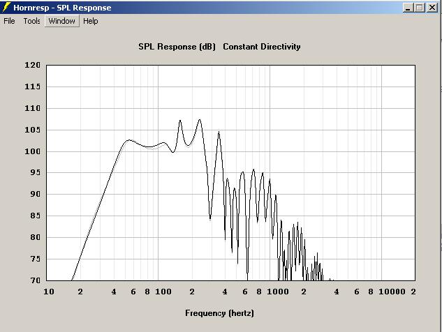

here is a comparison based on the Hornresp Data in post 38 @ 2.83V
The 3015lf is the grey and the PDN15BR40 is the black😀

Point is most budget drivers will have conciderably lower efficiency and power handling in a TH. I dont know what to recommend to you that will give you a better price/performance ratio
The Fane sovereign Pro 600lf is £90
Is it worth throwing away 2db off efficiency for £26
The Fane driver runs out of X-max at 40V (200w 8 ohm)
The Eminence & Precision Devices Neo drivers take approximately 50% more power to get to X-max
I haven't found a better 'bang for the buck' driver than the 3015lf so far for the ss15. There are obviously other drivers that work, and some even work better... but at a cost.

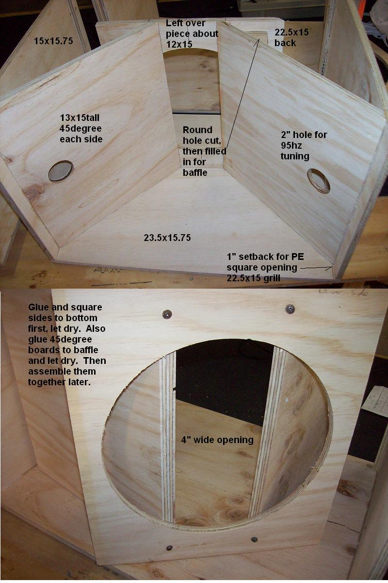

I've had a couple questions about the HS12 tops that I've been using with the SS15 subs. The name HS12 is 'half sheet' 12" driver tops, as I can get a pair of them (barely) out of a single sheet of ply.
Attached are a couple pics, and any enterprising person can from these, reproduce my tops. I personally use eminence beta 12a-2's with selenium 16ohm 220i compression drivers. I use a simple 12db/oct 1900hz crossover with high C=2.6uf, L=2.68mh and low C=5.24, L=1.34mh. (at least that's the values the crossover calculator gave me.) I used parts express components that were as close to that as possible, the high capacitor needs to be a poly, and the high inductor needs to be air core, electrolytic and iron core is ok for woofer. If you are going to stack, the goldwood pb500 horn works, and for single cabinets I've used the dayton 12" conical waveguide. In both cases I just bolt the horn to the metal grill. The PE square hole grill is very strong and is actually what I designed this cabinet around.

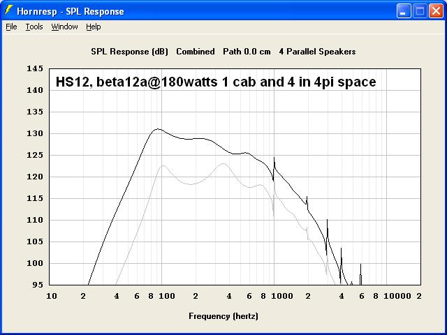

Going by the graph, the HS12 appears to have a somewhat falling response.
How does this affect use / performance / setup?

Ben, you are on the money on the design. Yes, I started with an OT12 style cabinet and fixed the things I didn't like.
Ports on the sides create feedback. Ports deep in the horn sound funky...
The baffle with the small 'fill' plates is easier/faster
The cabinet size is designed for a PE metal grill / and horn lens bolts to grill. (only use the square hole grill, round hole PE grill is too flimsy)
The horn is a low pass, and the eminence typical 'rising response' counteracts that. (horn low pass keeps you from having to eq out the midrange 'honk')
Any cabinet not 'midbass heavy' in 2pi sounds weak in 4pi (on stands) so yes, this is kinda a 'midbass heavy' design. You can see how even in single cabinet, this design is strong to 100hz.
A selenium 220 sounds MUCH better than an ads1001
16ohm selenium matches up to the 8 ohm beta12a-2 almost perfectly, no resistors needed in crossover.
VERY LITTLE eq needed when used with the dayton 12" waveguide, and a nice open, non honky sound comes from compression driver.
1.9khz crossover means no 'fillers' needed, no need to get 12" to run up to 3.5k (selenium can go down to 1.5khz if needed)
95hz port tuning means this cabinet is good xmax down to 60hz if you 'have' to run no subs, and is strong down through 100hz. (which is important for male vocals)
