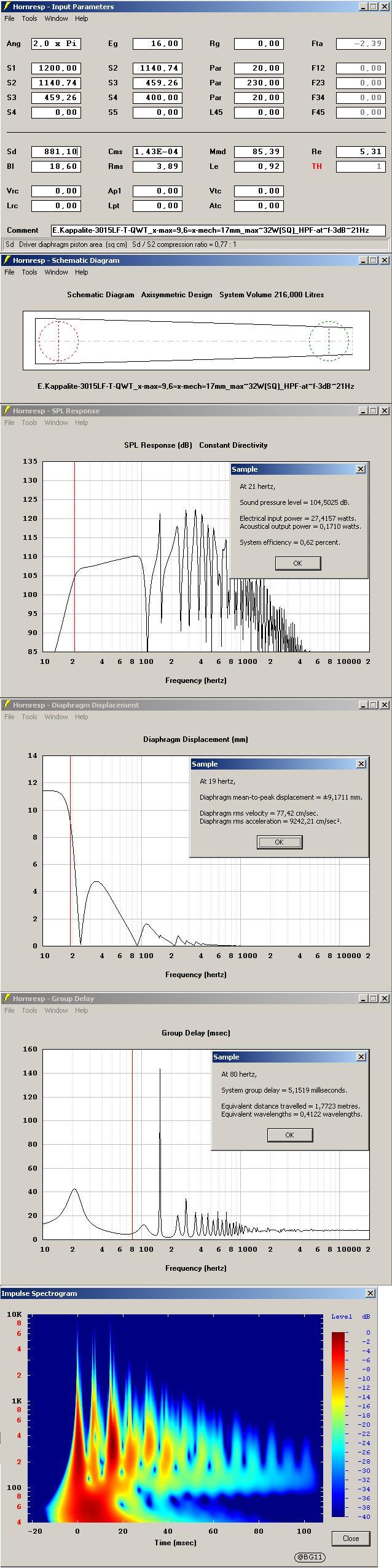

Hi Crank,
There are alternative use for a PA driver like the Eminence 3015LF, IMO more suitable for home: No need for signal-delaying the Main speakers or needing an additional EQ:
b🙂

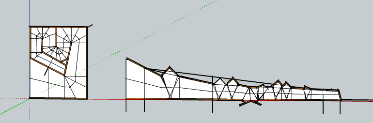

I just saw your drawing of the THAM15 in Xco1. It explans alot. Could you do a Xco1 drawing of the SS15 and post it thare.
Unfortunately, I do not have SolidWorks, but something similar can be done in SketchUp. You can unfold the horn with a little time and patience. Then you use the unfolded horn to pick the best spots for the S3 position. You can't get the lengths directly from it though. You have to manually add the section lengths up, as some of them will be at an angle.
After you straighten the horn out on one side, you draw a line connecting the top of the S2 and S4 positions. Now just look for the point along the horn between S2 and S4 where the horn is at the farthest distance away from the new line you drew. That is your S3 point, and the horn segment volumes, and flare rates will now be as close to accurate as possible.
If it lands in a corner pick the first straight section point that is closest to it.
In this case, you will find that section 2 will have less volume than is present in reality, and section 3 will be pretty close. This is caused by all the extra volume present in the s-curved top section of the horn. This is one of those times where HR will get you close, but not all the way there. You would need to move this horn into AkAbak to get a better picture of the final FR, but the HR should be close. You can cheat a little in HR by selecting section 3 as a Con flare, and making S3 a little larger than it is in reality.
