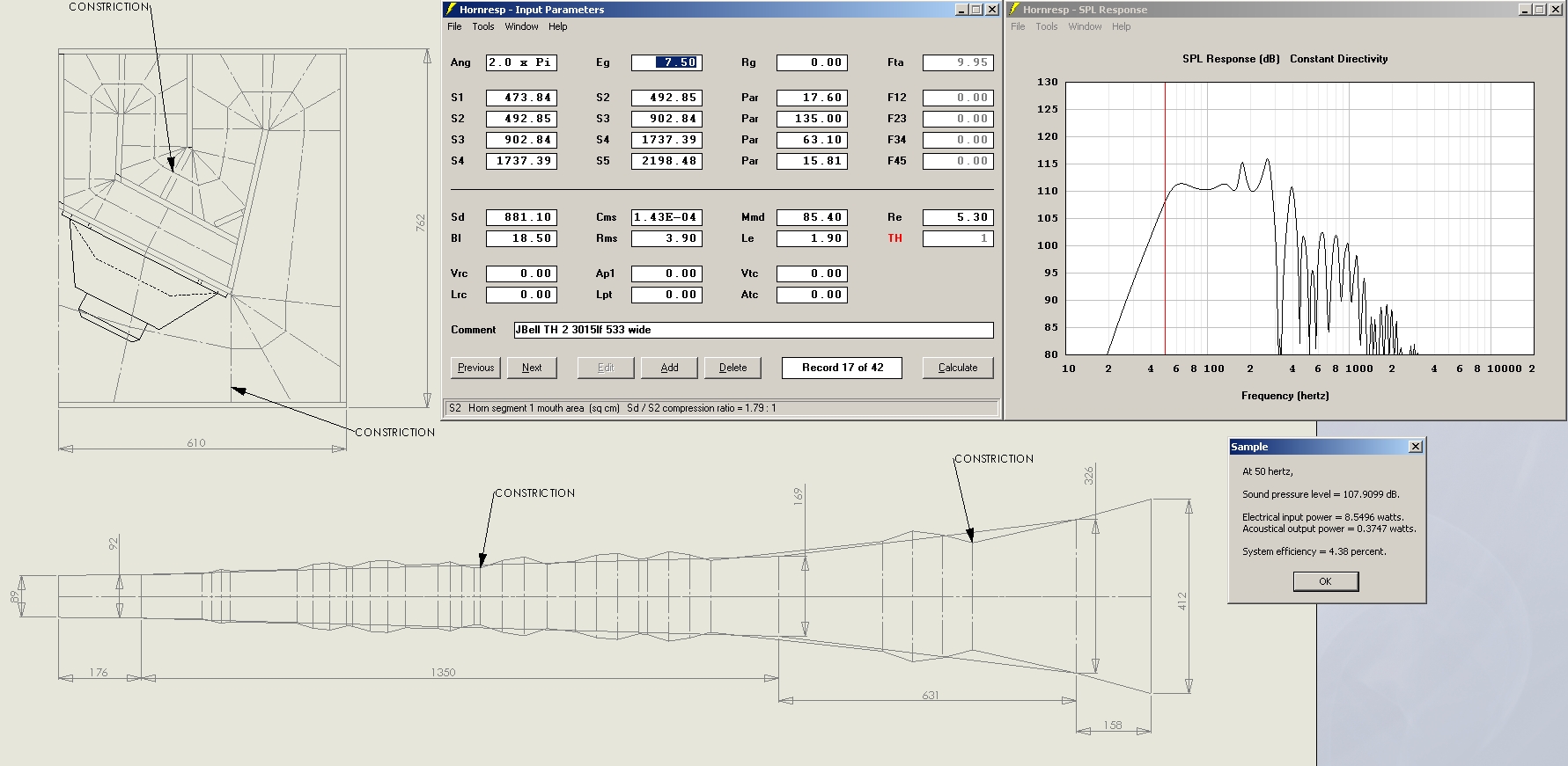

I decided to have a go at plotting out the horn dimensions 'as drawn' to try to fathom out what is going on with this sub.
The results of the unfolded taper are reasonably linear apart from two restrictions.😉
When I sim with these results, and adjust the level to 7.5 V to match Runrods sensitivity readings it tracks his results within his 2db tolerance level.
Then I notice that Runrod says he is running a 50hz hi-pass (the plot thickens!)😕
