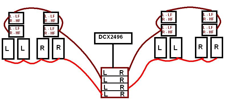

Jim; I am trying to specify QSC amps for my outdoor system. How much power will the SS15 take with the 3015LF driver and how much for your HS12 with a good Eminence driver? I am looking at setting up 4 pairs 8 each of your designs with the 2" HF drivers that I have and the owner would like to spend the monay on QSC class H amps before the new year. I will tri amp with a DSP. Do you think running two pairs 50' to 100' feet apart off one amp in the center is OK or should each set have its own amp rack? Thanks for all your help Andy.
SS15 is good for 63v (500watts) and HS12 with the beta12a-2 top is good for 37v(180watts) Your kappa+psd tops (if you build them) would be good for about 49v(300watts)
Personally I'd probably keep everything in one amp rack, even though that'll mean long runs. I typically use 12 gauge extension cord for speaker wire and speakon's so you can run 2 channels per cord. You can either run your tops all parallel for a 2 ohm load, or if you want to be gentle to your top amps and run 8ohm, you can make a small serial-parallel box to put at each pair of tops. The attached diagram keeps your cabling to a minimum.
My guess on amps. Sub amps need to be rated for no less than 1000watts per channel@4ohm, top amps need to be rated at 1000watts per channel@2ohm.

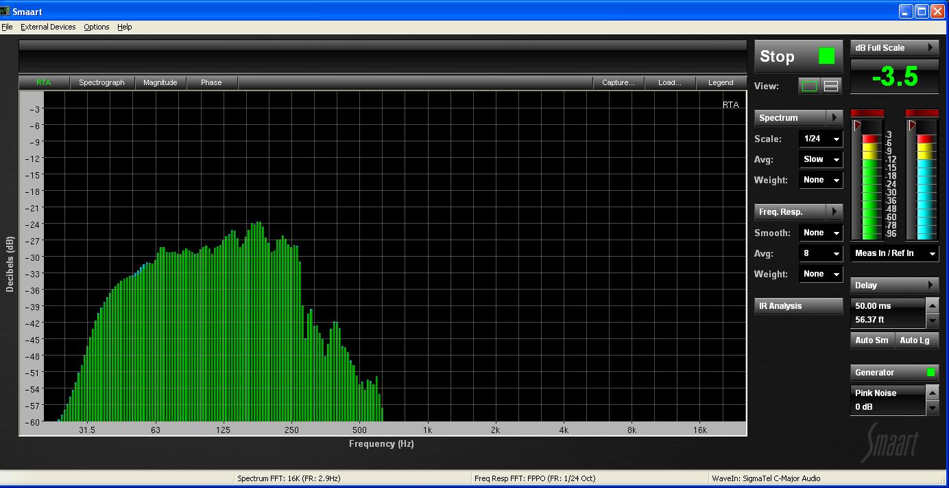

I don't have any good pics at the moment. However I did have smaart out today, as it was a rare perfectly calm day. (you can tell there is no wind... nothing at 10hz)
I pulled out a ss15 and did a 1 meter groundplane measurement. I set the sub amp crossover that I used to no boost, and 180hz cross. I verified with spl meter and volt meter that there was no boost, just flat response out of the amp. (have to watch that... some amps have a 'bass boost' by default..... like the bash.)
Here you go.
Here you go.
It wasn't calibrated to anything, just a relative measurement.Jim; What voltage was that at? Andy
However I always set to 2.83v@1m or 28v@10m.
If you go back in this thread and look at the spl measurements, they line up very nicely to smaart. 105db@60hz, and then it gradually drops to 100db@42hz, then falls off a cliff. If you assign -30db to 104, that'll be pretty close. 1meter always tests better than 10meter. This was also over concrete, not over grass.

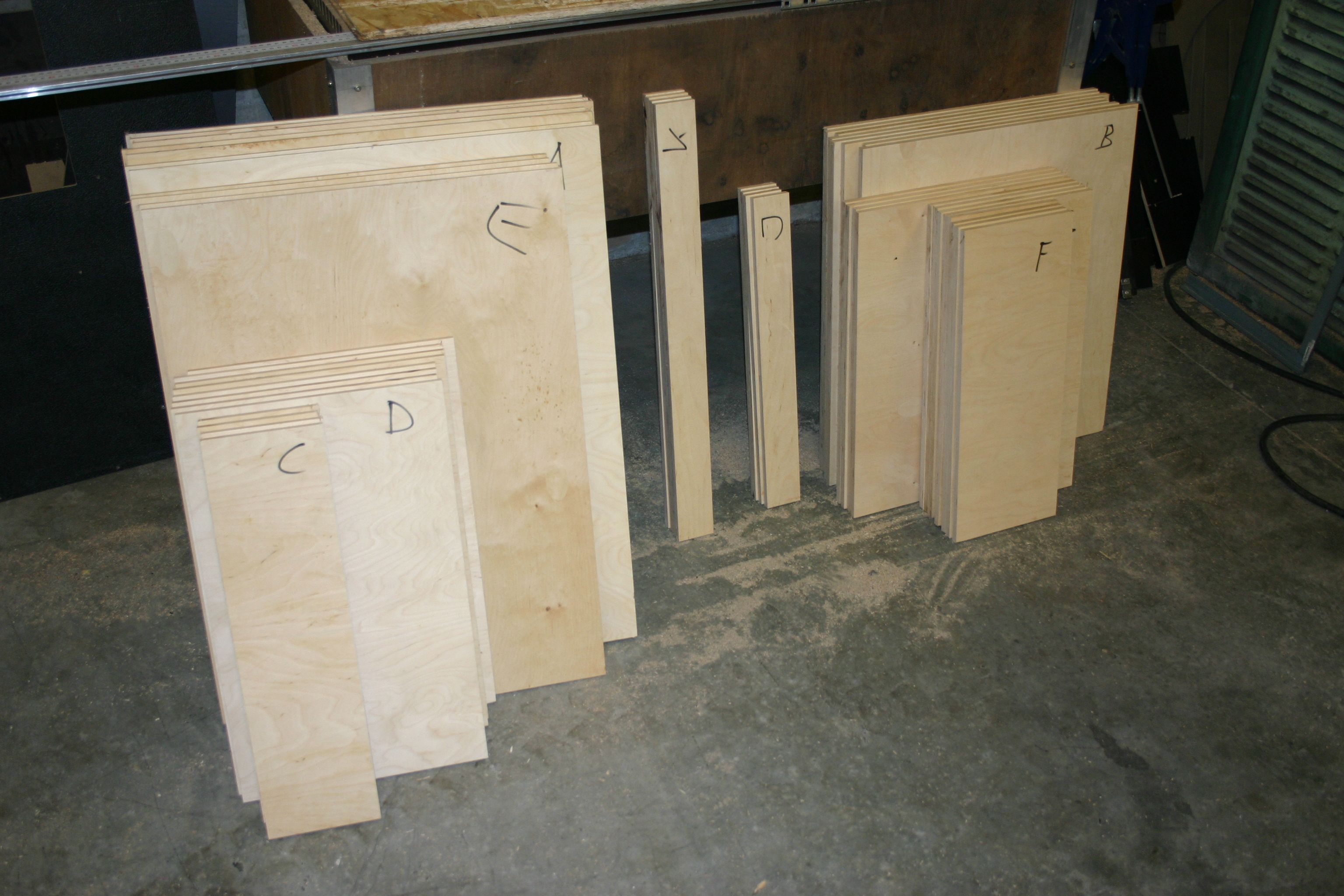

So, the build is in progress. I'm in the middle of drawing the design on the sheets, but now i have a question. It's probably more like a generel tapped-horn question, rather than something specifik on you're design.
After the horn path is going up to 5.15" it seems to me, that it goes down to 4.49", before going up to 5.25". So the horn path is narrowing after the first taper. Can someone explain this to me? I'm just trying to learn, but it just seems strange to me that it narrows down for at short while. Is it because of the double tapper or?
Looking forward to the build pic's Chaps Thank You.😀So, work in progress 🙂
My 4 sheets of ply have been cutted (quite easy job by the way!). Time to get four of these babies together .. Hopefully they will be finished in a couple of weeks .. I'll remember to post pics, when there is something to show 🙂
